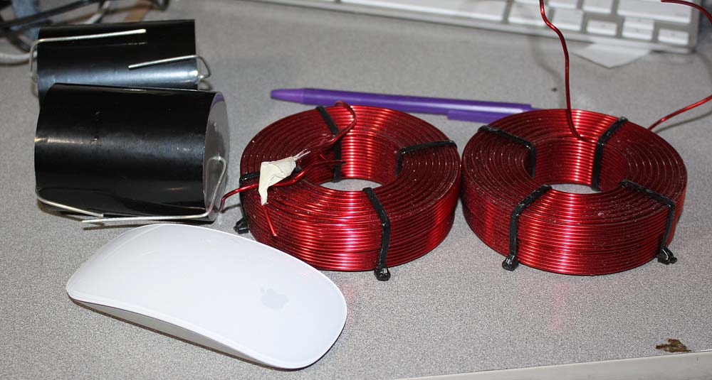

Woofers should be crossed over below 300, even below 150Hz. Doing that with a passive crossover becomes very ridiculous. The coils get to be the size of gallon paint cans!
This is where we are usually working, and almost always at least start with a PLLXO. But sometimes you just have to be able to live with a single amp.
Parts for a 160 Hz XO (or maybe it is 240), you are right about size.

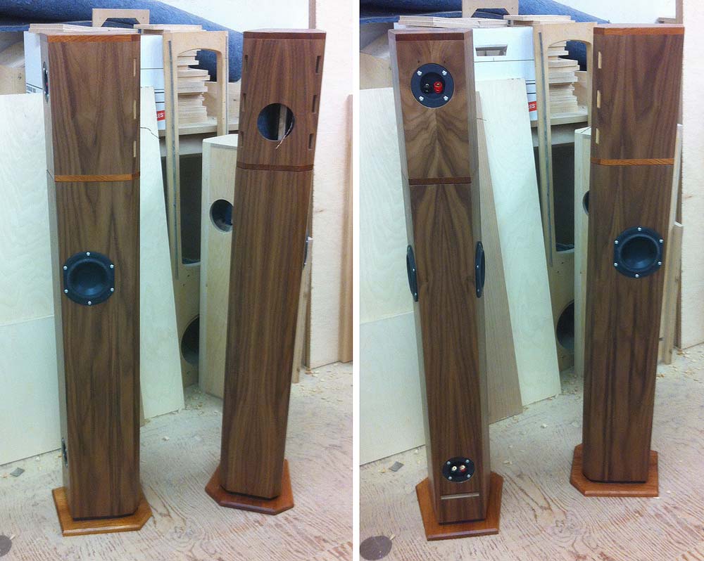

We've already tested an early mule with a PLLXO, pics of the next iteration (mid-tweeter not yet installed).
