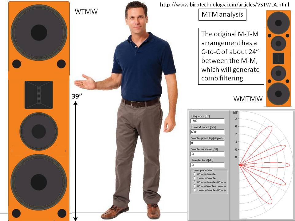

A WTMW topology would avoid the lobing and comb filtering generated by the 24" M-T-M spacing.
There are several good papers discussing the sound stage problems in MTM designs with large M-M spacing.

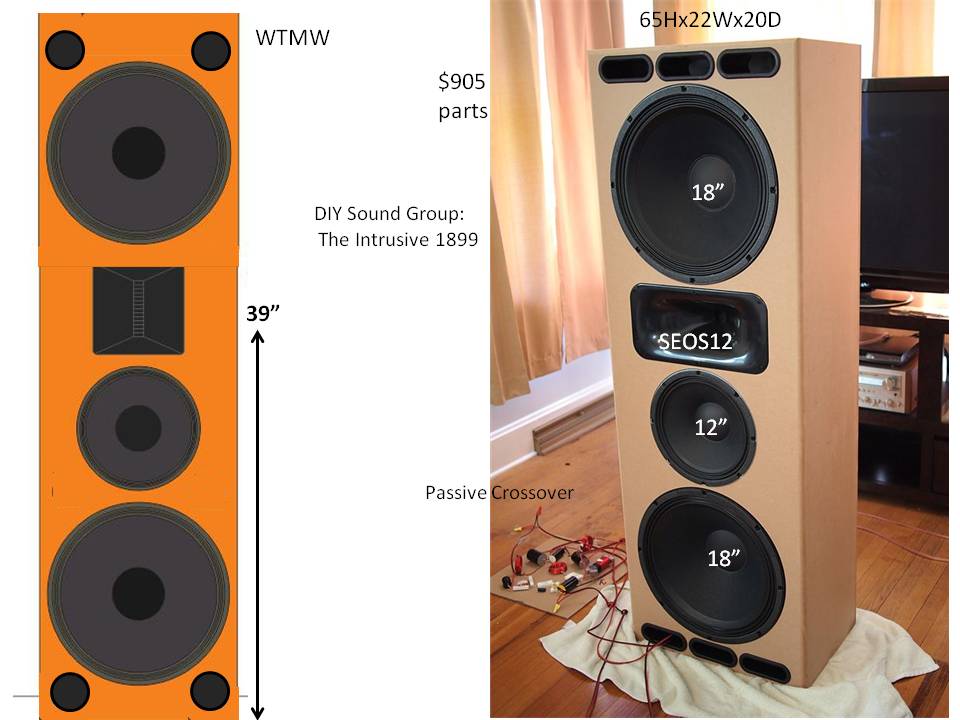

If a passive crossover is planned, an 18" woofer with T/S parameters optimized for a bass reflex alignment is desirable.
If an active crossover with multiple amplifiers is planned, an 18" woofer with large X-max and high power handling can be better suited to handle boost+equalization.
