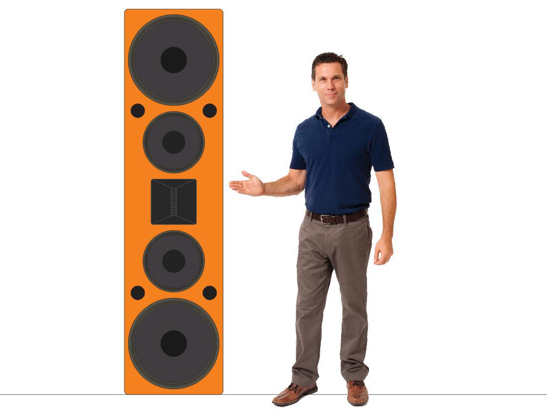

I just decided to add a Fostex T500 AMKII super tweeter crossed @8-9khz. I'm doing this as I want to prevent the TPL-150H beaming at higher frequencies and as I think TPL-150H lack a little bit the top end sparkles which will make it sound a little bit clinical although the spaciousness it adds to the sound is immediately audible. I hope I can make a better speaker using Fostex T500. I'm gonna run TPL-150H and T500 on the same channel and I'll add a HF filter to T500. I think I have to take care of TPL-150H LP filter. it's a tweaking job I have to measure and hear what kind of HF and LP filter are needed and how much overlap do I need
I know it may seem funny but a friend of mine insists to build a WMTMW based on Beyma drivers and this is the first sketch. the result may be interesting to many of you guys who have been following TPL/12P80 threads so I hope I can have your ideas about 18" woofer.
2x TPL-200H
2x 12P80ND-V2
2x 18" woofers
I have Faital Pro 18FH500 in stock and I have access to all Beyma products. I Beyma 18P1200ND/N seems promising. any idea?
it's gonna be 195cm tall and 50cm width and depth
2x TPL-200H
2x 12P80ND-V2
2x 18" woofers

It's just another speaker! I'm working on the first speaker that LineSources brought to a conclusion. I'm working on that speaker and I'm not gonna make any change to it except I may use TPL-200H instead of TPL-150H.
this WMTMW is another speaker my friend asked me to build for him after he heard the sound of the first speaker prototype.
I tend to keep my worthy 12P80NDs safe in the warehouse. four 12P80NDs is just too much as I only have 8-10 pieces in stock. after all two 12" midrange in a high fidelity speaker? really?!
Faital Pro 10PR410 is a worth checking:
I think it's a good match to TPL-200H. smaller driver will get narrow higher.
I'm still eager to hear your ideas about 18" woofers. 15FH500s are not bad I think.
I'm sorry I have no experience with 18" . I rate very high the advices of LineSources. They are always "fire and forgett" as some say (hit the goal if you prefer without worry about the good result😎).
In a big room enough >40/50 m², I will maybe try in your shoes 18" in line array but drivers not so close to the floor and ceilling (so middle centred). Look for instance what StigErik did with its bass array here with searching function of DIYAUDIO. Or laterral push-pull for enclosure odd harmonics and vibration cancelation as LineSources advised often ? It's up to you, your energy and skill 🙂
The idea is to have both a lot of Sd to improve transcient in the low end while the vertical array help a little for room modes, an other elegant path is maybe distributed sub in the room à la Docteur Gedes.
