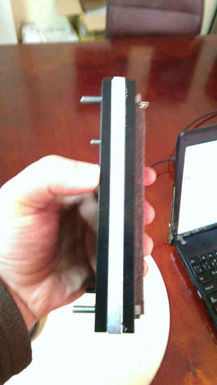

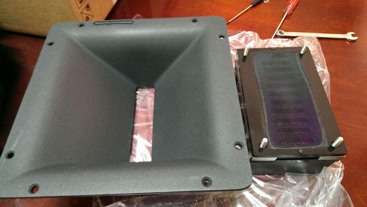

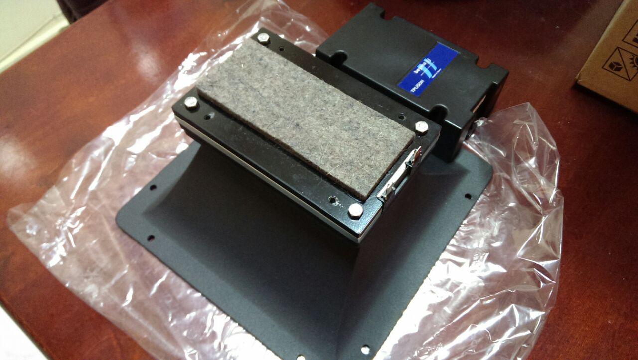

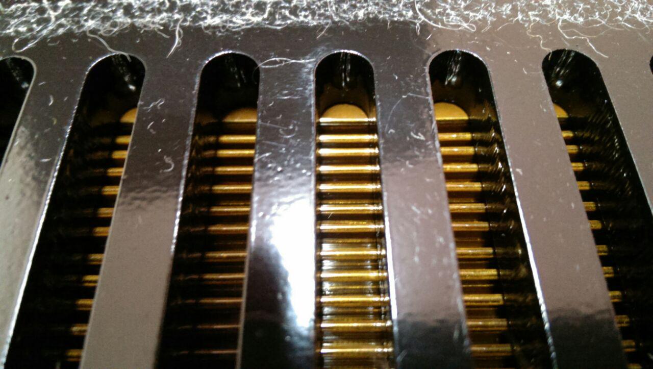

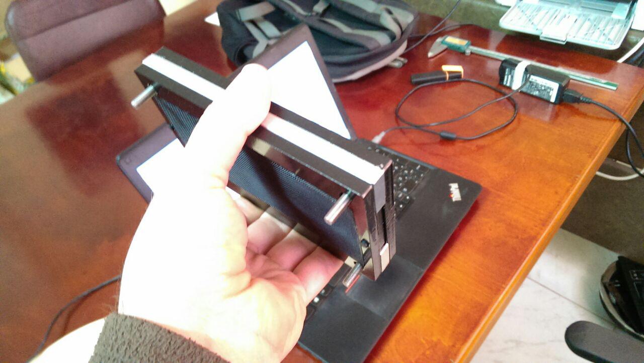

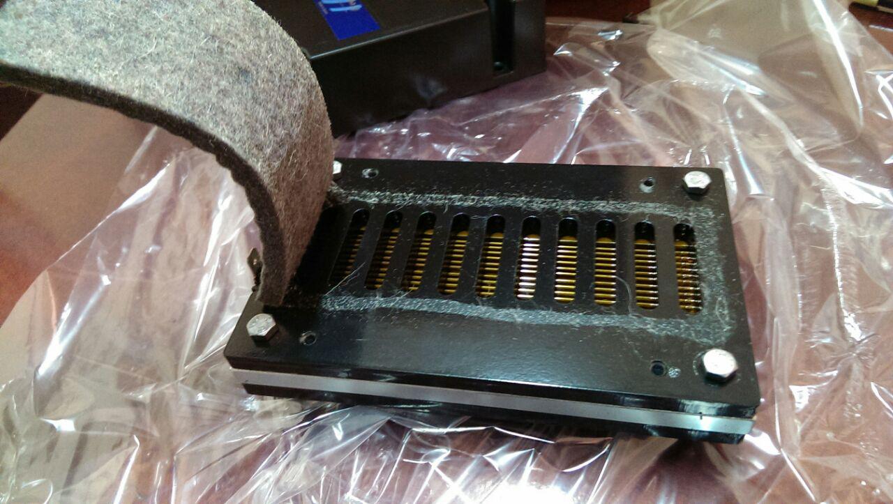

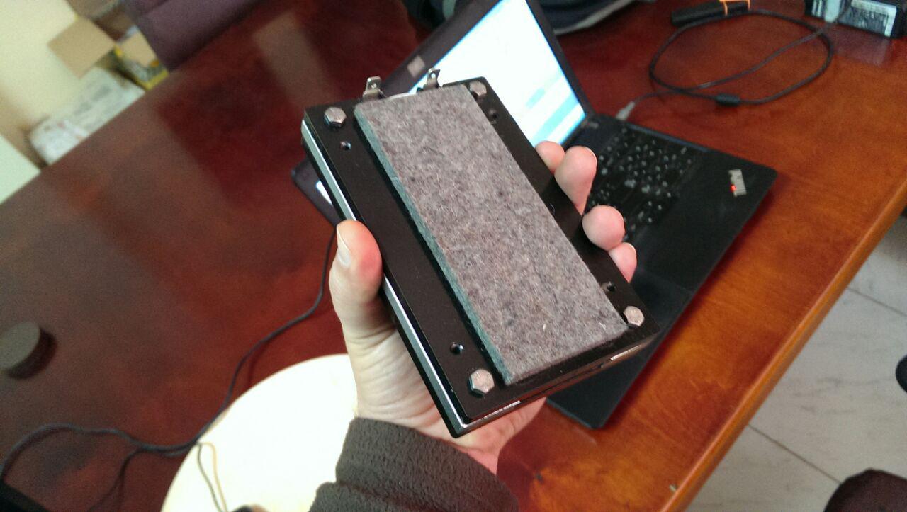

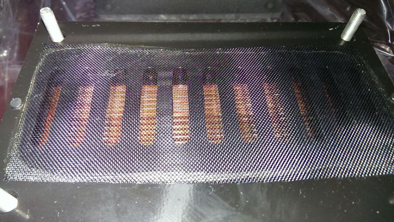

I just opened up TPL-150H to take a look inside. see the attachments.

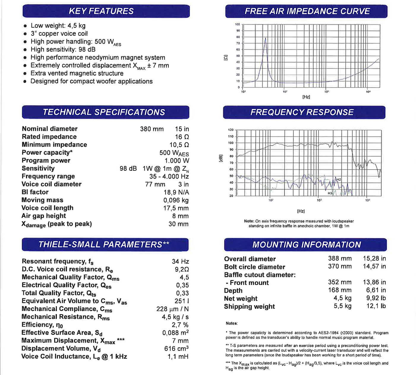

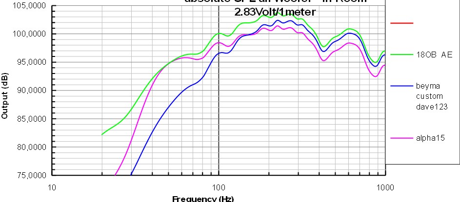

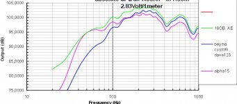

for now my concern is if I can get decent bass down to at least 40hz or not with customized Beyma woofer I got (it's called BD-Design BD15) woofers I got.
it's pretty fast woofer with light moving mass. I like it's sound too much. but it's the first dipole I'm gonna build so I don't know if two of this woofer will go down to at least 40hz region.
it's a 16ohms woofer. I'll use two of it per side:

BTW, removing the plastic back cover and building a 1 to 2 liter box behind the TPL is said to extend the low end reach, plus reduce distortion.

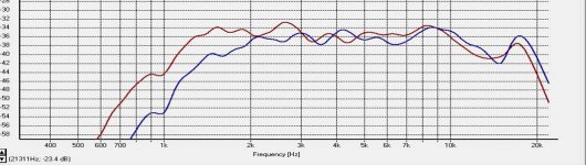

I thought i would add to the comments regarding the TPL's. I have attached a trace of the TPL with and without my oversized horns. The peak i introduced ( +2db) at 2K has been fixed with the larger back box. IMHO alot of the peaks and issues with the TPL and not crossing it below 1800Hz are ill founded. I believe all the issues are mechanical, the 1600Hz peak is the plastic backbox vibrating and other issues relate to the fit of the ribbon in the slot, i packed mine out with some shims. It did not feel right to have the ribbon cassette loose enough to drop out if turned upside down. Lots of wasted energy in mechanical vibration, so my horns weight around 10 kg each, to drop the assembly freq below the running range. I know Stig likes them open at the back, if i wasn't going closed baffle on all the drivers, i would have been tempted to build the double horn having them loaded in dipole, as an experiment. Supravox 215-2000 EXC ,400-2000 EXC OB and Beyma TPL 150 OB 3 way
