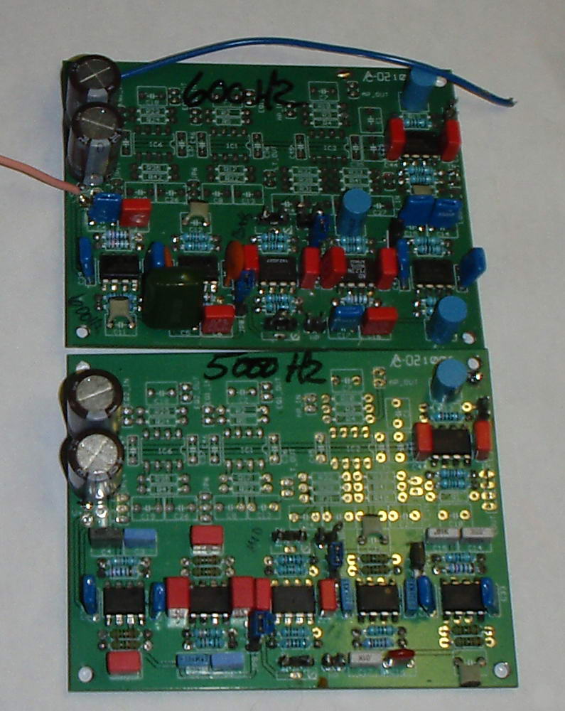

Active filter board GB
Why new? Ether I have got fakes...that makes the trouble?
And most are usually missing a leg or two trying to get them out...
I have already spent weeks, trying to figure out what happens/why...without success.
The last minute I will spend on them are the way to the waste-bin.
Arne K
As I usually build them..:
Arne K
Hi all...
Save those boards!
I might suggest buying some high quality IC sockets. The ones with the round, machined pin sockets, not the cheaper folded spring ones. They are very reliable, have little effect, and you can then change parts easily and quickly.
I even use them as individual sockets for caps and resistors. Get some 24p or larger sockets, or just the inline strips, break them up carefully with your needlenose piliers, and you have single pins! Perfect for developing, where you might be changing filter values a lot till settling down on final values. Then you can solder permanently if you like.
As a troubleshooting tip, see if you can separate your crossover into lower order sections, to see if they work. That should help you to pin down where the problem is.
Good luck!
