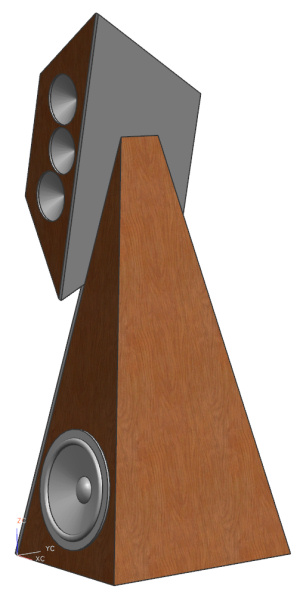

I'm trying to understand all this, and I think I've got it. I'm attaching a model of my rather special speaker again (this is the left one), with a front mounted woofer as suggested by Bob.
What I know so far is to use the input buffer, 12 dB high- and lowpass filters, and output buffer (is the output buffer really necessary?). I'll put the filters at 250 Hz like the original passive crossovers. I'll also use a notch for the bass, after measuring frequency response. All opamps are the new LM4562. What I haven't decided on, or quite understood yet, is whether to use allpass and LR.
Due to the recessed mid/tweeter baffle, their voice coils are vertically aligned with the woofer VC. My ear height is about 25 cm below the tweeters, at the focal point of the mids' inward slant, and about 50 cm above the woofer. Should I even bother playing around with an allpass on this? If all it does is compensate for different distances to the voice coils, I can do that by moving the mid/tweeter baffle back or forward a bit more before I start cutting wood.
LR: Considering I'm using a notch filter, will this do me any more good than add bottom end bass? The woofer is a 10" Seas 1305 in a 50 liter vented box. I've got plenty of power to drive it.

Ideally you'll want to use the all pass to compensate both for the acoustic center (not necessarily the voice coil) offset AND phase differences at the crossover point. You can measure the drivers and crossover individually and see if there is enough phase difference to worry about.
Output buffers are not absolutely necessary. If you are not using the gain control you will get a buffered output from the filter. The buffer provides a low impedance source to drive your amps. If the interconnects are short and you don't use the attenuator you shouldn't have an issue. Otherwise you might find that your system is overly sensitive to cable choices.
You can use a notch filter to tame upper end breakups. The Linkwitz transform can extend the low end response if your woofers have the excursion and power handling to take it. If the woofers aren't up to it, you either limit your system output or live with lots of distortion. You might consider a high pass on your woofer to prevent damage below the port tuning frequency.
