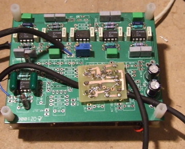

Some progress has been made on the power controller/muting circuit I mentioned a while back. Some details are on my website. I'll be posting more there shortly.

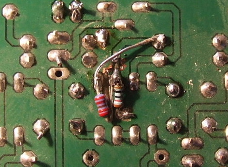

Suggestion for a Mk II board. The output buffer set to have gain, x2 will do. This has come up because I'm trying to use a single board with an existing pair of balanced drive commercial monitors to provide a sub output, and the losses in the system as is means I have less level on the outputs than required. I can either cut traces and reconfigure the output buffer or use another of the spare eq stages to get some gain, but that means another chip. Not ideal.
Noted. Thanks for the input Al.

In case anyone has the same problem, the mod for adding gain to IC9.
Oh Al!!! PLEASE tell me that was a prototype done hastily and you will be cleaning that up!!! 😀
You know I'm just giving you a hard time...
