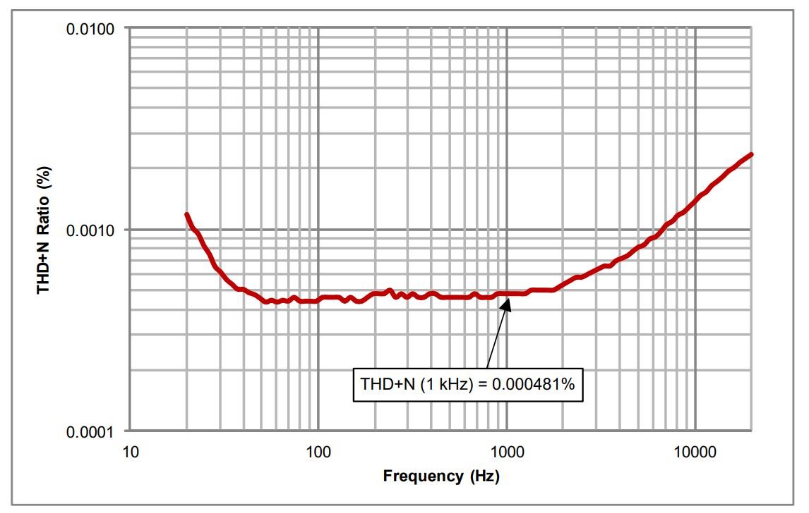

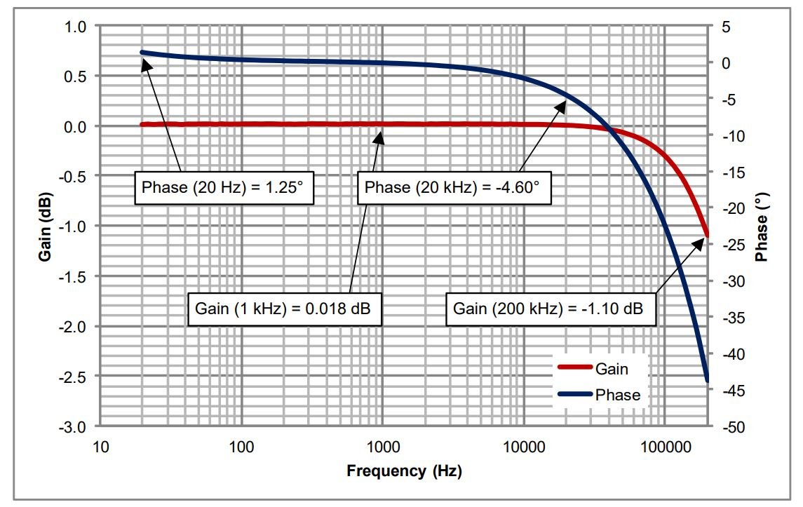

I disagree with your reasoning. If you add resistors to an input with a capacitance, you create an RC network, which has an effect on phase and frequency response. These effects are minimal with the active attenuator. Also included are the measured values of the active attenuator.
If the new resistor devider has almost the same impedance as before( as I proposed) nothing but only the signal amplitude changed.
All the deviders you show yourself are almost shorts for the preout. You go from 47k to 1k impedance, yes that changes the sound.

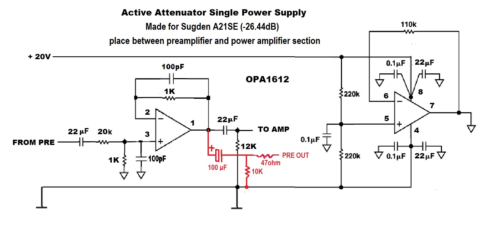

I finally decided to make an active attenuator with the low noise dual opamp OPA1612 and I'm going to place it between the preamp and power amplifier section. The 20 volt supply comes from the preamp section. The 20 volt I convert with the 2nd amp in the OPA1612 to a virtual ground. By adjusting the 20K input resistor you can make any attenuation needed.

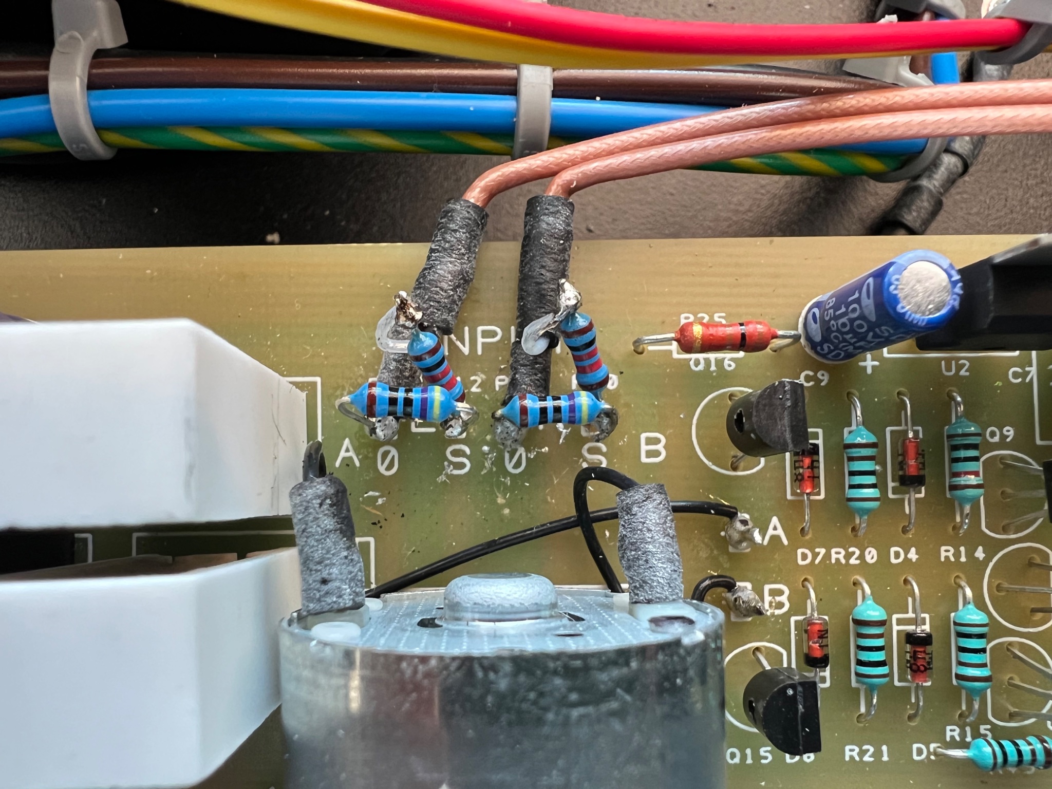

Today I was busy again with placing the signal attenuation in the Sugden itself. I wanted to attenuate between the pre- and power amplifier, but I discovered that with an input signal of 1.77 Vrms the pre-amplifier started to distort when the potentiometer was set to 2/3. The Meitner DAC even has 2.3 Vrms.
So the attenuation must take place at the input of the Sugden.

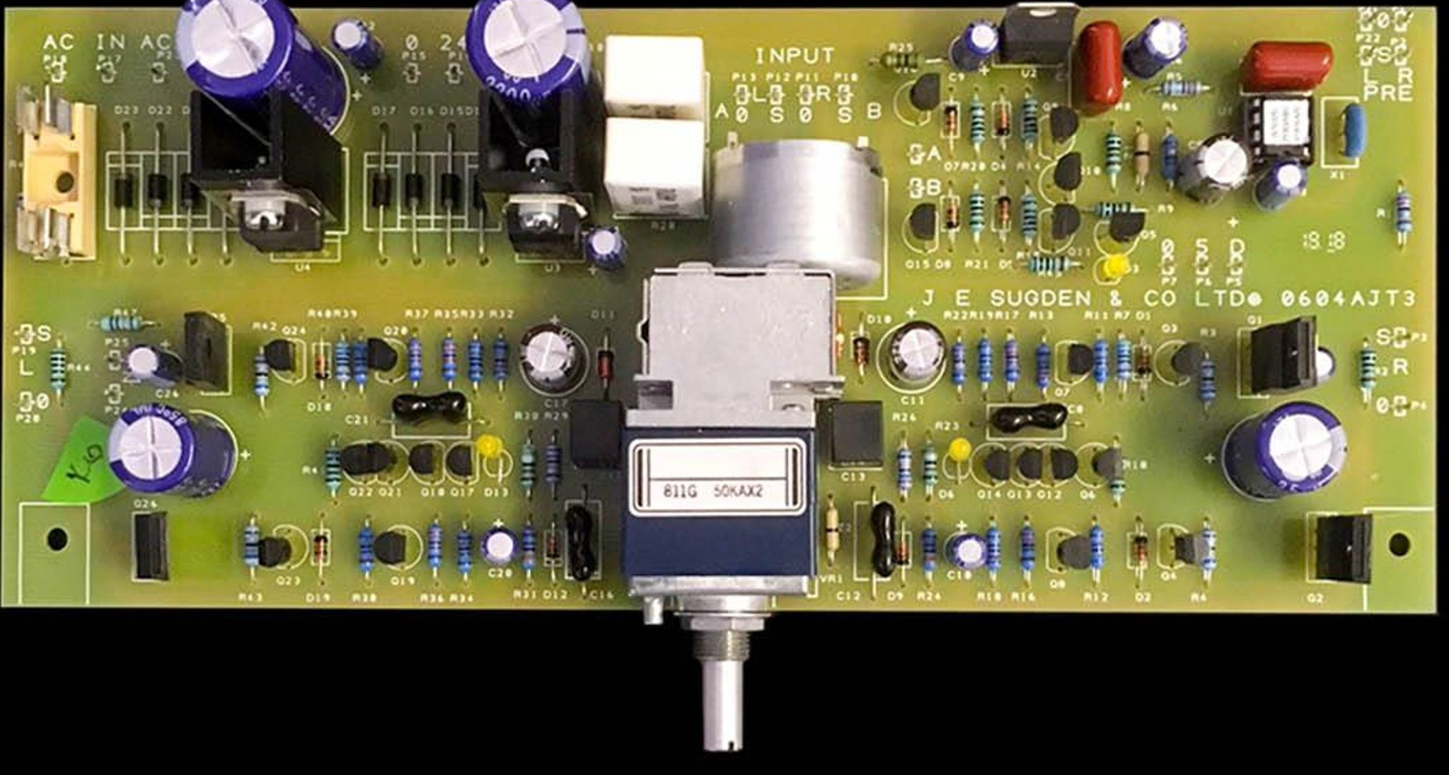

I looked at the input circuit in the Sugden and determined that the input is a 475 ohm resistor in series with the 50Kohm input potentiometer. Only after the potentiometer do I encounter an HF capacitance.
That means that I can place a resistor attenuator at the input of the pre-amplifier board without any problems. I chose 10.2Kohm in series and 475 ohm parallel. Seems to work fine. High frequencies such as 50KHz are also not attenuated. So with there resistance values I end up with a damping factor 22.5x. or -27dB.
now the potentiometer can be set to twelve o'clock and the sound is still beautiful.
The circuit of post #46 is a buffered passive attenuator, no matter how you look at it.
Technical language gives specific, defined meaning to words otherwise used casually.
See post #52 for an example of actual active attenuator.
