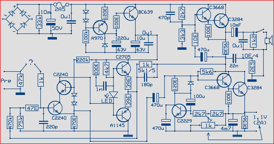

It seems you are pretty sensitive to sound quality and ways to preserve it/not affect it (the sound) while being able to fine-tune the overall gain. So here's the schematic diagram that should resemble your amp pretty closely. Use the trim pot in place of the 470k resistor, and then find the suitable gain. Then measure the trimpot resistance and insert the corresponding discrete resistor value. This would be easier than going inside that CD player of yours to adjust the gain of its output stage.
You could also just go ahead with a 390k resistor if the trimpot is too much of a hassle - that should be okay for your needs.... but the trimpot would most accurately get you the desired sweet spot.
Edit: or just solder a resistor on top of that 470k to get to 390k...

The volume control in that A21Se is as passive and resistive (and cheap!) as can be so the reasoning is off. The real solution is to have the Sugden adapted to the world not vice versa (or by adding stuff in between).
It simply makes no sense to correct A21SE its too high GAIN by attenuation of sources standard line levels and then amplifying again. Correcting an error with an error that is. Practically every device bought today will not have a nice relationship with A21SE. Amplifiers in general do not have too high gain, this amplifier has too high gain.

This looks like the best sollution. I soon will have a look inside the Sugden.

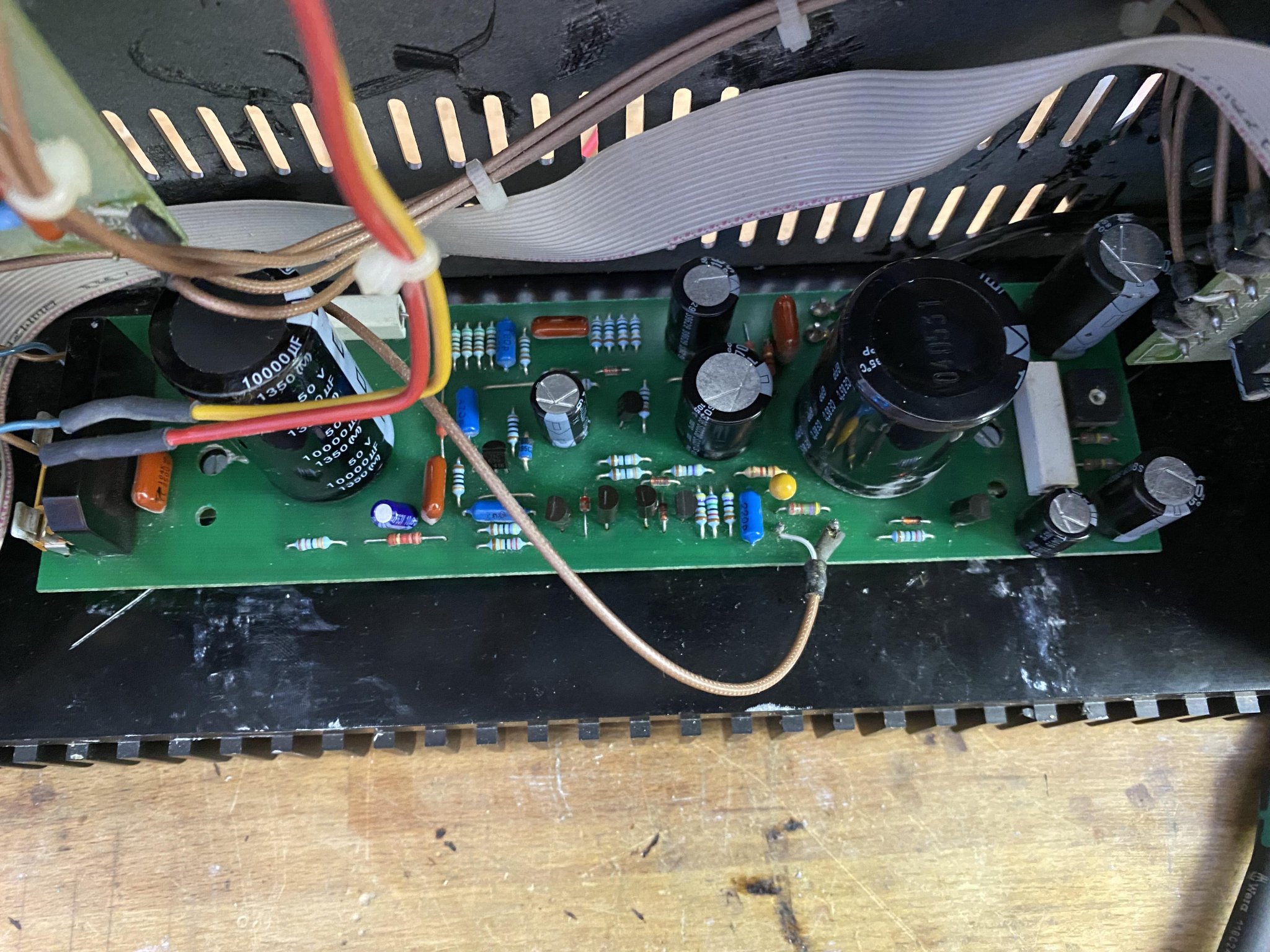

I found pictures of the circuit boards of the amplifiers in the A21SE on the internet and you can clearly see that the components at the input correspond exactly with the diagram. The feedback resistor is actually 470K and can easily be adjusted by soldering a resistor in parallel. Then it is a matter of measuring and determining the correct value. I will start working on it next weekend.

Good. I'd also use only a single high quality reisistor in that position.
Dale metal film vs. Allen Bradley carbon film would be my choice, with one providing detail and extension, and the other making everything more mellow and warm but still quite detailed.

They are in their own world with regards to gain (it is design poverty). Nobody likes volume to be very loud at 1 o'clock or distortion but Sugden dictates the way they see it and that would not be an issue if they would produce fitting 200 mV sources which they don't except 1 DAC. A DAC that has....2.15V rms output level. That is why they are a British cottage industry brand.
What can be is that the feedback loop needs other changes. Many amplifier experts here that can tell.
