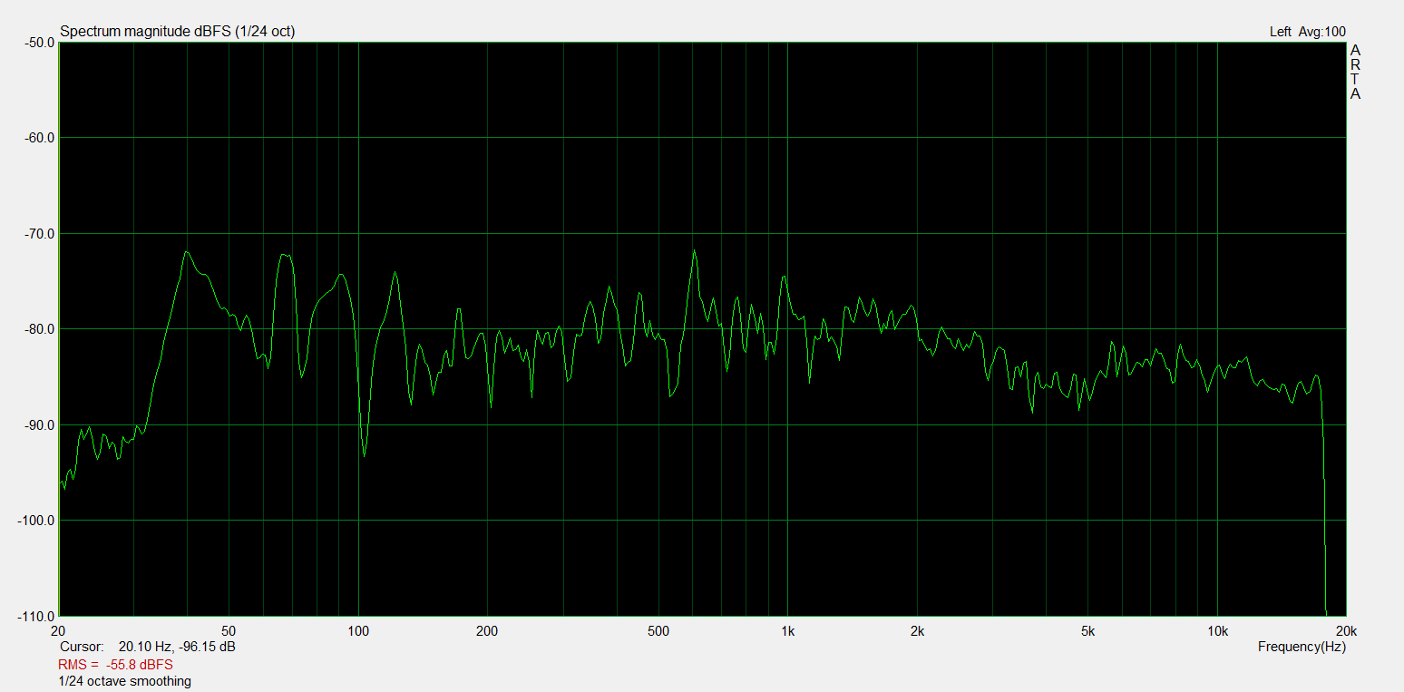

Boston Lynnfield 400L measurements
I open again this old thread. I gave my word to xrq971, Wesayso, BYRTT members to measure my speakers in the spirit of the great job made in the Full range section : measurements sessions of many 5" to 2" inch drivers made by xrq971. It's also for the nice people whom helped me in this thread before : actual tweeter has a passive notch I added around 4.5 K Hz if I remember (not the last seen in this thread above) to tame some sibilance which worried me ! The near Boston Lynnfield 500 L serie which has the same drivers, XOs points according Boston Acoustic Datasheet can be found on Stereophile website here :Boston Acoustics Lynnfield 500L loudspeaker Measurements | Stereophile.com . The Boston has a lower low end. My Lynnfield 400L are given to 35 Hz to 30 K Hz, although a passive mechanical patented filter in front of the tweeter is said to damp the aluminium cone peak around 20 K Hz !
XOs on both speakers are 125 Hz & 2600 Hz ; but look at my measurement below, XO of the 400 L seems to have its tweeter XO nearer than 2 K Hz than 2.6 K Hz !
I'm a beginner at measurement sport (advices are welcomes)! reccording environment :
Mic: ISEM EMX-7150 - (calibrated with both semi-reverb and without : so 2 correction files)
PC - laptop Windows 10 (x64) - Intel I5-8 GoRam
soundcard : external EMU Pre Track http://www.creative.com/emu/products/product.aspx?pid=17511 : 24-bit/192kHz A/D and D/A converters (A/D and D/A: 112dB measured SNR performance ; A/D converter: AK5385 ; Phantom supply in class A for the mic.
ASIO driver from EMU was keeped. Drivers are for Windows 7 (x 64) as the W 8.1 & 10 do not exist; it seems to work ! Previous tests of this blog were made with a XP Pro laptop with the same soundcard but a EMC-8000 non calibrated mic).
I loaded also Ohms Impulse but had no time this week end but for the last Arta 1.85 from where come those graphs below !
Step Sin 20 Hz to 20 K Hz file played through AYA2 boosted DAC ! The External SoundCard iIt's a first measurements s just feeded by USB, I have the possibility to put an external PS though.
These are my first measurements ! Calib files non loaded to beginn as BYRTT member asked me (mic is said to be very linear stock without its calib correction : the idea is to compare !)
Left speaker reccorded : 1 meter from the rubber mid cone (look at pictures on this thread to understand why : passive mechanical filter is in front of it and it's impossible to move it.
A rapid calcul of the volume of the room give a 133 Hz Scrhoeder frequency.

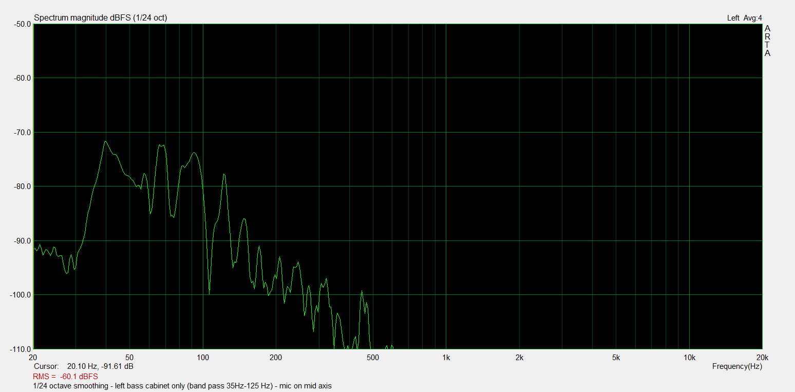

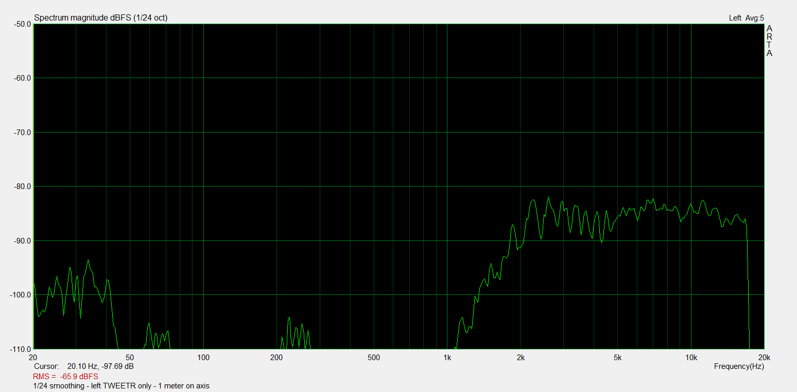

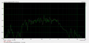

Eldam thanks plots and nice documentation, looks like that especially 6kHz and 8kHz resonances from mid add to tweeter response in the system full range plot, maybe also the two mid resonances above 6/8kHz influence when one compare tweeter response verse system full range plot but they probably make dips (cancel) instead of peaks (sum).
thanks for the inputs,
If you want I make some measurements process : with calib files, old mic, listening position with different setup, just ask !
I have to read a little Olhms Inpulse manual before playing in the living room !
I surely made some protocol errors but it's a beginning ! I will try also THD, phase, etc ! As you see, on listening position, the curve should dive when going to the mid & treble ranges. It's already the case at 1 meter on axis with just the left speaker playing...(I damped the floor between the speaker and the mic; left speaker is at its usual position, so not putted on the middle of the room for a measurement farer of the walls ! Here the usual position is farer than 1.2 meter from side and front wall).
I find the notch added to be good at ears, better than without ! but as it's changing everything like phase for instance, I plan to remove it and measure again... but not yet ! Next measurementq will be like those ones with the notch keeped to have a concistency with the 1 meter on axis measurement...
Nice! You've kept your word 🙂. Let the games begin! It is fun stuff to learn what you are listening to. I expect the tweeter to go up way higher and not drop off that fast. Maybe try to record at a higher sample rate to be able to see that?

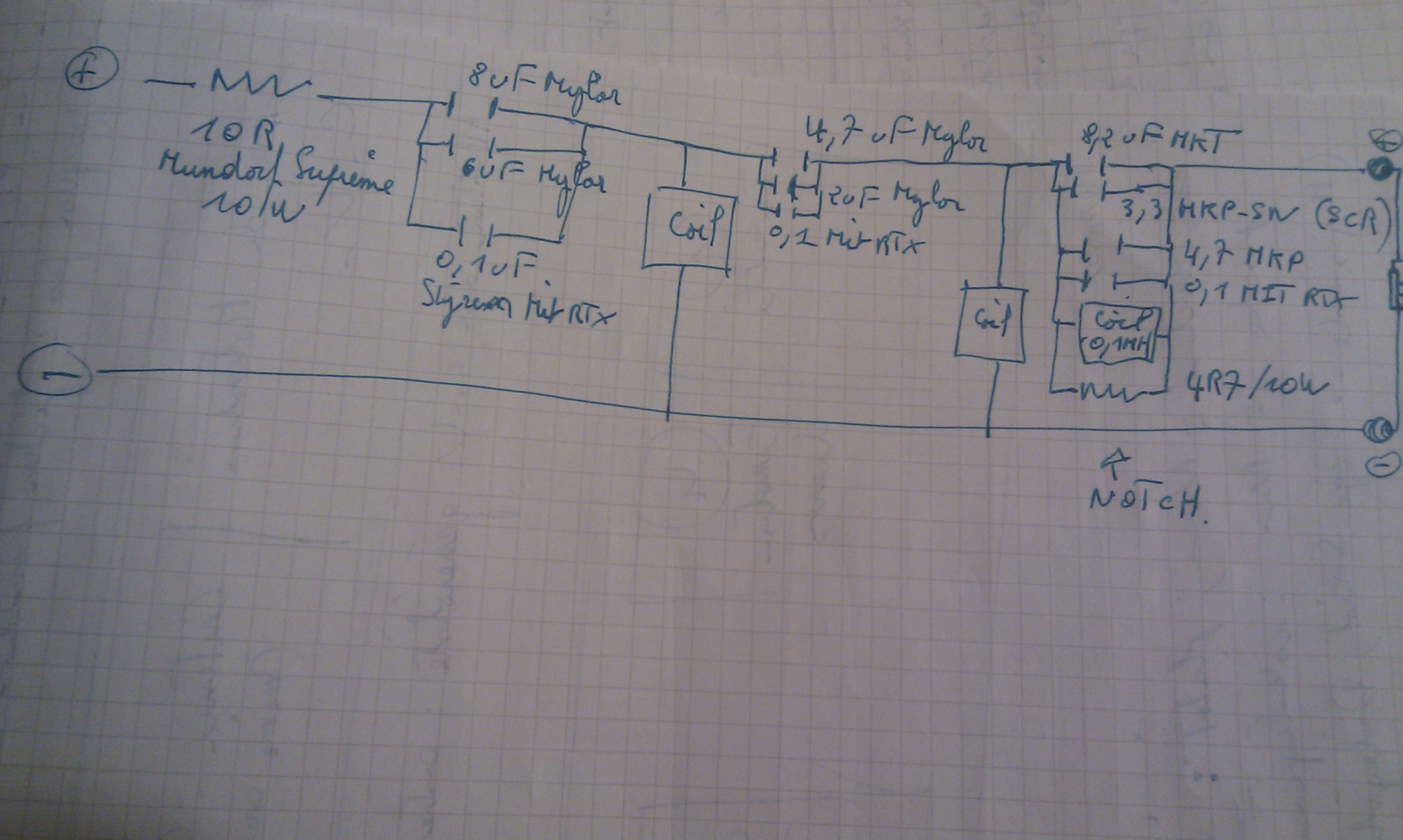

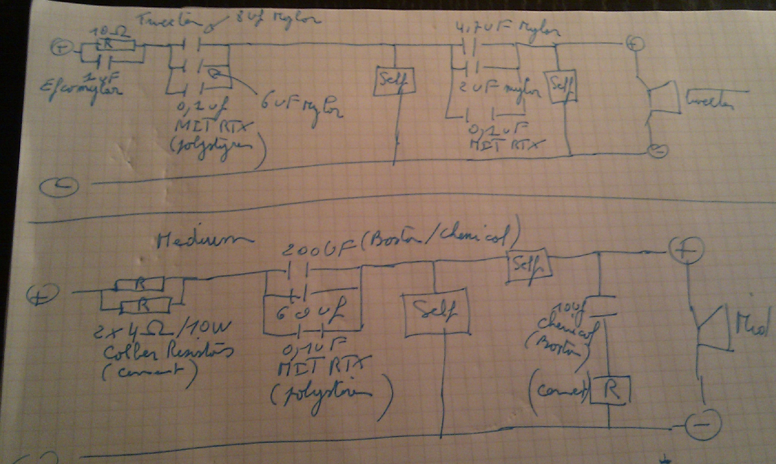

The shematic is the original one. I changed few things : the tweeter resistor has 0.5 ohm less but is a biwired.
I added a notch around 4 Khz
I added stuffing in the teweeter domes
I changed the Zobel in the mid (marked 10 uF but both channels exactly measure 9 uF instead) by SCR MKP (the smoothest MKP I know, sound like mylar buth better ESR)
I swapped the two 4 ohms résistors at the beginning of the mid by two mox of 3R8 (instead cemented in paper genuine ones)
The MIT styren in // with the 260 uF in the mid was changed by an Audyn True copper cap I find less coldy.

In those measurements (the mast made) with a calibrated aMic and soundcard, the tweeter seems to dive at 19 K Hz; it's not like Stereophile measurement in the 500 L which has the same mid and tweet units but maybe different crossover. The measurement I made suggest 2000 Hz : I measured each driver with its filter as the speaker can be tri-Amped ! But the XO points seems the same than the 500 L on the paper 125 Hz/2500, Stereophiles as my measurement suggest more 2000 Hz though.

I have to draw the notch I added in the tweeter filter between the tweeter unit and the filter above shematic to be clearer.... (the sound improved at my ears, and with the internal damping of the cone tweeter as well despite the foame dome behind it on the magnet ! look at previous photographs in thi sthread).

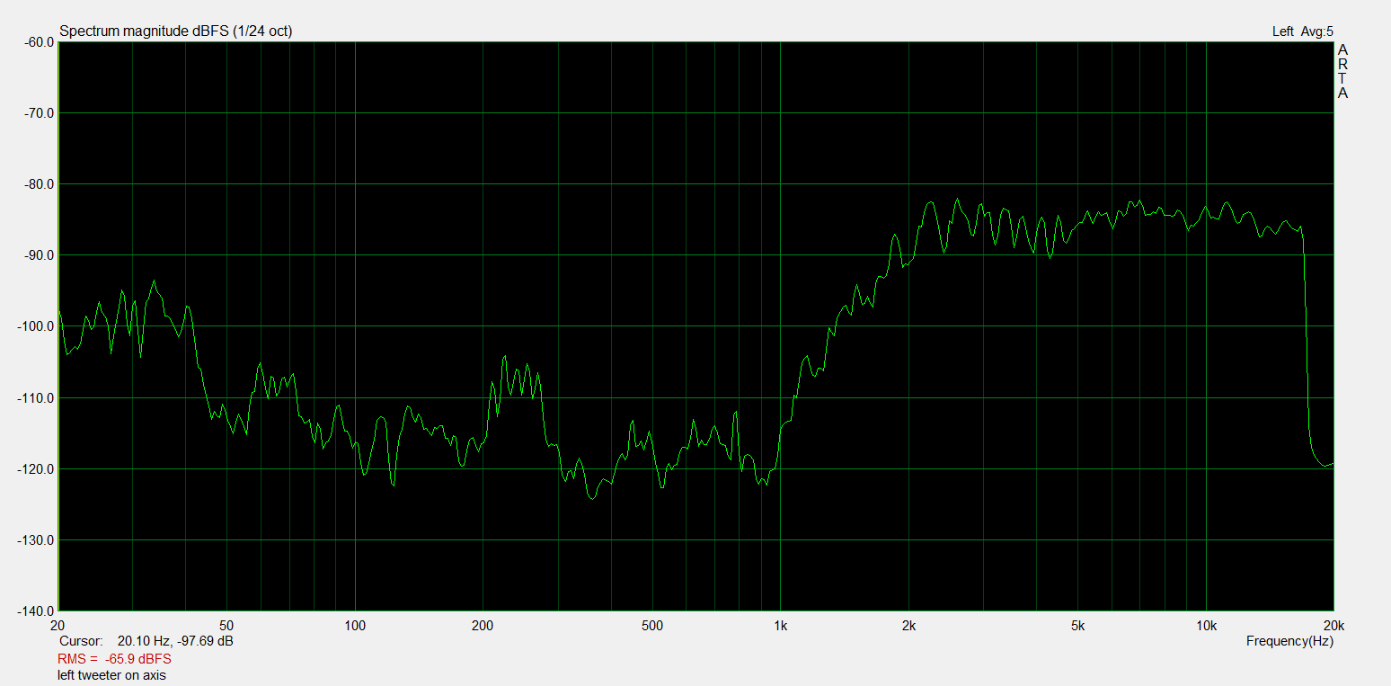

It's getting a bit late to do much on this, but it seems like you've just fiddled around with improving components without changing things much.
FWIW, I would think the tweeter ferrofluid is drying up now. You can buy replacement stuff on eBay by all accounts.
I just had a quick model, and you can easily lower tweeter level and shape it a bit. You use target electrical slopes to do this, and you just have to know the DC resistance of the tweeter to get quite close, because the filter totally dominates the response with 4th order.
But I need to know the existing coil values and tweeter DC resistance to work out a filter shape, for sure. Attenuation can be more easily estimated.
Thanks Steve, indeed I have to change this FF.

Could someone tell me if it Worth to swap the chemical in serie in the mid (260 uF iirc in the shematic linked above by a MKT or MKP ESA from Clarity cap ? I'm suspicious about ESR when it comes two swap two caps technologies !
Thanks if any idea : I was also thinking to the russian K73-16 MKT in 22 uF /60 v in // !!
Btw way, what is making a resistor in // with a cap putted in serie in the tweeter filter please ?
Does it climb a part of the treble curve when the impedance curve falls or the Fhz curve falls ???? Not clear to me despite re reading the V Dickason book !
Any tips appreciated about this please, 🙂
PS : in the genuine filter a 10R was // with a 1 uF Mylar from Epcos : http://www.diyaudio.com/forums/multi-way/240636-acoustical-filter-tweeters-2.html#post3592382 (original shematic from this thread in a post above) ! I find it better without at ears !!!!! But the cement resistor was swapped by me with a Mundorf Supreme which is subjectivly clearer with more détails but gives also a subjectrive climbing treble ! (aluminium dome faulty ???)

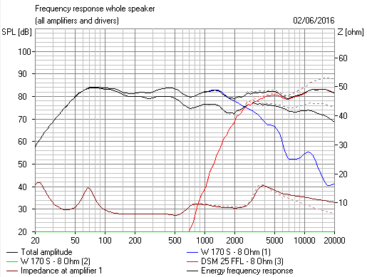

The 10R//1uF lifts the top end a between 2-4dB above about 8kHz.
Bit perfectionist IMO. Possibly work better without the 1uF.
You'll be better off simming it really:
Downloads
boxsim-db.de | Boxsim Projektdatenbank
Import that project into projekte folder and mod it. I uses a W170S 8 ohm and a DSM 25 FFL. Must be vaguely similar.

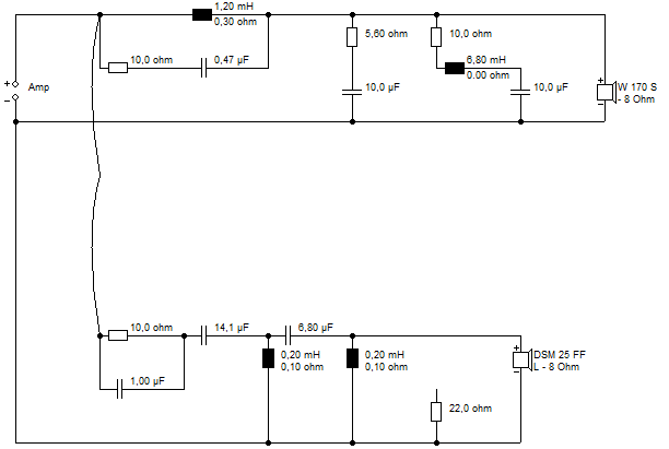

If a tweeter is overly bright, you might lose the 1uF, and add some shunt element at the tweeter. 22R here, or a sloping zobel like 7.5R and 0.68.
You've gotta judge it yourself.
I have this sim set up for your speaker, but I really can't remember exactly what I was doing there.
Tanks a lot System 7 ,
Without it sounds better indeed, at least in my room !
The plus was also to add the notch around 4/5 K, but surely phase suffered of this tweak ! Adding also medical cotton behind the aluminium gave improvement!
The problem with my measurement is I can't identify if it's really in the treble ?! Maybe it can be the huge peak I have around 600 or 800 Hz which are givinge some harmonics ringing... or I made a bad measurement (I didn't putt a delay !).
But where will you putt the 22R shunt please (cause easy to try) : just before the tweeter after the notch cellul or can I simply putt it before the filter on the plugs as the speakers can be tri Amped ?
