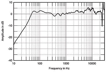

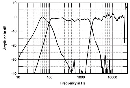

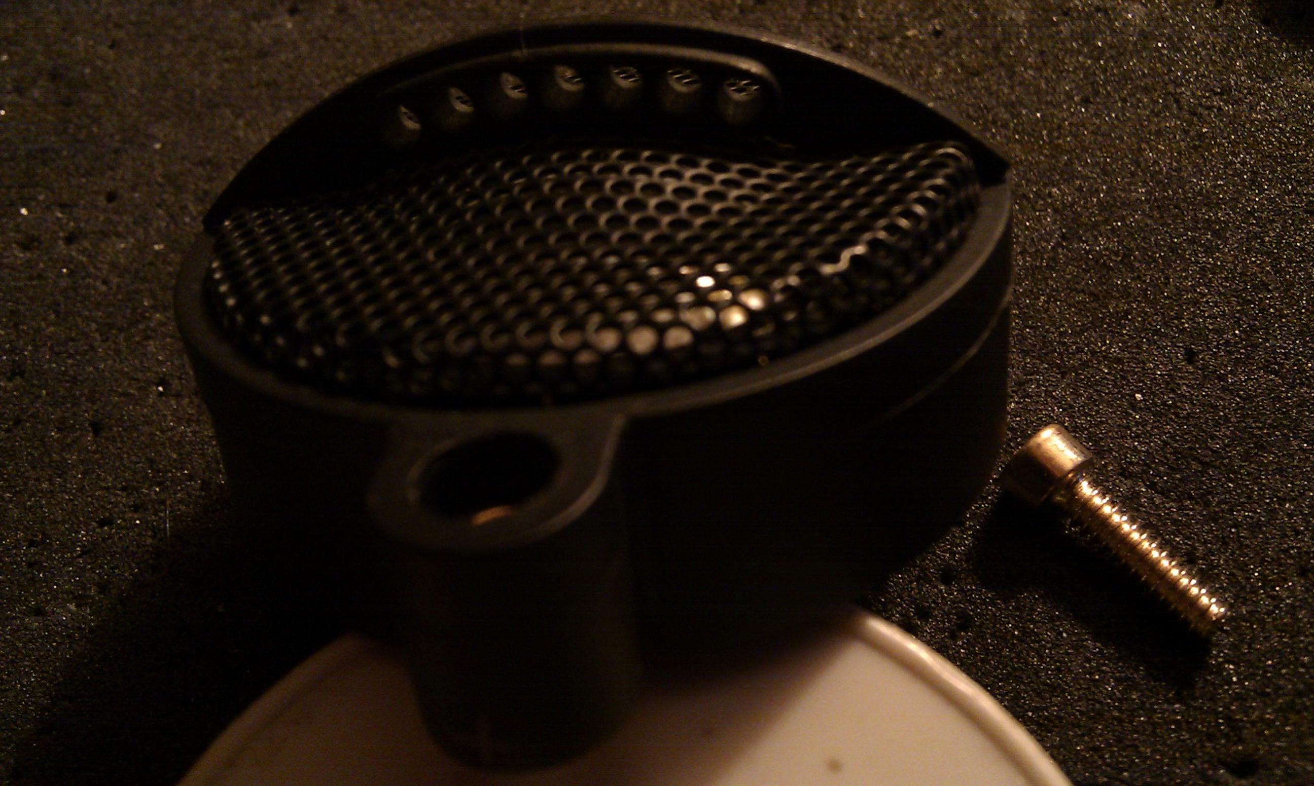

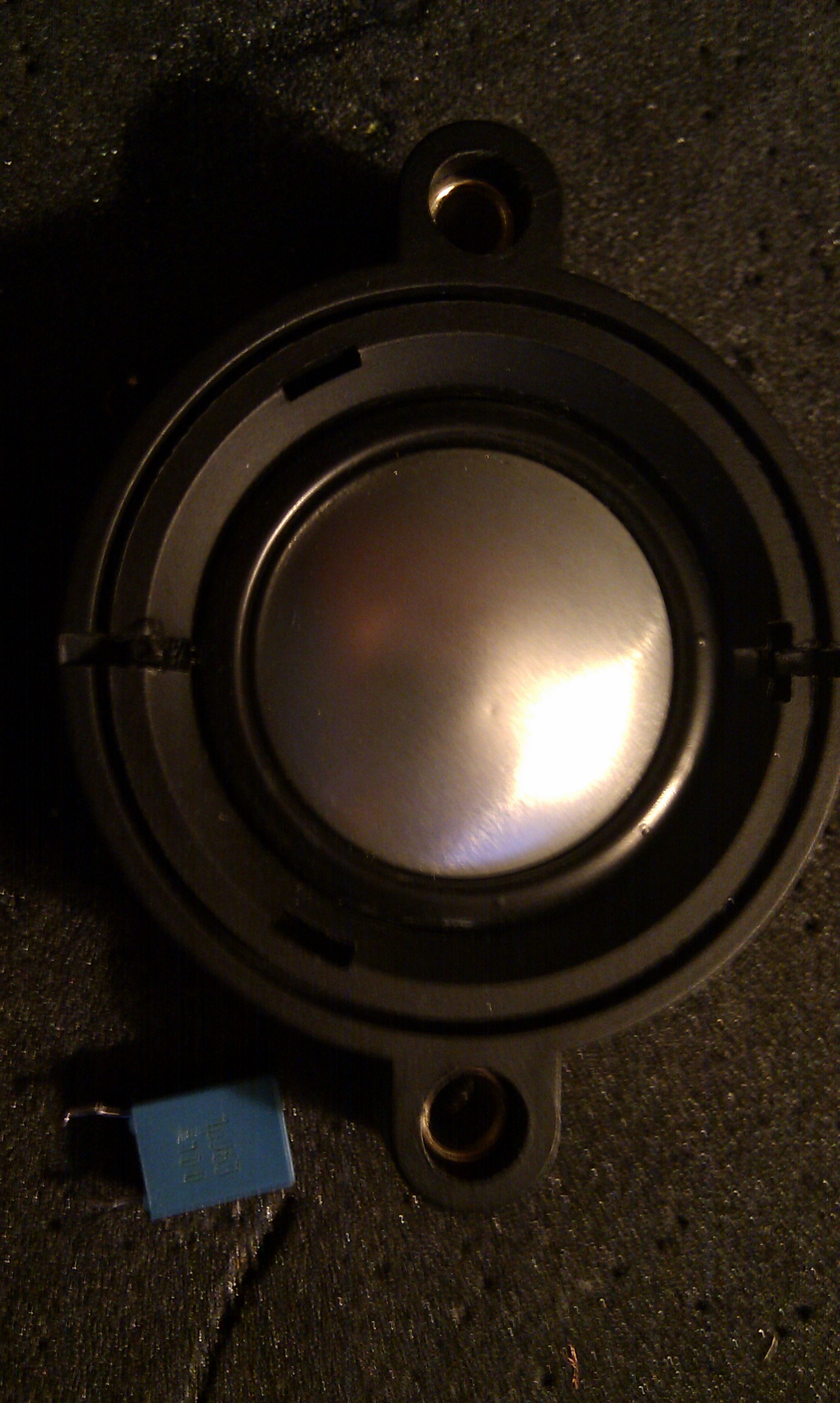

I saw Stereophile test, and the peak seems to beyween at 5k & 10 khz with peaks at 7Khz & 9-10khz. The measures below is by Stereophile with the Lynfield 500L in anechoic chamber. The crossover of the 500 have the same value : 125hz & 2600 hz & the sames drivers. It's worth to try cotton fabric to pad of above 4Khz as said in the threads but afraid of too much attenuation after 10Khz...a little test will say if good or not.
I need help please, what do you think: is it a good one to pad off the DB with a resistor in serie in front of the first RC (10homs//1uF) ?
Or do I have to work more with R2 in a L-pad... maybe a shelving filter (pit notch)with f1 at 6K f at 8K and f2 at 10K (but don't know what i need to calculate it?)
the last picture is : Boston Acoustics 500L, anechoic response on tweeter axis at 50", averaged across 30° horizontal window.

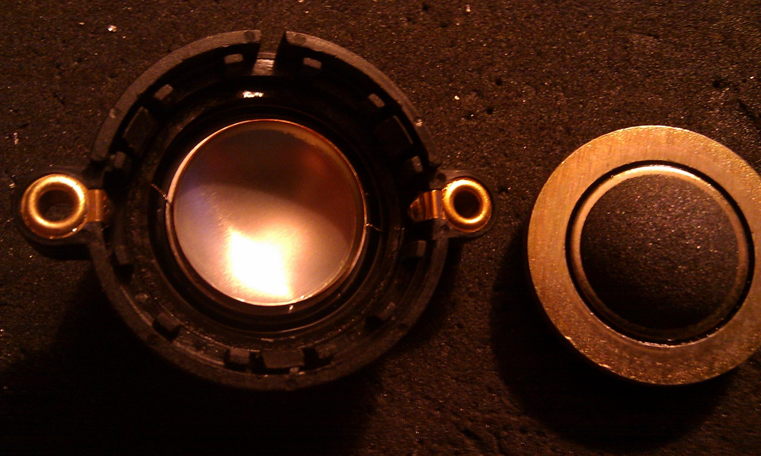

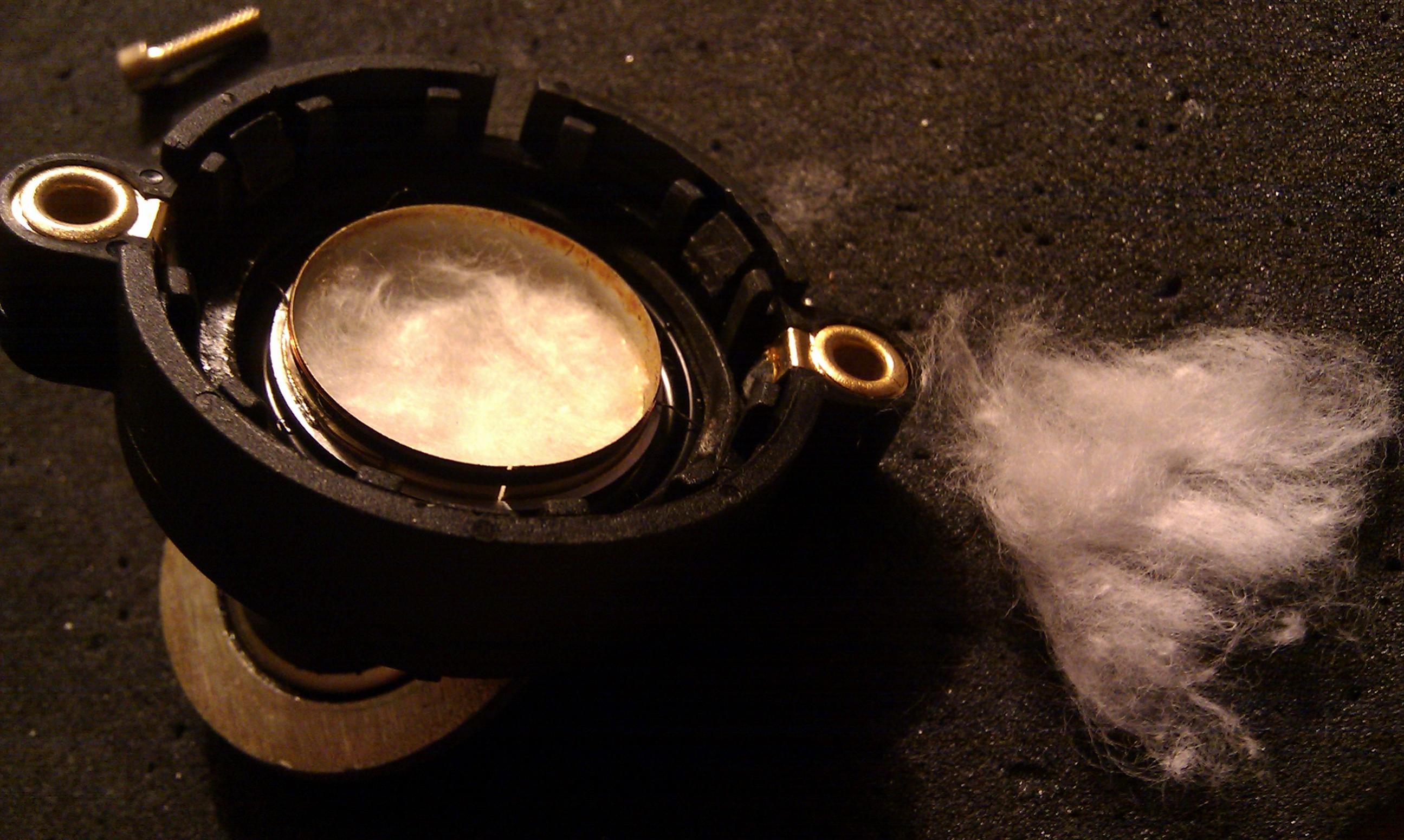

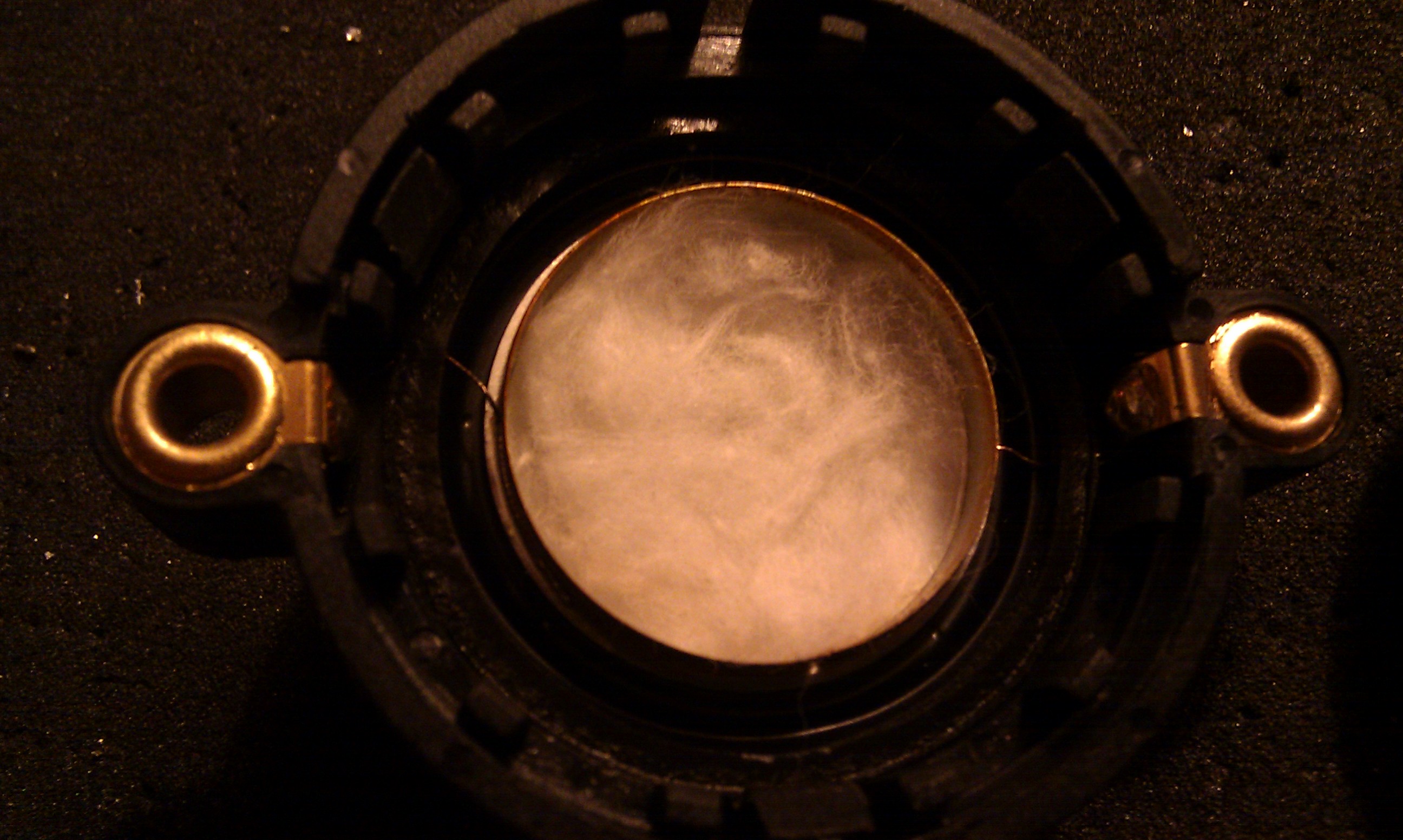

Have a very better result with 15 homs in serie without the C of the RC. So with 50% more R attenuation in treble (The 50% is my science side, for the Phi I'm still looking for, the presocratics books are usefull for bass trap or like the Husserls' ones...very large !)
I tried too the coton fabric t-shirt... not good.
But the treble is not as dark warm as the old beautifull kef ones !

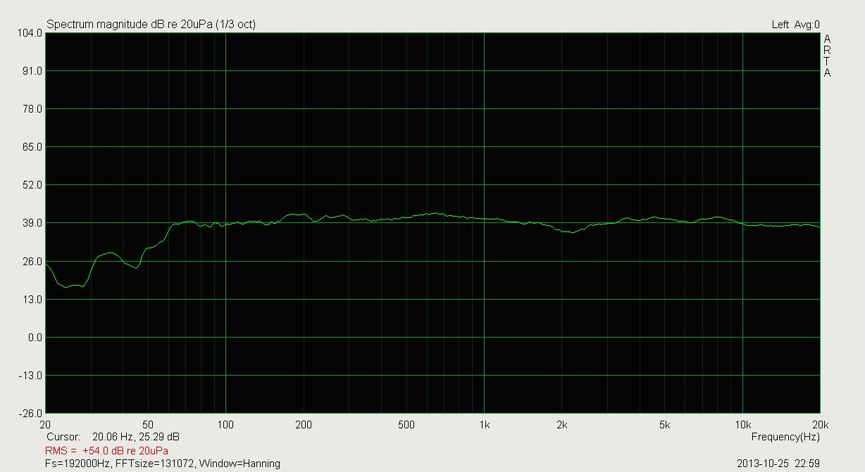

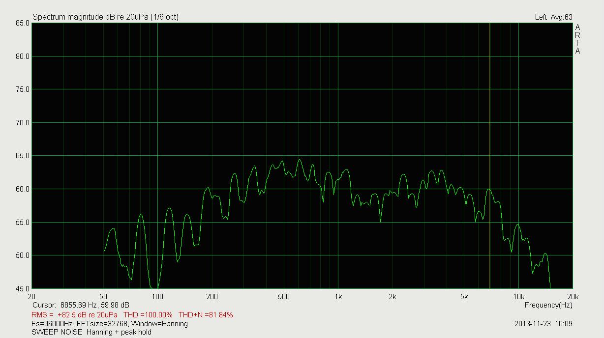

Pfff I continue,
great improvement : less peak energy, more natural sound, better articulation, warmer...come in mind
I come back to the 1O ohms resitor but non inductive. Give up the // 1 uF.
But just maid a Parralel bandpass notch after measurement. It showed something borring at 7 khz as said at Stereophile with the Boston Lynnfield 500L (same drivers but 2 cabinets... mine is a standalone cabinet)
Well, the Notch have a "short" bandpass -2.5db 6000 to 8500 hz, centered around 7000 hz.
0,05 mH//2,7 ohms//4.9 uf (3.4 SCR MKP-Sn//0.478 MKP Orange drops 716J // 0,1 Multicap MIT RTX)
the caps are choose for their quality to lower the harchness, it could be a MKT + the MIT RTX too... but details (that I can hear). The resistor here is cement to padd down a little the great pristin non inductiv 10 ohm from Mundorf.
Have to try 3.3 ohms cement vs non inductive. Have to persist with foam on the tweeter, now i know with the HOM in the Horn theory than open reticuled FOAM around 30 PPI (is the good word ?) can be find in Aquarium store...without the red fish on the speaker ! I'm still turning around this speaker !
First picture : silent room at 4 AM with own calib file for ECM-8000 give this flated FRD. Second is the 400L in my living room with log sweep sine from audiocheck website.

I had courage today and tried for the first time to open the tweeters, easier than I thought. The golden screws are used to give the signal to the driver. diameter of the alum dome is 2.5 cm and 3 cm took on the middle of the round rubber. it climbs at 30 khz but a mechanical notch trap makes a deep at something 21000 khz....
After some sucees with a passive short notch trap at 4000 it's better but some siblings stay; john Atkison measure on the Boston Lynfield 500 L (same drivers, same high pass Xover)) a flat peak between 5000 to 10000...
Is there a very little medical coton between the foam damping cone and the aluminium cone can paddle off some peaks between 5000 to 10 000 hz ? Maybe i can try to put a verry little peach of fabrik in the peak of the foam dome where the hire frequencies are supposed to beam from the dome side above ?
No danger with heat ? Bad idea ? I yhink there is no place for someting else than cotton or thin fabric sheet... Its impossible to have an idea of the gap between the dome and the foam dome absorber ! But I suppose 1 mm or 2 mm max !
Do I have to change the ferrofluid in the round interstice of the magnet where the aluminized dome repose ? The color of the fluid took on the interstice has a rusted color and is viscous when i touch it between my fingers: not fluid but i suppose this is normal with Ferrofluid ? It's far less fluid than food oil e.g.
On the last photograph, you can see the magnett with its circular interstice : it's a strong Neodyn which is able to move a 3.5" mid but here it's for a 1". Photograph n° 5 is inside the dome and the magnet with its icircular interstice where the aluminium cone is posed. You can see the reticulated foam dome for absorption... no chamber inside : it's plane beneath it...
Bad idea ?
