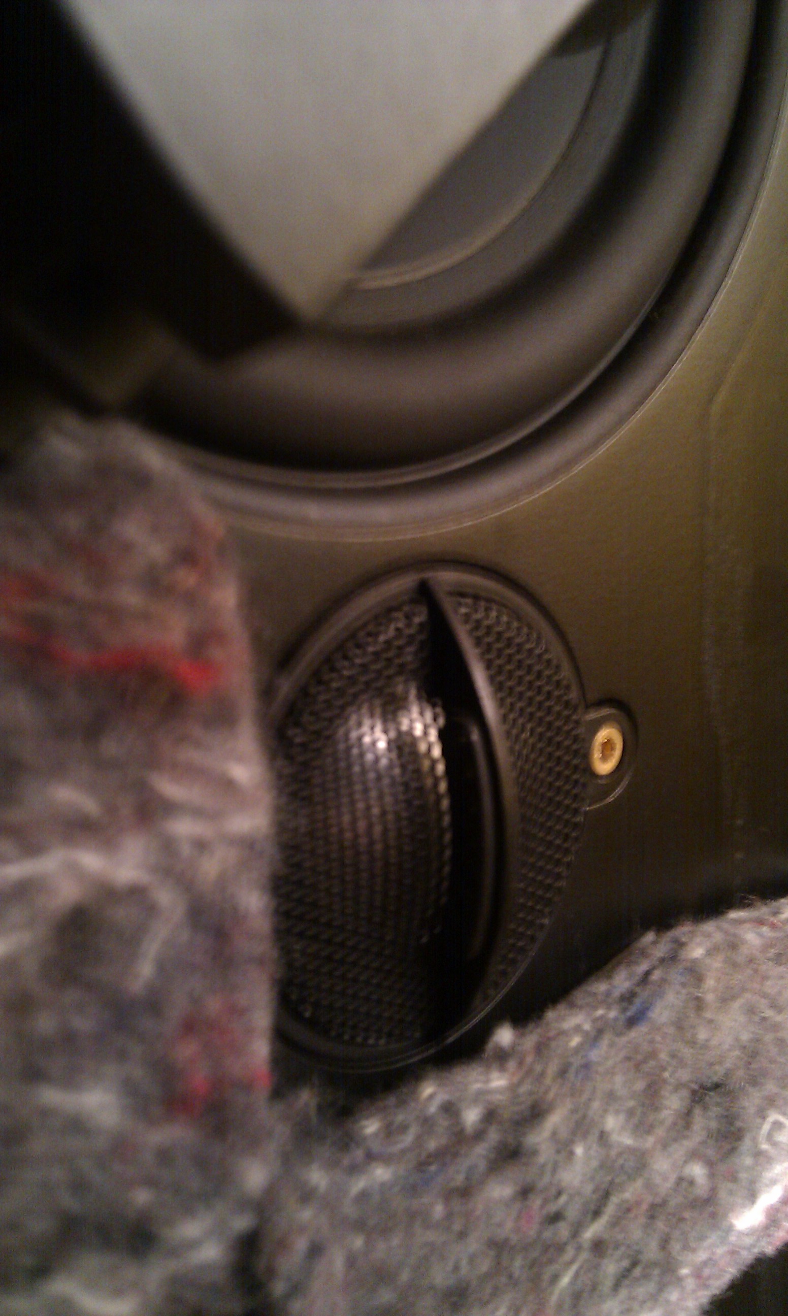

Hi greebster,

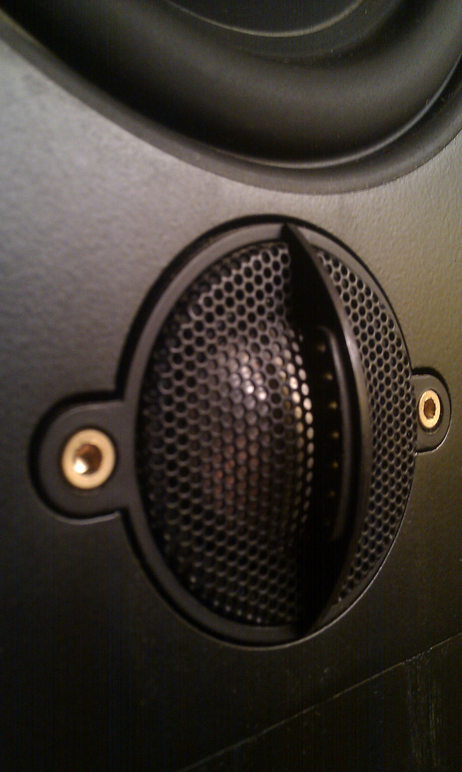

No, but it's an excellent idea ! Problem the tweeter is tied by behind on an aluminium plate... no screw in front of speaker (just two little but it's for the tweeter acoustic grill... yes the grill is here like the stick for the medium to avoid resonance but....).
I read somewhere that he is ferofluid damped not for temperature but for peak resonance ! 🙄.
I just listen Red Ant a song of the cool Olu Dara a blues man of NY City : the same here that the female voice problem is in the high pitched note of their voices : it's like it urts the ears with ice peak when there is attack of vocal ...don't know if it's harmonics but i surmise yes and i work on the theory given by gentle fellow here : around 5k to 6k Hz !
I'm sad because elsewhere this speaker is nice : amasing soundstage, very tansparent and rapid bass, awsome medium (125 Hz to 2600)
Beginning asking myself if tghe problem could be the medium... but when i bought them 16 years ago I had a measurement : flat between 100 to 15000 ! but was it the good one ?
Odd hobby that we have... but I like that ! When I switch on Kef 104/2 : less transparence but same soundstage without listening fatigue ?! Near the same configuration : the kef is 150 to 2800 with two 4" plastic dome working one a semi apollitto (one of the two doesn't klim higher than the other and is a renforcement for low frequency), the Boston is 125 to 2600 with a single aluminium 5.5" and 1" aluminium tweeter 2600 to 35000 (maybe for dogs who love music !) ; the low mid bass of the kek is amazing but the Boston acoustic goes lower and more transparent : you can hear that with bass string (Rostropovitch) or bass guitar (Marcus miller).
Unless it was majorly destructive I would pop them open and inspect.
FF is one way to dampen, but being that old may be part of the problem. As the oil ages it normally thicken changing the viscosity. Perhaps clean and replace while "under the hood".
It's a little too "Experts Boston" for me to inject new FF! But Yes it's an old speaker (89 build) and reviews already talks about this too heary tweeter (test of the 500L in Stereophile)
If you look at the picture before you see that the mid and the tweeter is on a one piece of aluminium glued or screwed by behind; No way to move it. behind there is a trap for the crossover but you can't see the medium-tweeter unit. I read a Lynfield lover thread and the man says that the suround of the tweeter has to be reburn after a non use period of 2 months ?!!!!! He founded that the Lynfireld build under licence in GB have an inverted crossover in the bass. It's a french, I send him an email but don't know if it's a tweaker like us.... I'm afraid not but I think he knows very well the Boston acoustics Lynfield serie.
I think the advice given here are sadly true : if I can't sucess with mechanichal filter which is try & fail method, i haver to sell them or go to a trap notch after measurement ! But I don't believe in my "amateurisme" to do that.
I continue mechanichal method step by step...funny !

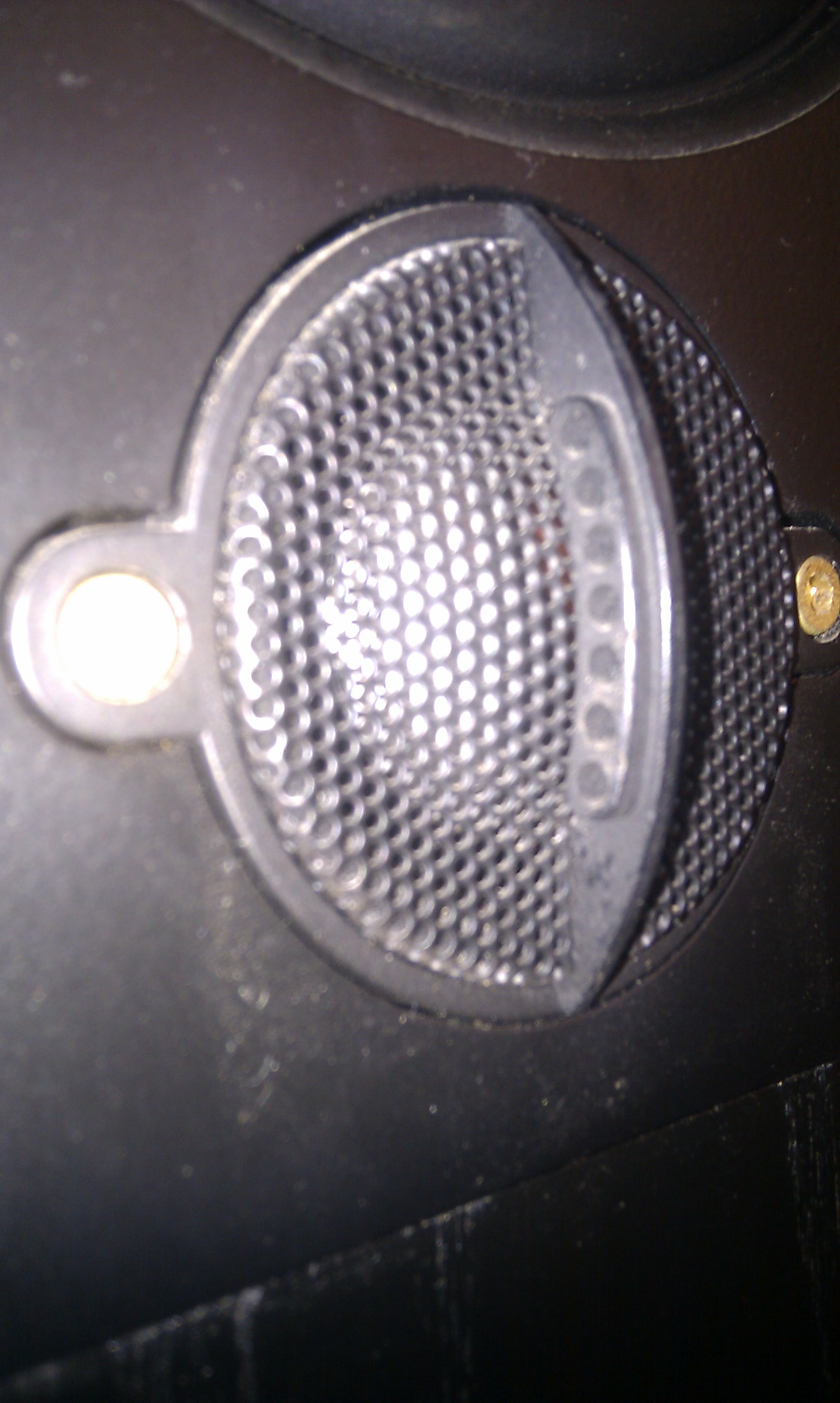

I don't know if you all realize it but the pictures shown are of the Lynfield tweeter from Boston Acoustics that is unique in having a built in notch filter. The bridge over the tweeter has some sideways holes that create a notch filter at one of the high dome break up mode frequencies. I think they got a patent on it. (A Phil Jones invention, if I remember correctly.)
I suspect that if you aren't happy with the frequency balance you want something that is a little more broad in effect. Whats wrong with trying 1 or 2 Ohms in series with the tweeter? (Or even tone controls)

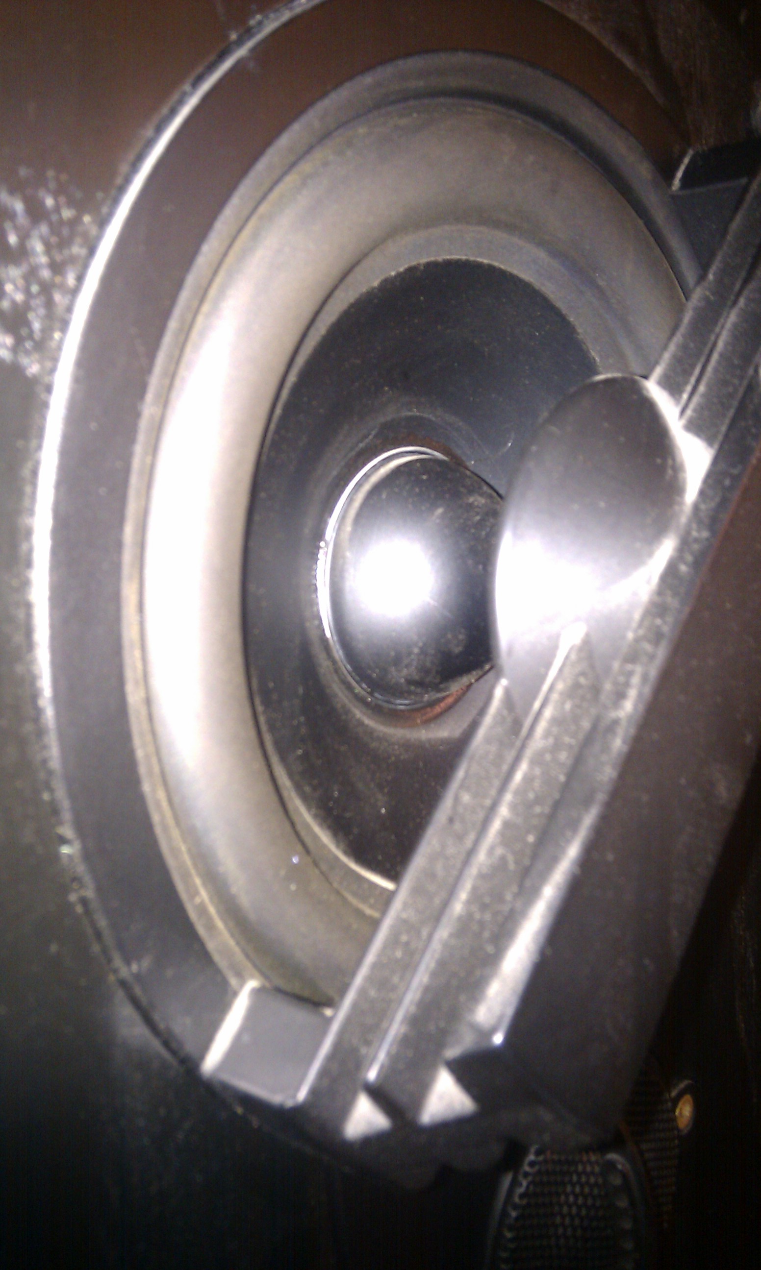

You can see the AMDs' filter
The mid is all aluminium...

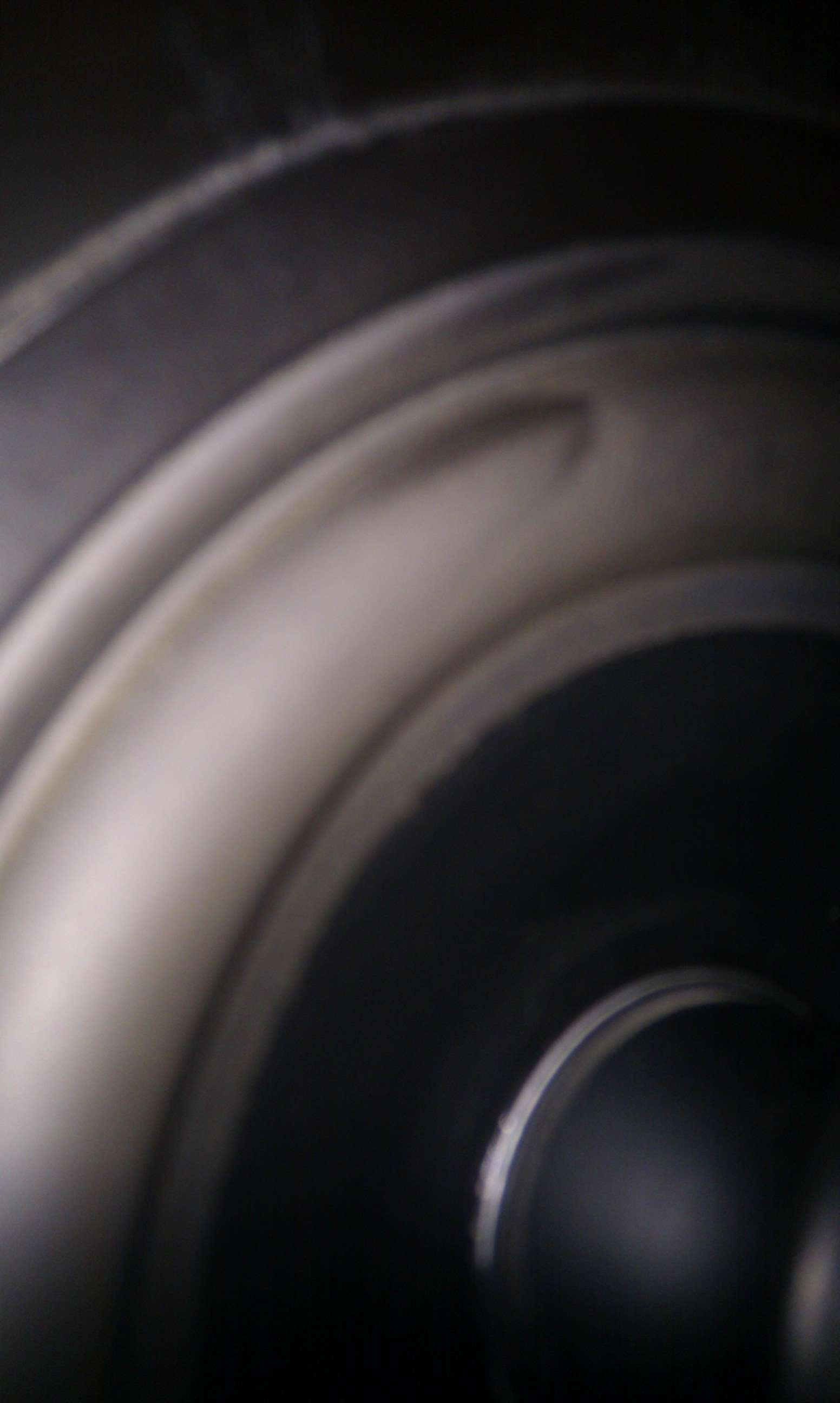

Look at the double rubber: the one outside is fix but as damping...
Very solid design : 20 years and the rubber are like new one !

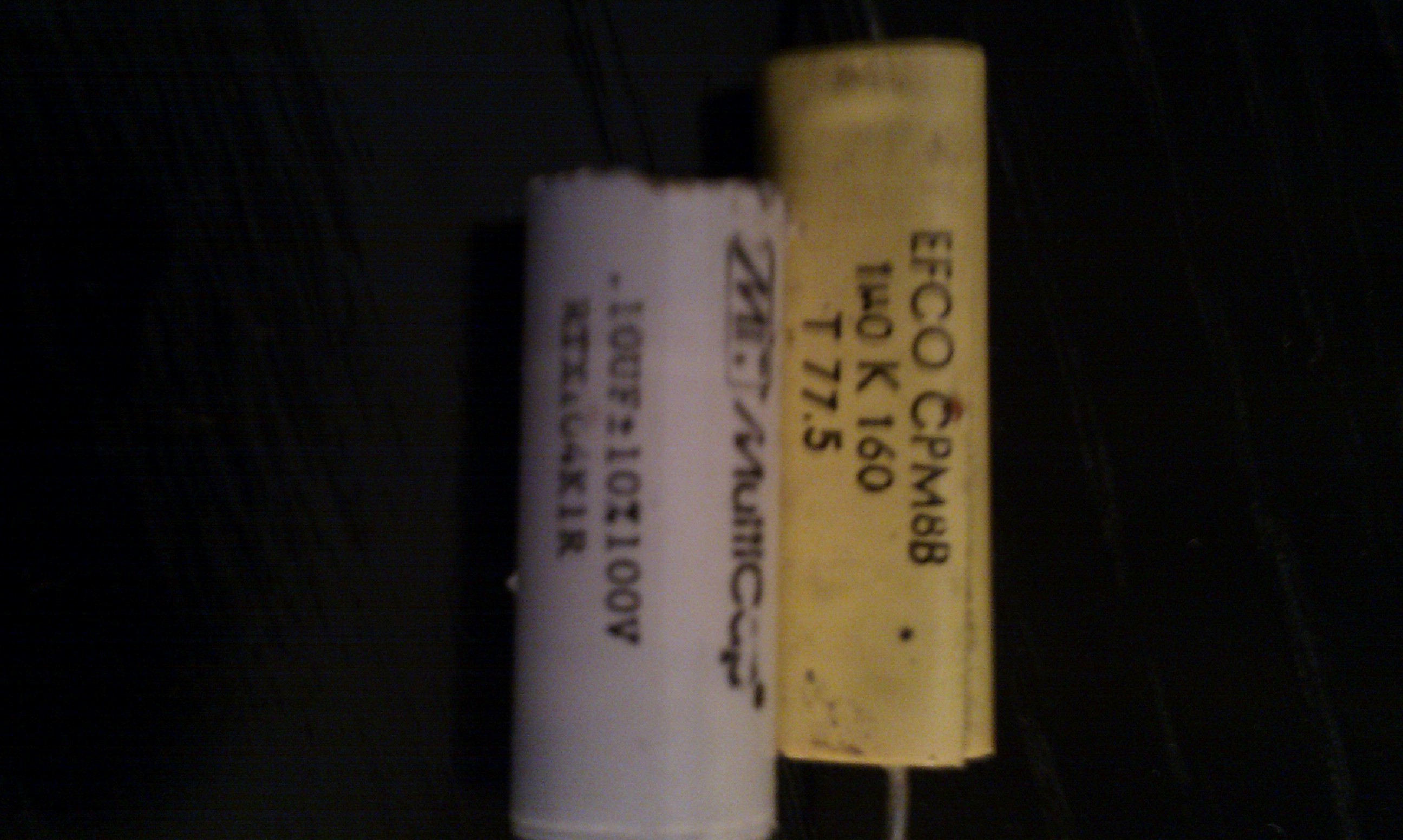

The yellow cap is the // with the 10 homs cement resistor at the beginning of the tweeter filter (The MIT i after in the two stages of the fourth order crossover). The cap is an Eurofarad (french industrial and spatial manufacturer of caps) polycarbonat with T option (metalized foil) very stable at change frequency.
yes I think Phil Jones know whta he done here but reviewers too : there was a second version of the flag ship boston 500 which use same units... maybe i read that the rubber of the mid was harder in the 500L than the one used in the 400L (myth?)

That 10 ohm resistor with 1uF cap stands out as a simple place to try tweaking things. Disconnecting the cap would reduce the higher frequencies. On the other hand if your issue is with the middle treble then increasing this cap might bring the upper treble into line if it is lacking, otherwise changing this resistance could be equally helpful in the ways already mentioned.
Thanks AllenB & SpeakerDoctors,
I will try this way.
I understood reading litterature than the 1 uf // with 10 homs do like increasing low frequency when the frequency curve dive. Did I missunderstand ?
hé hé I have to try all these things.

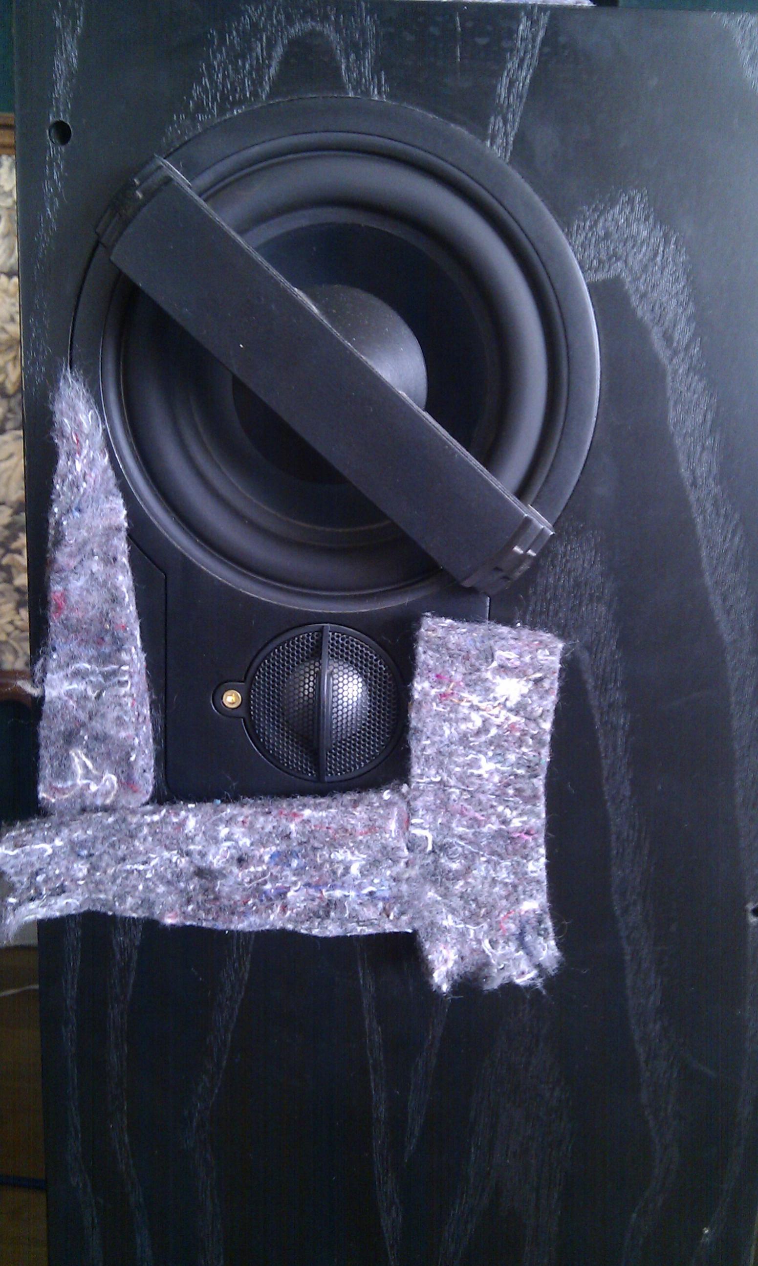

I have been cutting reticuled foam to put arround the tweeter. test tomorrow.

Yesterday evening, needled felt was tried before foam (the foam i have is open...but rigid : used into package for choc protection).

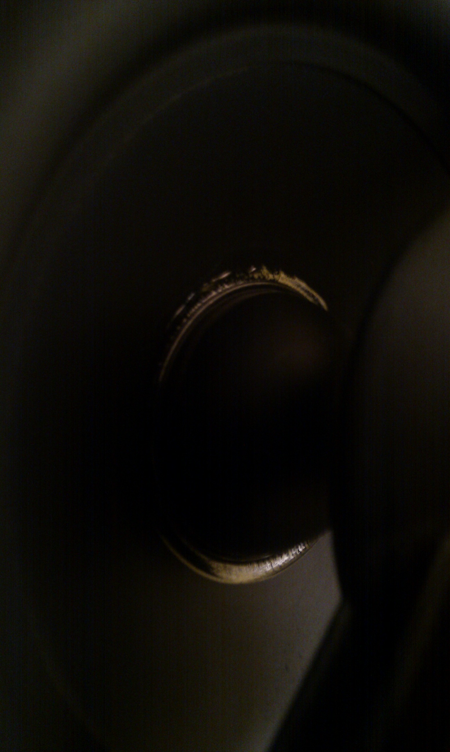

The mid seems indestructible, but maybe like it was said here : the treble has now a more viscous ferrofluid (dry). The french guy who has all the models says that it's a sweet speakers in the treble with fabulous mid bass and fast bass... I hears all, also the soundstage and the diseapper of the box (better with the toilett paper tip : image more on the center) but not the sweet treble yet...in relation to my beloved Kef 104/2... i 'm going to marry with these last one ! the little felt i added makes nothing (0,4" thick), but maybe too little and impossible to putt between the two drivers : lake of space !)
