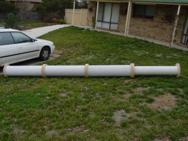

i wonder how close measurements like,at pipe end,will compare to at 1metre
its good that youve joined the flanges properly
What pics. Great project, Drew!

Yes, very nice boltable flanges and a good amount of building adhesive and surface area with which to join the flanges to the pipes.

Test Results from the front yard
Folks, I borrowed a 150w subwoofer "plate amp" and a cd of LF test tones from a freind and fired the beastie up outside this morning with a digital volt meter hooked up to read RMS voltage applied to the drive unit.
Feeding the cannon with a 100W (28v RMS) input and produced smooth, non distorted and non boomy bass in the range 60 - 25 Hz, 100w at 20hz is not especially loud and is beginning to ask more of the drive unit than it would like to give. 50w (20v)is a better limit for the 20Hz tone. still audible but not giving any hassles.
15Hz produces a most disturbing sound with extensive non linearity and higher harmonics other than the raw tone if the signal is pushed above about 10v RMS in. below that it's barely preceptible anyway so these's no point in feeding a 15Hz signal to it.
Maybe a more robust and bulletprooof drive unit could handle this better (Lambda perhaps?) i don't know.
Of course, continuous sine waves will be making life far harder for the driver than any regular signal would, so perhaps none ofthis will be a problem in practice.
this week I"ll mount the driver with just the 300mm pipes hooked up as a 1/4 wave tube and see how that sounds. More like Nelson's "El Pipe O". Could be that the extra tube is just causing hassles.
Time will tell, thought I'd give you folks some feedback anyhow
drew

DrewP i also noticed that the right quarter of you pipe (in the picture) ,which i assume is the length in front of the drive, is slightly thinner than the rest of the pipe, is there any reason for this?

To my mind, the longer the pipe the better. The only reason Bose can get away with the 12 ft pipe they use is by setting a limit of 25hz in their specs and using a significant amount of EQ. I expect this is the reason their driver can handle 500W. It has to.
If my original calcs were correct then a 5.25m pipe ought to give above 75% of the drive unit's forward output at 20Hz.
The 6m pipe gives 93% at 20Hz.
In practice i believe that the 5m pipe i'm using at present starts to both lose output and get below the drive unit's Fs, hence the limited power handling and reduced output below 25Hz.
the section of 250mm pipe on the short section is because that's what i had access to. No scientific reason and it was still large enough to fit the driver basket.
I'll probably do the 6m pipe in 250mm the whole length. It'll be easier to install in the roof.
Drew

Assuming that the driver is producing usable output at that frequency, then yes, a 6m pipe should give you good 20Hz output.
It won't be boosted 20Hz output, for that you'd need a pipe around 8m long.
Nonetheless, it will give you better (and significantly less delayed) output than a reflex cabinet would give.
I've yet to see a reflex cab tuned down around 20Hz with less than 30ms group delay. The long end of the pipe is only 13ms away from the rear of the drive unit so you ought to get subjectively pretty fast bass from the cannon too.
drew
