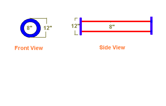

This illustration is something that might be used to fit a thinner tube into both sides of the Cannon.
Of course, if worse comes to worse, you can always cut some of the tube off, put a couple of vent holes in it, mount the woofer in front of one end, plug up the back end, and make it a reflex tube sub a la Hsu.
