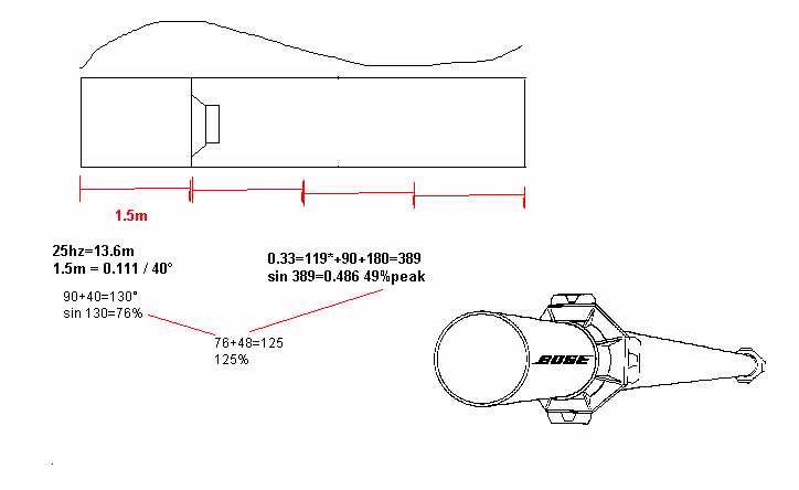

Agreed, I saw a picture of the wave cannon with a sine wave drawn over in red on the net somewhere.

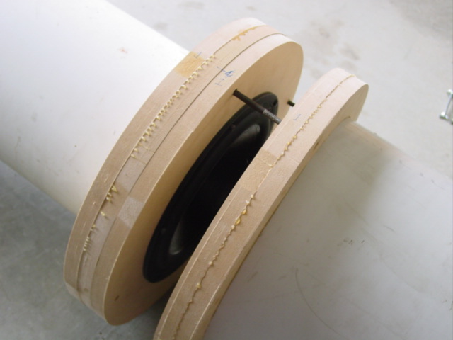

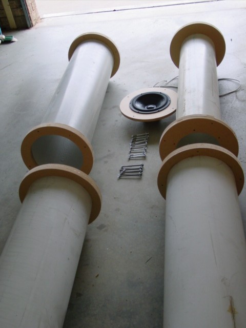

After a couple of weeks spent purchasing drivers, cutting pvc pipe, routing flanges from 18mm MDF etc and so on (work dramas not withstanding) today I finally got to run some test tones through the 5m long clone Acoustic Wave Cannon I've built.
Due to the "scrounged" nature of the parts incorporated, one side of the bass driver has a 1.25m long PVC tube that's 250mm in diameter while the other side of the driver has a 3.75m long PVC tube that's 300mm in diameter. No biggie it would seem, this design is pretty much all about path lengths and the proportion of a wavelength that they constitute (and how thay constructively combine with each other etc etc)
Bass driver used was a Vifa M26-WR-09 the numbers you need to know I guess are Fs25Hz, RMS power 160W, Peak power 500W and Sens 88.5dB (although in the low end where it's being used it's closer to 84-85). Can't recall the Qts but it's on the low side so things are pretty nicely self damped. No nasty "high excursion walkies" to be had.
A patient friend and I wing-nutted the sections together diagonally across my loungeroom today and hooked the driver up to a subwoofer amp of indeterminate specification (Jaycar specs are funny amorphous things sometimes) and fed the beastie with a series of test tones from 100Hz down to 10Hz.
I don't know how much power we were putting in and without knowing what (if any) eq was inherent in the circuitry of the sub amp I can't give you any idea of response flatness, I can tell you that we got tones that were cleanly audible to a level beyond what my house would tolerate.
Output from 100Hz down to 60ish was pretty normal. Below this we dropped the volume as the light fittings, sliding doors, windows, ceiling and plasterboard walls were joining in the fun.
Nice strong output was available down to 25Hz (house antics aside) with no evidence of doubling at all. I have to say that at this frequency we were beginning to get into the "bass you feel" region more than bass you hear and the house output was overpowereing the sub output.
Winding the wick up a little gave clean audible 20Hz and a decent impression of 15 was even on offer. Without knowing how much power we were applying (or what the house would take) I had no intention of pushing my luck.
The upshot is:
There's nice output from 40-25Hz where many normal speakers (and the lion's share of subs) are producing almost nothing .
Will i bother applying eq to bring the 20Hz section of the passband up to the same as the 25Hz (around a 10dB boost req)? I dunno. That would allow me to play a 90dB 20Hz tone with input power of around 100W. Personally i doubt the house would stand it anyhow and I'm more tempted towards subtle bass you notice when it's turned off than obnoxious bass.
Anyhow, I promised you folks some results and they are that the beast actually works. Having never heard anything producing 25hz in a pipe (or for that matter 25Hz most other places either apart from thunder) I can't say how "in a pipe" sounding it is. ....Didn't seem very pipe like.
One thing I will say, once you take away the flutter, port noise, box honk and so forth, these very low frequencies are kind of unimpressive in their impressiveness. Maybe it's the suff that's normally present that makes you go WOW! If it weren't for the output from the house I'd call the results subtly impressive.
As it is I'm just glad my wife was interstate. 🙂
For a first attempt I'm most impressed.

Drew has plans to post pictures but first will need to get digital camera from work (not till i'm well again, bloody Flu!).
Of course i need to figure out how too, I'm assuming i put the file on my machine and just stick its file name in "attach file"

cannon
if it was filtered low,probably it wil sound abit better,since it wont ahve a chance to distort the 50hz signals,which wil have higher harmonics i n the 100hz+ range,
where as 2nd and 3rd harmonics if they occur ,on a 20hz fundamental,are just 40hz and 60hz noises😛
there is no free lunch 😛

this image is just the cannon with some notes that another guy posted around it...
i want to know how music sounds lol,and is it jsut easier(and shorter) to make a normal tline,i was reading they roll off at 6db/octave around resonance ,but they are a few mroe db down there,than portedbox...audioasylum posts that is..
The whole sinewave and tube diagram is on the right track visualisation wise but where you cross form the front to the rear of the drive unit you need to flip phase by 180 degrees. Neg peak on back of sine wave, not positive peak on both sides.
The dips i expected were not overly apparent, will need to do more testing in free air before i can give an appraisal of actual freq response.

the sinewave was just a doodle until i know how to really put it properly how u say lol
can one model a cannon with the mathcad tline files? i dont think you can do 2 seperate lines at once
