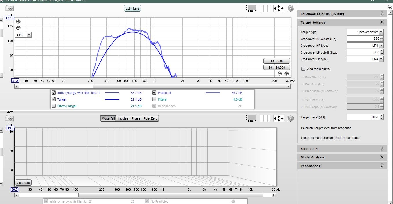

Unfortunately I have not learned FIR fully yet, the recording is from miniSHARC filter. I later found out that the test does not reflect reality because I have a baffle step slope of 0.5Q, which should drive the phase wrong further? and also a standing wave cut.
One should be able to enter the settings in FIR without measuring? type in from whatever settings is in SHARC and flaten the phase (does not have a good mic and room for measuring).
Group delay I usually measure with DCX2496 and a mic that I connect temporarily but had no xover delay compensation in the recording.

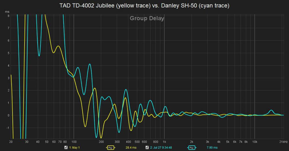

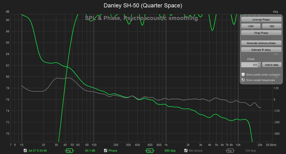

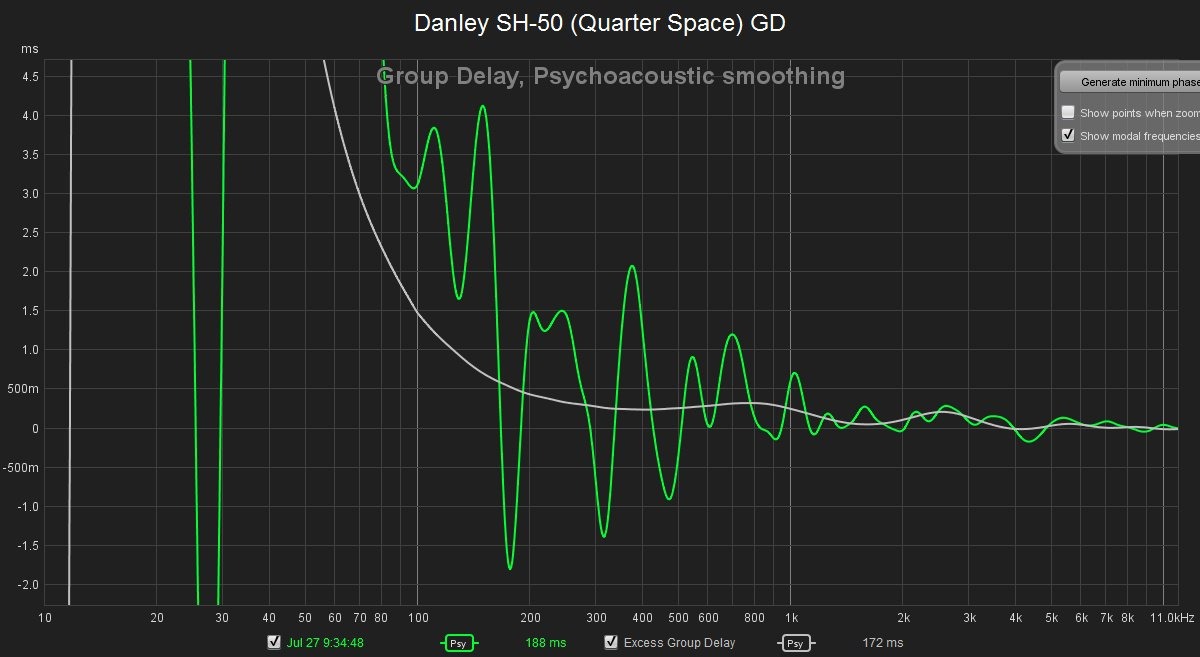

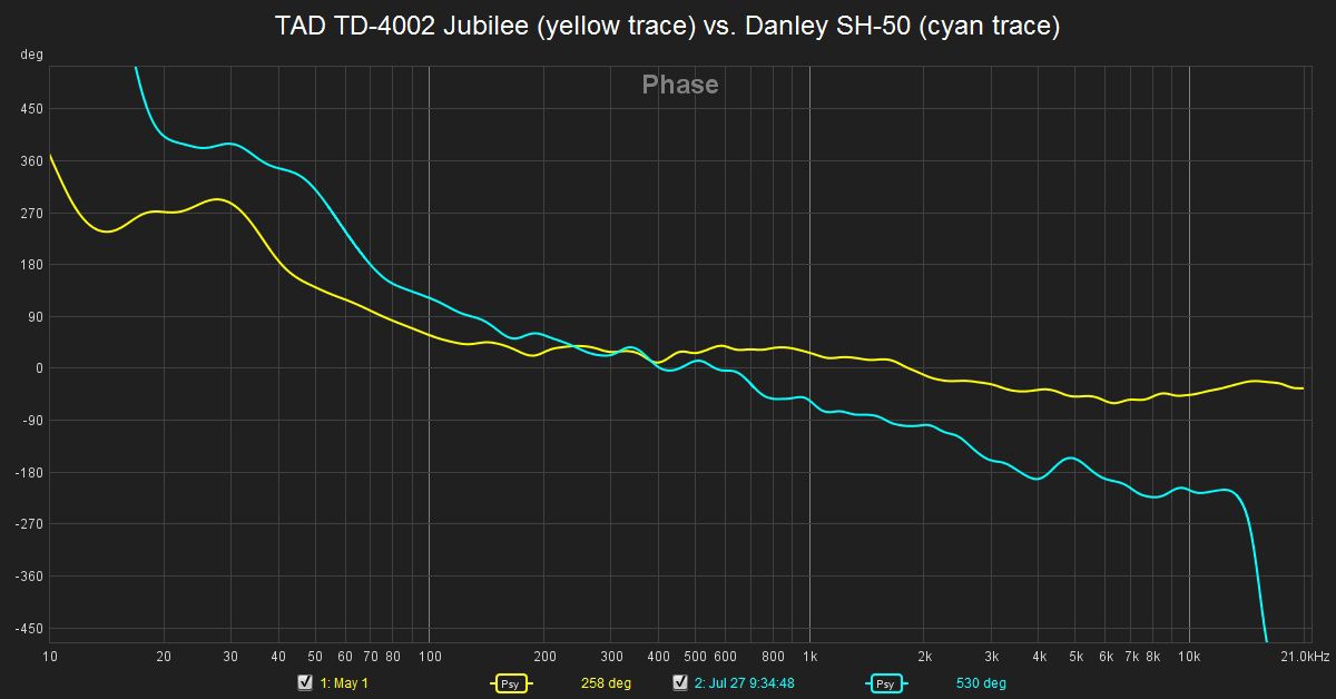

Here are my measurements of the SH-50 phase (total and excess) and group delay (total and excess), showing that the effect of bass reflex excess phase growth below ~120 Hz, and woofer-midrange crossover network excess phase growth at 500-800 Hz:The phase-rotation of the DSL SH-50 over it's rated -3dB pass band is 720 degrees, equivalent to 8 "poles" (6dB crossover filters) or two "trips around the globe" .
Some of that phase rotation is inherent in the bass-reflex ("phase inversion") alignment, Fb (box tuning) at around 90Hz.
Reproducing a reasonable facsimile of a square-wave-signal requires smooth, not flat phase response
Note the magnified vertical scale on the group delay plot showing 500 µs resolution. The excess group delay shown here says that there is almost no all-pass behavior of the two crossovers in the SH-50 that is traceable to the passive network (all "IIR" filters).

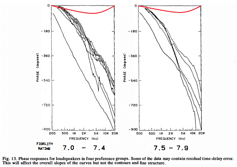

For a comparison to typical store-bought loudspeakers, here are the plots from Toole ("Subjective Measurements of Loudspeaker Sound Quality and Listener Preferences", JAES 1985) showing the relative levels of phase growth that is tolerated in most passive networks:
The red curve in each plot represents the measured phase response of the TAD TD-4002 Jubilees in my listening room that use only IIR filters to flatten SPL response. Note the lower frequency limit of 200 Hz as plotted, not showing the dramatic rise in phase response due to bass reflex ports.
Here is a plot of the Jubilee vs. the SH-50 for reference:
This has been my experience also. As long as the response is all minimum-phase, I can't hear a difference (except as bass frequencies below 100 Hz) which is, I believe, the punch line to all this. Just avoid all the all-pass behavior of the crossover filters and physical alignment mismatches of the drivers to each other (time/phase alignment at the crossover interference bands within 90 degrees of phase), and more than 99% of the desired sound quality will due to these factors will be achieved.Not to dismiss the ultimate sonic superiority of FIR over IIR filters, but I can't hear any difference between a flat frequency response loudspeaker with 720 degrees of smooth phase rotation through its pass band compared to one with with no phase rotation.

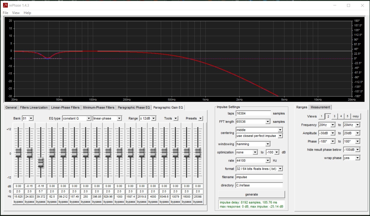

Concerning Rephase, can i just type in my values from miniSharc and press generate? It feels like risky waters when zoom is called views and one have to handle IEEE 754, floats, wraps and so on 😎
And why does not miniSharc offer linear phase eq and LR? it costs money and Rephase can offer it for free.

This is a great analysis. Testing/tuning my SH-50 clone lead to having a very narrow freq band for the mids and a lot of overlap with the bass and highs. I did get better square waves using higher order cross overs on the bass LP and High HP. The Danley synergy design is a work of art.You do know that high order crossover filters are not necessary in an MEH, right? And only enough phase delay is needed in the crossover filters to put the lower frequency drivers in phase with the high frequency ones. By definition...that's first order.
Polar lobing is not an issue in an MEH and so the root reason for using higher order filters is not an issue for MEHs.
Most people also do not understand that the Danley designs do not use high order IIR filters, because there is no need for them in a horn that achieves "unity summation" of the polar acoustic output internally.
For instance, the SH-50 uses a "phase link" design--with the midrange covering only <1.5 octaves, but is there to spread the acoustic load to support higher SPL operation, and to link the phase of the woofer to the HF compression driver. Significant overlap of driver output exists between the driver sections in the SH-50.
