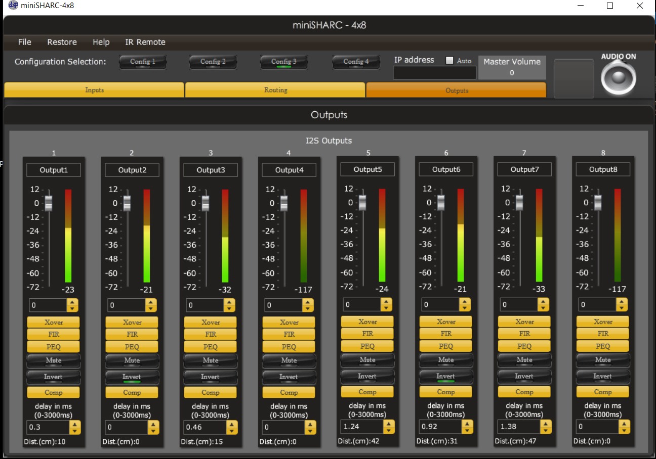

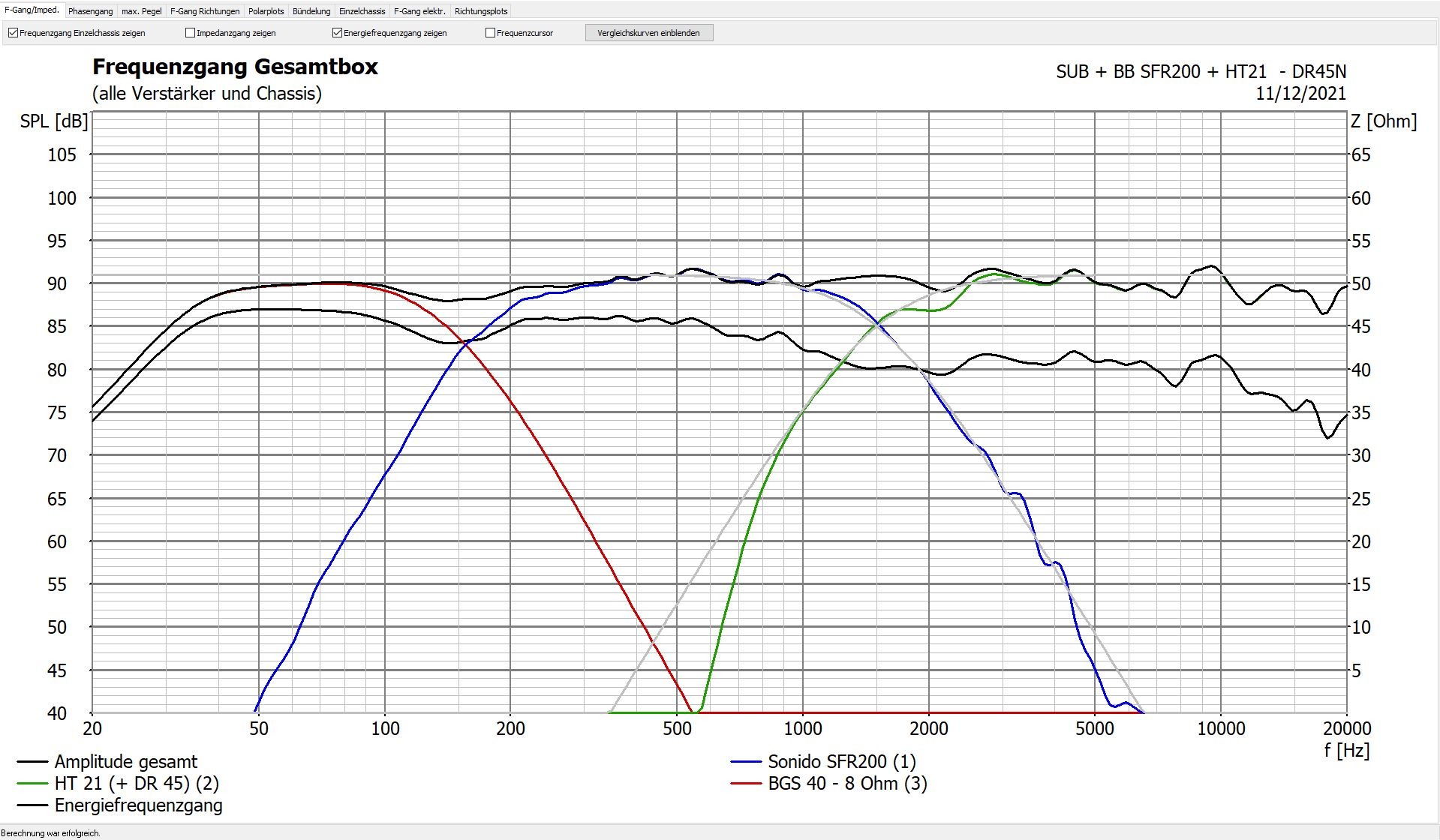

I have played a lot with simulation software - a quite simple to start one - BoxSim from UweG.
The problem is that you have to start with the measurement files of the Visaton drive units - the new one with the 19 measurements in 5 degree steps.
I have tried for comparison reasons also VituixCAD 2 - it is much more effort to get a first result with this software.
With BoxSim it is much easier to learn how an active crossover works together with the frequency behavior of the driver itself.
Here a small example how it looks like - sorry for the text in German, i think you can turn the language to english:

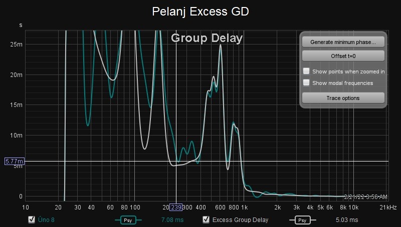

May I ask you to look at this measurement? It is in room with a crossover somewhere around 1 kHz (I do not remember which version this was). Could you please comment on this measurement pointing out what is wrong? Or if this kind of measurement is even usable for anything?
You've got almost 6 ms of delay on the lower frequency driver...
I recommend cranking in about 5.7 ms of channel delay on the higher frequency channel, i.e., the AMT-1.
That's quite a lot of--almost 2m of acoustic offset of the two drivers. What order of crossover filters are you using?
In an MEH, the woofers should lead the HF driver by 90 degrees if no crossover filter is used, not the reverse, and not by that amount..

This is actually funny. When I try dual channel measurement with no crossover (maybe I forgot to turn off the Mid highpass at 300 Hz), I measure the AMT around .5 ms "closer" to the mic than the mids. But it seems that the Behringer soundcard is not really good for this, I get multiples of 1 kHz peaks in distortion and some other strange stuff. It is slightly better when using the ASIO drivers instead of standard windows, but still strange.
The measurement above was made by UMIK, the filters were all LR24, mids - 300 Hz HP, 1000 Hz LP, HF 1000 Hz HP - the 1 kHz crossover point can be actually a bit lower, but I think it is exactly at 1 kHz in this measurement. Now I see there is also the midbass unit included, which is a 12" bass reflex with 300 Hz LP and 120 (or 140?) Hz HP. That one is not in the horn. The horn contains only the AMT and mids (2x 3FE22).
I think I need to start from the top, just the crossover between AMT and mids. I will try to do some better measurements tonight (I failed yesterday in Win, need to do in Linux, but there I can only do with UMIK). AMT only, Mids only, then both together without any filters or delay.

That sounds like a good place to start. The VHF sets the timing refence, and then work down the ladder.I think I need to start from the top, just the crossover between AMT and mids. I will try to do some better measurements tonight (I failed yesterday in Win, need to do in Linux, but there I can only do with UMIK). AMT only, Mids only, then both together without any filters or delay.
I'd get your dual channel with loopback running. Measure the AMT's TOF, and set that as the Delay for the measurement such that a measurement shows zero delay when taken.
Then measure the mids raw, and the Delay shown will be very close to the distance between acoustic centers.
I agree with Chris regarding your posted measurement, and also his comments about not needing a 4th order xover with a MEH.
If you use either a 1st order or any LR between the AMT and mids, the timing you found above process, AMT vs mids, will be the Delay you need to put in your processor. No need to account for any xover induced delay then. If you use something non complementary, then additional delay finding may be needed,

I made some proper two channel measurements and the results are much better now. Good news is that the ECM8000 with UMC1820 works on Linux. The only problem is that the measurement is clipping as -57 dBFS (some Linux driver issue/setting I guess), but I got pretty good results for now. Still not perfect, but much better than before.
I have another question. How to choose the HP slope for the HF driver not to overload it with low frequencies? First order would work for low volumes, but most loudspeakers use 2nd or 3rd order there. But that means inverting the phase for 2nd order, correct? Or is that compensated better with delay?
And a second question - in REW, should I watch the (generated) minimum phase?

This isn't a simple question to answer for myself. I will refer you to Mulcahy's write-up on this subject, which is better than a "sound bite response":And a second question - in REW, should I watch the (generated) minimum phase?
https://www.roomeqwizard.com/help/help_en-GB/html/minimumphase.html
In general, it's faster to look at excess phase and excess group delay plots (the difference between the minimum phase and total phase, etc.) to see what you need to know, but there are some cases where you need to see the minimum phase plot--especially as you start to EQ at midrange and lower frequencies--toward the roll-off portion of the SPL plot. Flat portions of the minimum phase curve tell you that (generally) the driver is still in a good region. If you're looking at excess phase and it's not in a flat region chances are that you're trying to EQ something that's really the result of room (or internal loudspeaker/driver) reflections.
Chris
You can also use PEQs (large attenuating ones in the stop band below the crossover interference band) and shelving filters (negative slope looking toward lower frequencies, or positive slope looking from the LF stop band) to avoid the phase shifts of the "named" crossover filter types....How to choose the HP slope for the HF driver not to overload it with low frequencies? First order would work for low volumes, but most loudspeakers use 2nd or 3rd order there...
The way you can tell if you need to increase the effective high pass (combined) filter slope is to run the driver at 110 dB and look at the non-linear distortion. If you've got a problem, you'll see it there. Generally, modulation distortion will go as the harmonic distortion goes, so using HD is a way of seeing MD--which is the problem that I can hear (i.e., lower order harmonic distortion is generally not audible, but the modulation distortion it causes is audible).
