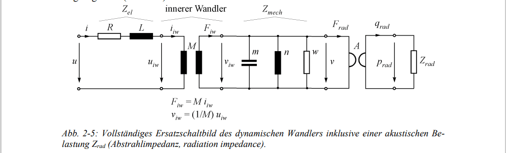

I think the modern approach with active DSP crossovers is completely different than what Duelund and other folks have done in the past. The mathematical approach works only with a lot of assumptions that do not fit reality. Look simply at the substitute circuit diagram for a speaker here:
Sorry for posting with German, i did not find any other picture real quick.
If you try to take all things into account the transfer function of the electrical filter and the speaker together is so complex that it get nearly impossible to calculate.
The modern approach is to automate the process of the large number of iterations to find the best settings with try and error. This is what room correction software can do, manually it will take a lifetime of listening tests to do this.
Some folks are better than other to implement a system intelligent enough for this kind of approach, from what i have heard these guys know really what they are doing, but the devices are not really cheap...

I have no money for such an intelligent correction system and take the time to do the iterations manually with a reference system on my desk with a nearfield monitor subwoofer plus satellites setup with Genelec speakers that are known to sound very clean for sound engineering purposes.

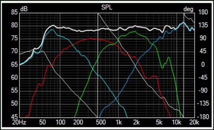

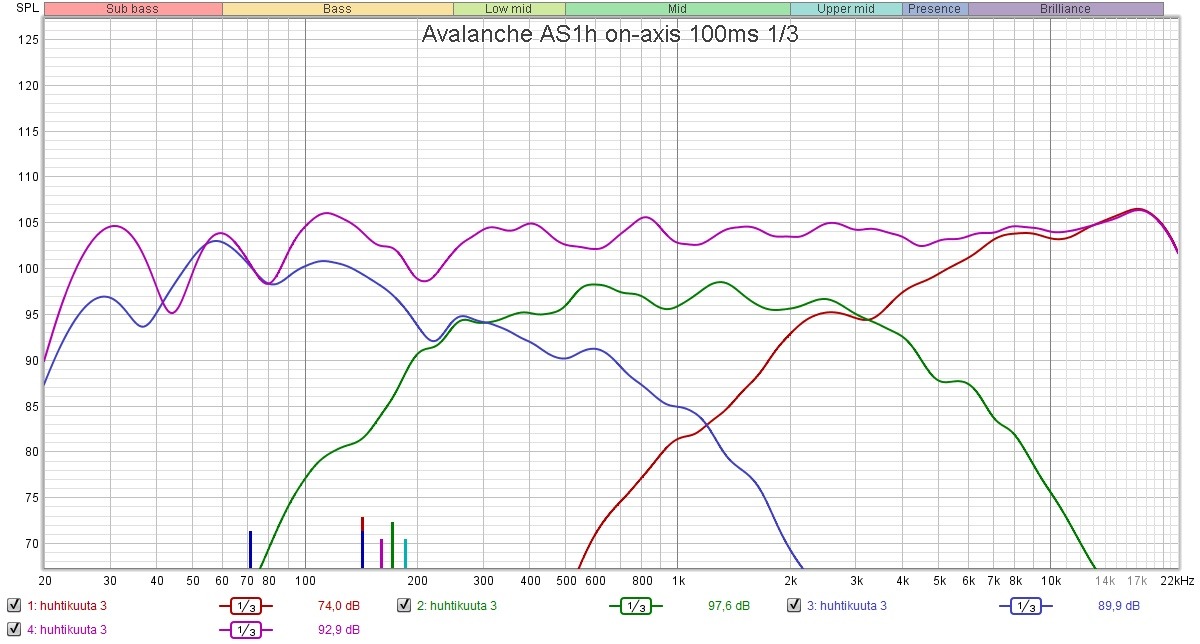

I am planning to add a midbas to my system (using a digital filter) and have simulated the result, is this a bad idea?
I see no radical problems in my simulation. Any thought?

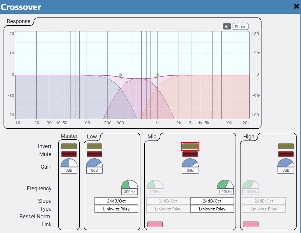

The topology issues come from multiple filters overhang into the same freq range.
Iow, the xover regions have more than two players involved. This occusr with both phase rotation and magnitude.
You can see the dip in mag from 4th order LRs at 300Hz and 1 kHz here:
If you were to spread the xover points out further, to say 300Hz and 3 kHz, you wouldn't see the dip in mag.
But in a 4-way, i guess it's about impossible to spread them all out so there's no overlap.

Maybe I am overlooking something, but I don't really see why that is so different than an all LR2 3-way crossover. According to the step response, tweeter comes first, with negative polarity, then midrange with positive polarity, lastly the woofer (probably swamped by room acoustics to produce clean step at the mic) with negative polarity , same as an all LR2 3-way.Duelund (3way) topology is nice and what I like to get - and rather easy with dsp . Basically elliptic acoustic responses and woofer and tweeter should sum well too, that's the point. Mid fills in that gap and sums with woofer and tweeter, with inverted polarity. It sounds better to me than all-LR4, which has more excess group delay.

Maybe not but you posted the right link where Linkwitz explained it above.You can see the dip in mag from 4th order LRs at 300Hz and 1 kHz here:
I'm really not the right guy to ask about IIR xovers...
In the 300Hz and 1K case a level increase on the mid would fix most of it at least in real life where things are not as flat. If that is not enough an all pass filter of the right type has the same effect as the cascading does on the phase response.
Raise the level of the red driver and drop the level of the green in some combination and most of the difference will go away.Mark, i think i can notice some of this effect between 850hz and 4300khz in my current 3way setup.
If you see the scale in Linkwitz's graph the residual ripple after level correction is less than 1dB, not a major issue in a live setup.In pro audio for live music, i have never heard of this problem, they use 4way and just hook them LR4's up, and flip.

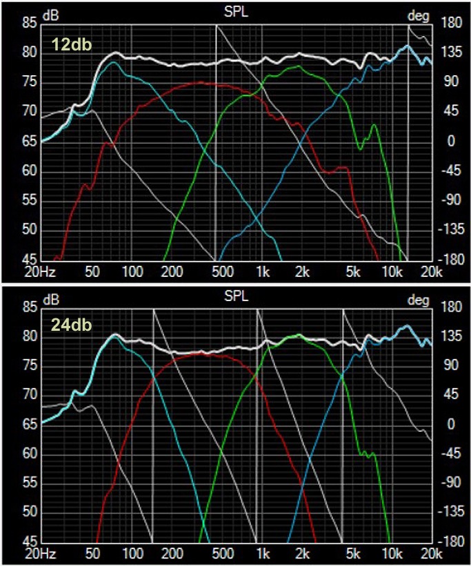

I compared my simulation in vituix and one can see that 24db would benifit from FIR.
it would be interresting to flip between flat phase preset and standard LR24, but one has to take into account that it takes 8sec to load the memory, maybe too long to hear audiophile differences.
There is a lot that could be altered with level and EQ regardless of IIR or FIR.I compared my simulation in vituix and one can see that 24db would benifit from FIR.

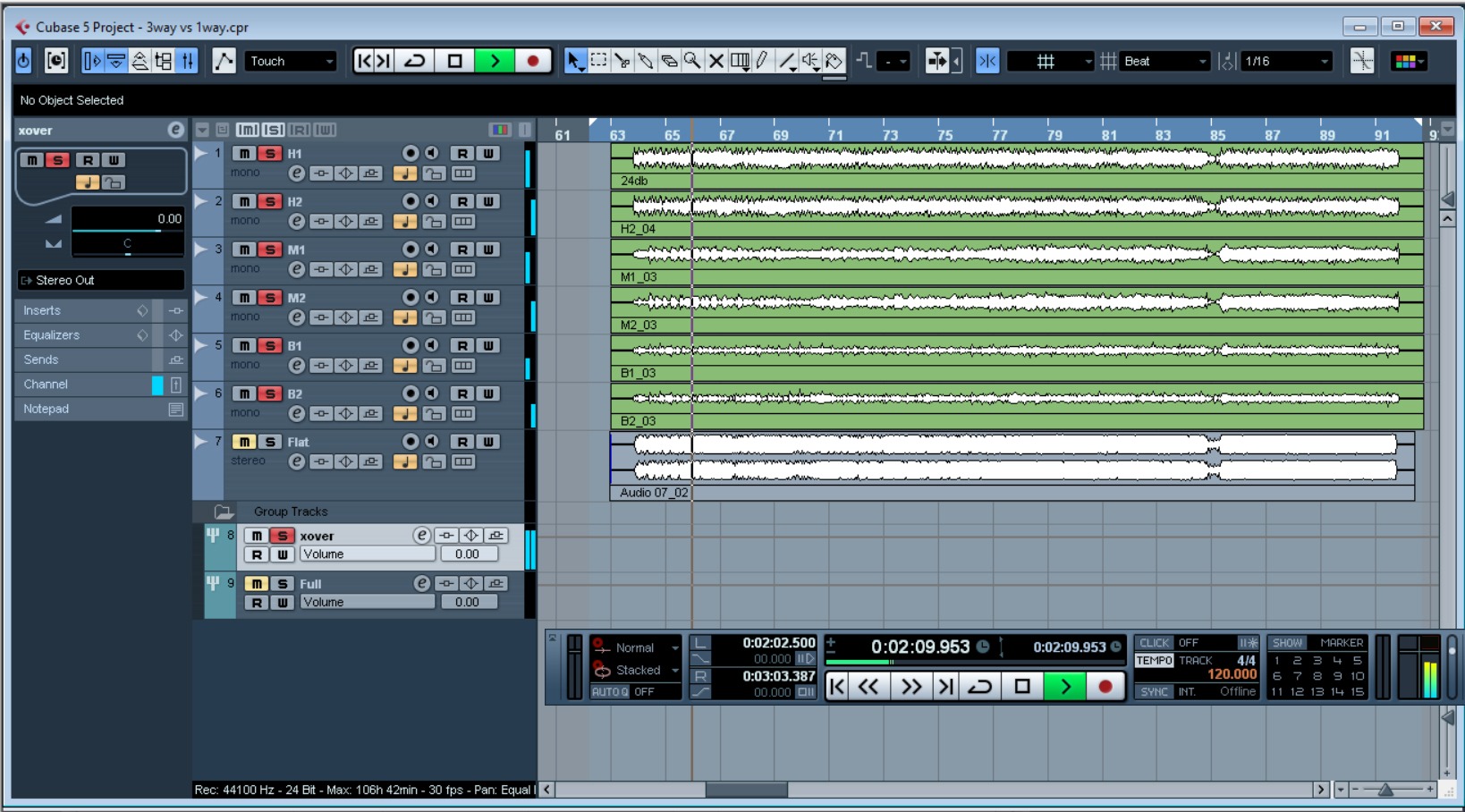

You've got a daw. So process files offline ( destructive, you work on the audio not some real time processing): then you create two groups and use solo and/or mute to shift from one to another. No delay.
The differences are sometimes subtle but they are here between FIR and IIR. For monitoring real time i find latency of FIR to be a real issue with some musicians... so i've got an IIR and a FIR preset: when monitoring during takes i switch to IIR, when critical listening FIR.

In fact 4way 12db looks better than 3way 24db concerning phase in wituix.
