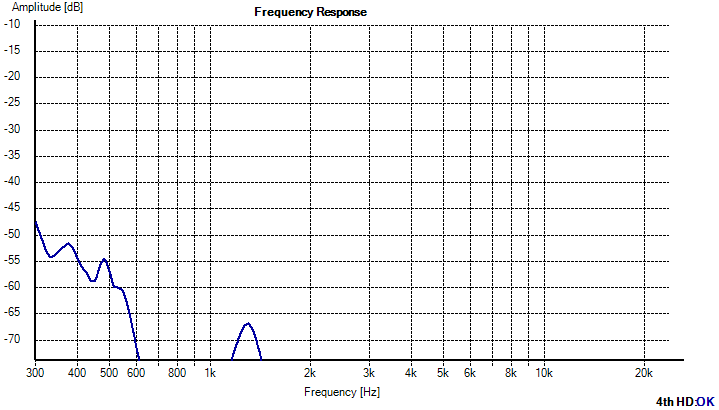

- And see the cut-on frequency of the first axisymmetric higher-order duct mode:
It basically doesn't let the source misbehave, ignoring its HOMs, which are destined to vanish pretty quickly.
That's also why it's able to maintain so nice polars up to 20 kHz.
This is of course the direct consequence of the small throat. Kudos to BMS, this allows a wonderful device to be made.

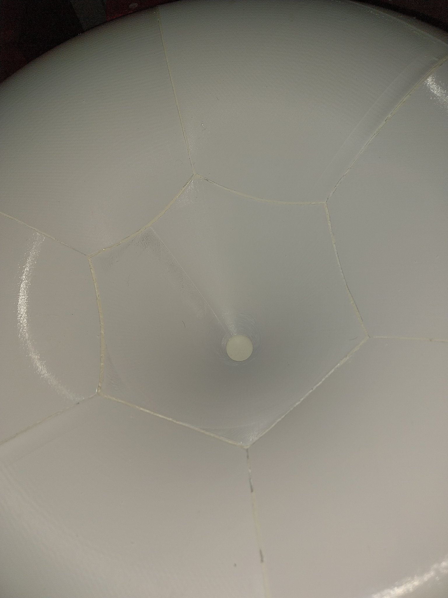

Some progress on the a460 spline version, glued together with Griffon Polymax.
How do you plan to do the finish? Won't it be a problem with that glue?
Looking closely at the photo, the petals seem a bit far apart, more than I would expect - did you sand the sides before gluing? This is really necessary to do, as there will virtually always be some overruns at the corners, preventing the fit.

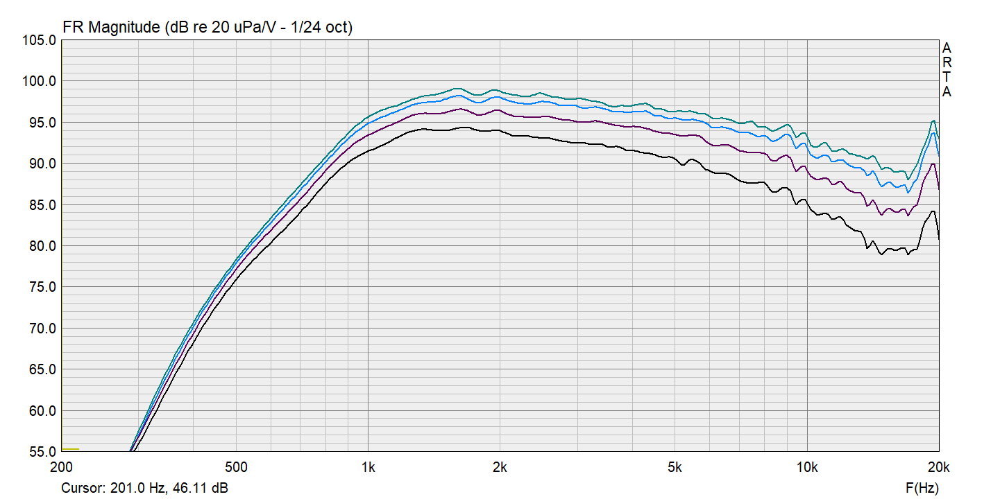

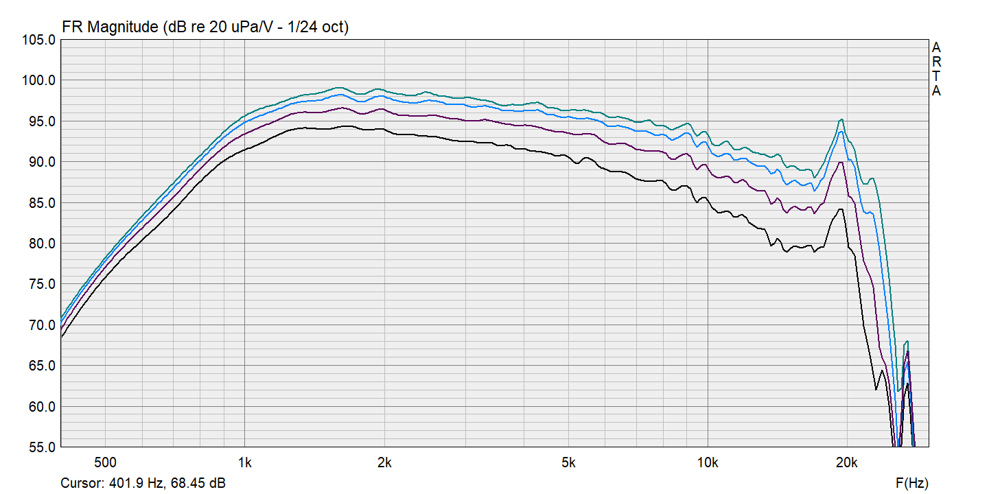

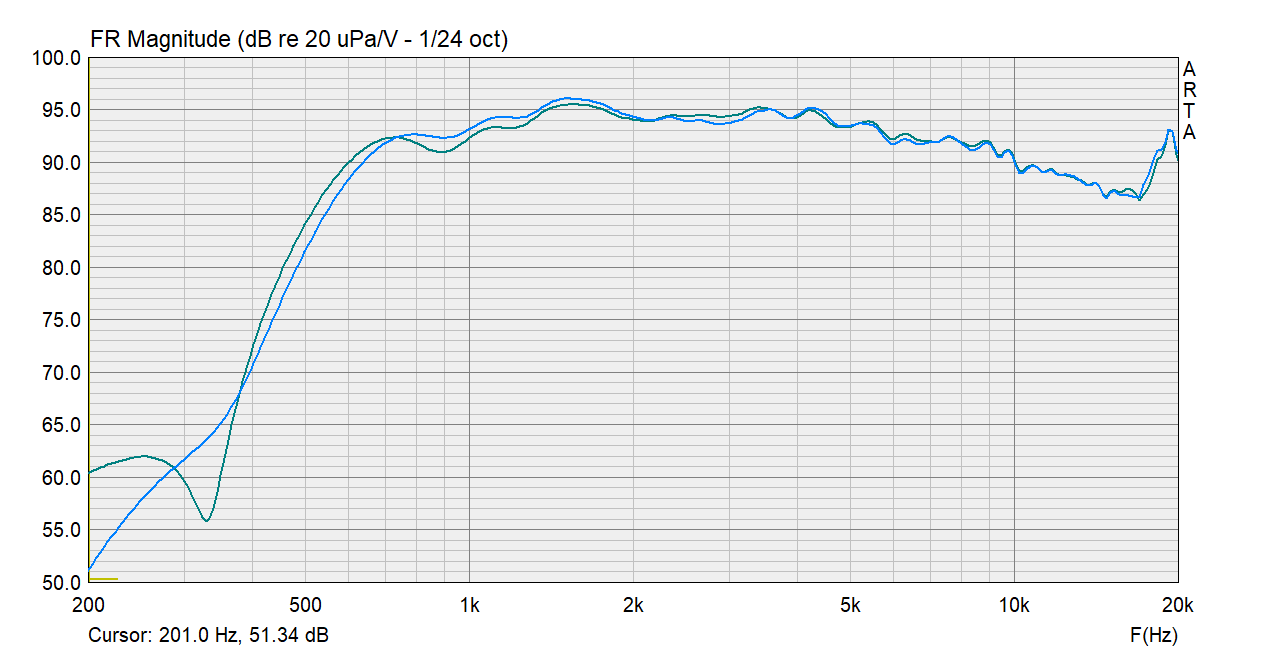

I'm very curious to see your measurements, especially how the region around 2 kHz comes out.

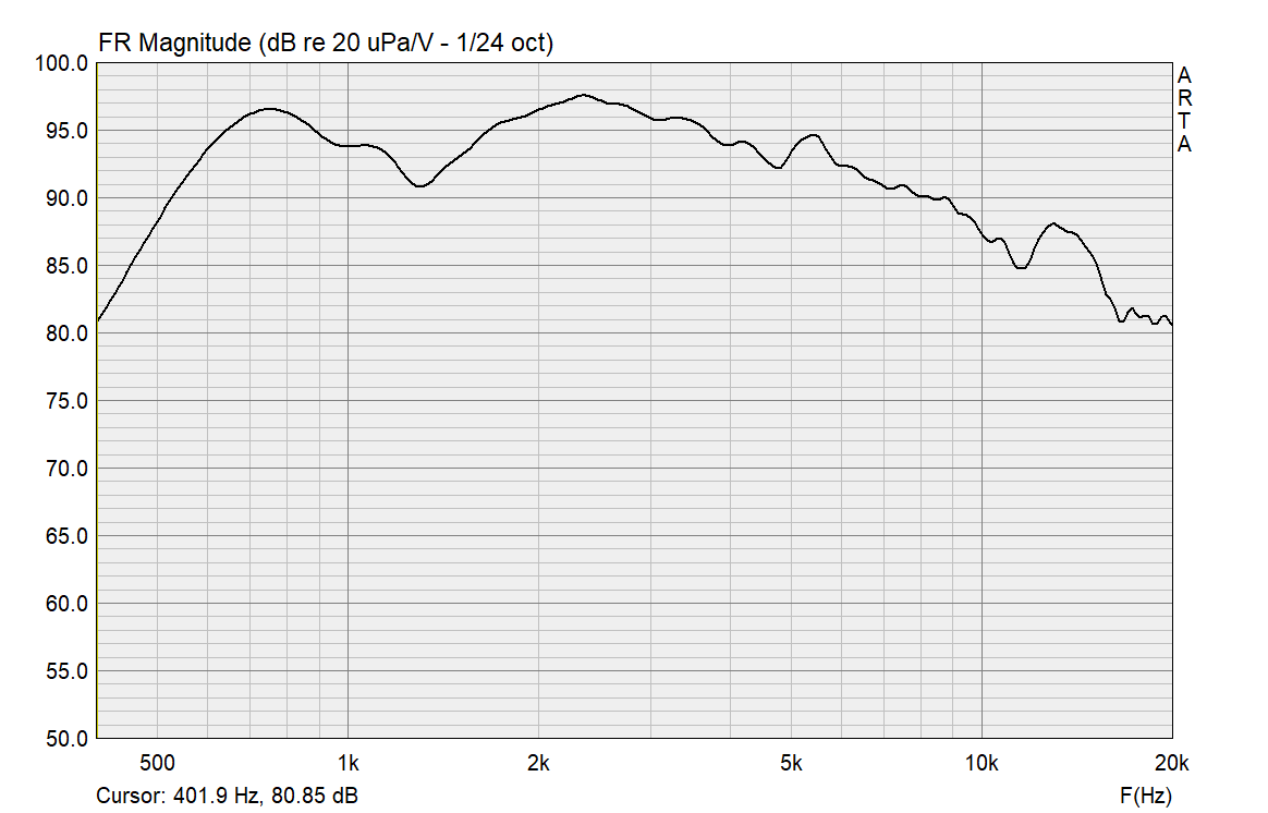

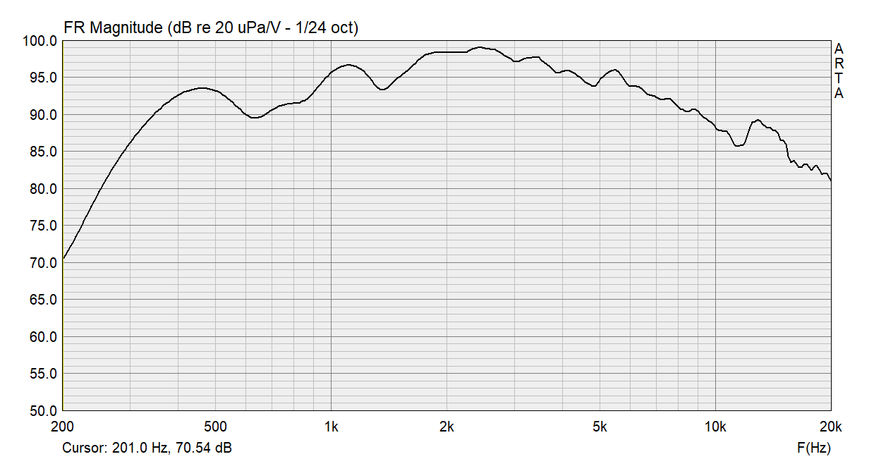

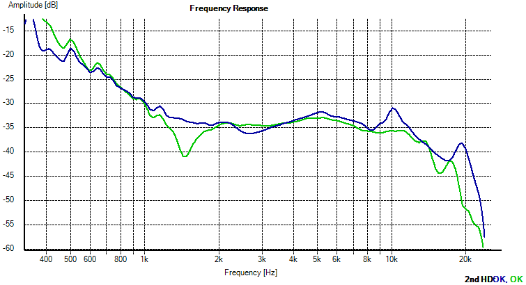

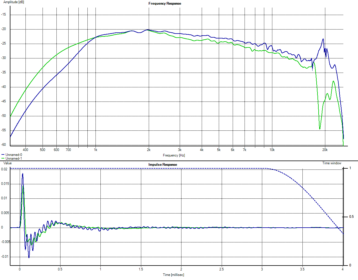

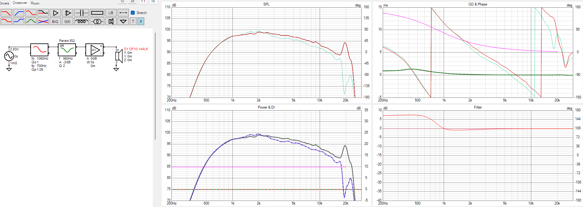

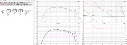

Well, the DF10.144LK doesn't look quite as good at lower frequencies as I had hoped it might be. The peak around 20kHz isn't present in the datasheet curves, but should be fixable with a passive notch.

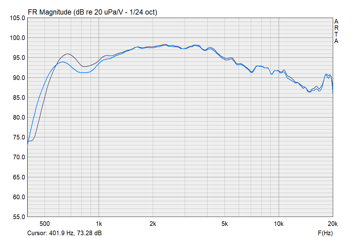

Here kind of matched using Linkwitz Transform and eq biquads. Would be some +7.5dB extra drive voltage on the coil, and then depends on excursion capability, as both drivers have approx. the same Sd, and probably not too different internal geometry.
