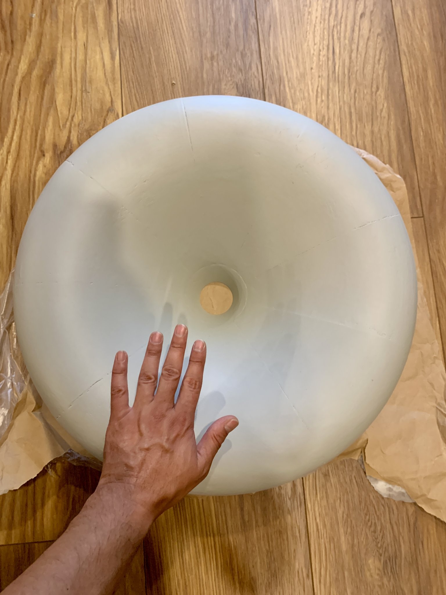

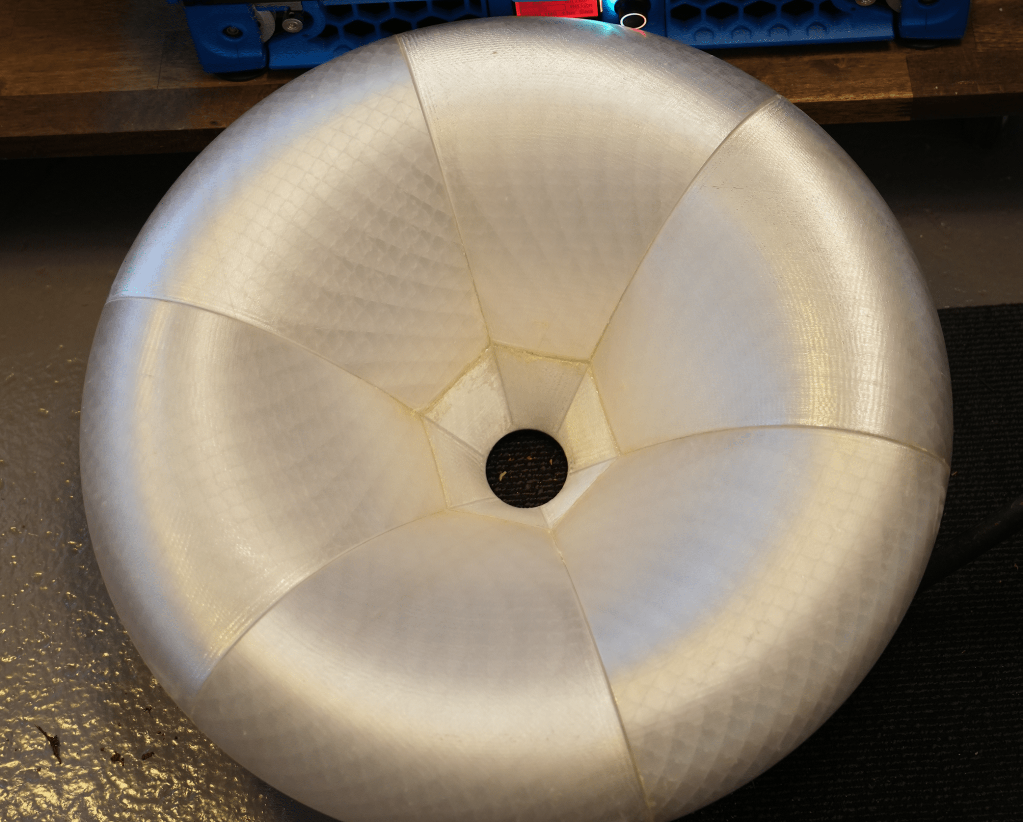

ATH E520G2 all glued up and ready for some painitng.
Whilst the included jig does a reasonable job of holding everything in place it doesn't really pull the petals down right into their seating as well as it could. Might I suggest a join that has registration pins and the ability to utilise fastners to pull the petals into the base. I was able to get precision prints (natural PETG) on my Voron and fit them with <0.5 gaps before glueing, however doing this with all the petals fitted and screwing the jig down requires way more arms than I have. 🙂 My joins are mostly <1mm however between petals and base some opened up to be larger than 1mm.

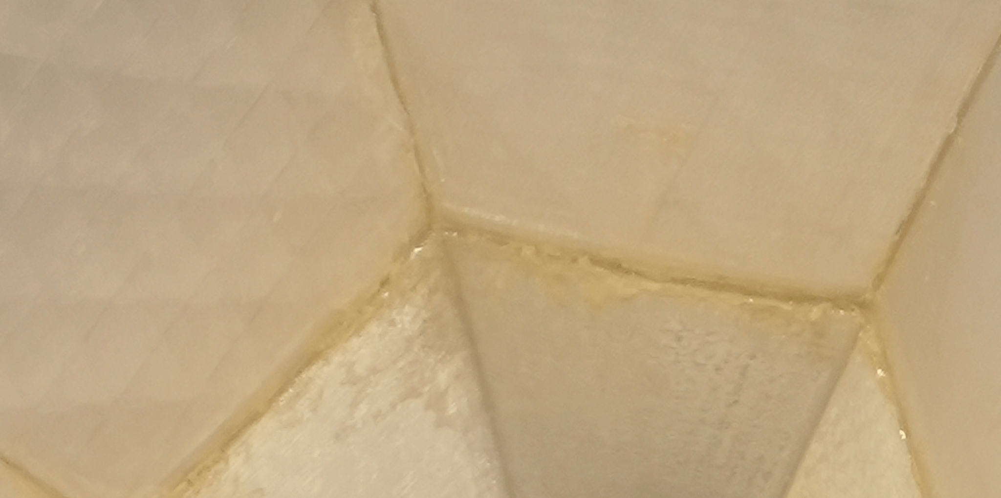

FYI natural PETG prints with a clear layer or 2 so the edges may look like a larger gap in the photo.
Nothing that a bit of filler couldnt fix though. 🙂
Glue used was a PU based one, hence the messy joins. For those doing it a first time make sure you tape all your joins with packing tape to prevent the jig sticking to the horn and make cleanup easier for the other joins. PU expands as it sets.
Printing settings:
- 0.2mm layer height, 0.4mm nozzle
- Natural PETG - prints the best and will show you EVERY blemish so it can be awesome for dialling in PETG.
- Scarf joins and put joins to the back, then rotate the part so the joins line up on the sharpest point of the curve on the back of the horn.
- 3-4 sidewalls/external layers with 10% bicubic infill. base was 20% infill.
- Printed slowly ( for a Voron) each petal was about 7 hours.
Hi, thanks sharing your printing tips! 7 hours per petal, thats 42 hours per waveguide + throat and possibly other parts. How much does it weight? Trying to get some idea of filament use. Thanks!

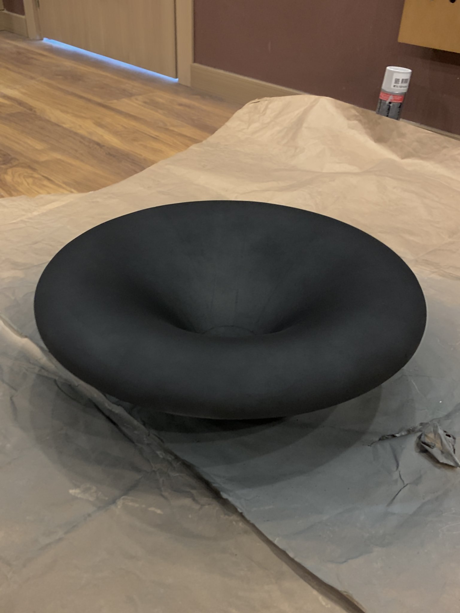

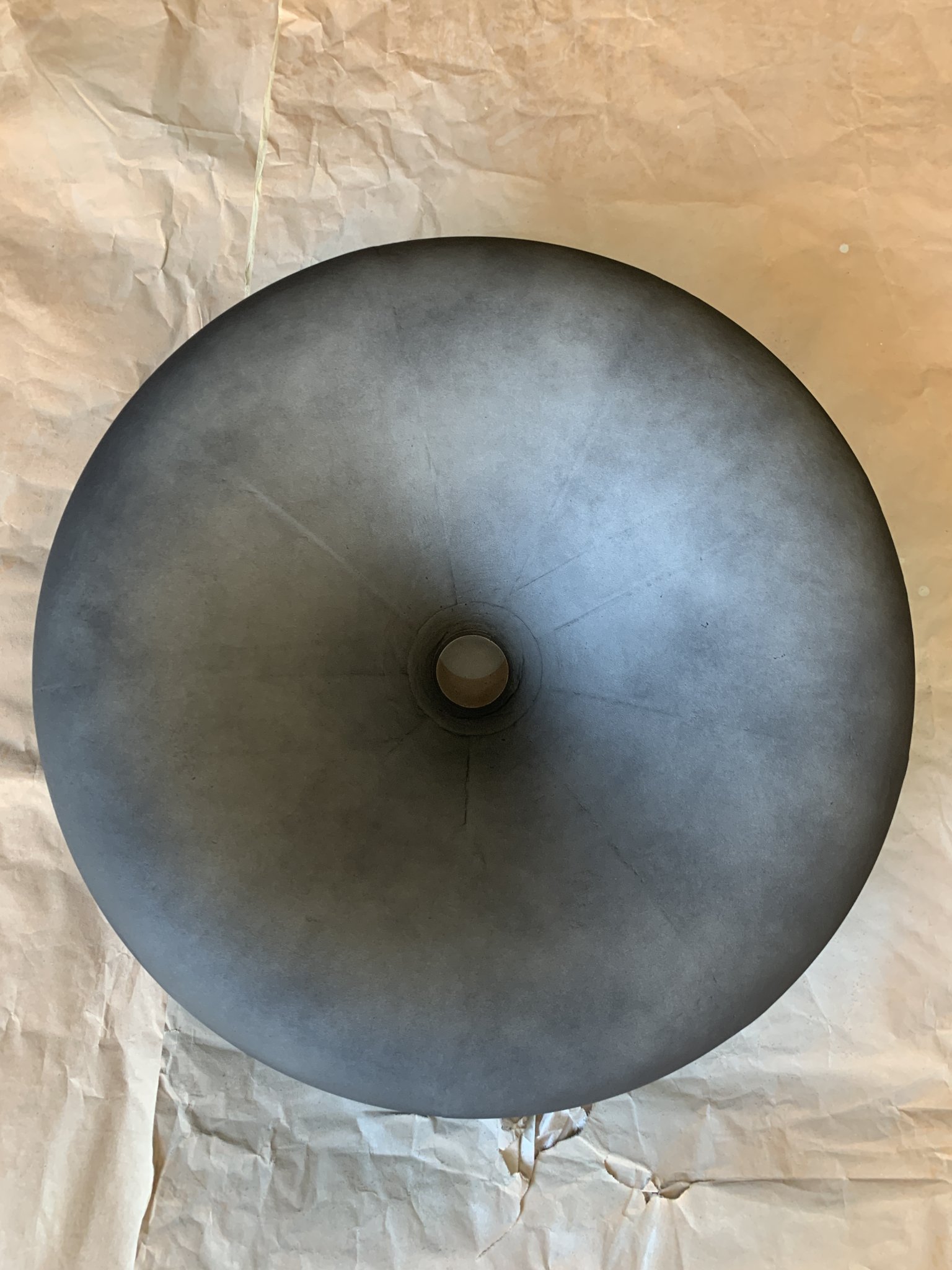

Here is mine, also from PETG. 0,1mm layer height and solid infill. No resonance probşems with the simple knock test. As I have always worked with wood and subtractive methods, this construction was one of the first for me. I liked how complex geometries can be printed but I did not like the finishing part. It takes time and involves chemicals I do not like that much!
I have already shared my glued and first layer of polyester putty filled photo before (https://www.diyaudio.com/community/...-design-the-easy-way-ath4.338806/post-7757232). Now, you can see full layer of primer and first and second layer of paint applied. I am not 100% happy with the results but this is my first try so I try to be easy on myself. Also, I will sand with very fine sand paper and apply another coat of paint yet. The thing is, it did not end up looking like a finished product (at least up to my standards). The cnc'ed wood takes much less time finishing and gives better results. I am hoping to build the same horn out of wood once I get the necessary files. The throat part can still be 3d printed, though I would prefer to get a mjf print for that.
The whole waveguide and adapter / jig is almost exactly 2kg of petg.Hi, thanks sharing your printing tips! 7 hours per petal, thats 42 hours per waveguide + throat and possibly other parts. How much does it weight? Trying to get some idea of filament use. Thanks!
I second that. Slots and tabs (or slots in each part to insert a separate tab) would be better than pins, so that they allow some movement in one axis.Might I suggest a join that has registration pins and the ability to utilise fastners to pull the petals into the base.
I always do the petal assembly one by one, can't imagine doing it any other way. I first fasten the jig to the base and then insert petals, one at a time. The jig does push down but also outward so it's good to use a tape to prevent the petals from moving apart:

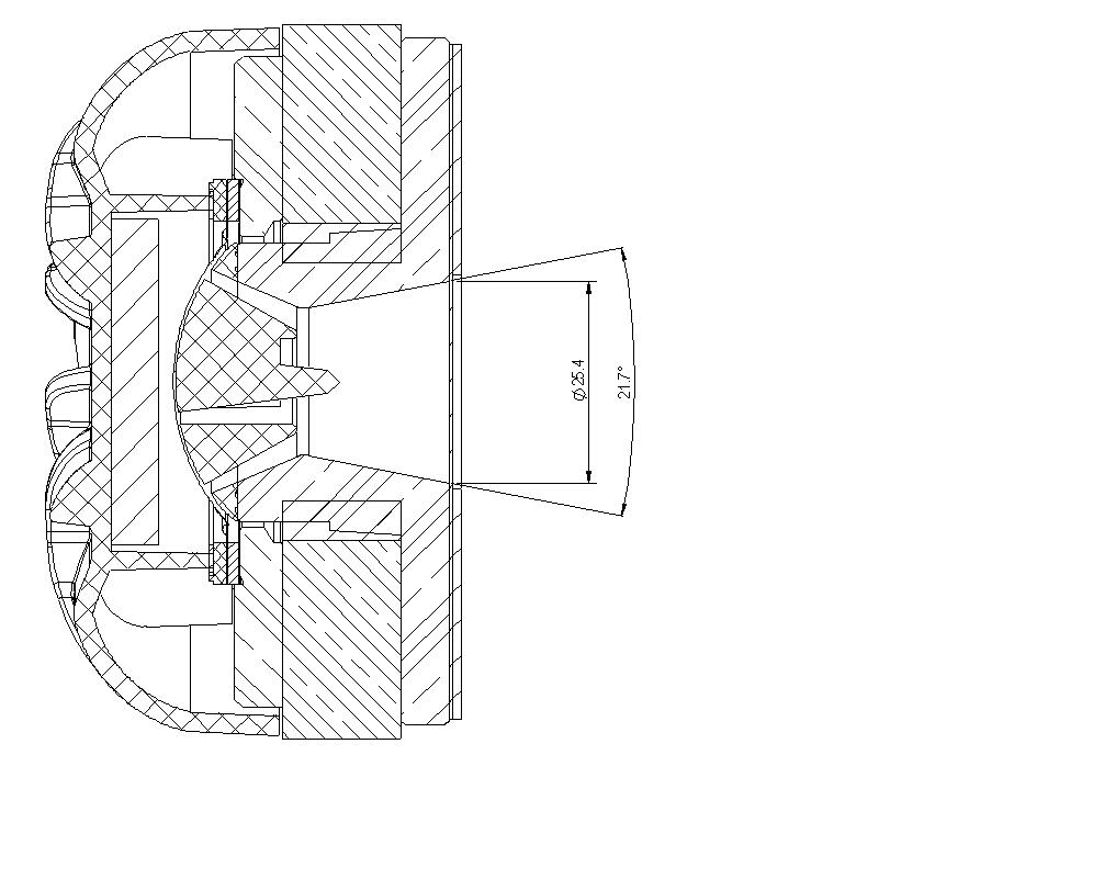

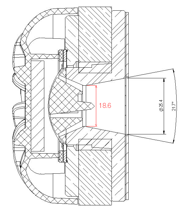

below is 2535 drawingBased on this drawing, does everyone agree that the exit angle of DFM-2535 is 22 deg?
(Which is right between the current STD-1 and STD-2 adapters.)
According to the technical drawing, the exit diameter at the phase plug is ~18.6 mm. Would be interesting to see if increasing directivity with a reducing insert works without messing up the FEA optimized response of the driver.

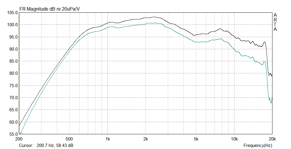

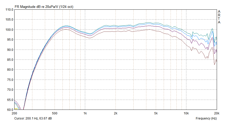

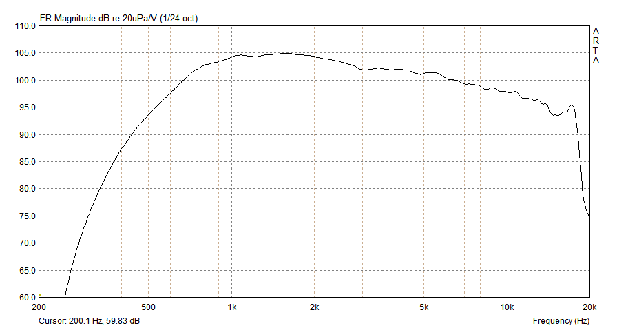

I tried a ring plug in the DFM-2535 with a smootly expanding adapter. These are unsmoothed frequency responses:
What seemed as a very smooth profile overall doesn't turn out that way. I think the expansion inside the phase plug is just as critial as anywhere else. Here it apparently doesn't match the rest. So, with the ring plugs it's also not that easy. The DFM-2535 is obviously optimized with the existing conical exit section.
But I can try some more rings, this was just a first try 🙂
But it still sounds fantastic. It can be well worth it, even if some additional EQ might be necessary.
I kind of expected this. Not the best outcome for a passive approach. If directivity is considerably better (lesser) in the high frequencies with a reducing insert, for those of us who use a DSP solution, it could still be interesting what a straight-walled ~18.6 mm insert does.

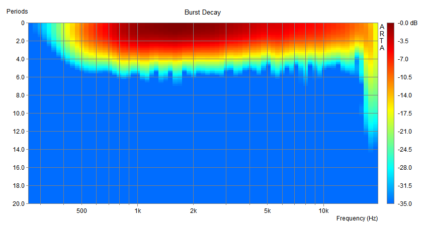

This is the second piece from my pair of DFM-2535s (in its original condition, including the bug screen and foam gasket, which doesn't allow the cleanest joint).
Attached is an on-axis impulse response in various formats, all exported from ARTA.
Anyone is welcome to analyze it and present any derived data, I don't have anyting to hide, I just don't think there's anything more to it than what has been shown.
For a reasonable CSD the available reflection-free time is quite limited (only 4.9 ms).

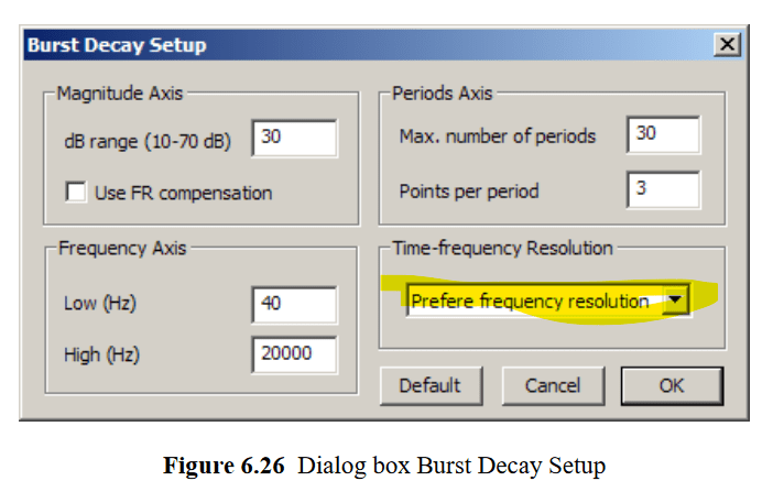

Which 'time-frequency resolution' setting was used for your burst decay graphs? 1/3 or 1/6 octave resolution? I often find it irritatingly difficult to reproduce graphs with the same values in a different analyzer (REW vs ARTA in this case).

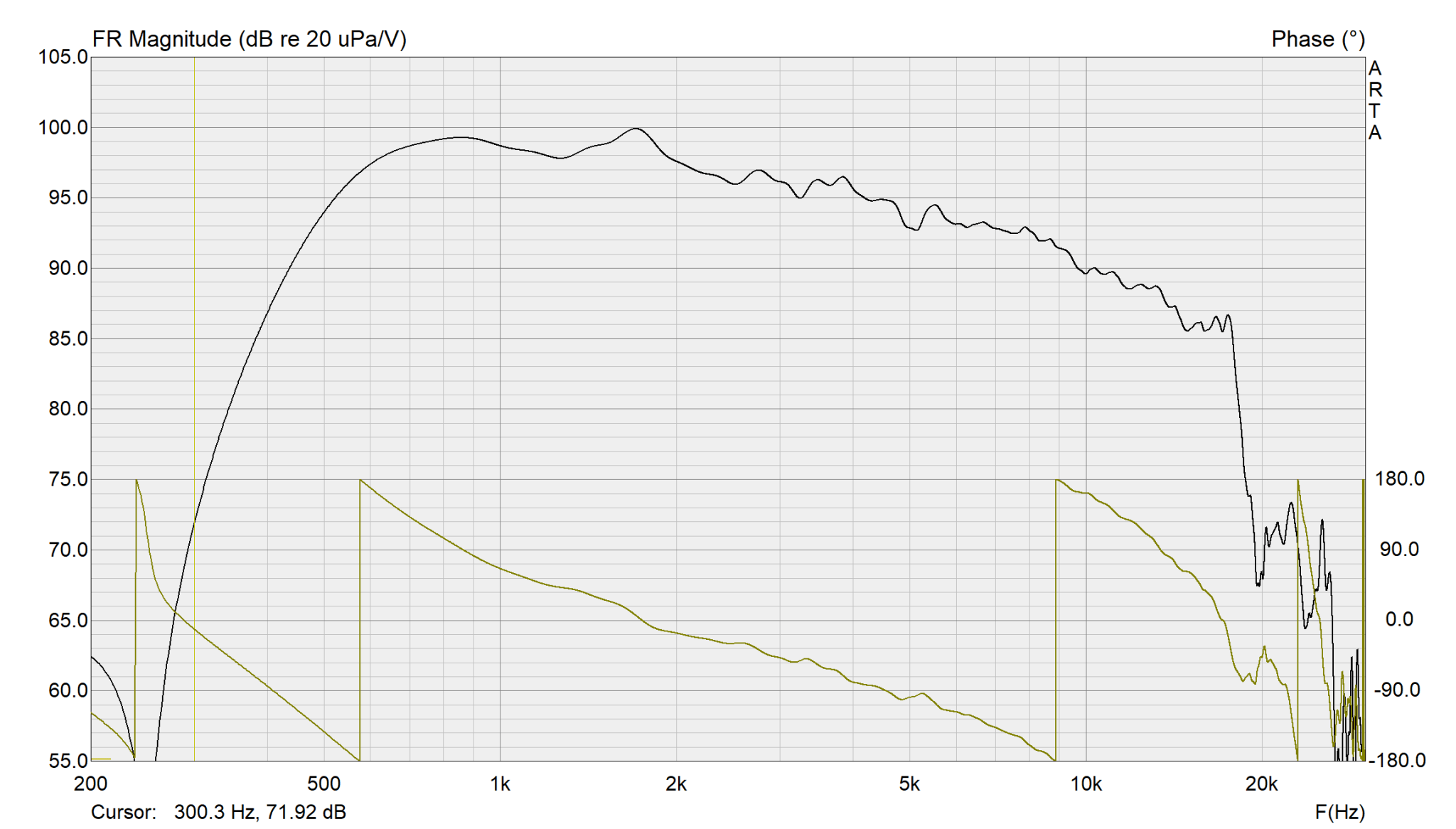

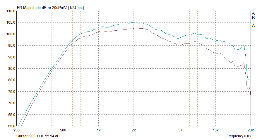

The 1" Peerless measured with the STD-3 adapter, on axis. That's all I can handle today 🙂
