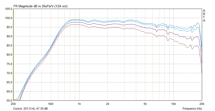

I was primarily concerned about the initial rise and sudden drop from 18kHz to 20kHz on the DF10.171K (if that's even audible), rather than the absolute SPL. The DF10.172M appears smoother in this region.Regarding a final absolute SPL curve, a lot depends also on a waveguide, so the picture above only tells you that the driver per se is probably smooth enough to work with easily, but not much about a required EQ in a particular horn. But I'm not convinced that a stronger magnet is necessarily an advantage here. It can add a few dB of midband sensitivity (which is already pretty high anyway) but not always improves things regarding EQ.
If you look at the DF10.171K with the A520G2, there's already very little that needs to be done. But of course if anyone tries the other variants of the Lavoce drivers, it would be more than welcome.
I tend to not take datasheets at face value to this level of detail, but it may be indeed smoother.The DF10.172M appears smoother in this region.
I would be surprised if it was noticeably better in the top octave (than all the other very similiar ones), but all I can say is try it...
I suggest people buy a pair of these just in case... don't want to end up with another Peerless situation 🙂Lavoce DF10.171K (A520G2/25-STD-1).
Given the price (62 EUR/piece), it's just perfect.
It will be virtually the same in A460G2.

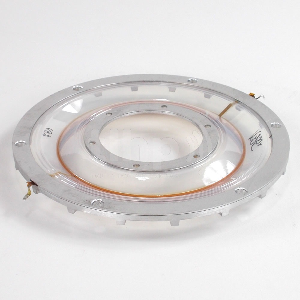

How about forming larger ring radiator diaphragms from PETG or PEEK? Imagine something like the B&C DCX464 or BMS 4590 mid diaphragms in the photos, but larger and conical or approximating a section of the WG, plus the required wiggles that are part of the diaphragm's shape, instead of flat, as if the outer and inner the metal rings were the edges of the outer and inner parts of a printed WG, like in the second picture #15176 The point is that the surround is included in the diaphragm and vacuum forming and gluing is achievable for DIY, probably.
Those B&C and BMS diaphragms have 2.5" and 3.5" voice coils and Sd of 50 ~ 60 cm2, if I remember correctly. That's too small for 200Hz, should be a ring with more like double the Sd.
Below would come the voice coil, if it was an imaginary scaled up driver that would imply a very large voice coil and magnet diameter. Maybe some odd thing created out of a cone driver could drive the diaphragms, something like truncating the cone a 12" midbass to the fitting diameter and gluing cylindrical element onto it to hold the diaphragm.

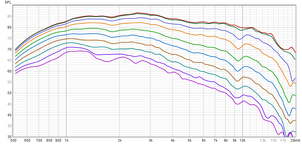

Here's an example - 18Sound NSD1095N with two different throat adapters with the A520G2 waveguide:
The bottom one should be a closer match to the driver. Is it actually?

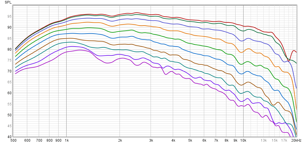

The top octave of the DF10.171K is almost textbook-perfect regarding coherency, there must be only very little of any wavefront disruption. It almost makes me think about trying a wave-shaping plug for this one again.
Either a very good job by the Lavoce engineers, or a great luck 🙂
ST260 waveguide + DF10.171K
- Looking at the basic resonance, maybe it should be indeed tried without the rear cover (or with a bigger, well-damped one).
