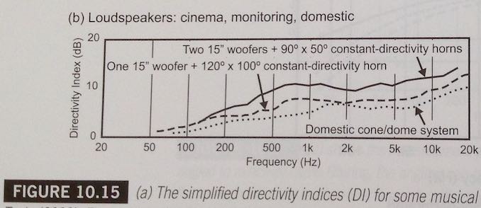

Where would your speakers plot on this DI chart?
attachment.php
© Toole, fair use for educational purposes
I would be a little surprised if suitability for music types switched between the dotted and the dashed lines. But that is the hypothesis being put forward, so I will take it seriously. Also, someone commented that the shape of the DI plot is more important than the height. I take it you would not agree?
P.S. my hifi is XT1086-based, so I am not taking pot shots, I am on board, just testing discussion points.

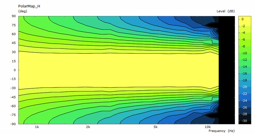

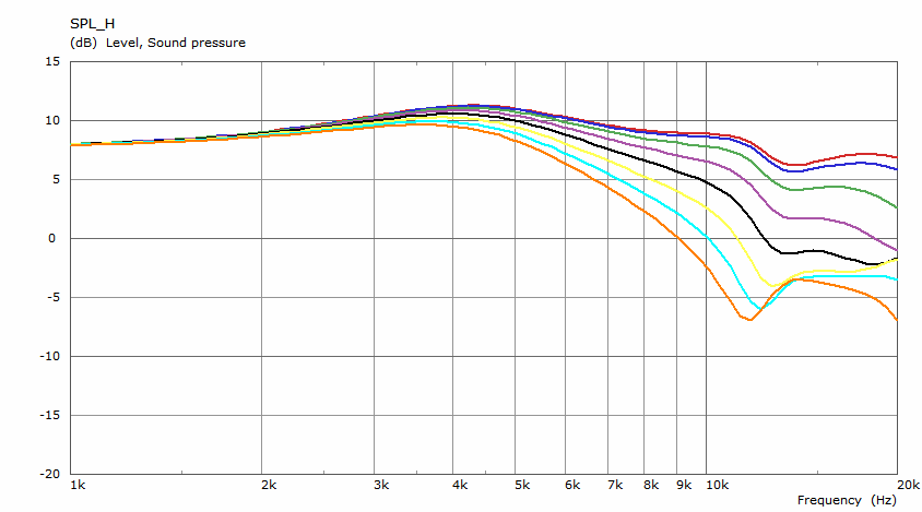

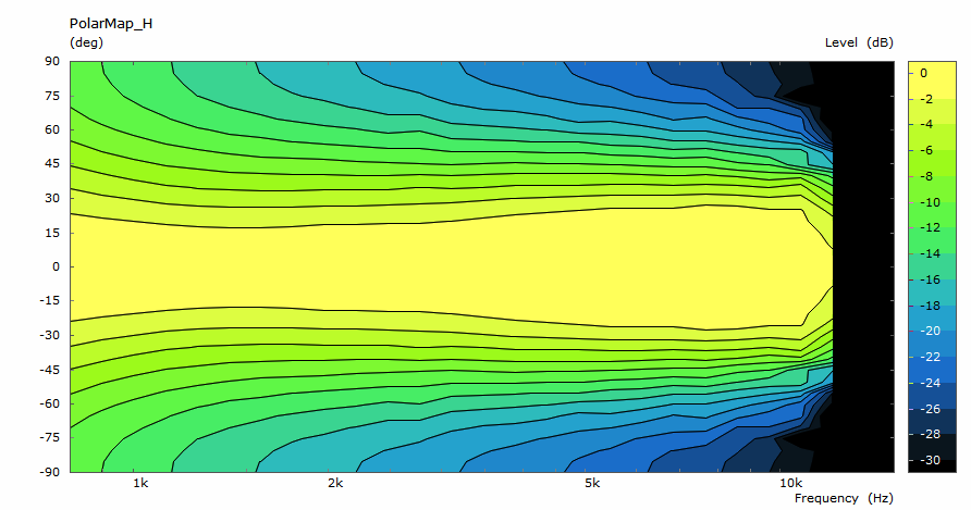

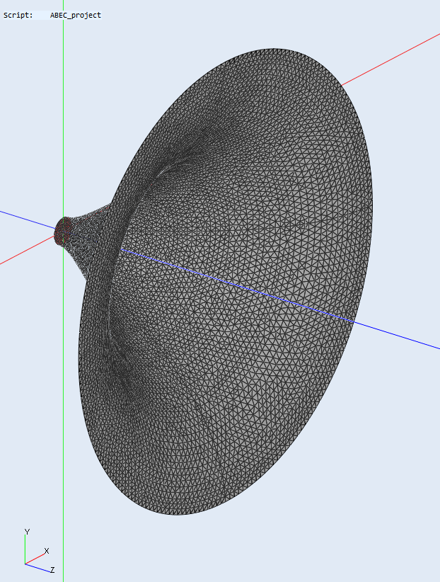

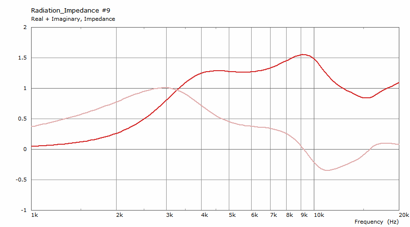

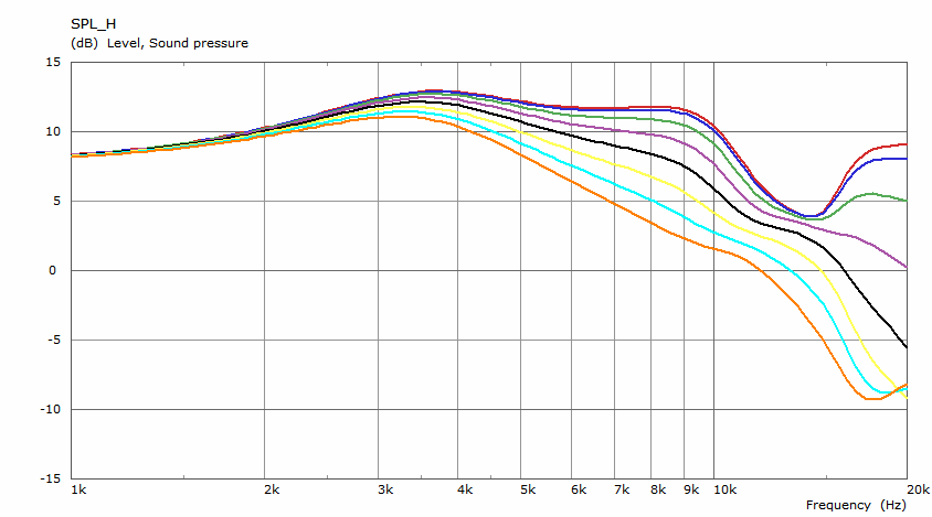

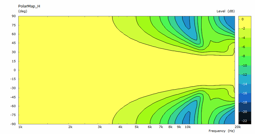

OS WG, Ø 65 cm (~26").
Polar map normalized to 0° and 20° (as usual) on the two pictures. For these very smooth waveguides it may have sense to show the polar maps normalized to on-axis sound (?).
I forgot to change the lower frequency limit - next time.
I guess now it is time to start analyzing the full-space situation, i.e. with the horn put out of the infinite baffle. This was the easy part 🙂

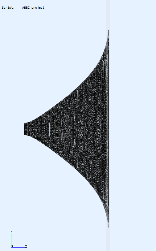

The profile used - it is 35 cm deep.
BTW, I see no further improvement other than the extended pattern control down to lower frequencies. If this wasn't needed it would make no sense to use such big waveguide - at least not in a baffle/box. For a free standing horn, it might be different I'd guess.

Thank you, that has been helpful. It also means I am cursed, with my wide tastes.
My NS-15 would be at about the top curve in the plot but smoother and flatter.
Whether or not the differences in the DI would be audible would depend on the room. If it were anechoic then of course no differences would be heard, while in a very lively room they would. My rooms are always very lively at HFs so I would expect to hear the differences in that case.
Shape and level are two different things and both are important, but I would agree that shape is more important than level up until you have a very smooth flat shape, then the level become the most important. I do both.

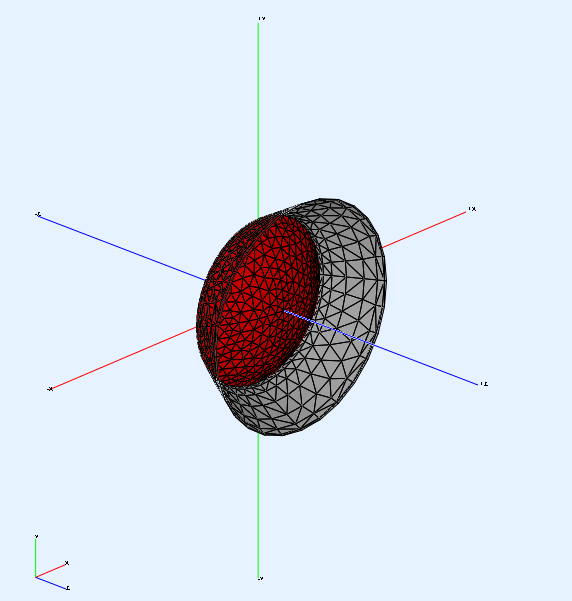

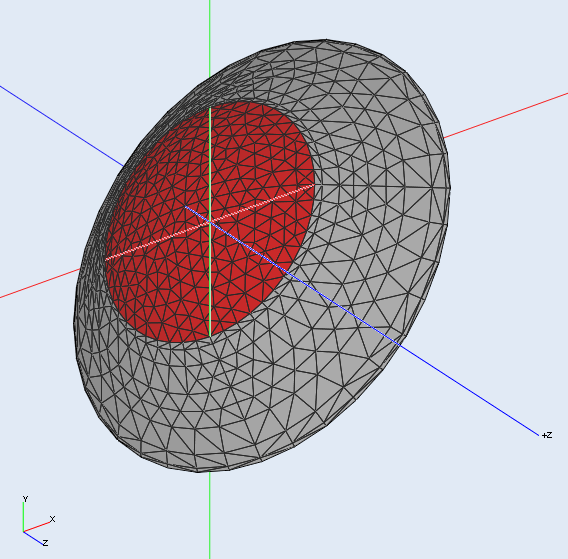

Stay tuned, I'm just about to release version 4.5.0 which will be a major update with all the features long time waiting to be released.

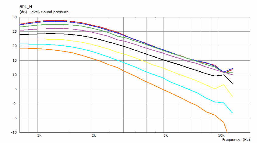

One quick example - a 30 mm dome in a short conical recess. This kinds of little things will be possible. This took me about 2 minutes from writing the script file to upload the BEM results 🙂
(A big waveguide could also be placed on top of that).
