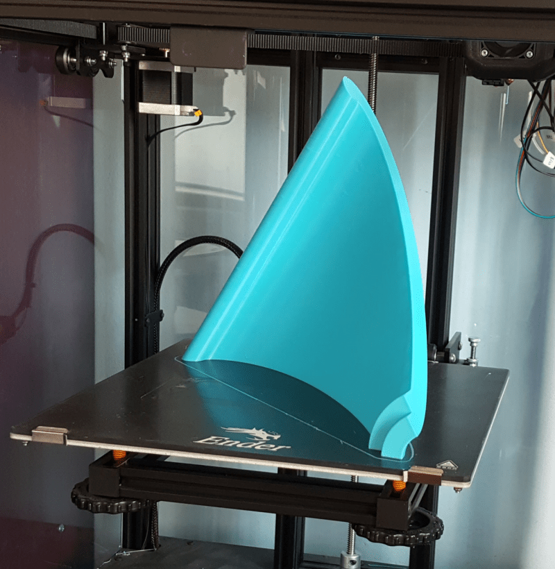

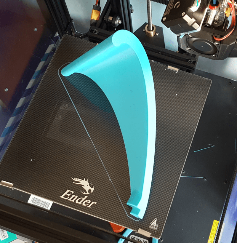

ATHEX 460-36, a petal model for casting (or 3D printing).
STL file: https://at-horns.eu/img/athex/ATHEX-460-36-CAST.stl
This was never so easy:
I've actually never made molds for casting, so now I wonder how to best proceed :D
(This was a 6-hour print and probably couldn't be made much quicker. That would be 72 hours for a WG pair. I can only hope casting 12 pcs won't take this long.)

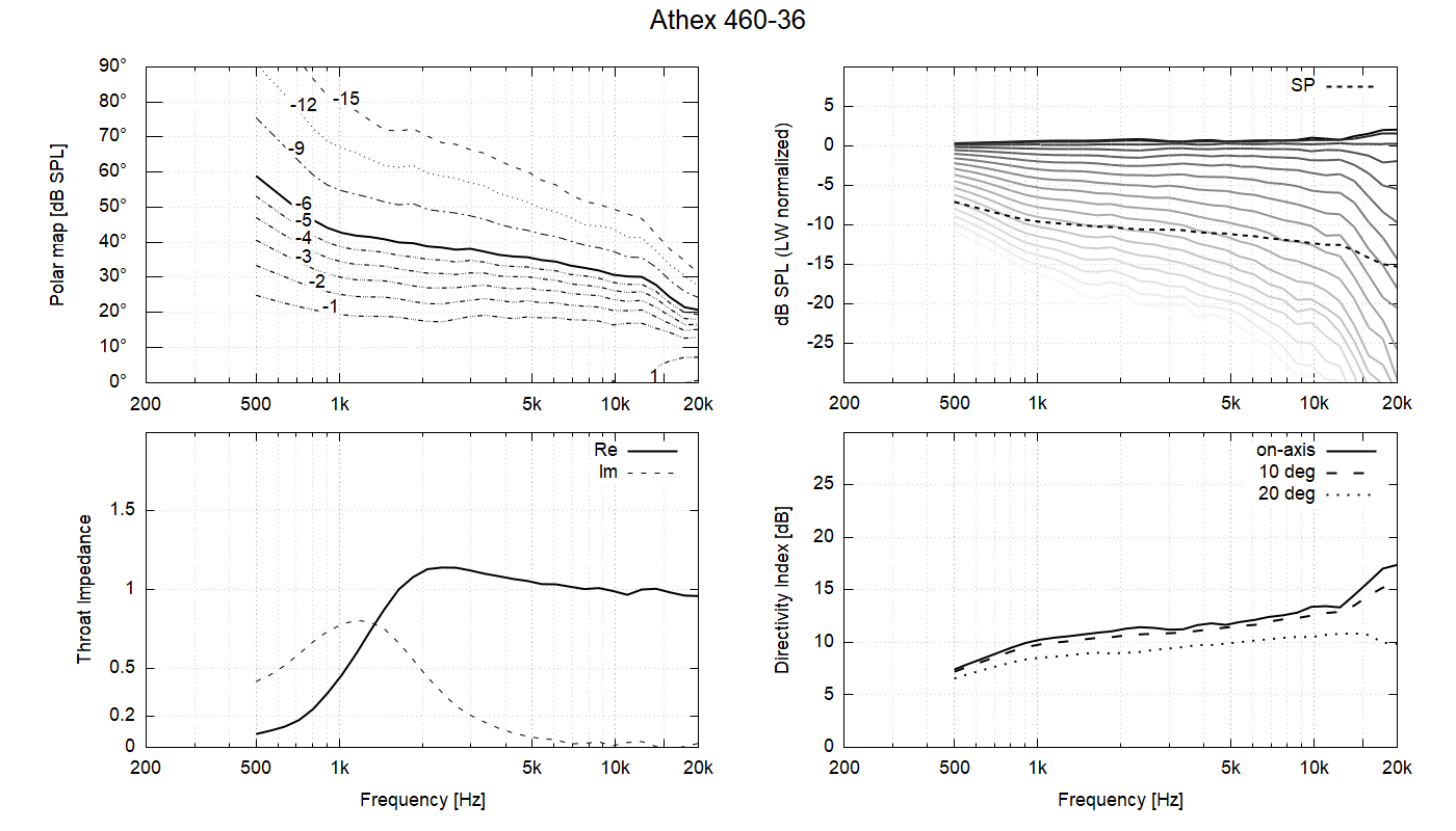

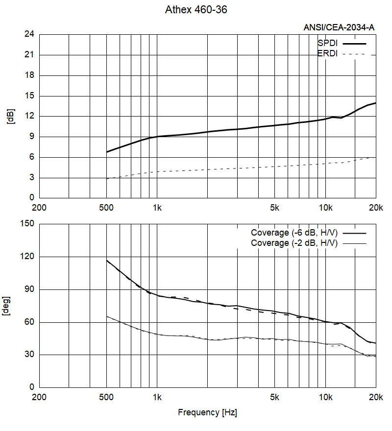

- The 460-36 is also ~75 deg in the middle of the passband (it somehow fits naturally with a 1.4" throat), but it's not really constant:

The effect of the direct field is that the direct sound is so strong compared to all the rest, that the details of the rest (like DI) just don't matter much - it's "mostly out of the picture".
- That's also the only option when a direct sound is the only good thing left in a system design :)
