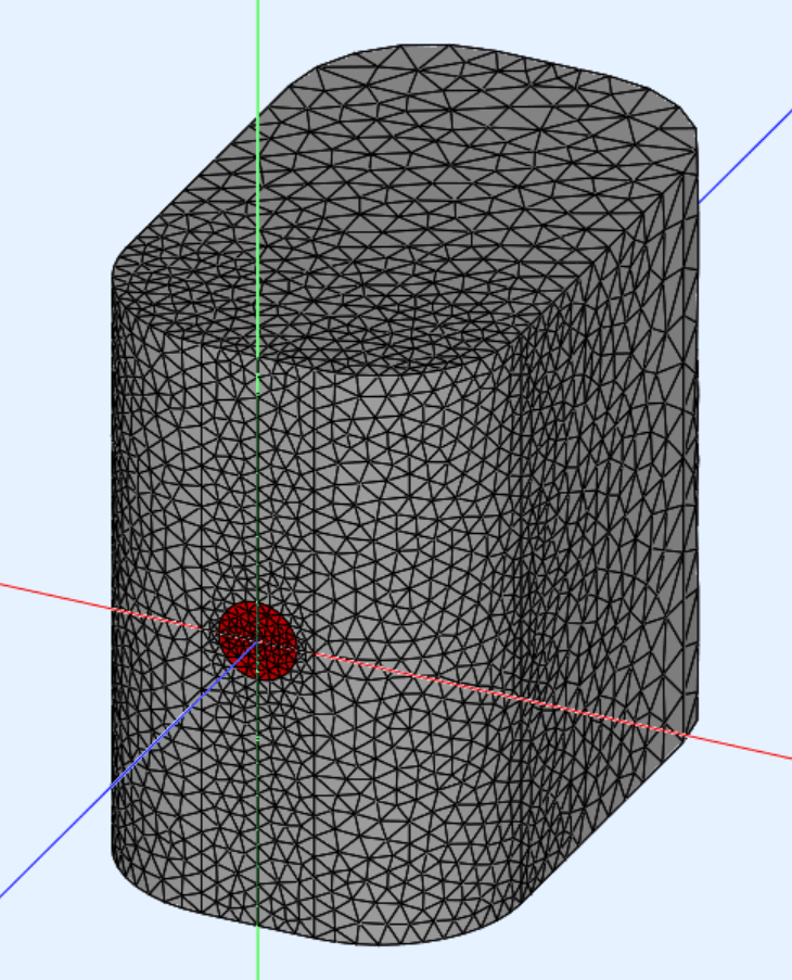

Im sure you've had this debate, plenty already. I am looking through your thread, for a flat baffle with optimal edges. I am sure you've simulated this before.
There are no "optimal edges" to any practical flat baffle, I'm afraid. The best you can do is probably to minimize the baffle in that case.
There are no favorable edges? Thats being pretty elitist...I probably sound the same way when I say there are no optimal reflections lol; There are no "optimal reflections" to any practical system, I'm afraid. The best you can do is to minimize the reflections, in that case.

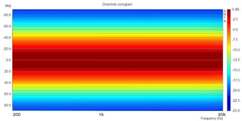

Well the thing is, we can stay in the realm of waveguides only, and see the trend...
"keep DI flat, as with any other good waveguide." - A waveguide with Higher DI will measure better, in room, then a waveguide of Lower DI..... Both having a Flat DI
That is the point I am investigating
That's just not how it should be measured, it makes no sense to compare them this way. If there's a sufficient time gap between the direct sound and the reflected sound (which calls for a highish DI), then the stronger the late reflections, the better 🙂A waveguide with Higher DI will measure better, in room, then a waveguide of Low DI..... Both having a Flat DI
That's minimizing the flat baffle, just what I said (and not nearly as good as with a WG). It will beam above 10 kHz though.
I call it a flat baffle with optimal vertical edges. Semantics I guess.. I see what you are saying above 10khz.

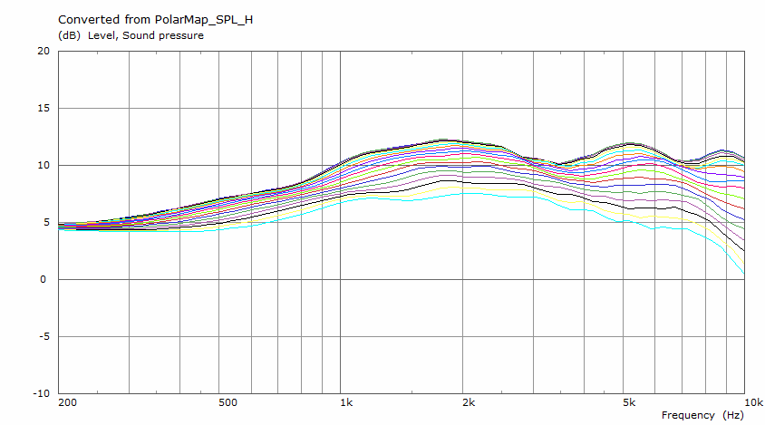

I don't know why it would be better. This must be an aspect of preference since it definitely would not measure better...That's just not how it should be measured, it makes no sense to compare them this way. If there's a sufficient time gap between the direct sound and the reflected sound (which calls for a highish DI), then the stronger the late reflections, the better 🙂
The resulting FR will be smoother, in room, with a waveguide that has a higher DI vs a lower DI, both having Flat DI. I prefer a smoother FR over higher room energy.
As I said, whatever floats your boat. If you want your loudspeakers to measure the same in the room as in an anechoic chamber, then I guess you'd best make your room an anechoic chamber... It's as simple as that 🙂 - The great thing about it being that the DI is then completely irrelevant and it will work for any loudspeaker. No need for big horn.
I guess the discussion about low versus high DI will never end, as there are valid arguments for both ways. It boils down to preference and circumstances i.m.o. If you have a very reflective listening space because of living with a spouse or family so room treatment is not feasible, then a lower DI is maybe preferable, maybe omni, dipole etc. If you are lucky to have acoustic treatment with much weaker (treated) first reflections and a single listening position, higher DI may be the way to go. Measurements do not tell the whole story, psychoacoustics play an important role too. One can also learn from how mixing rooms in studios deal with the matter. I like a pretty dead room -across the whole spectrum, not anechoic but with controlled reflections- so I can get away witch beamy speakers but in general, for average rooms with no treatment, I guess lower DI is preferable and that is what you see in the market, most commercial speakers for the masses have a tweeter that has a wide dispersion.
Anechoic Chamber is a very extreme exaggeration... Like these measurements, in room, things look very different. The Higher the DI, the more the measurements at the listening position will resemble the anechoic measurements is all. This is just pointing out that the lower DI, your in room measurements will look nothing like these measurements making them only useful to check for purity of the system minus the room. Somewhere there is a happy balance.

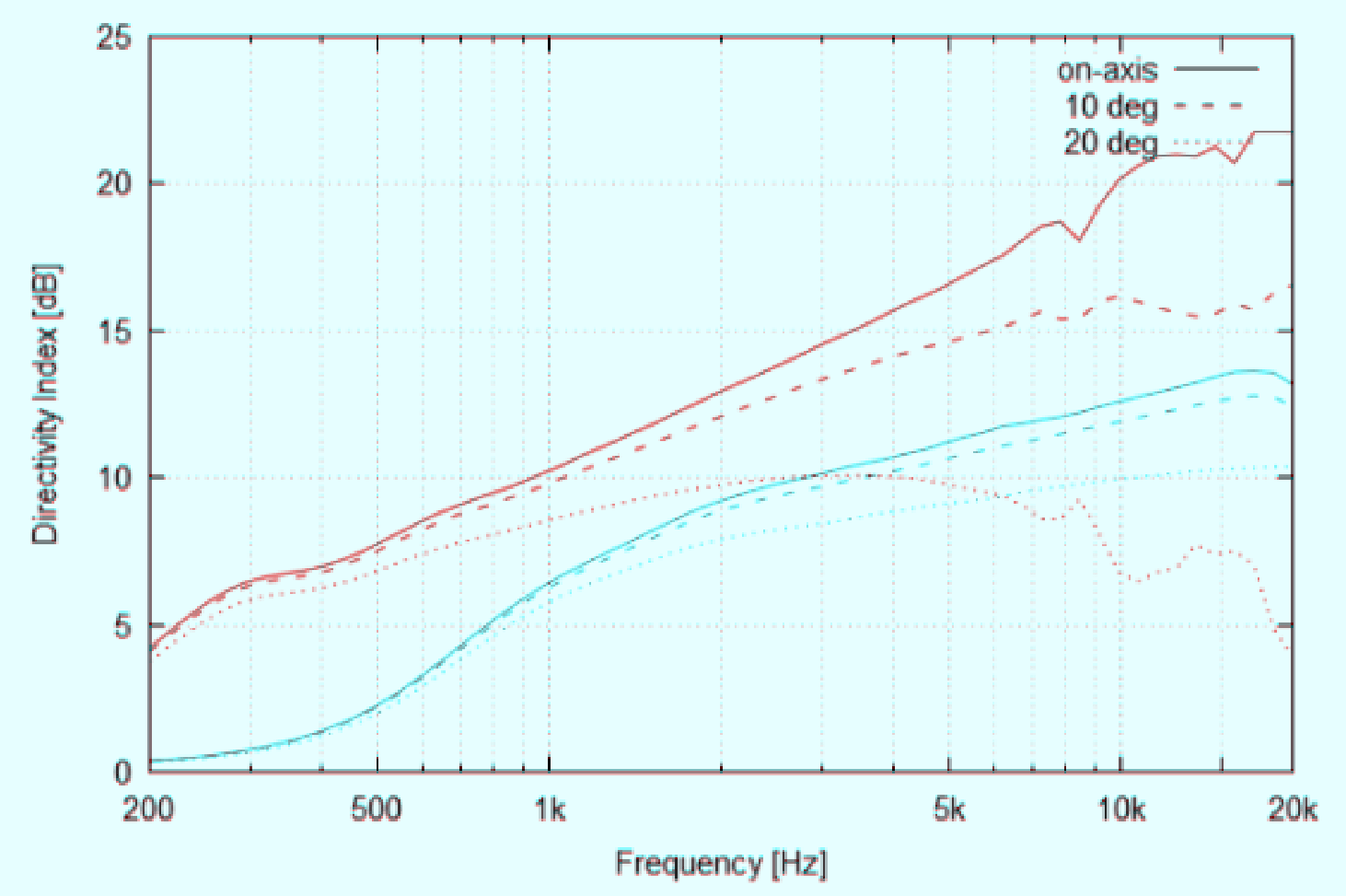

But that's not the discussion. It is (more or less) flat vs steeply rising DI, i.e. controlled directivity vs beaming like hell.I guess the discussion about low versus high DI will never end, as there are valid arguments for both ways.
One of the differences between a lower DI speaker in a highly treated room versus a Higher DI speaker in a non or less treated room is simply the size of the sweet spot.If you are lucky to have acoustic treatment with much weaker (treated) first reflections and a single listening position
Which one has a flat DI? Aren't they both rising smoothly?

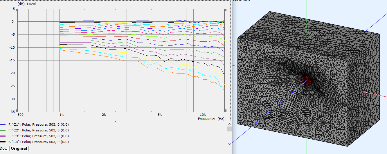

No ones ever seen constant directivity anyway... even whats shown below needs to be extended to 20hz... We end up with portions of the spectrum being constant directivity, in real life. 700hz-7k is a good portion to have covered, but 200-20khz is likely much more effective.
You could say my own form of elitism is chasing after clarity instead of wide sweet spots or high room energy
- Acoustic Horn Design – The Easy Way (Ath4)
