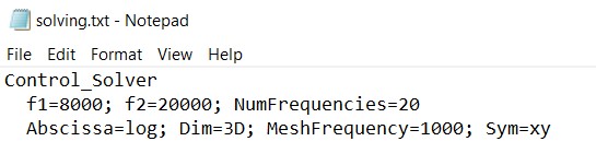

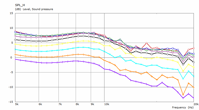

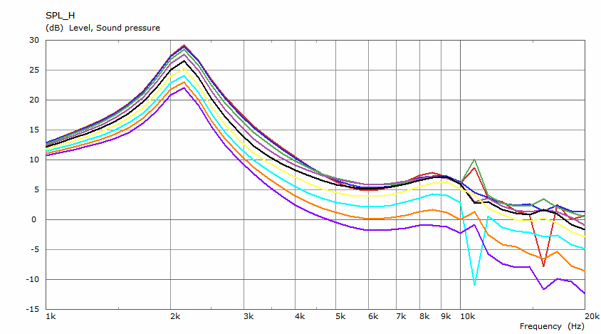

Any idea what this ABEC error is?
"ERRORS ------------------------
Number format problem in data block of import stream.
This shows in the Observation -tab sometimes when trying to open solved ABEC project in the VACS.
Is it something that can be fixed after solving the project?
This time it happened when I first simulated with following config settings:
ABEC.f1 = 700
ABEC.f2 = 10000
ABEC.NumFrequencies = 20
Then wanted to check how the top end looks like with parameters;
ABEC.f1 = 700
ABEC.f2 = 20000
ABEC.NumFrequencies = 30
Waited almost four hours to see the ERROR message 🙂

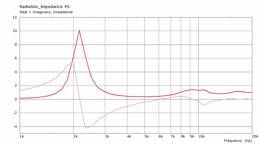

I actually never got throught to the Appendix 😱In the Appendix of my book, I did an analysis of an axially vibrating source at the throat of a cone. In that solution, I predicated that as long as only the lowest mode propagates the source curvature doesn't matter much. BUT, as the second mode comes in things get much more complicated, usually a widening. In the 1" case this would be around 7-8 kHz. Seems confirmed by your analysis.
Now as I try to study some "basic" duct acoustics for the PWT background, I begin to fully appreciate the struggle you had to face with an analysis of waveguides.

When I ran a sim up to 20K I copied the project called it a different name and changed only the start and end frequency in solving.txt shown in the attachment. It only took ten minutes longer than the standard project to solve. Maybe it is the start frequency and number of frequencies that is making the simulation more difficult than it needs to be.
Try what I did and see if it works for you.
Thanks, will try!
I noticed a smooth looking simulation (i posted it earlier) had problems when the simulated frequencies changed, thats why I kind of randomly change the values to get a new perspective to the previously simulated frequency range. Simulations are just simulations, so better just stick to config that works repeatedly (mabat seems to have been using those settings as well, in the thread).
After changing anything in ABEC scripts, like the "solving.txt" (manually or via the tool), I always delete the "Results" directory and re-run ABEC, if the project has been already calculated. I do this without thinking about it, maybe it is not necessary but as it has to be calculated again anyway, I just find it safer.

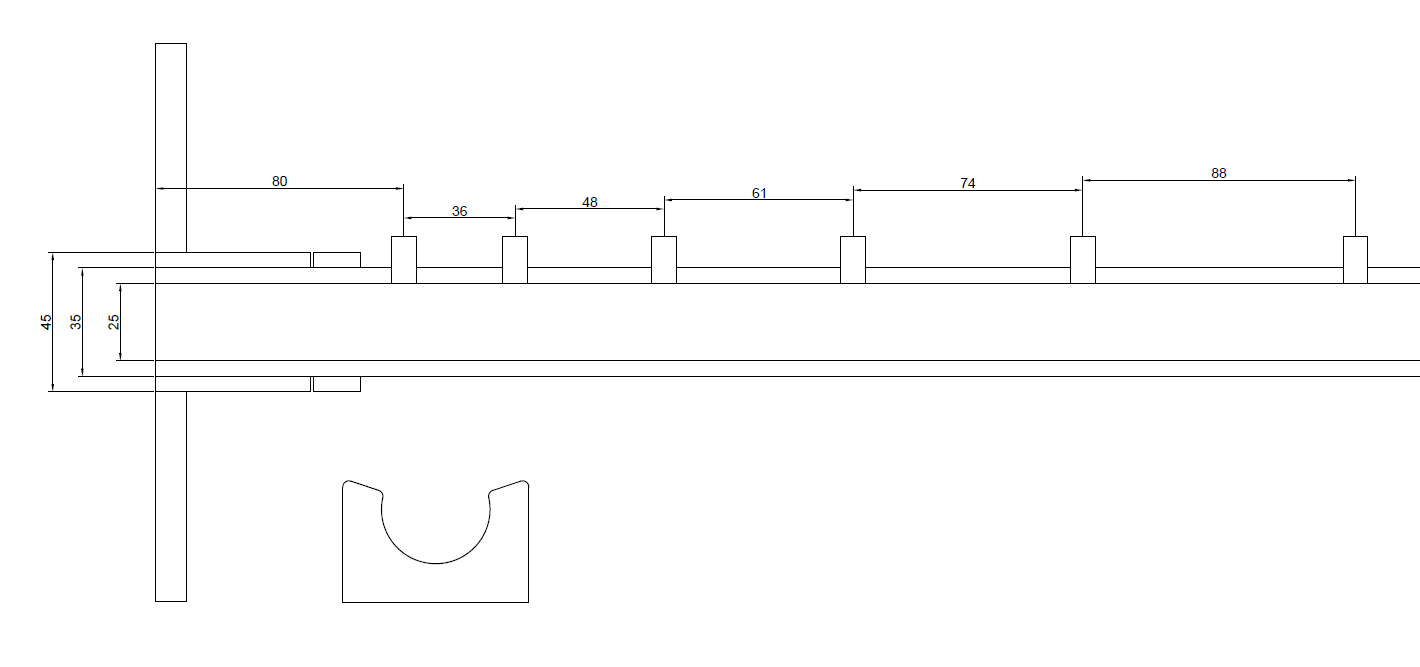

If there are no objections, I'll start with the six mic positions as shown above. I'm quite close to start measuring, only hope Earl Geddes didn't lose his interest, otherwise without his knowledge and mathematical skills I would have made only a limitedly useful construction exercise. 🙂

I have not and will not lose interest, but my abilities to contribute are limited. Almost all of the tools that I used to use are no longer licensed, so I have limited capability to do the complex (literally) matrix manipulations that are required. As I said, the crux will be a singular value decomposition of a 6x6 complex matrix composed of elements that are Bessel functions (maybe with a complex argument.) Those capabilities will be required.
The spacing looks OK, except maybe the largish first distance. The evanescent waves decay exponentially so to get reasonable values for those the mics have to be close. This can be done without the evanescent waves, but that will limit the HF resolution - until the modes "cut-in".

That's great. I think I will be able to perform all the calculations, SVD included, but will definitely need some guidance along the way, at least for the start. I believe it will turn out being not so difficult after all but right now I have only a vague idea how to actually proceed with the data, the modes, etc. I'm really looking forward for this experiment.
I can still move the positions closer to the driver, no problem.

Re PWT - the final touch to the mic positions before drilling. Any comments?
Finally, I have nine mic probes made. Should I reduce the currect spacing for the nine mics or possibly add three more mics later further down the tube?
Have you ever thought about to use the Fibonacci row for the spacing between the mics?
Should I? These numbers were suggested by Dr. Geddes, the author of the method (except the first distance, which is affected also by the construction). I see no reason to question that. My impression is that it is really not that important, only that a regular spacing would not be good. The Fibonacci seems a bit dense at the beginning and then quickly getting sparse. Would it be better? I have no clue.

Fibonacci was only a suggestion! For large numbers the quotient of two adjacent numbers approaches the golden section ratio 0.618.
You could start with 1 and then for each next number divide the previous by 0.618, so 1, 1.618, 2.618, 4.237, 6.855, ...
