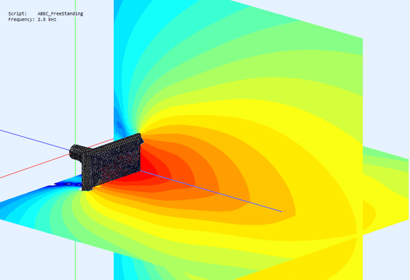

Must not be a bad thing if gradual: then, vertical pattern, looking sort of like a wedge, benefits a DI that has a gradual slope towards HFHoly pattern flip

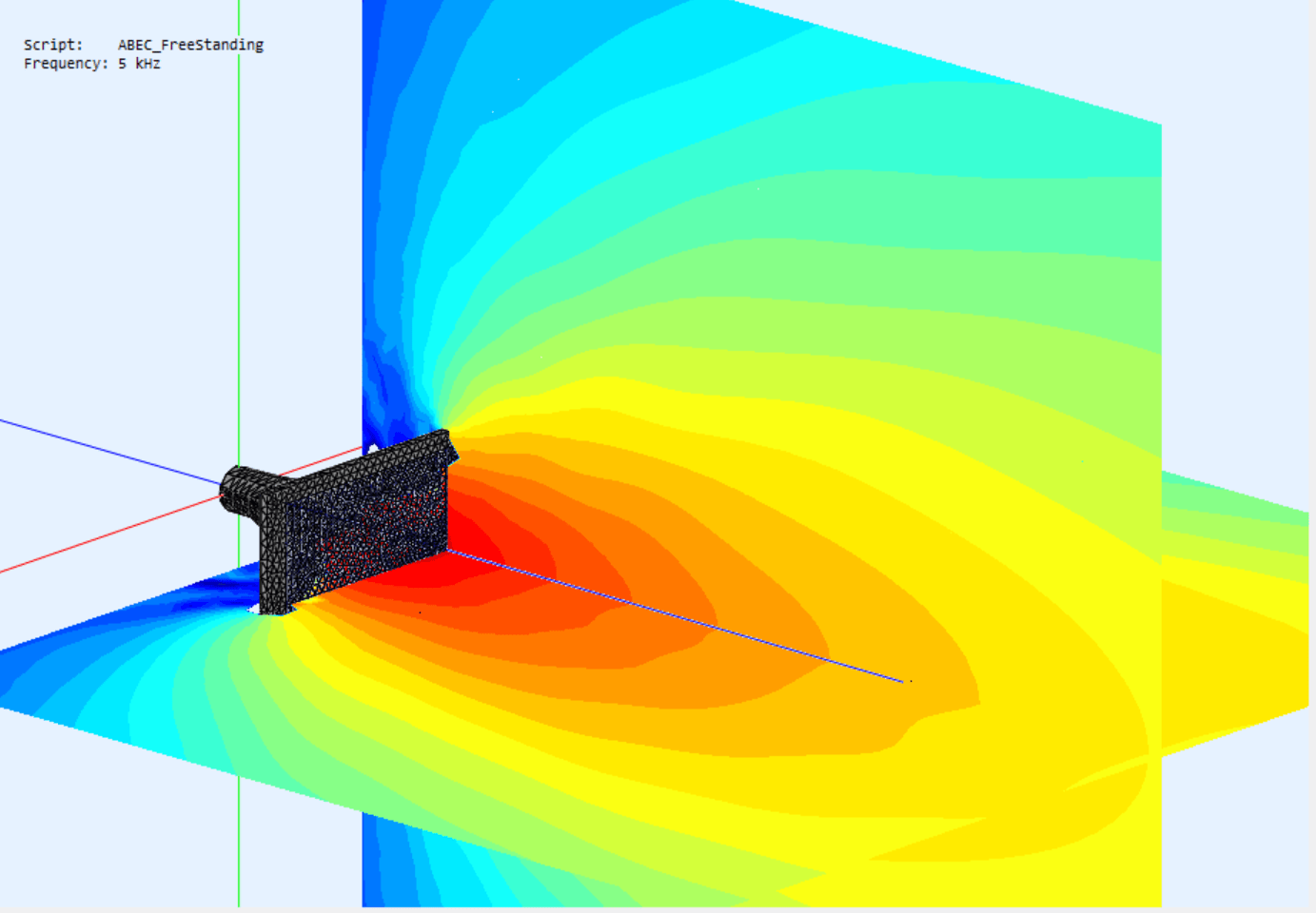

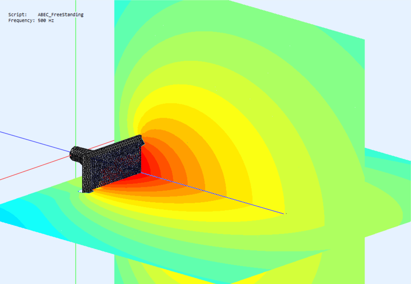

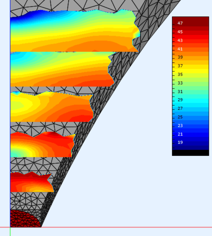

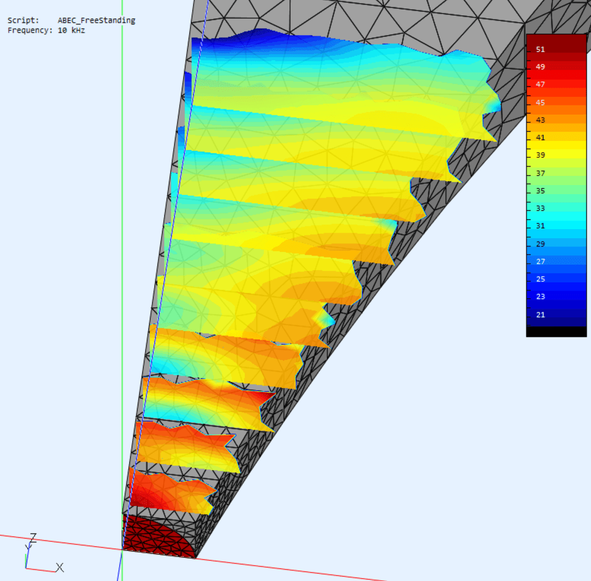

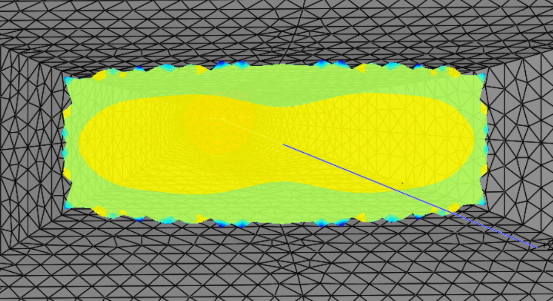

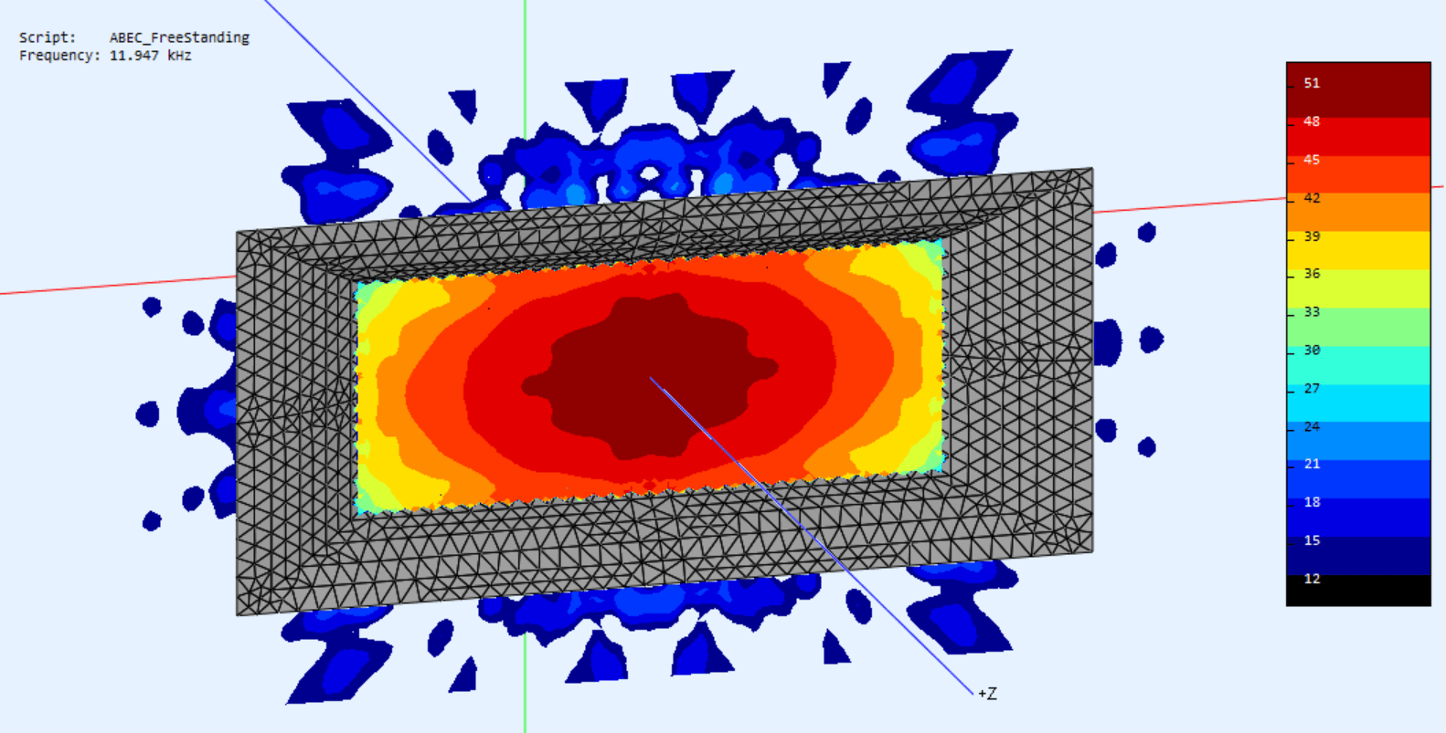

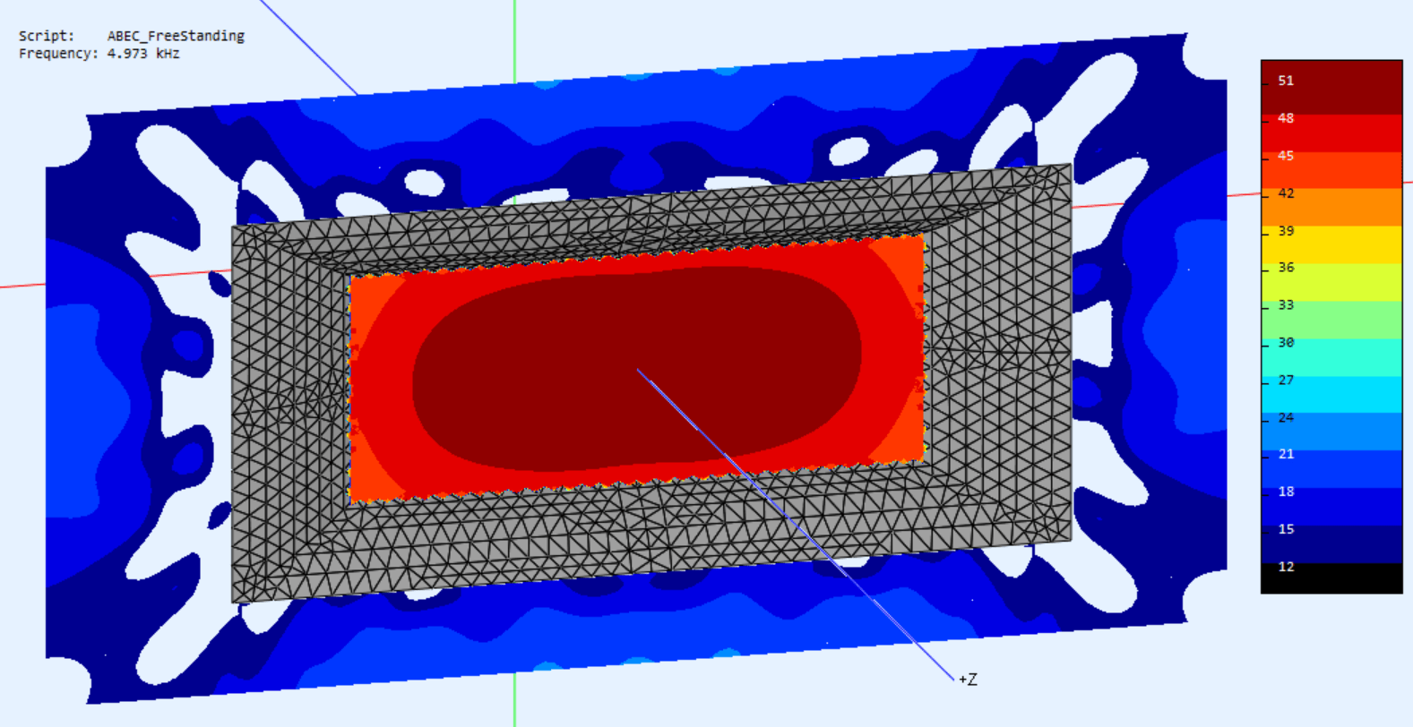

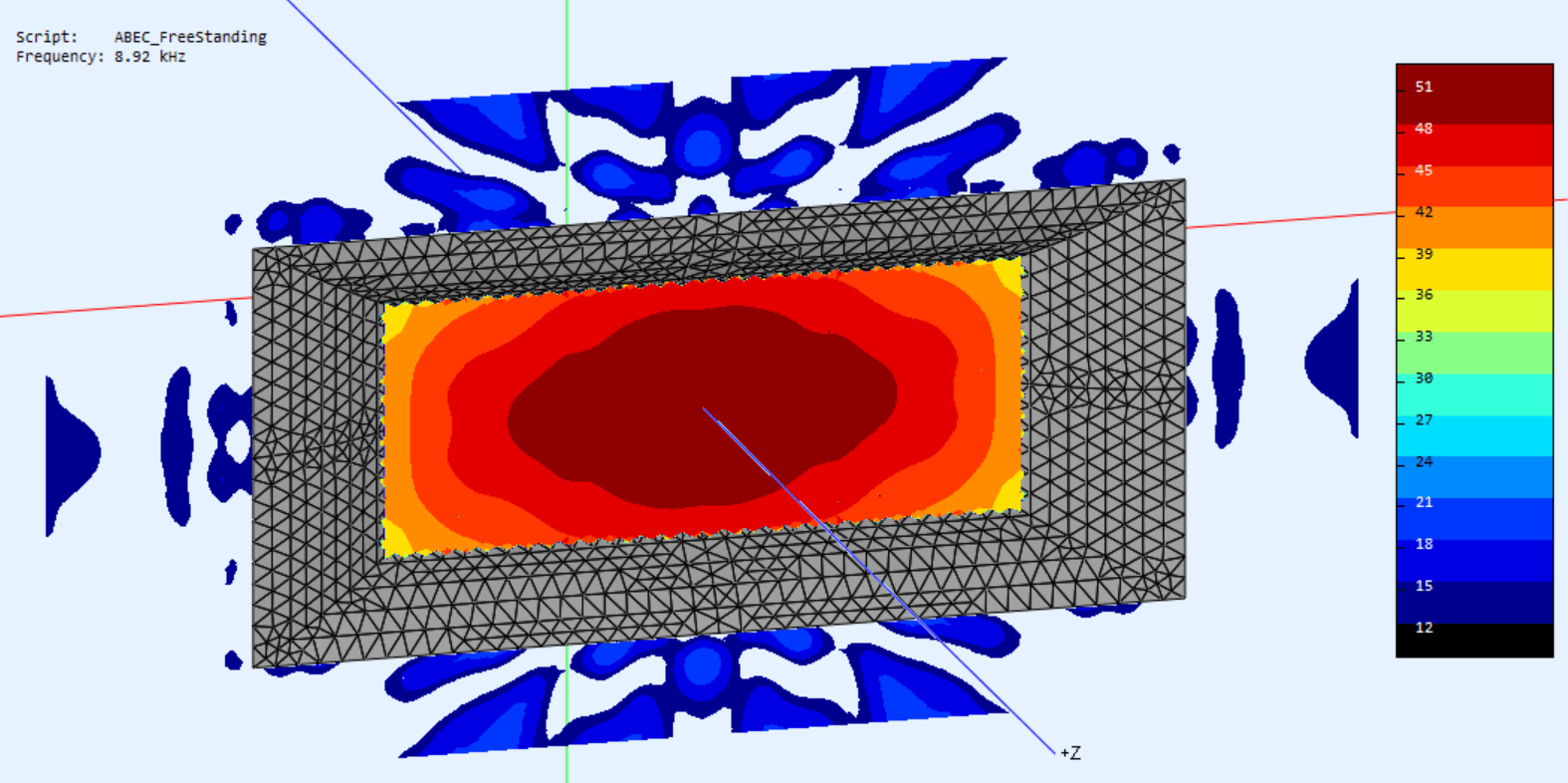

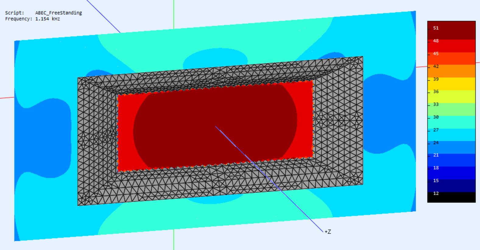

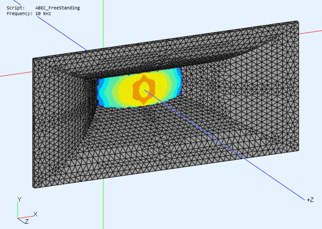

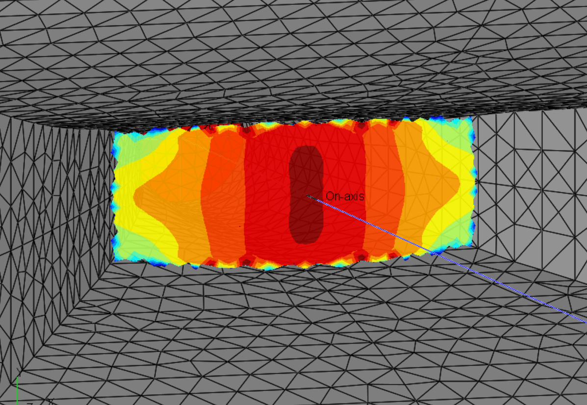

Nice work.Just some pictures - pressure field in a transverse plane near the mouth:
(Frequencies in the upper left corner.)
View attachment 1094586 View attachment 1094587
View attachment 1094588 View attachment 1094589
The lower pressure in the corner supports Tom Danley's advice to place the holes there in a Multi Entry horn.
Could you do a slice closer to the throat and see how consistent that behavior is?

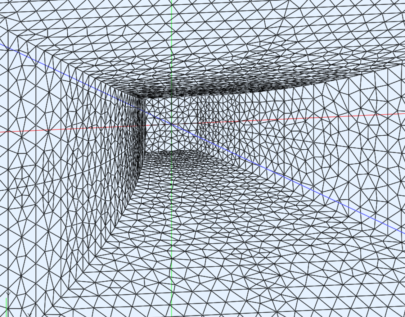

It also implies that a radius fillet in the corner wouldn't make much difference, which is what I expected but nice to see evidence.
So a fillet would be ok if convenient for fabrication, maybe an epoxy to bond the flat plates.
Best wishes
David

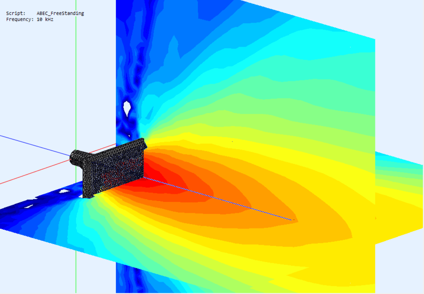

Have you experimented with this if its something desirable over say axisymmetric device? Axisymmetric could have more or less rising DI as well. I've been lazy and haven't exported responses to play with in VituixCAD so not sure what would be better in crossover region. No opinion for top octave yet other than it seems ST260 is more enjoyable to listen to than store bought devices I have, which have more rising DI among some other issues like more edge diffraction in same application (freestanding).Must not be a bad thing if gradual: then, vertical pattern, looking sort of like a wedge, benefits a DI that has a gradual slope towards HF
The pattern flip is fun to watch as its always kind of a surprise I mean, the device looks like it would have narrow vertical pattern as its asymmetric, but the response is almost exactly opposite except on the top octaves. I'd like to test a waveguide that really has narrow vertical pattern, but that also means it would need to keep it to low frequency. Time / intensity trading doesn't seem to be as effective as I hoped it to be and at best good sweet spot where phantom image holds is still kind of small so narrow horizontal coverage would also be fine I guess. Sound is very good through out the room what ever the toe in is, but the image of course shifts and I'd like the throw be better for lack of better terms. Sound is much more focused bit front of my practical listening spot which I bet is at least partly due to ratio of direct / reflected sound.

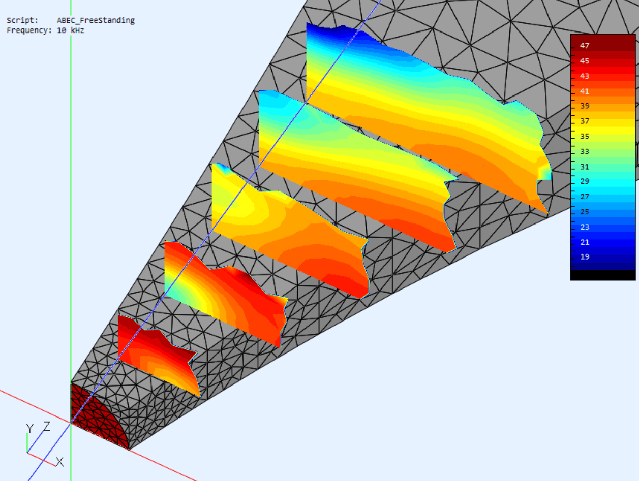

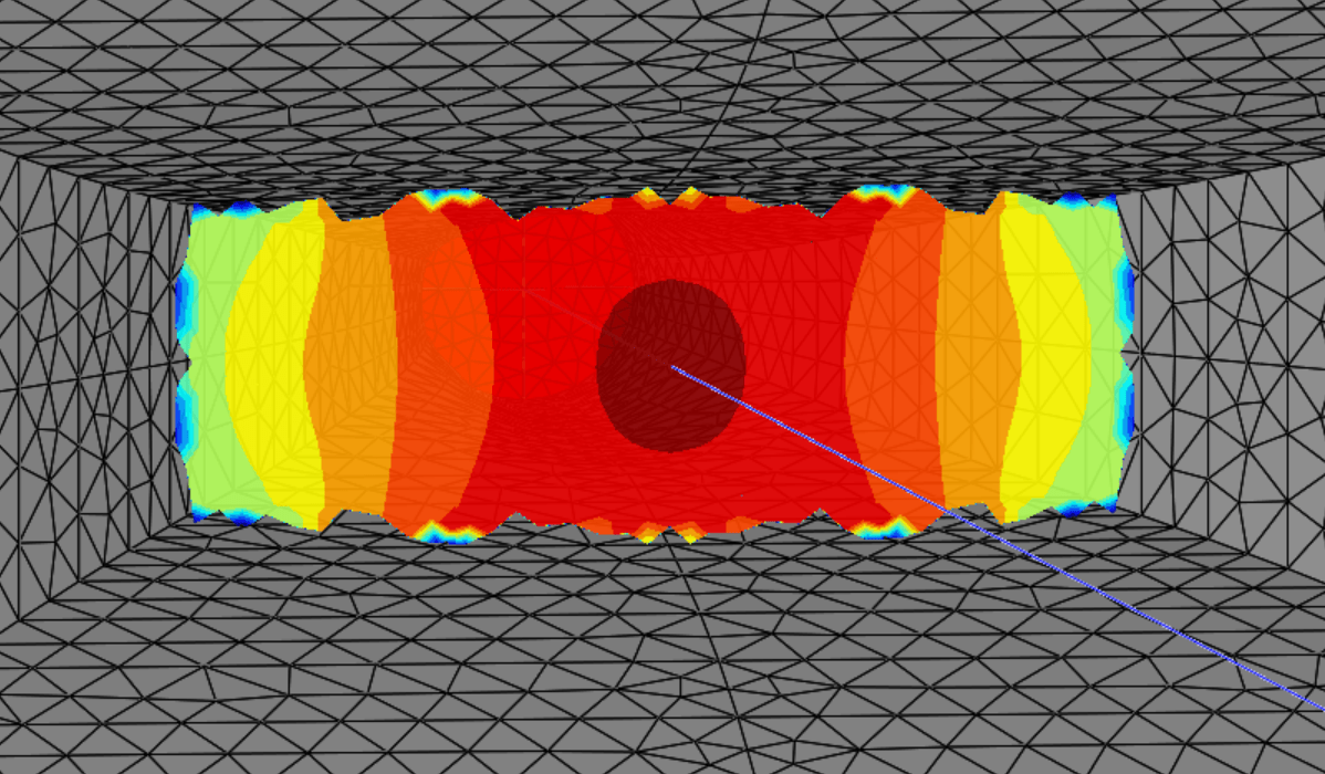

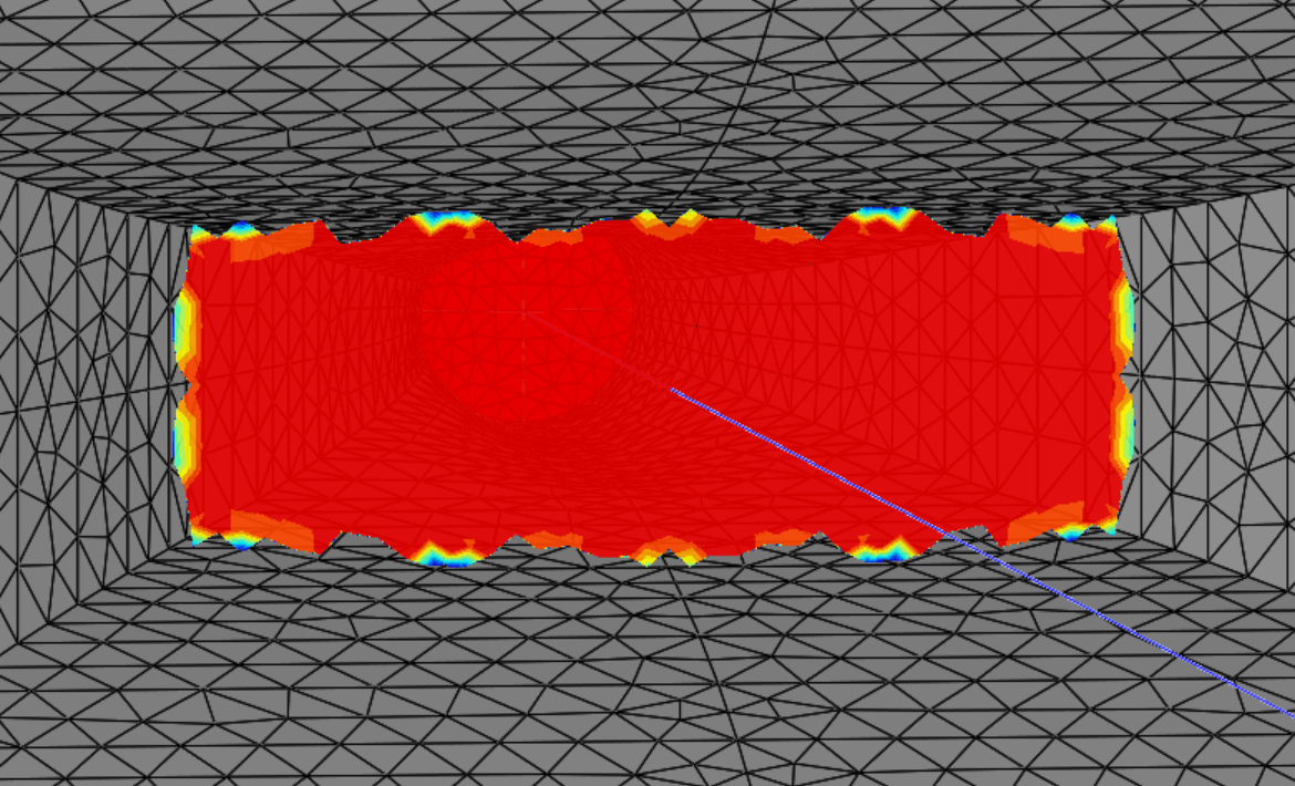

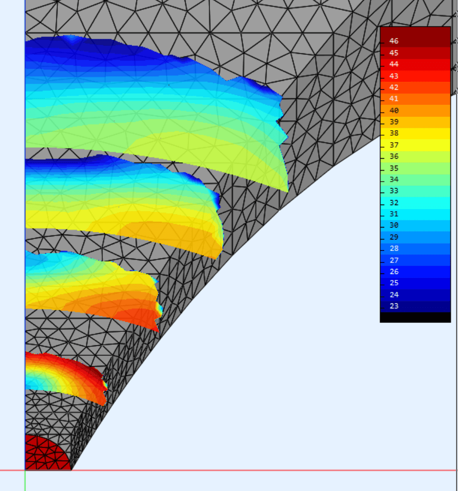

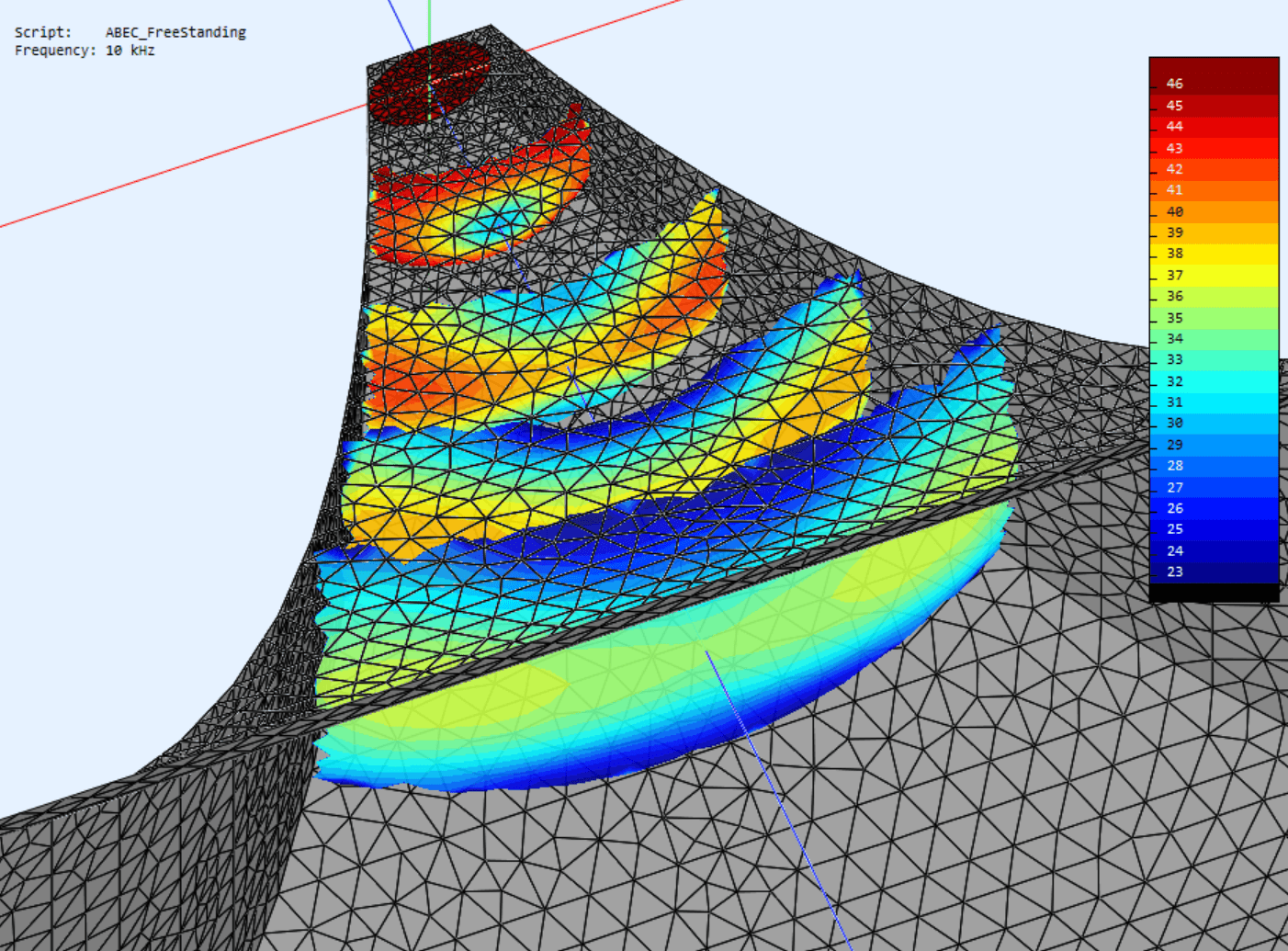

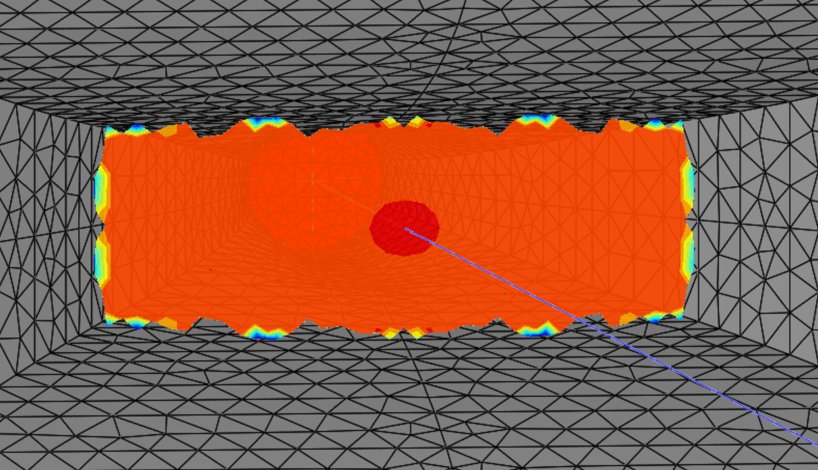

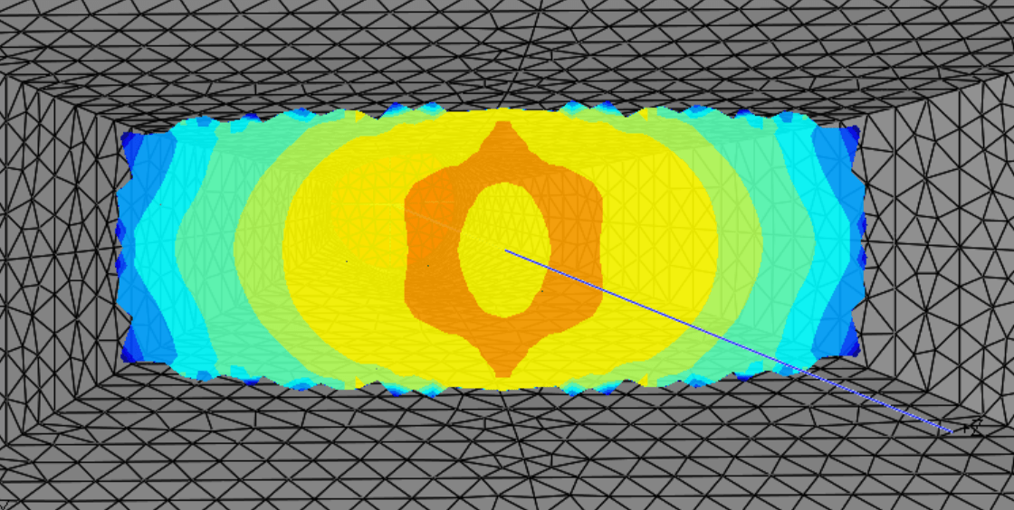

This is approx at the end of the adapter (12 cm from the throat):The lower pressure in the corner supports Tom Danley's advice to place the holes there in a Multi Entry horn.
1.8 | 4.3 | 10 kHz, 1 dB step

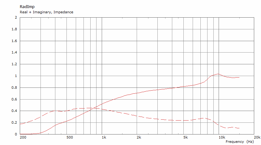

BTW, with the throat adapter removed, i.e. with the bended walls starting right at the throat, the acoustic impedance is really this gradual - perhaps for a passive crossover this can have some advantage. It has some issues on HF though, I'm not sure it's worth it.
