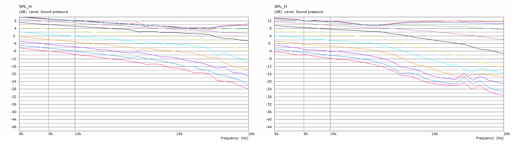

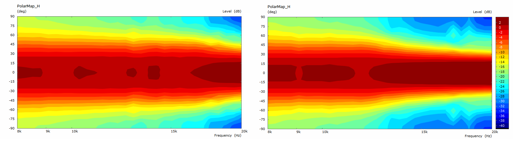

the graph on the right (when 2 graphs shown), that is the non knuckles ?
Response looks really good to me (compared to so so much) on the non knuckles.
what are the graphs, left to right again ? vertical, horizontal, diagonal ?

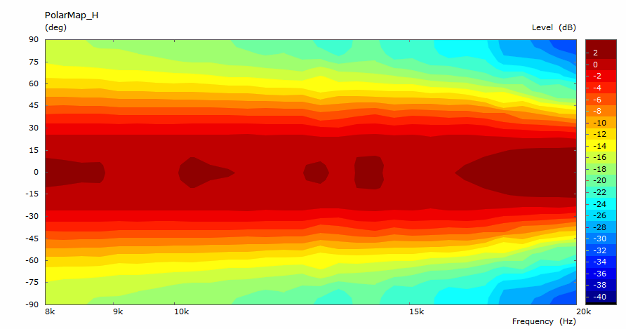

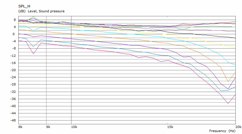

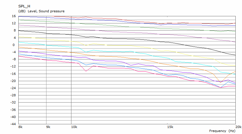

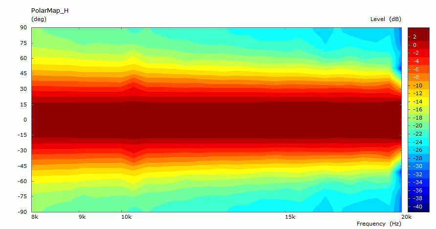

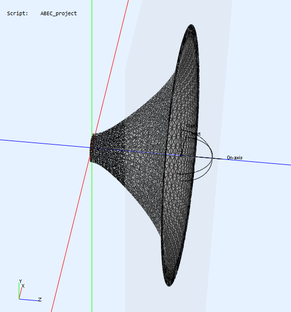

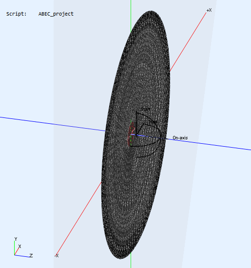

OK, I just quickly simulated the following two cases:
a) 175deg OS waveguide, i.e. almost a flat baffle, which is really the limiting case for an OS waveguide as coverage angle approaches 180deg;
b) 90deg OS wavaguide.
The pictures will follow...

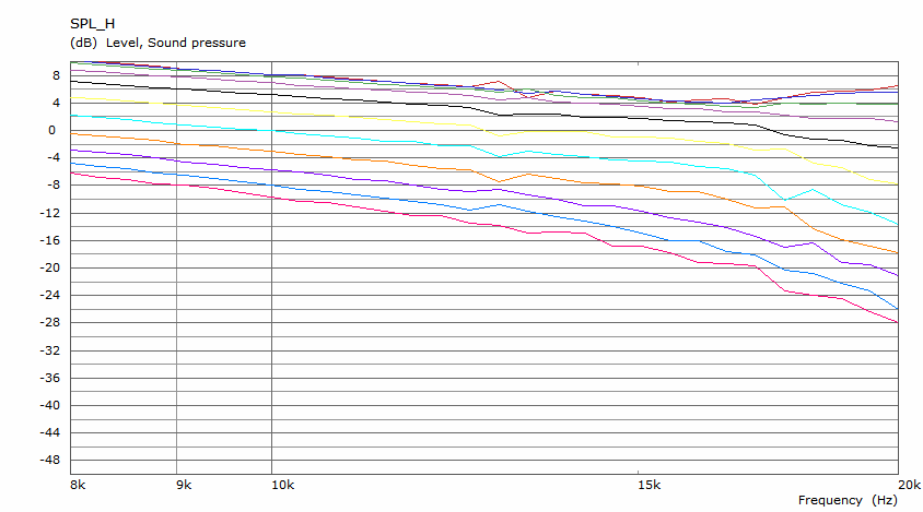

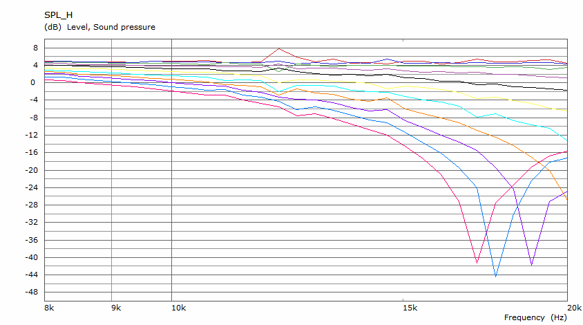

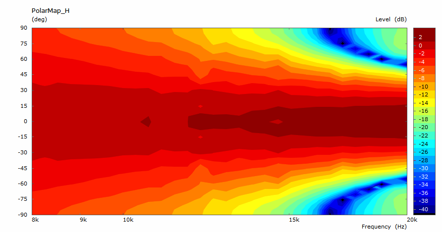

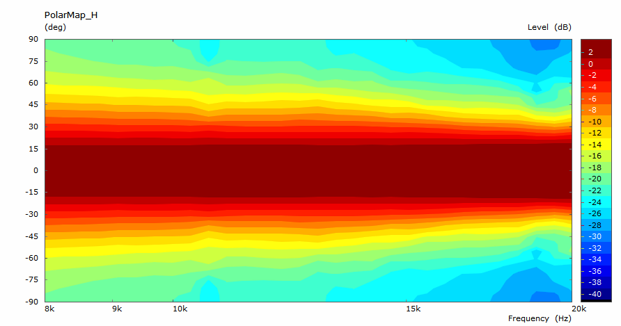

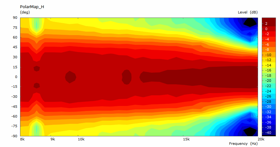

A "flat baffle" case (175deg coverage):
Since the flat baffle is the limiting case for an OS waveguide as the coverage widens (up to 180deg), there must be a continuum.
Any comments or suggestions?

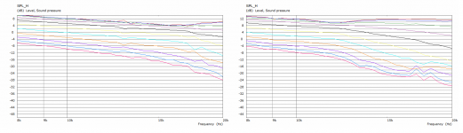

- Does anyone know how to thicken the plot lines in VACS?

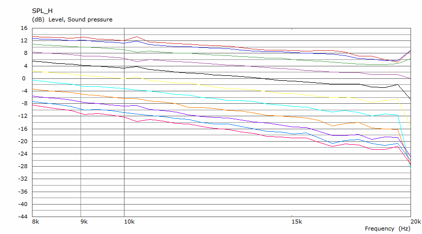

Seems the over 10K response is smoother without the big dip in the M2 clone, could you extend the sim to go to 20K to see it better?
I can but it makes a huge difference in BEM running times. I try to limit the mesh resolution as possible to speed things up. There's still a lot to look at and improve between 1k - 10k. IMO, there's too many unknowns above 10 kHz that it makes little sense to try to simulate it this way. I can try occasionally. This might be an interesting case.
I think the pattern is obvious (and it has been said many times) - as the coverage angle is increased or the throat made larger, the lower in frequency come all the HOMs into play - the device deviates from constant directivity of a pure spherical wave. The flat baffle being a special case of the maximum coverage angle, i.e. the worst case for a given throat size.
Mabat
Thanks for those plots. They prove what I have said from the beginning: that a waveguide does not have the polar limitations of the source. This was predicted by the theory, shown by my measurements and now again shown by simulations. I hope this puts this incorrect belief to bed, Finally!
The waveguide does narrow as the angle is made wider, but this is not driver dependent at all. In reality driver wavefront coherence degrades at the upper frequencies and that causes reality to differ from the theory, but this is due to the inability of specific drivers to maintain a flat wavefront. It is not inherent in the design itself.
