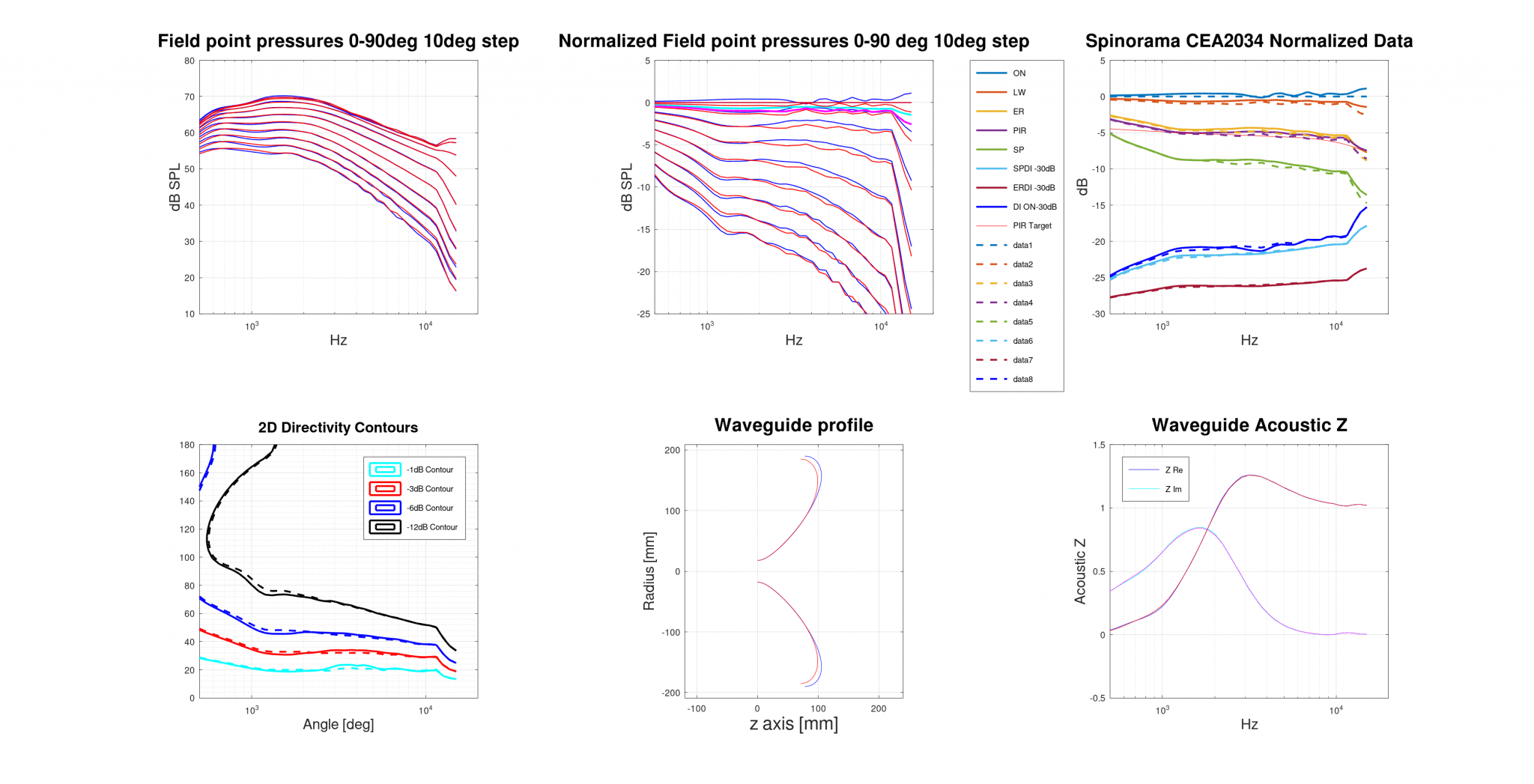

Just for the sake of it I ran my optimizer on the example provided in the document.
Calculation time: about 15min.
Code:
R-OSSE = {
R = 185.0778 ; [mm]
a = 39.65450 ; [deg]
r0 = 18.00000 ; [mm]
a0 = 0.000000 ; [deg]
k = 0.97464 ; []
r = 0.31653 ; []
m = 0.81689 ; []
b = 0.37050 ; []
q = 3.77180 ; []
The comparison normalized to 00deg which is what I tend to use because, ideally, one would neither want to compromise the performance on nor off axis
The same but normalized to 10deg which is what you seem to prefer
From what I can see the optimized version
- is smoother on axis (DI ON and 1dB contour comparison),
- does not have as pronounced a pinch in the lower range of it pass band
- looks a bit more ragged when normalized to 10deg (I guess your optimization and mine are diverging there on what should be used)
Since I am still looking for a "standard" fitness function, which one do you think is the better compromised?
Also if I am not mistaken the through in the DI on seems to coincide with the depth on the WG, it that a correct observation?
There's a very good reason NOT to normalize to 0 deg. When doing so, you risk distortion of the presented data by differences that are not significant. I would say this is also the case in the example above - there's almost no real (meaningful) difference between the two. The 10deg-normalized plot shows this a lot better, IMO. Honestly, I don't think anyone could distinguish the two just by ears.
I can only say that if you make the waveguide larger (overall), all of this just shifts lower in frequency. The depth alone is not directly related I think (as it's not in many other things, like e.g. to "loading").Also if I am not mistaken the through in the DI on seems to coincide with the depth on the WG, it that a correct observation?
or even better; define a listening window ( i.e. 0 to 15 deg), by energetic averaging and normalize to thatThere's a very good reason NOT to normalize to 0 deg. When doing so, you risk distortion of the presented data by differences that are not significant. I would say this is also the case in the example above - there's almost no real (meaningful) difference between the two. The 10deg-normalized plot shows this a lot better, IMO. Honestly, I don't think anyone could distinguish the two just by ears.
The thicker lines cyan and magenta in the normalized plot (top middle) of my dashboard are the LWs (Listening Window as defined in the CEA2034), they also are ploted in the spinorama plot (top right).True, only not always readily available in the tools. I already thought about implementing just that in the Ath report.
I understand what you are saying about audibility, and I am not in complete disagreement.There's a very good reason NOT to normalize to 0 deg. When doing so, you risk distortion of the presented data by differences that are not significant. I would say this is also the case in the example above - there's almost no real (meaningful) difference between the two. The 10deg-normalized plot shows this a lot better, IMO. Honestly, I don't think anyone could distinguish the two just by ears.
Whether significant or not is not really what I was after.
My computer only has the “ears” that I program into it i.e. the fitness function of the GA procedure.
It is easy to go from something horrible to something acceptable but it is much more difficult/subtle to start with something already good and improve it further. This is where optimization ought to shine. The great thing about it is that the PC is doing the hard the job (240 iterations is this case). But the fitness definition is obviously critical there…
The question was more: does the optimization provide objective improvements? Or plainly does the fitness function I used is on the right track?
I would tend to think so, but I wanted your opinion.
I also fully understand the 00deg vs 10deg normalization but I am trying to push the compromise as far as possible with the tools at hand. Dr Geddes got tons of (undeserved) stick for the ON vs Off axis performance of his speakers, you’ve improved the whole thing, or at least made it way easier to design, with the smooth termination of the WG.
I want to see how far that can be pushed before I (me and myself) compromise on the ON performance which is different from disregarding the ON altogether (I am not saying this is what you advocate…). Again, here I am been unreasonable on purpose.
As for the optimization target, perhaps I would try the DI for the listening window average, as was mentioned. I gave up my own experiments in defining this rigorously and ended up with just looking at random results and manually selecting the subjectively best ones for another round (and typically it won't get any better -again, subjectively- after that). The three-dimensional nature of the problem makes the effort to come up with a one-dimensional optimization metric complicated, if not impossible - that's just the way it is.
- When I look at the data, the three DI curves for 0, 10 and 20° together tell a lot. That and the -1, -3 and -6dB (re 10°) polar map contours. If all of this is nice and smooth, I know I've reached my goal. Perhaps it could be expressed as some number, I don't know.

The SPDI in my spinorama plot is just that...As for the optimization target, perhaps I would try the DI for the listening window average, as was mentioned.
So what exactly is your fitness function at this point?
In the end you have to compare two results and be able to say which one is closer to the target, so you need a one-dimensional metric - a "distance" from the reference. I can't see how you could run any optimization without that.
You just need to describe a complex 3D problem with one number. Maybe we do it subconsciously (based on our experience) when looking at the data and trying to figure this out, I just gave up trying to formalize this - the foremost reason being that I don't need that. I have no doubt that some AI solution could be as good at this as skilled humans. Or maybe you'll find a simple and working solution. I can imagine e.g. a simple optimization for a SPDI target working good enough in most cases.
Sorry I am a bit thick, I just do not get your concern about the dimensions.So what exactly is your fitness function at this point?
Here is an example:
CarFitness = f( comfort, number of seats, speed, economical to run, price, size, looks, … )
Dimension 1 comfort affected of weight 1
Dimension 2 number of seats affected of weight 2
Dimension 3 speed affected of weight 3
Dimensions comfort and size are not independent (orthogonal) so aren’t dimensions size and economical run via at least the mpg.
Multidimensional function yields a single number (the metric) used to rank the candidates.
The metric is optimized to maximize its value with no bound i.e. ideally we want Inf as the fitness.
As I said turning the subjective comfort dimension into a number can be difficult but (sub)metrics like the NVH are a valid model.
In fact, Carfitness@Maiky is probably different to Carfitness@Mabat so would be WG@hifi is different from WG@Stadium, both the dimensions (attributes) and their weights will probably be different
What I am using now is driven by PIR smoothness and LW to On relationship
This is what I'm talking about. So how do you get to this number in your optimization at the moment?Multidimensional function yields a single number (the metric) used to rank the candidates.
Whether it is maximized or minimized is just a matter of a particular case. It can be anything - often you want to reach some target value, so you want to minimize the difference (error). The point is that you need a single number for that.The metric is optimized to maximize its value with no bound i.e. ideally we want Inf as the fitness.

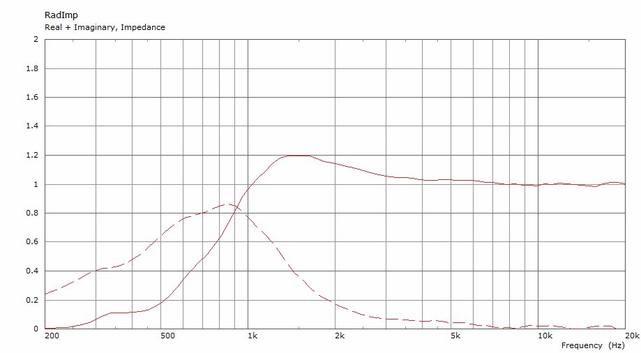

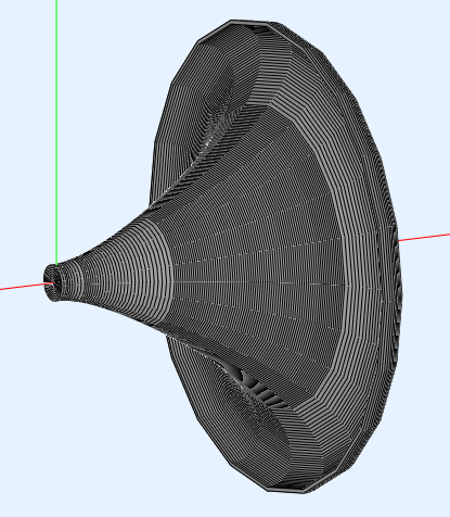

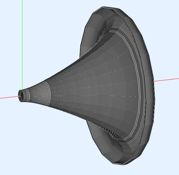

How low would you cross this horn?A little shorter/more open (ø610 x 350 mm) -
