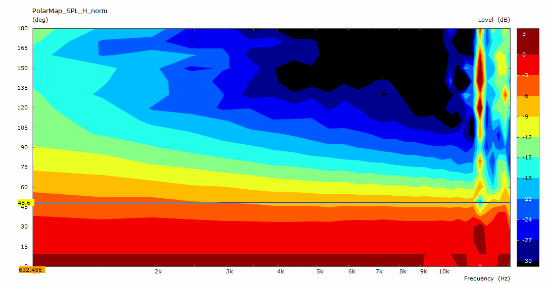

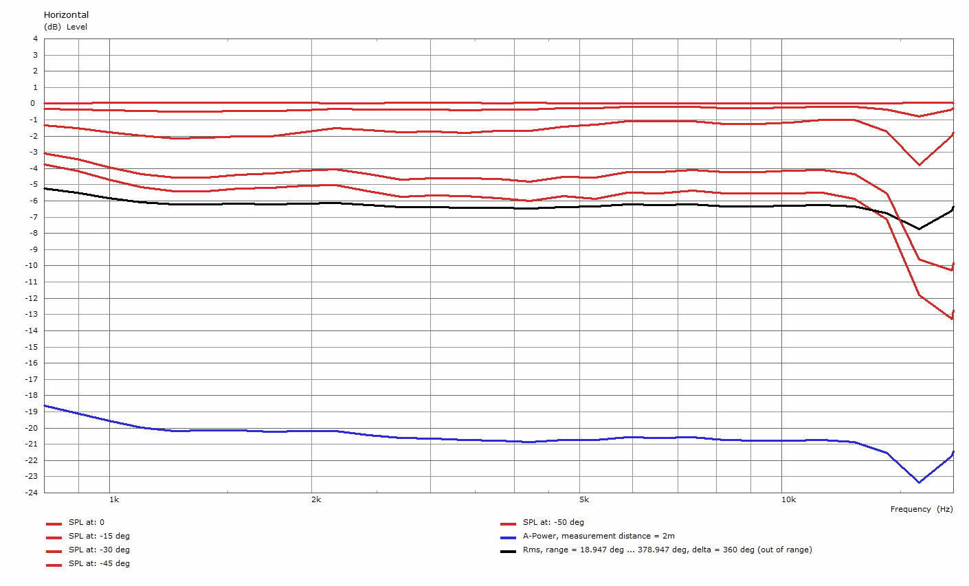

A few results from a daytime run.

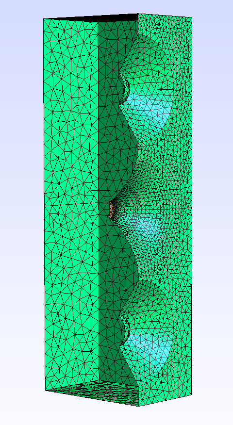

After removing the interface, with a full enclosure there still appeared some spikes in the HF. But the good news: over most of the simulation, the results stayed the same, any differences are probably attributable to the additional enclosure surface. So the spikes can be ignored:
quarter symmetry:
half symmetry:

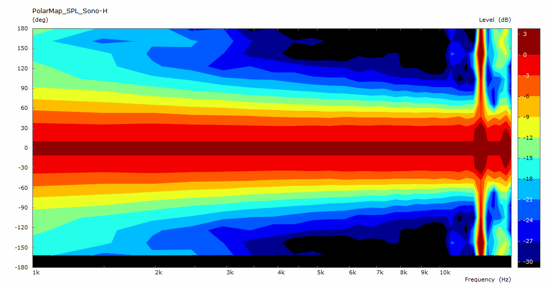

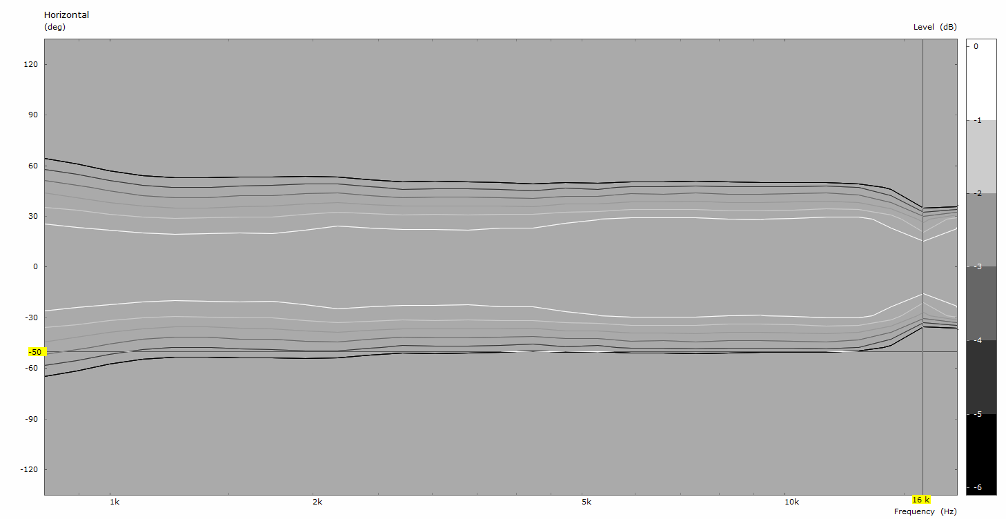

The pattern is generally a bit more compressed, losing some degrees of coverage. What a pitty, must I widen it again. One observation I found most interesting, when I looked at SPL graphs: Most of the off-axis excess bump that we see with an enclosure is happening at only a few angles, 50 and 60 degrees in this case (orange, lilac):
Overall performance s'well:
horizontal

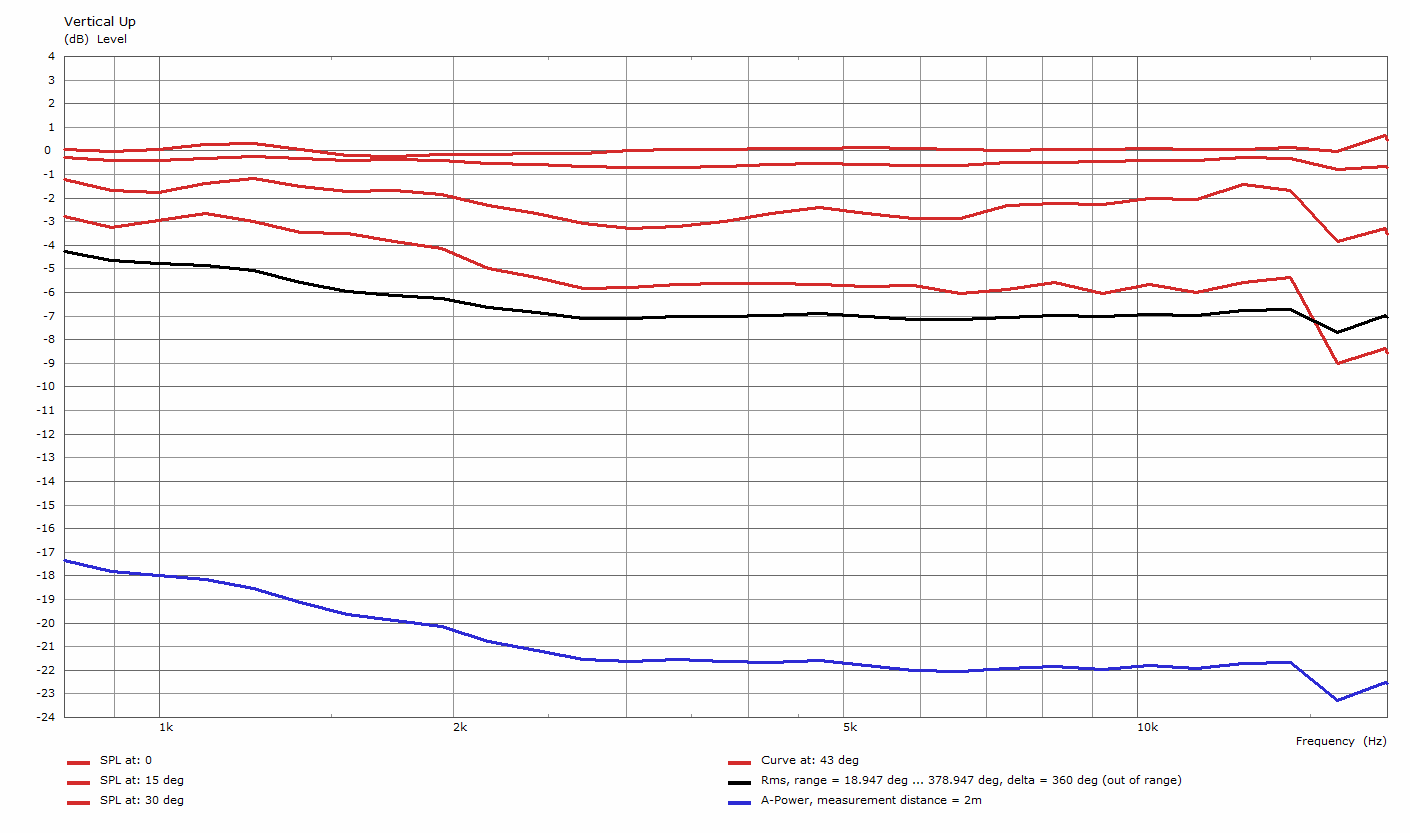

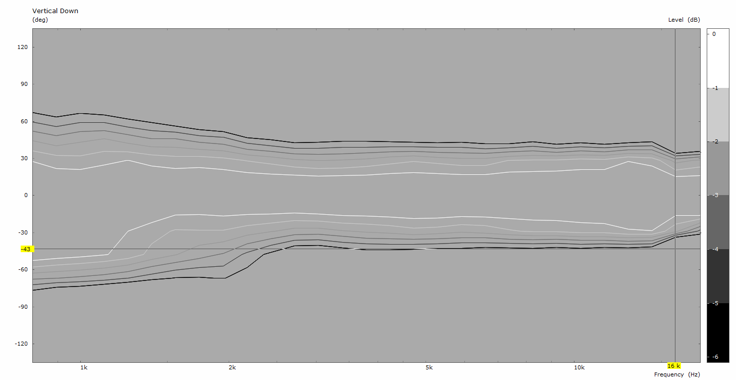

, vertical with known issue.
Btw, the pattern of the vertical up does not widen to much, so it competently controls almost to the crossover frequency. This is good.

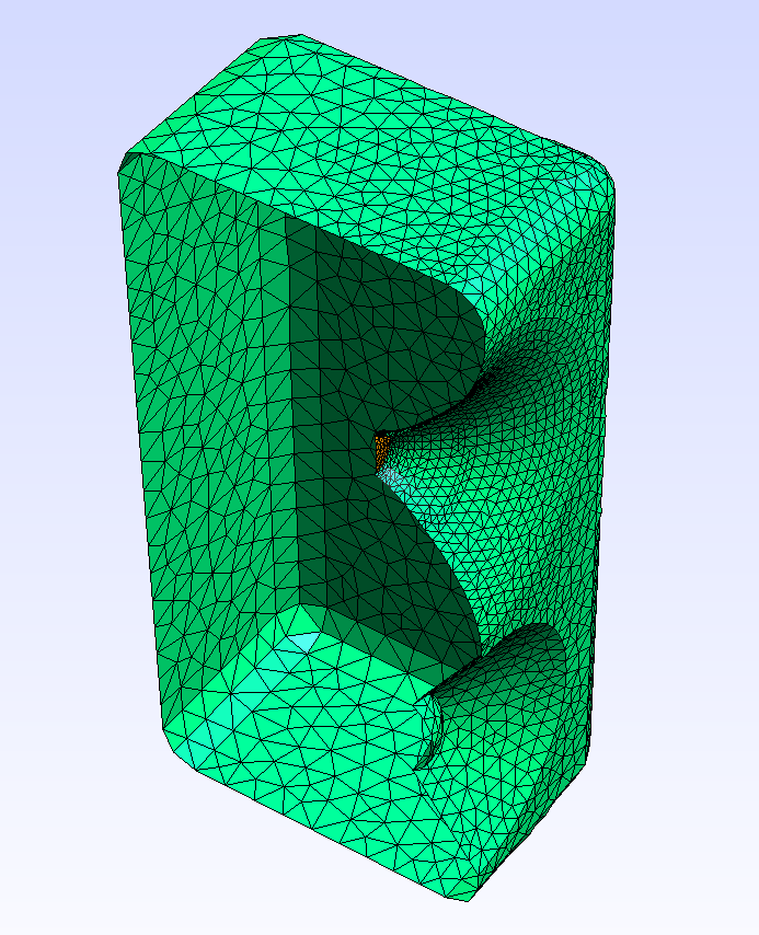

Is that not possible to define an enclosure this way:
Also the first Spacing value is ignored in this case?

There is possibly not a command with which one could disable the rounding on the back wall corners?
- Now I need to find a way how to make the woofer a second source. Then the full polar data for a crossover simulation could be generated. That could answer a lot of questions regarding power response wrt a MTM setup, etc.
For woofers it is quite obviously different when looking at field plots but not for waveguides.No, as the effect was shown to be very small.
You can create a custom plan with and without the back rounding. At the moment, it only won't be rounded at the top/bottom (that's still in the pipeline).

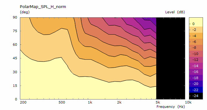

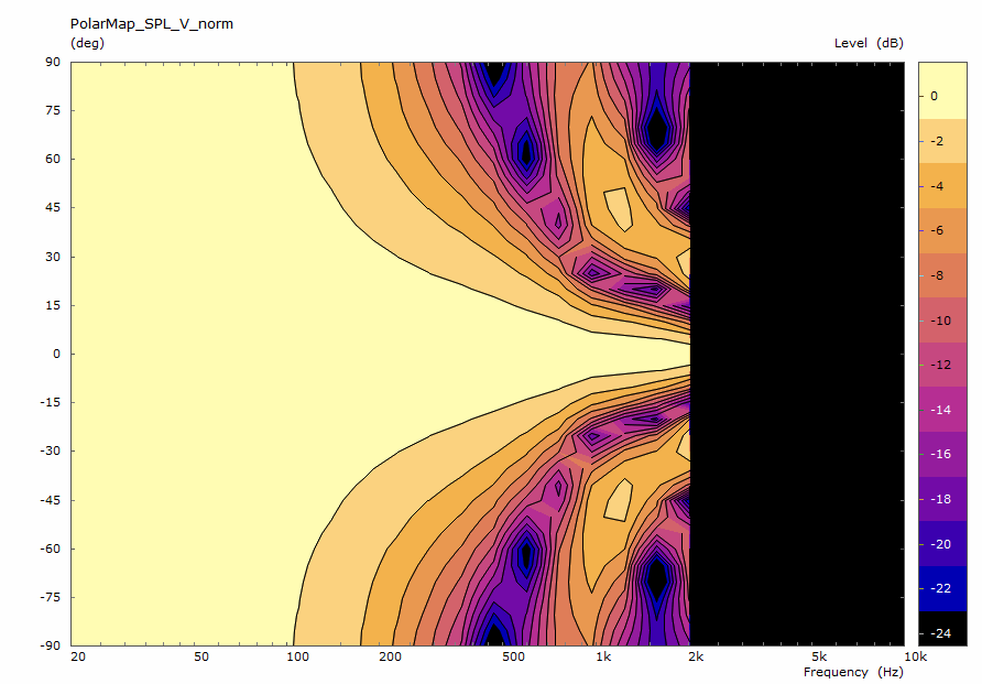

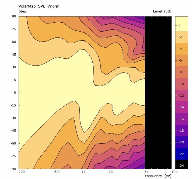

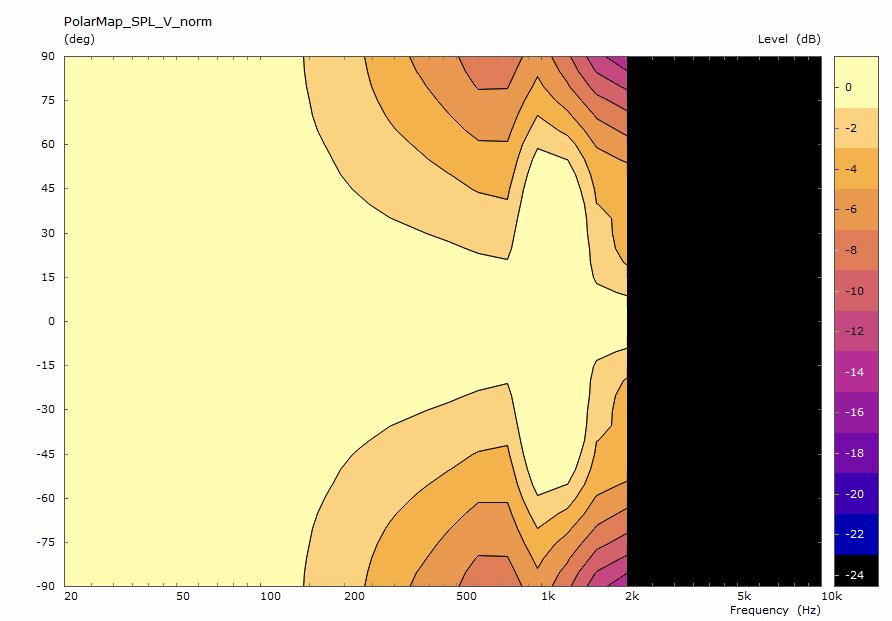

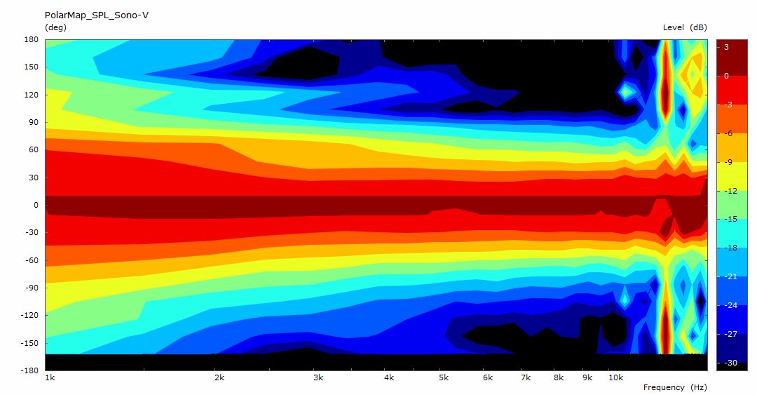

BTW, vertical polars of the above, just the woofers driven (246 x 586 x 200 mm) -
The same for only the WG driven (both polar maps normalized on-axis).
(Obviously not a good match.)

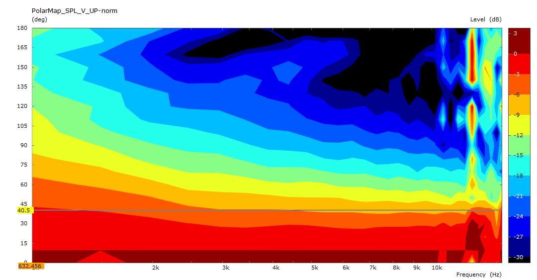

Speaking of, thanks again, mabat. After I had the chance to see the waveguide in an enclosure, I think that within its limits, it does exactly what it was intended to do, and quite competently. In my currrent enclosure planned, it allows for a 29 cm separation, which is around 1.1 lambda I guess.

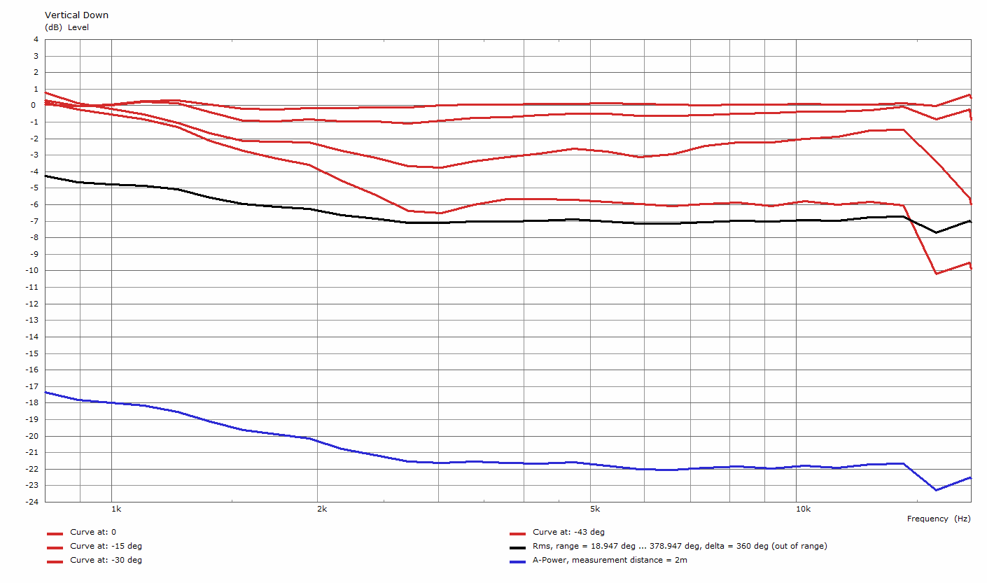

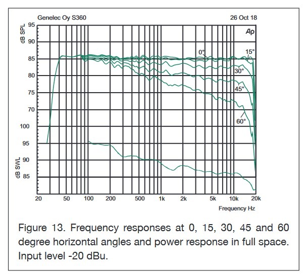

I am rather concerned with my own design assumptions. I have created a flat directivity index. The vertical pattern could be a bit brigth, when looking at the off-angles.
I am thinking of doing another version with a mild tilt. Can someone tell me: the A-Power and Rms curve do relate to? Rms can be set to 2Pi, here it is full space.
Edit: one more question, is it possible to see the combined power response of all both horizontal and vertical axes in VCAS? Which BE-Spectrum command brings me there?
View attachment 1040394 View attachment 1040395 View attachment 1040396

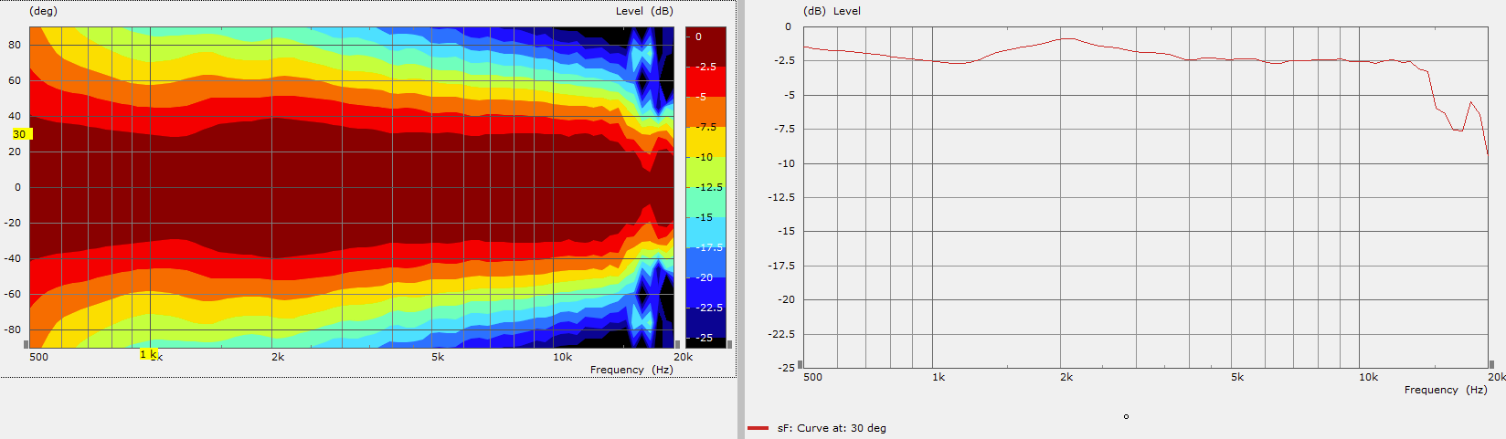

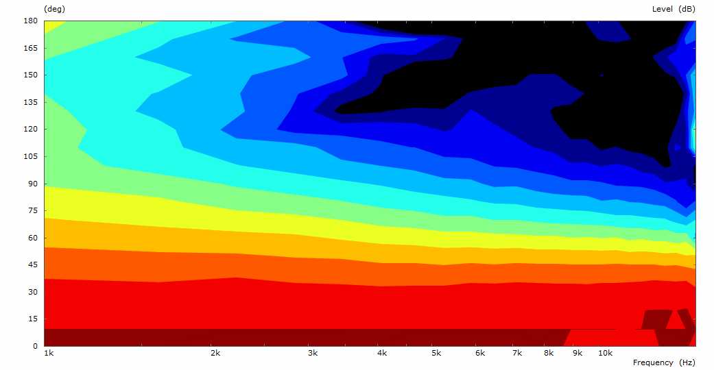

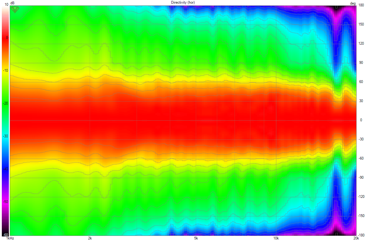

I’ve tended towards fig 10 & 11 in @gedlee directivity paper. I made the choice for a 3:2 ratio rectangle and tweaked for what seemed forever to arrive at Project2 waveguide. Still not quite there. Project3 maybe…. Love your grey/white charts by the way!

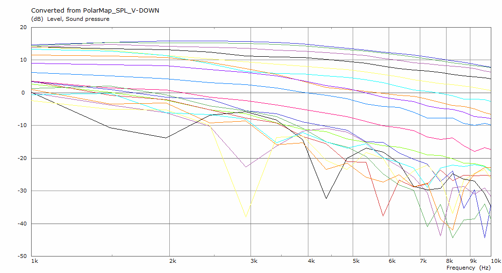

I’m running a few tests 1K-4K to see if there are any mesh settings causing this bump. Cabinet horizontal attached. I tried to match SEOS chart style and range.
Yes. In did this after the JBL PT-waveguides, they where not narrowing all the way up,so flat!!
and I knew how they sounded.
However, there was much discussion about the need to attenuate the listening axis. Other manufacturers than JBL obviously prefer a narrowing pattern for their controlled directivity waveguides:
So I came to question, if a flat DI is really ever so nice. Something with a slight tilt, maybe, not too much.
Note that my scale was set to +135/-135. A had forgotten to change this after I went for the new chart style. Yours would look better this way, too. Also, your low cossover point is accentuating diffraction. Have you tried to export the spectra from VCAS and combined the waveguide polars with your woofer polars? Search for vituix in this thread and you will find a renaming script from fluid to import the curves into VCad.

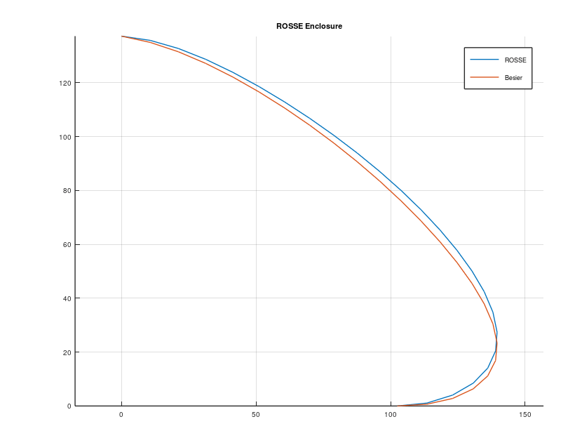

Is there a way to export the enclosure plan and to compare it against what is expected?
I tried this:
And I got this:
While I was expecting this using an implementation of the Bezier function from Octave:
I tried this:

And I got this:
