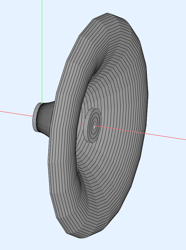

Put this in the configuration file somewhere
That works with the F360 addon included in the Ath package.
You could get the profiles as well by changing that to 1 if you wanted them, but slices usually works alone.

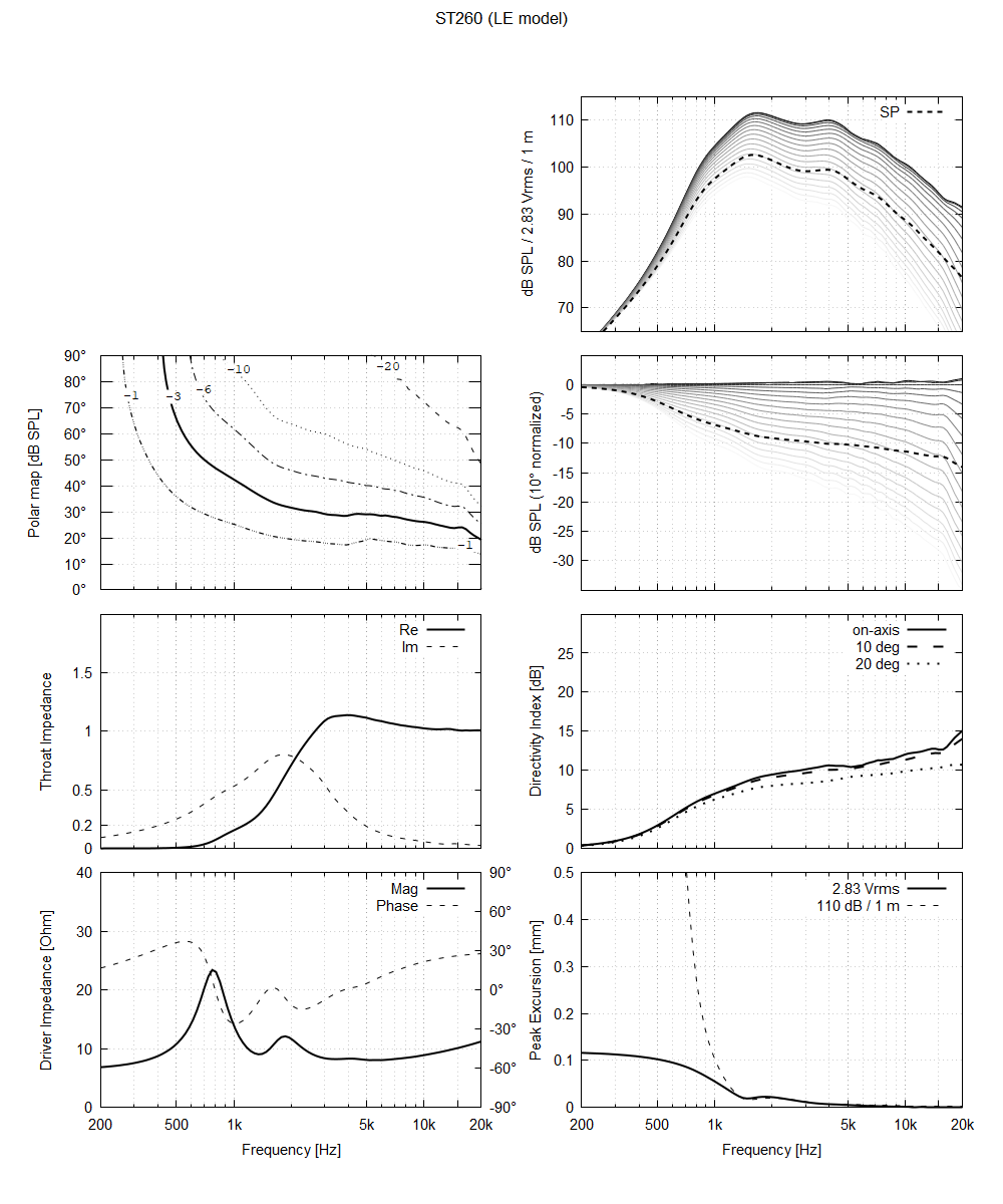

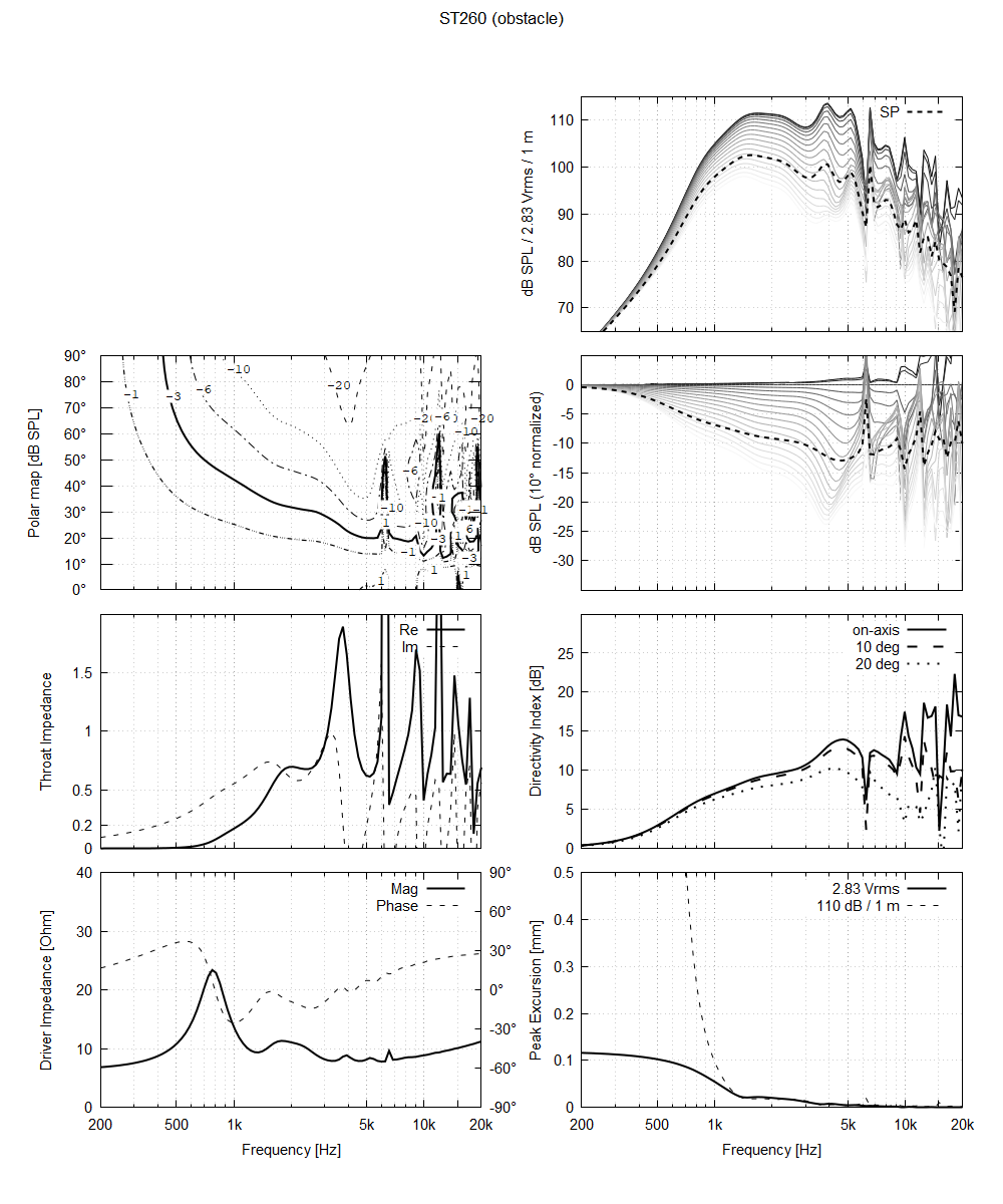

I've tried just that - simulated the exit conical section of the driver as a 1) part of the LE model, 2) part of the BEM model....I'll try to test what difference that makes.
The result surprised me a bit, maybe I'm doing this wrong. What changes is the throat impedance but it virtually doesn't affect the absolute SPL response. I would expect the reflection to have a bigger impact on the overall response/efficiency, at least around the impadance peak...
This is the modified LE model without the exit section:

What changes is the throat impedance but it virtually doesn't affect the absolute SPL response. I would expect the reflection to have a bigger impact on the overall response/efficiency, at least around the impadance peak...![]()
One shows the radiation impedance at the throat exit and the other shows the radiation impedance at the end of the phase plug. I think it makes sense that these would be different. The radiation impedance at the diaphragm should be the same in both cases (at low frequencies, anyway).
Hmm, I missed these are impedances at two different places along the "same" device. But for some reason I thought that the reflection caused by the wavefront mismatch (at the exit cone/wg junction) couldn't be seen by the LE model. That it takes BEM (the actual wavefront calculation) to reveal that (?).
My understanding is that only the fundamental mode is modeled in the 'Waveguide' LE component, but it should otherwise be the same. The LE model still 'sees' the sudden expansion at the throat.
Thanks, I should have guess that. Yes, a lumped element model would only contain pressure, everywhere at the aperture the same.
and volume velocity.
Acoustical impedance = pressure / volume velocity

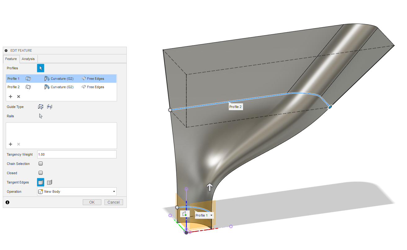

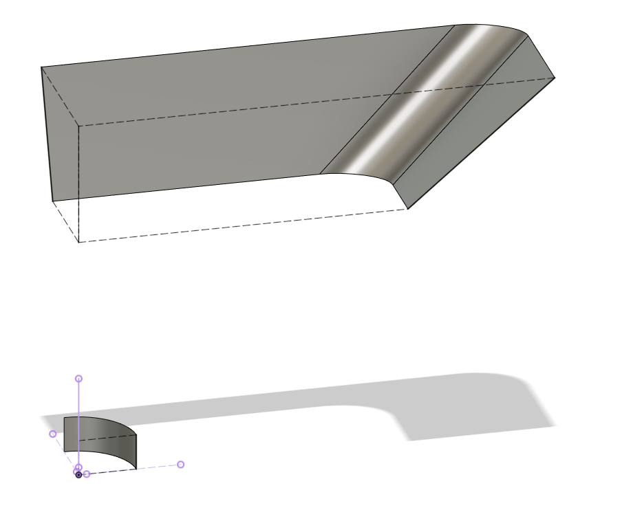

Reading back through this incredible thread I stumbled across this line of discussion, in which modeling continuous surfaces within Fusion 360 appears to have been a technical limitation for some users -
Fluid gives excellent advice here, rails are a good option. However, there is another tool which may be helpful to some - if you use that same 'loft' command within f360, but select surface edges instead of sketch curves, you are presented with some extra switches and levers that you can throw to get to a nice surface.
Screenshot examples are attached below. First of all, we are looking at one quadrant of a waveguide - it's nice to take advantage of symmetry when you can, also it's easier for the software to spit out a nice result when you're lofting between two profiles with a start and end instead of two closed loops.
I have created a starting surface, in this case one quarter of a cylindrical throat, by revolving a straight line parallel with the horn axis. In Fusion360, surface revolve is a different command than solid revolve, so be aware of that and look for the button in the 'surface' pane of the ribbon bar at the top.
The business end of the horn was generated with two additional sketches, this time straight lines at an angle to the horn axis, this time extruded instead of revolved. The extrusions are trimmed to one another and sewed together, then a generous radius is applied to the corner.
The second screenshot shows the edit feature window on the 'loft' command used to generate the transitional surface. By default, the loft will be created with connected (g0) continuity, if you change this to tangent (g1) or curvature (g2) continuity at each end you will get a nicer transition surface.
The third screenshot shows a zebra stripe analysis, which is another tool you may find helpful for visualizing surface geometry.
Once you've created one quarter of a horn shape, you can mirror that, mirror those, and sew all of these surfaces together. Create simple patches at each end, then use another sew command, and you will have a solid body which is the negative of the horn - a fine tool body for a subsequent subtract - er, "combine / cut", command, once you've modeled the positive shape of the exterior of your horn. Note that in f360 for whatever reason the g0 patches terminating the ends of your horn negative body don't seem to create as perfectly flat planes, so you may have to use the offset face command to pull them slightly beyond your baffle and driver ends before subtracting to get a clean result.

In Fusion360, I can only do a loft, which has a discontinuity anyway
You can loft with guide rails to go between two profile on the path you choose. The rails need to touch both profiles so use project include in the sketches to make sure they intersect. Using four or more helps to make sure the loft isn't warped.
If you could somehow do screenshots or video of this that would be awesome. I use guide rails but never with project, I'm not sure how that works.
