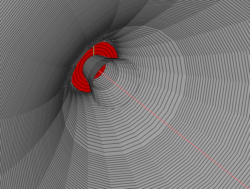

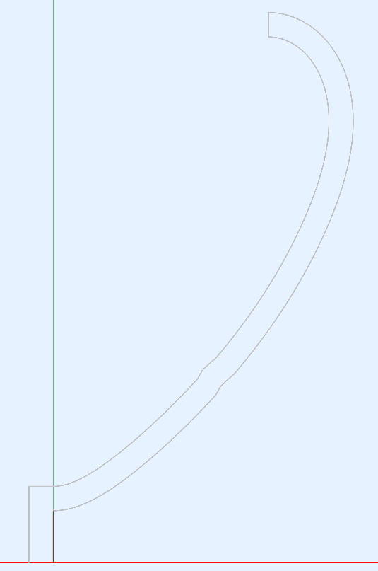

I think that a random coarsness of the sufrace is something very different than axisymmetric grooves. This is what such a groove (0.8 mm deep) placed at 50 mm from the throat does. So you definitely don't want any larger dimples in the surface. But the "coarsness"? I don't know.
To simulate surface deviations from the ideal you would have to randomly shift individual points in a full 3D mesh. To behave more like a real thing it would be a little more complex than that - perhaps interpolated between some sparse definition points, so it's not just a noise. Or smoothed somehow.

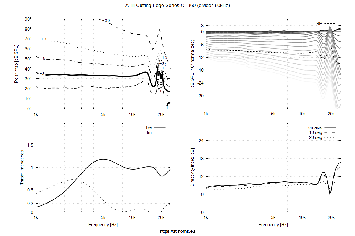

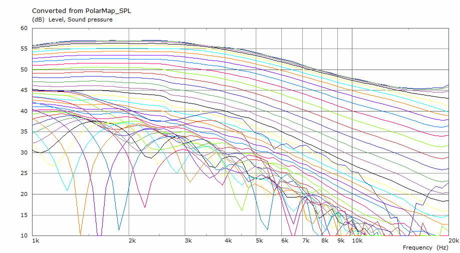

I got myself fooled badly this time - the manually added elements were meshed with too low resolution so that the results were not correct. By default I use so high number of slices on the waveguide itself that the nominal mesh resolution I use (33 kHz) is actually set much lower and obviously is still not enough for reliable data at 20 - 25 kHz..

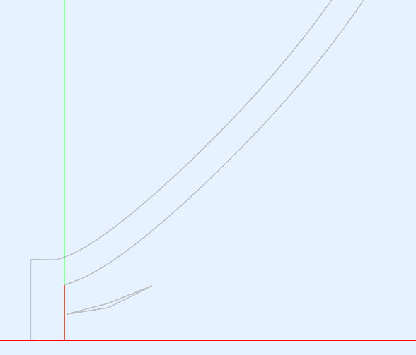

I'm definitely going to give it one more chance, make more rings following the OS coordinate contours precisely, but I'm a little afraid that the acoustic summing at the exit simply won't be good enough to make a real improvement in the end.
I'm not quite sure what's this particular acoustic lens supposed to do (?). Shape a more spherical wavefront? Does it work?
My idea was to not let the diffracted waves from the throat (where the wall curvature is the highest) travel across the whole internal volume, but to direct them towards the mouth. Maybe even not give them a chance to develop in such a narrow space - that was my naive notion.
As far as I understand, this particular acoustic lens is meant to decrease beaming over 10khz.
I THINK using a "phase plug" like that, could allow to use a longer throat extension with a gentler wall curvature. but then again - I'm not sure if that's going to be the case in practice.

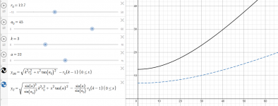

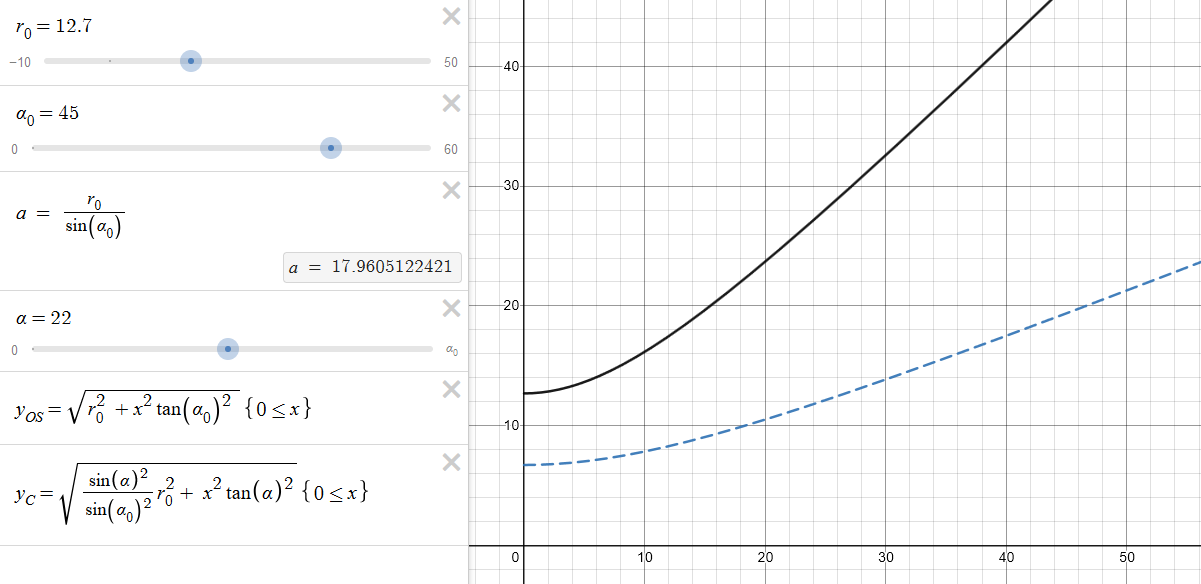

If anyone wondered what are the "inner" OS coordinate contours in cartesian coordinates, this is it (OS coordinates) -
- Acoustic Horn Design – The Easy Way (Ath4)
