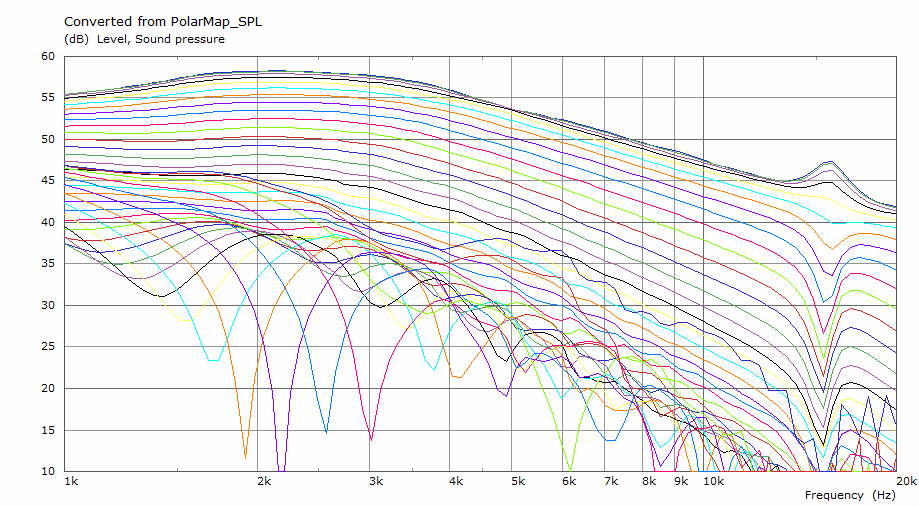

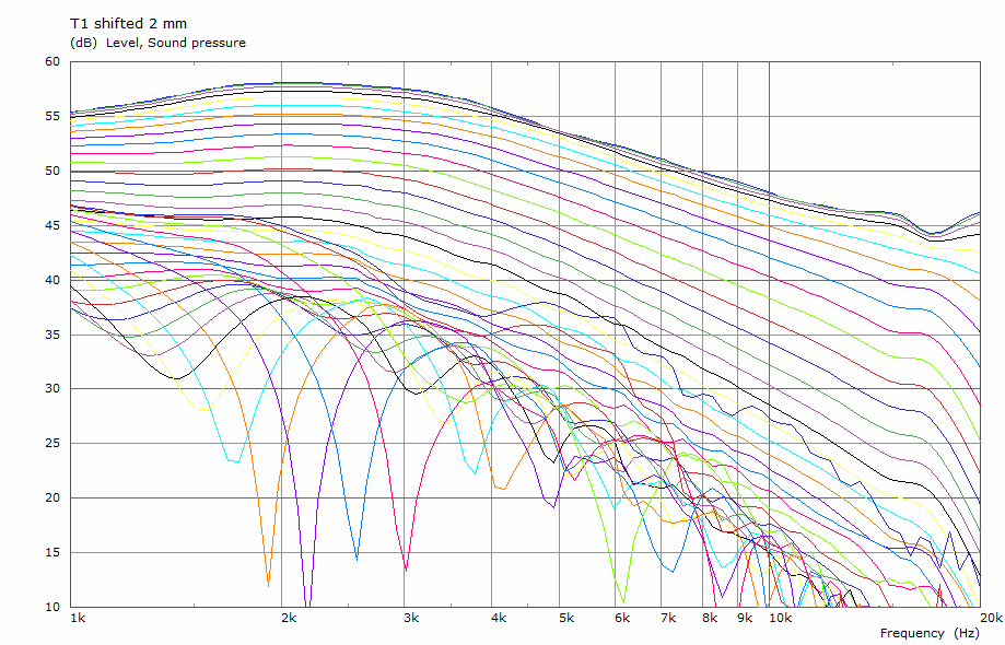

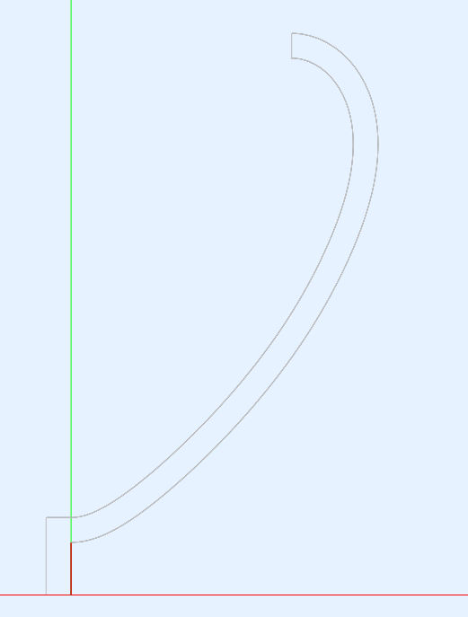

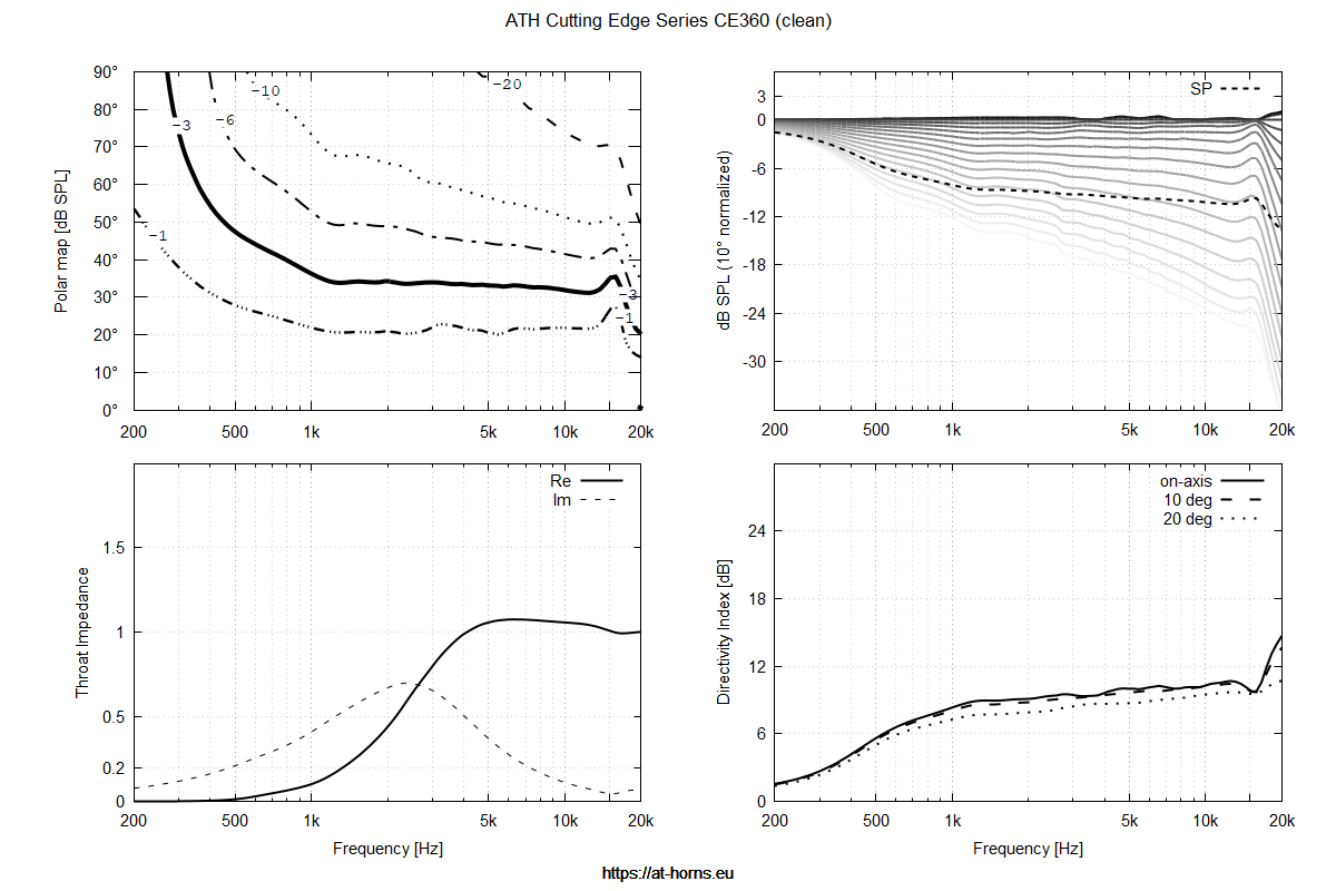

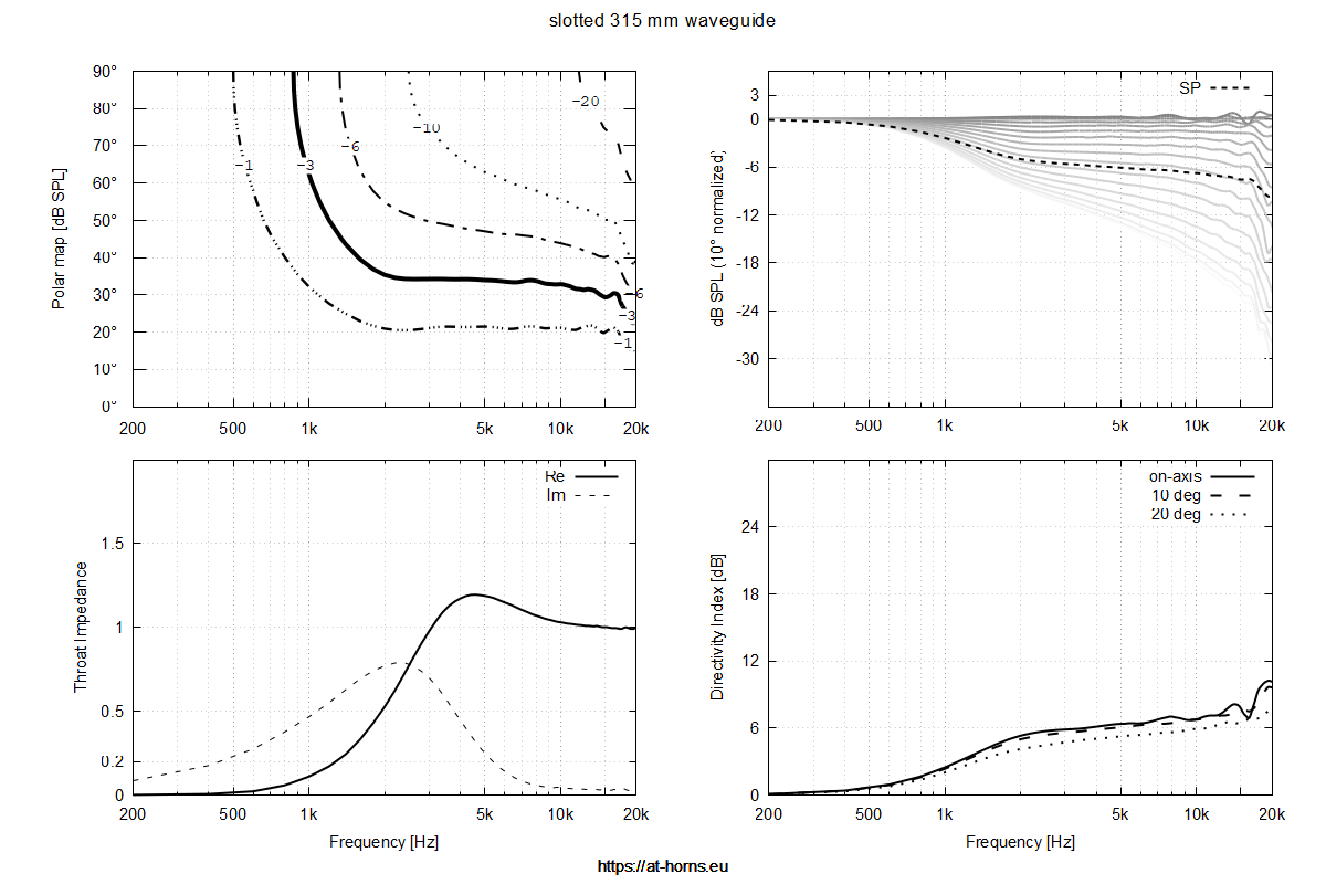

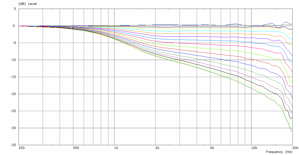

This is with higher throat resolution (3mm) and I will start another run with 2mm later.
Another nice thing with the new version: the limitations I experienced with ath 4.7.1 are gone: I can choose a lower OS.k and also increase length segments again.
Maybe you need to check the 22 and 45 deg behaviour with these slots?

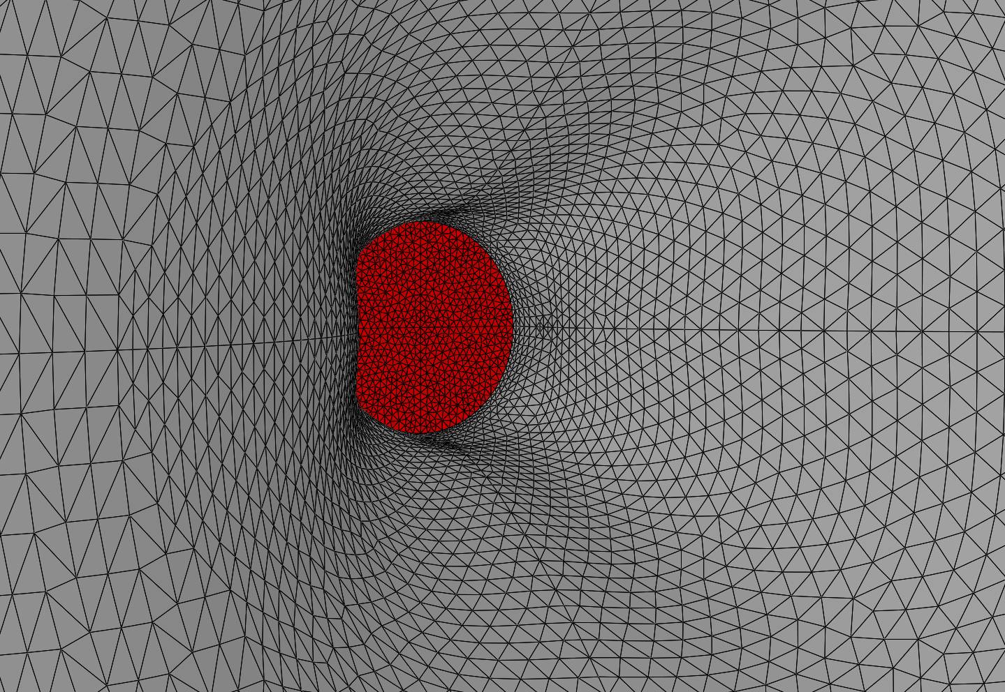

I had some meshing problems (Gmsh warning messages) so I just shifted the slot boundary a little further from the throat, which helped. If you don't have any issues, there's no reason why to keep it there I guess.One question: why do you add a fixed number before you start the cosine fuction? I omitted this completely because I saw no use, but maybe I missed something.

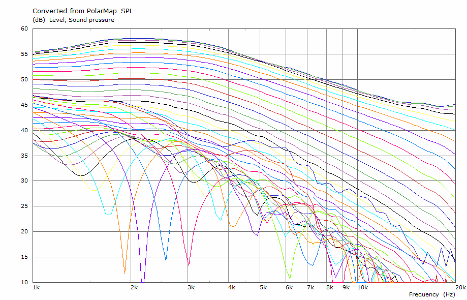

Thank you all for your patience with my small Q&A attack. I am still inexperienced and lack the judgement when it comes to the causes of imperfections in audio, which naturally leads me to become questioning about the results and my usage of the tools at hand. Did not want to beleaguer the thread. My final simulation for reassurance shows that the wiggles get ever lesser with higher (throat) resolution, in this case 1 mm. I will apply what I have learned to the beta 5 and optimize some more for myself. Will be a while until I can print and measure on a real driver, but when I leave my results in the thread, you can approach me for the surface if someone wants to give it a try.
Coping with the ripples in this frequency area is a matter of degrees of freedom with the parameters. I was limited to surpress the on and near axis ripples without tightening the pattern in the HF, so yes, they stayed to have a flatter DI. Will see what ath 5 allows me to do. To me these ripples seemed minor. I also do not know yet if they can be avoided in total.

Did you want a flatter DI and leave in the on and near axis ripples?

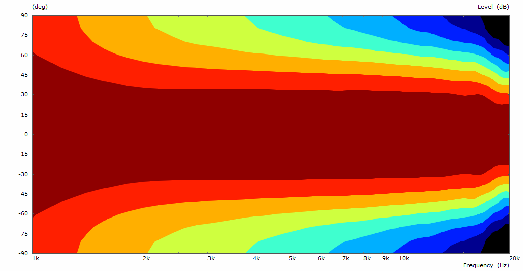

I cannot follow tbqh, what's bugging you?Maybe you need to check the 22 and 45 deg behaviour with these slots?

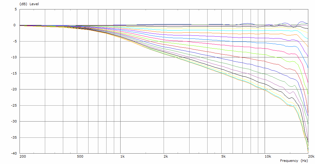

As the horn is not circular it might be a good idea to check the dispersion on other angles then vert & hor!?
I regularly attached diagonal plots, look for spl_d or dia in the headers/file names. This is how the axial differences can be eye-balled.

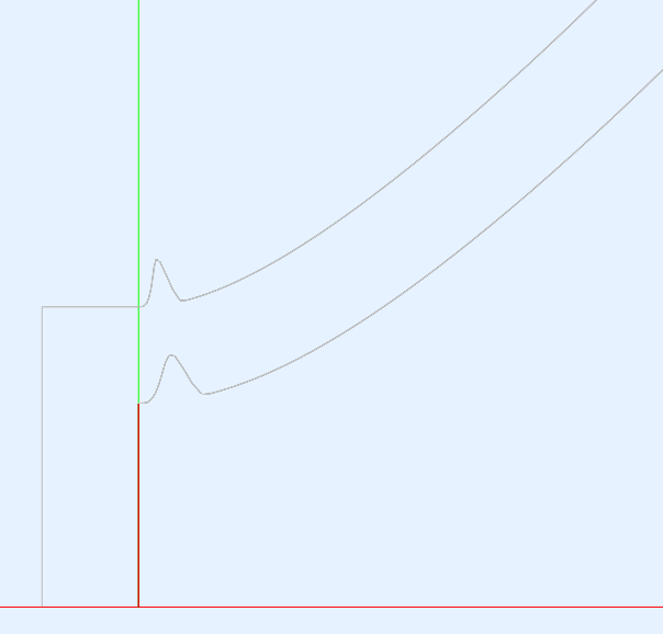

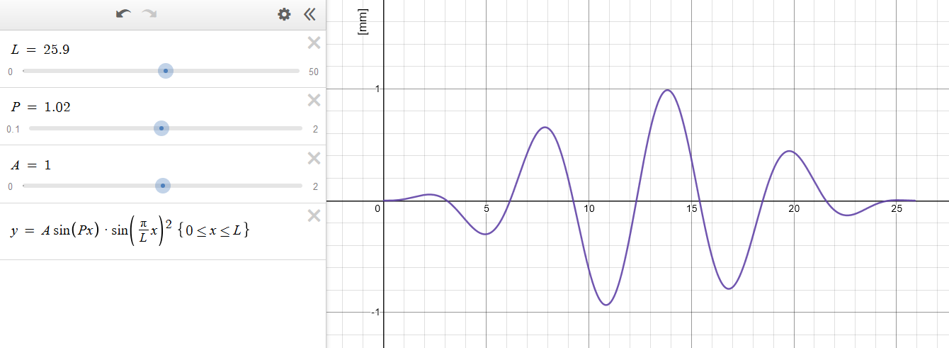

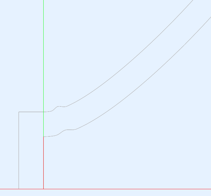

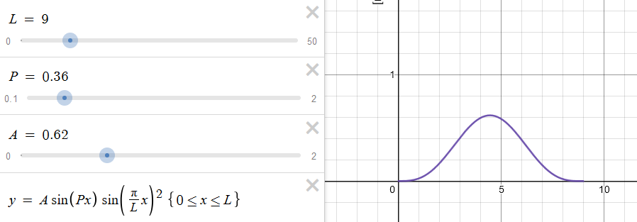

Finally I have a basis function for the Tickler - Geddes Tickler
Any number of those, all with different parameters, will be possible to superimpose on the profile at selected starting positions along its length. Really looking forward how this turns out 🙂
Because I could not counter the tightening of the pattern above 10k if the slots took too much surface area. The pattern got narrow then. Now that I can choose a lower OS.k, I need to see where that gets me, maybe the slots can be used more aggressive without loss of pattern width.

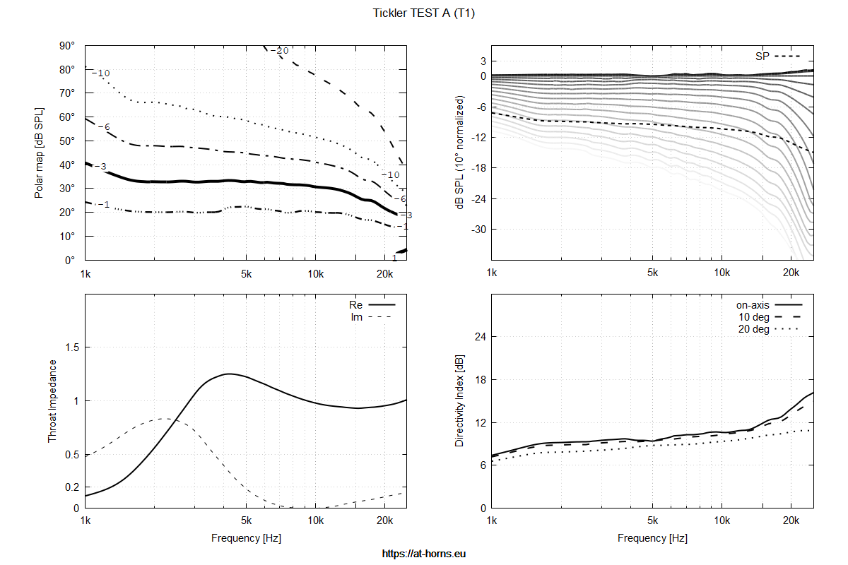

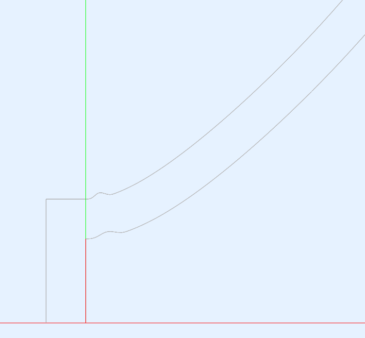

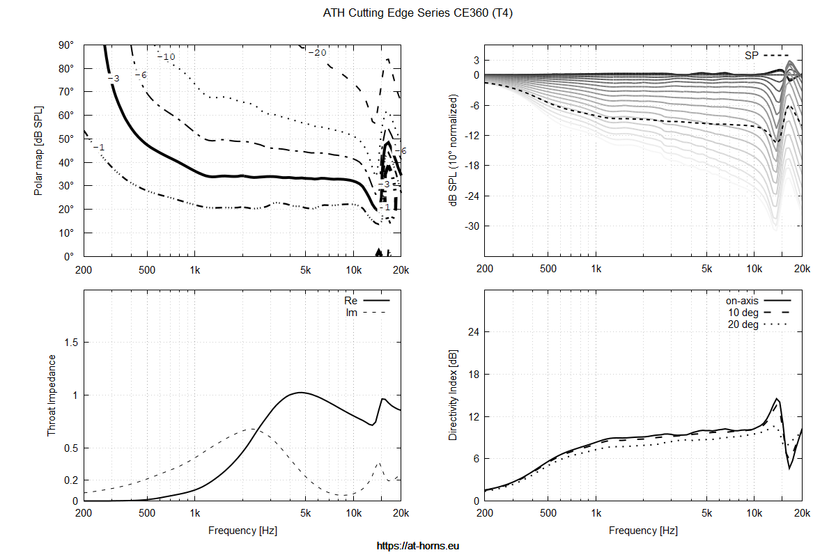

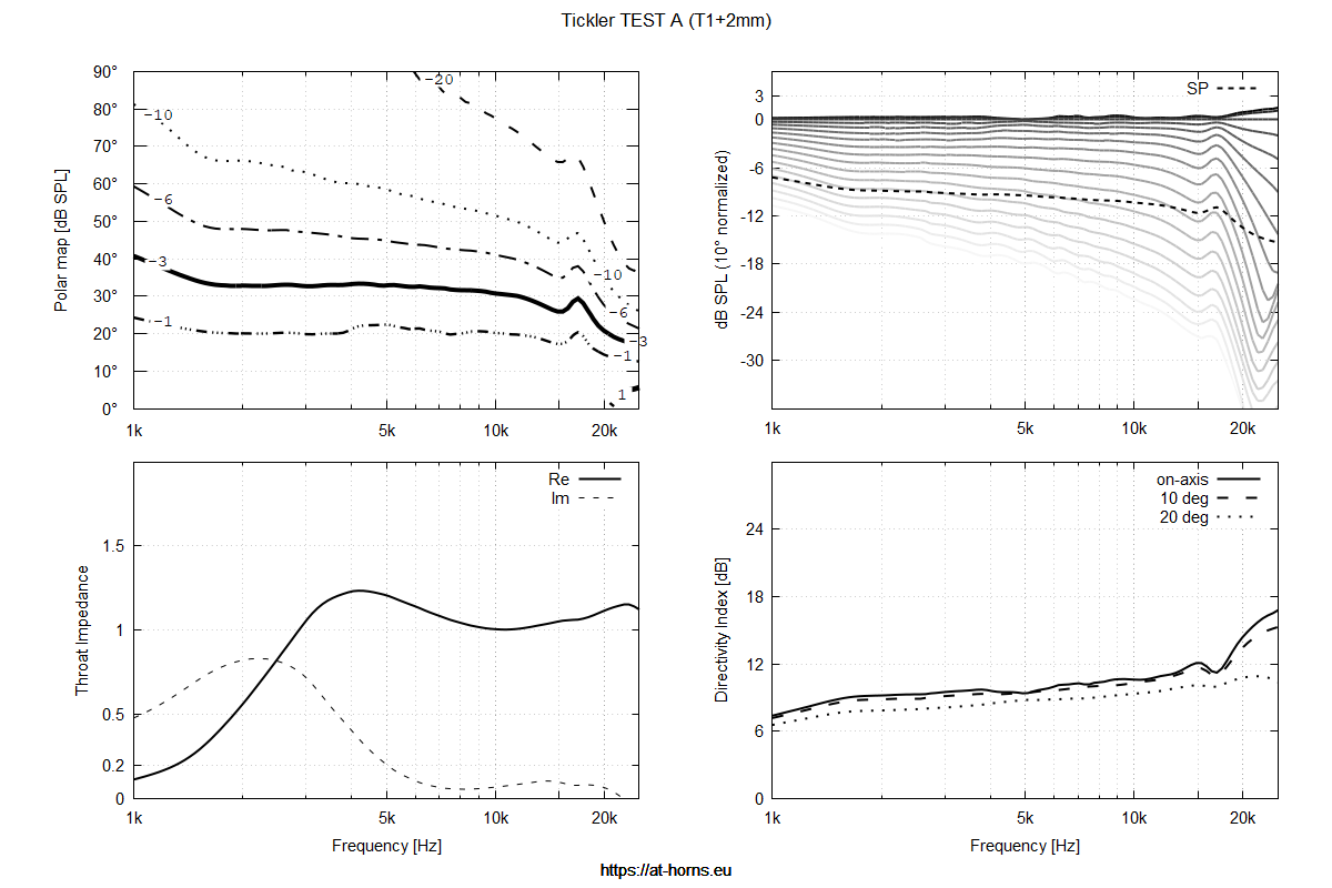

I made some first experiments but it will be extremely tricky as it's very sensitive. I even didn't save all the pictures of the profiles yet. Here are some random results (of which T1 was the very first and it was actually a bug with only a half of the bump - a result I can't reproduce with a "proper" bump anymore).Sure, that's simply a special case. Can be placed individually in different sizes and "polarities".
Next time I will try some systematic approach. It almost seems that with the right sequence of bumps and dips virtually any response could be modeled. Unfortunately I have no clue how to proceed with such a mess. Maybe with some really advanced optimization technique, who knows.

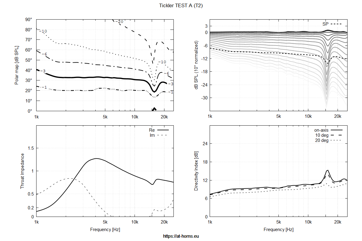

What kind of 'Tickler' function did you use mabat? One or more 'bumps'? The changes in throat impedance are wild, looks hard to control at first sight, but interesting.
Mostly single random bump near the throat, but this was really only a confirmation that it works at all. I yet have to think about how to make something useful from this. Series of simulations, varying one parameter at a time will be needed (position, amplitude, etc.). Perhaps some pattern will emerge.

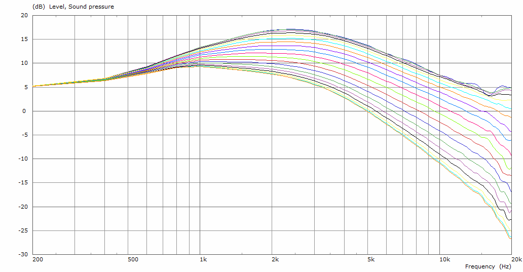

One example, 1" throat (mind the changed frequency axis range) -
(The bump on the outside is just a by-product, that's not intentional 🙂 )
