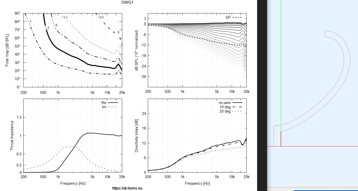

Very interesting stuff. Do I understand the current situation correctly: it is possible to design and sim "a perfect" waveguide with the ATH but since measurements of manufactured "perfect" waveguide is not perfect we have a doubt whether the measurement is "ruined" by the waveguide or the driver? And we could possibly confirm this by testing several drivers with kind of a reference design waveguide?
If this is the right situation now, then the next quest would be to design the reference waveguide to test the drivers against?
What would be the minimum size of a waveguide that would reveal the HOMs of the driver? Might be small enough to fit into a pocket? 🙂 Should be easily modified to any driver exit angle so anyone could 3d print one in few hours? This could potentially enable the community to build some kind of database for good drivers, that would measure in a waveguide as well as the sims?
Seems quite a task, maybe some university thesis project could work it out with handfull of drivers? 🙂

Cool! there is interesting thing about all this, I never saw the opposite polarity phenomenon appear with random ATH flat wavefront simulation results which kind of suggests that the waveguide tends to put the HOM this polarity with flat source (off-axis peaks, on-axis dip) . But the opposite polarity corresponds to the sims done with the duct modes (off-axis dips, on-axis peak). Also in the past few real measurement examples show off-axis dips and on-axis peak, which hints the measurements have likely a bad source wavefront which confirms good waveguide? 🙂
Very unscientific here but it really feeds the curiosity so thought to write it here 😀 And still we'd need to find the good drivers.
Agreed. My comment didn't relate to this - when I said I didn't know how to isolate the waveguide HOMs, I meant how to show or expose them in a similar way that we can do for the throat modes - to clearly see what they are. But maybe it's even not a good question, and all the modes (throat and WG) are coupled so that it makes no sense to try to separate them, I don't know.If it's a waveguide HOM, which it certainly can be if the throat wavefront is not flat (and even if it is to a certain extent,) or the throat angle is not right, then it will appear in each and every driver in exactly the same way. Thus with a database of the reconstructed throat (versus frequency I should add,) then we will know what is what.
- When we drive a waveguide by the 0,1 duct mode (e.g.), how do we know what waveguide HOMs are propagating and shown in the result? This seems to be coupled somehow but in a completely obsured way, at least to me.
Sure, that's the plan (see #7184). Then the next step is to simulate the polars for all the throat modes that are of interest and make a program that can calculate the weights (as a function of frequency) based on a real measurement of any device on this referene waveguide.... the next quest would be to design the reference waveguide to test the drivers against?
Regarding the throat opening angle, as I understand it, for the sake of the above procedure, it should stay the same for any driver tested, i.e. without adjusting the reference WG.
For simplicity, I would agree. But, if ever more detailed analysis of the driver is desired, the more of a complication this becomes. The mismatch diffraction at the junction would always be attributed to the driver since obviously we are assuming the waveguide to be perfect.
PS. I mean "perfect" in the modeling sense since it is mathematical.
But of course, this is not the only (or even the most important) criterion for choosing a driver, so it may end up as fairly academic effort anyway.
I suspect, as stated before, by you, that for a 1" driver it is not going to be significant, hence my preference for using as small a driver as one can use for the specs. But for 2" drivers, it may be the difference between useful and not, especially as regards its high end.
After all, it's no problem to generate several reference waveguides along with their simulated results for each throat mode, for more throat angles. Even if for one degree increment, this wouldn't take long to prepare.
This can be a distributed effort, so no one would need all of them at once. I can imagine people contributing with just one or two measured drivers. I intend to design the waveguides small enough to be printable even on the most basic hobby 3D printer (7" - 8" max).
