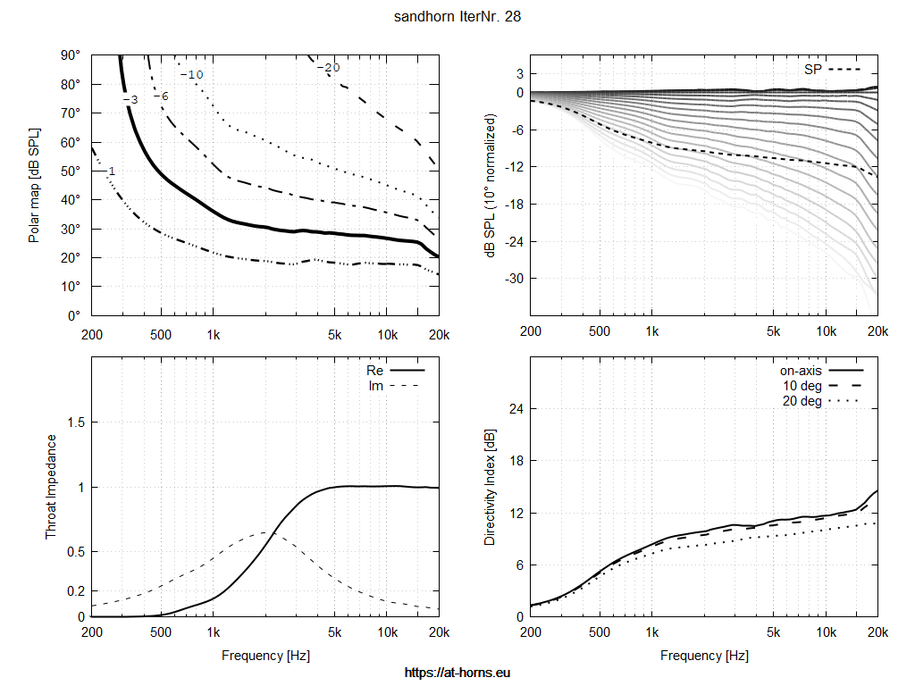

I'm being asked whether the ST260 could be scaled for a 1.4" throat. Sure, then it's around ⌀360 x 118 mm -
The waveguide can be scaled to whatever throat diameter needed. All the response plots simply shift lower (for an increased size) or higher in frequency in the same ratio.
It's not the best that can be done but it will work.

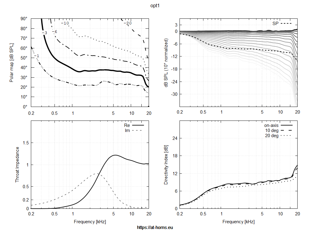

Finallly, I have an automatic optimization framework ready (Ath+ABEC+AutoIt) - with an axisymmetric device I'm able to get to 20 seconds per iteration.
Sample of 100 results: ATH - Advanced Transition Horns - Gallery
(any of them available on request 🙂)
This is what happens if you let k to vary in the interval 0.7 - 6: ATH - Advanced Transition Horns - GalleryWhy dont we have more K=10 WGs? 🙂
(In the previous examples k=1 was fixed, i.e. all pure OS throats).
