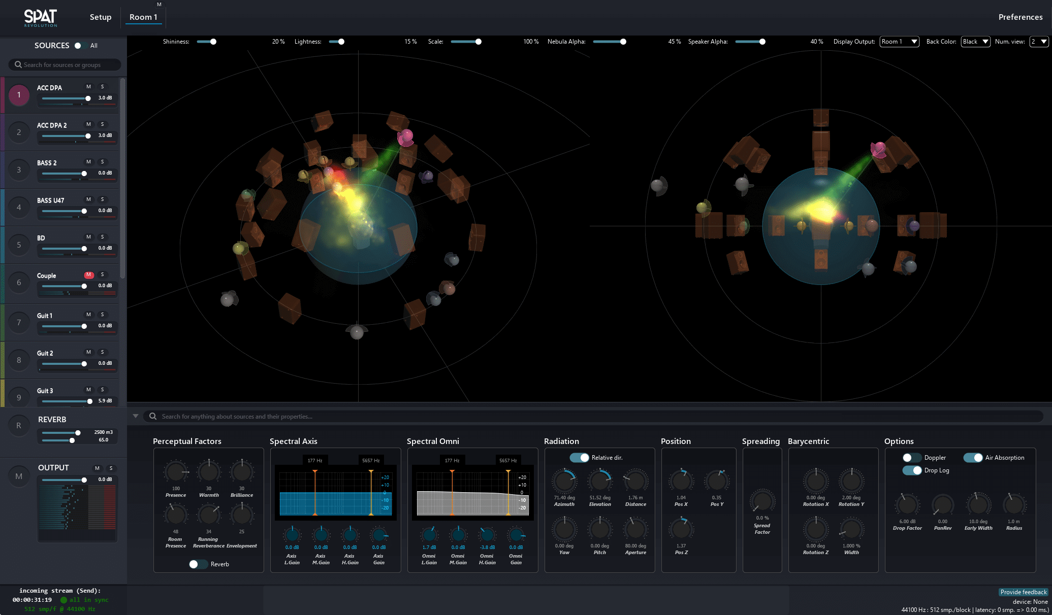

This is an example of what's called "immersive audio technologies". Auro also supplies plugins for Pro-Tools a.o.
I've some experience with Spat (last image).
So much for being OT.

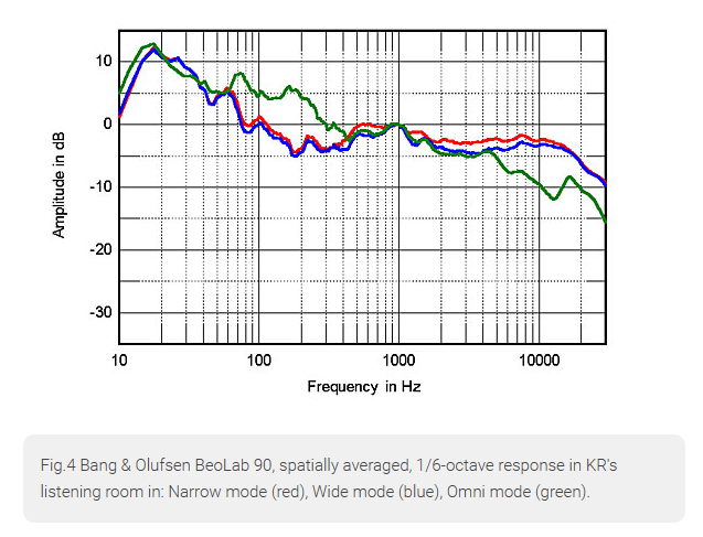

Here's some information on the Beolab 90:

Thanks. This graph is probably the closest to what I'd like to know -
Hmm. None of the curves is something I would especially strive for. The omni setting seems just crazy. Doesn't this loudspeaker sound best in the narrow mode anyway? 🙂
