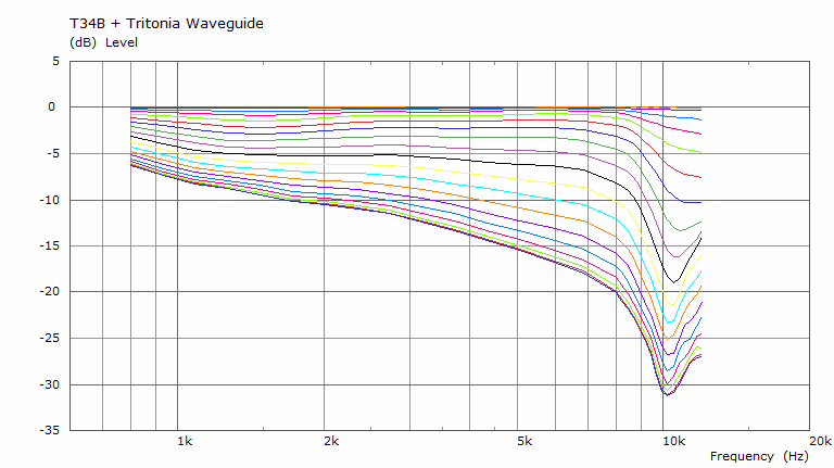

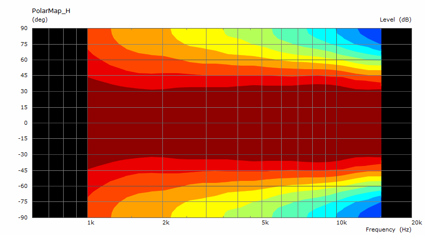

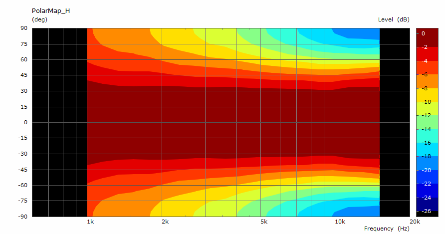

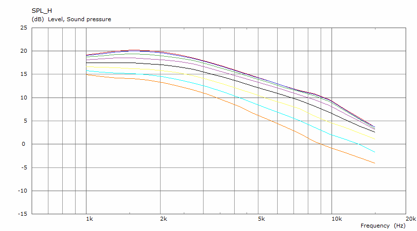

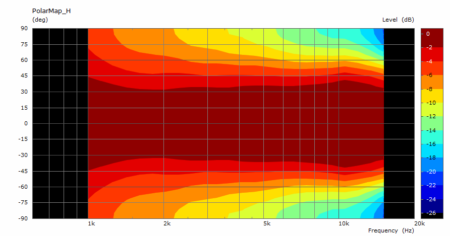

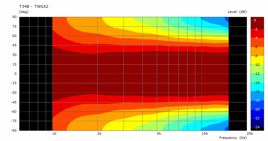

Back to the dome tweeter (T34-B) waveguide - I made the following one a little smaller (now it is 346 x 302 mm; the previous one was 450 x 390 mm).
The beamwidth actually widens with frequency a bit (although it is pretty constant for -6 dB). Makes me wonder if a slightly more beaming (and more loading) profile could/should be used in this case. I'll definitely give it a try.
(Again this is for an infinite baffle.)
attachment.php

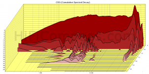

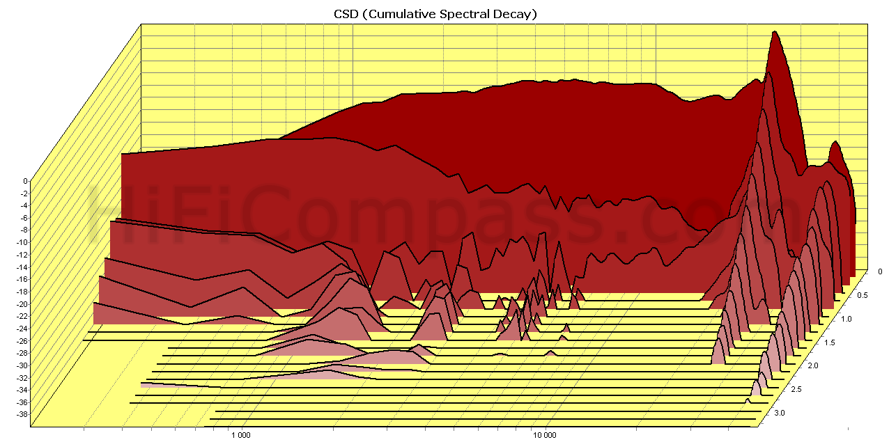

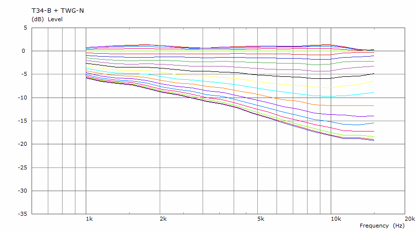

😕storage energy is not where they perform best. Why not the peerless DX25 or DX32 instead ?!
I know you have trouble getting the model numbers of speakers correct but I think you are talking about the DA25 or DA32 as they use Corundum as the dome material.
Here is a comparison of the T34B and the DA25 from Hificompass as the graphs can be directly compared. I don't see a real issue with energy storage with either. DA25 left T34B right.
DA25 gets worse below 3K.

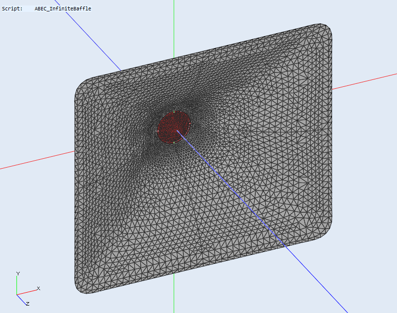

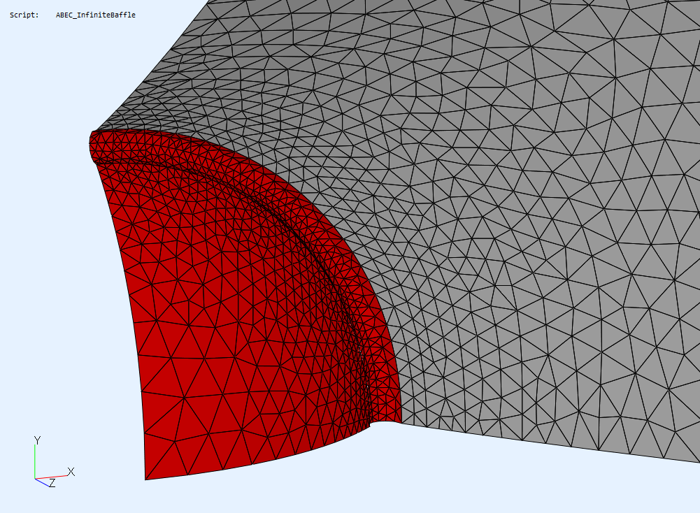

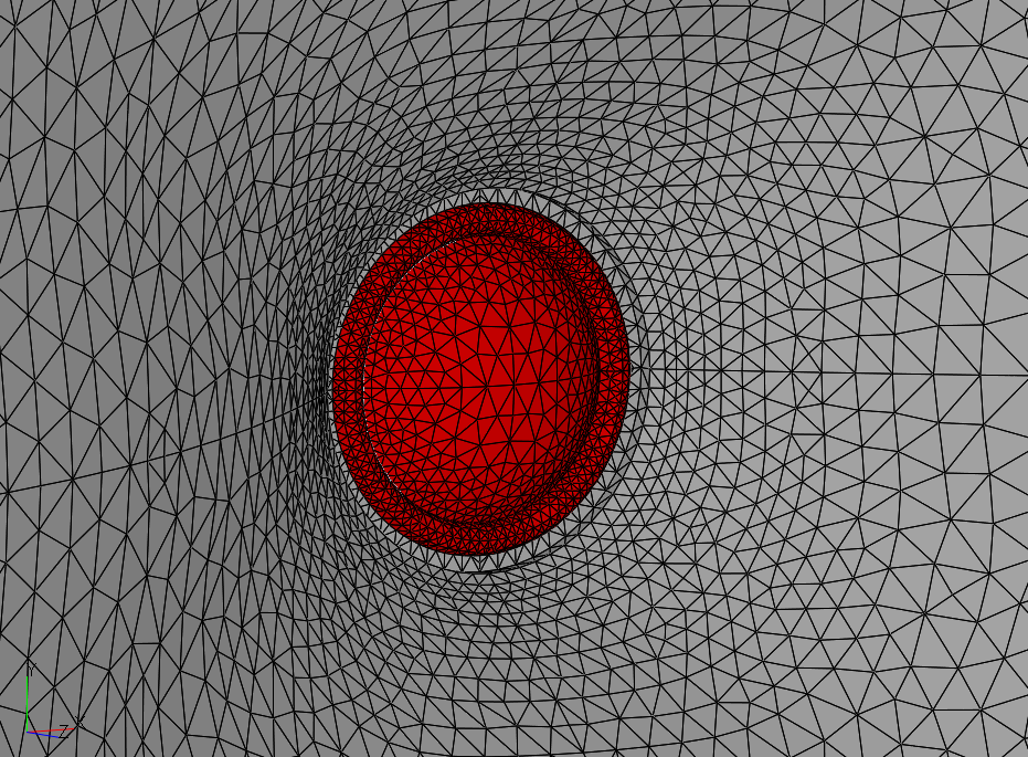

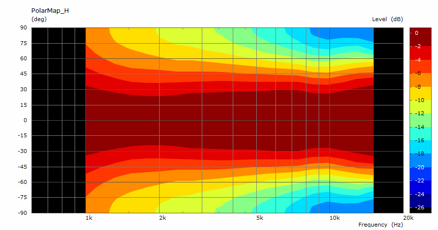

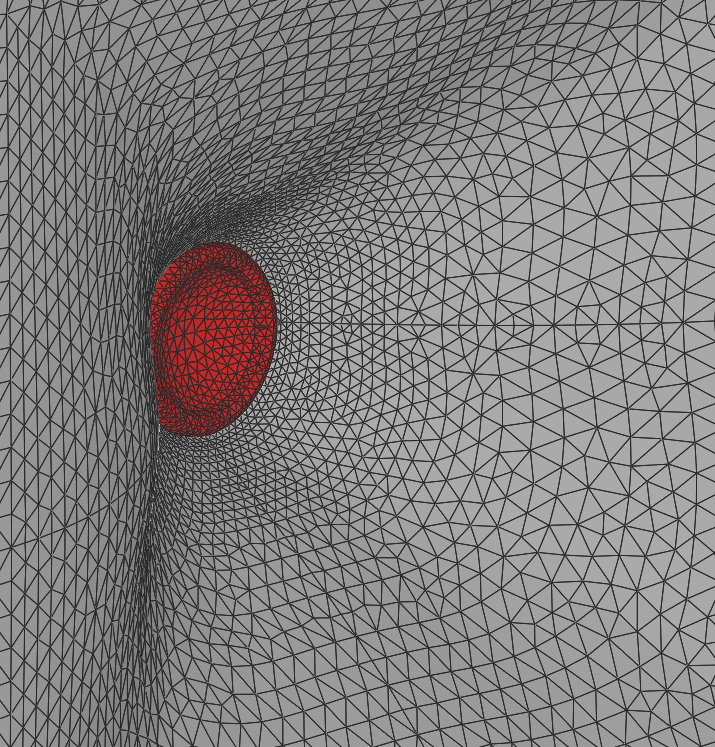

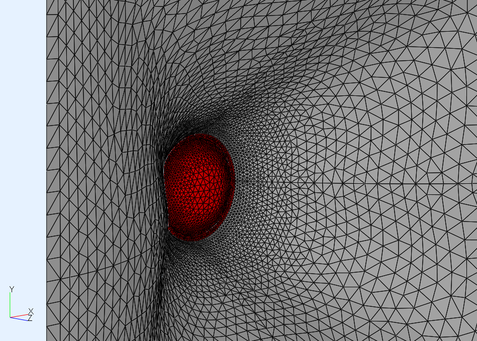

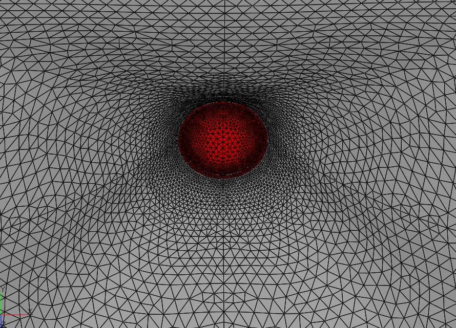

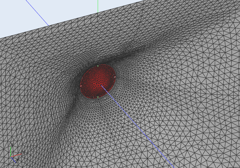

Would you care to show the mesh of the tweeter-horn interface?

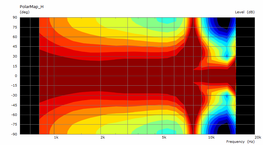

You could change back to an OS profile, with an opening angle 5-10degrees less than the conical angle
That's quite insightful!
I don't know exactly why, but with OS it gets worse around 10 kHz, even for a mild presence of it. This is for an opening angle 5 deg less than the conical angle (and it gets worse with increasing this difference). Maybe there's another way. BTW, non-axisymmetric shapes are far less sensitive to the "surround problem", it seems.
Anyway, I think this is a pretty good starting point.

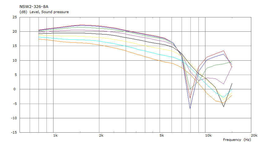

2" Aurasound NSW2-326-8AT, the drivers S. Linkwitz used in his Plutos, in the same waveguide (modified for a different throat diameter, of course).
It would make a nice contest - to improve this 🙂

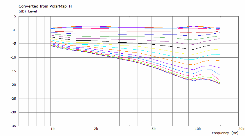

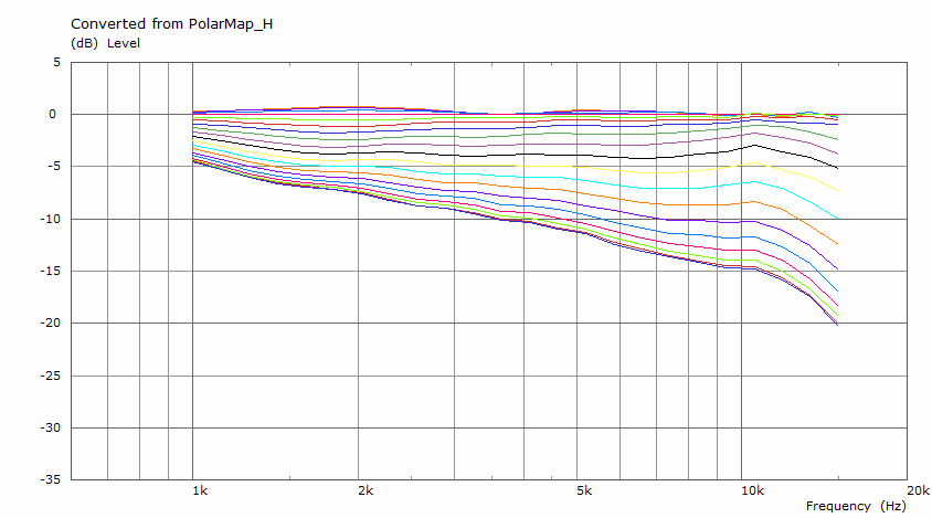

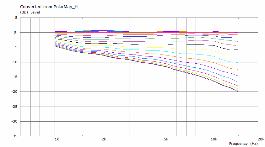

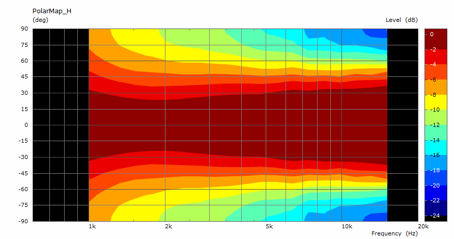

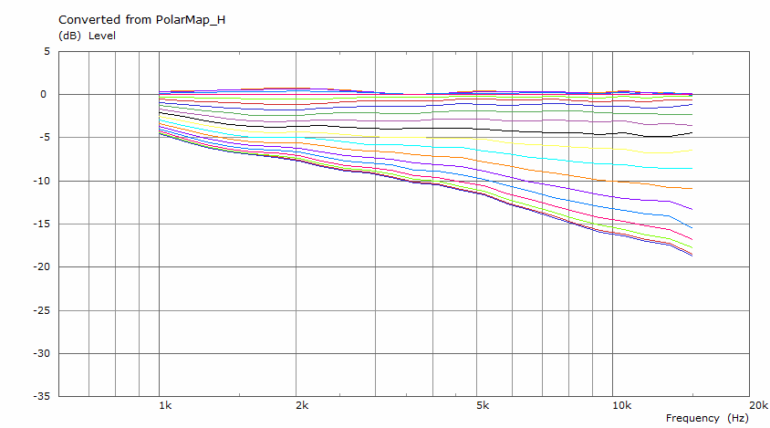

how do you get "Converted from PolarMap_H" graph.
And, is it possible to export data from Vacs and import to Vituix? If it is, how to do it?
You click/select the polar graph you want to convert in VACS and then choose
Graph - convert curves <-> contour from the menu that will generate another graph. To get those curves out to Vituix select all the individual curves at the bottom of the graph. Select the first one then press and hold shift and click on the last one, they will go darker when selected. Then go to export the data from the menu, should default to Amplitude and phase and choose a file name.
Each curve will be exported separately in a numerical sequence.
To get them into Vituix they need to be renamed to the Arta style or something similar. I made a script to rename them to a format that will work using advanced renamer.
The script was attached in this post if it helps.
