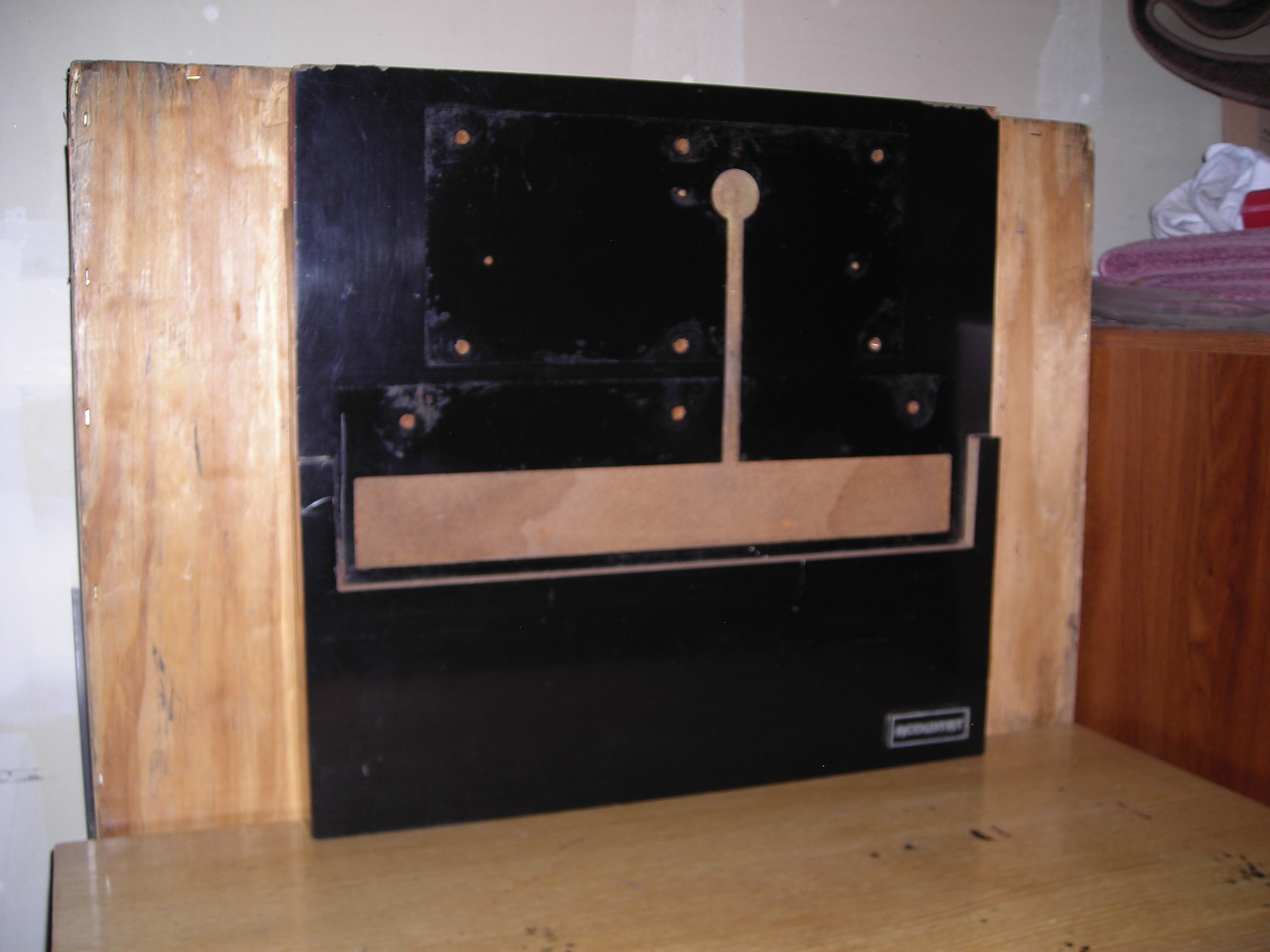

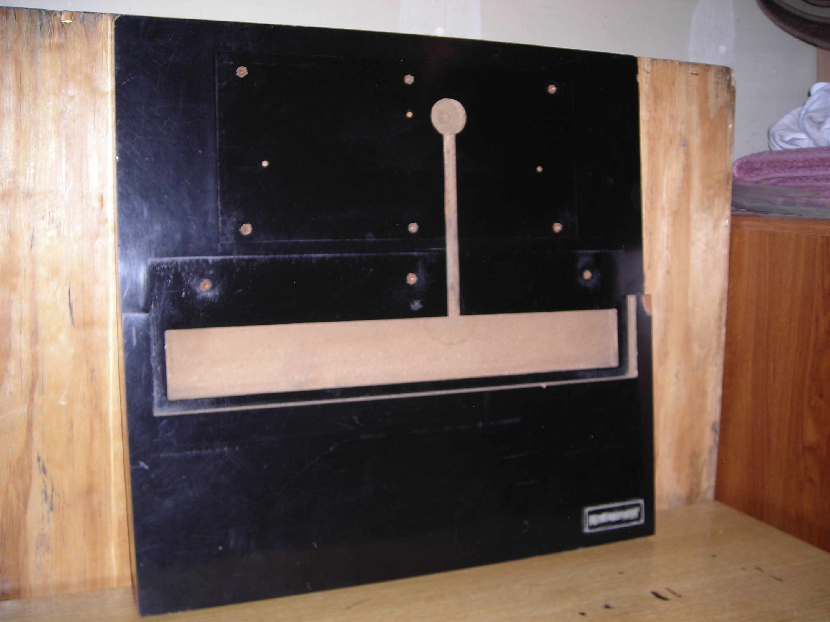

FREE Acoustat 2+2 bases
Hey guys! I have a pair of gloss black bases for the original Acoustat 2+2's. These are in horrible cosmetic condition. Many scratches, chips, small missing pieces of trim and they got water damaged.
However, they are fully 100% functional. I used them for 6-7 months while I was doing all the work of my 2+2's. They could be used as templates for new ones.
And...they are FREE! Just cover the shipping and they're yours.
They were two types of bases & frams on the 2+2s....the ones here are the first ones..i have had both ..if you look at the base... here in the pic, you well see the top wood panels an peaces of wood frame not in the pic.... set in a rounded out...I well call it a slot...look at what the 4 panels an the wood frame set on....what may be a 1/4" a around the outside of the slot ...even thought there a thin peace of medal than gos across the bottem of the wood panel frame.....all the wate of the upper frame an panels set over the holo slot....the panel wire come out the bottem on this type 2+2...
The fix I have done to get better sound....is to put wood to fill in the slot up level with the 1/4" cut ...so it fell in the slot more ....leve only a 2" full slot in the middle for the wires..thats all that's needed...this give a better base for the wood frame an the 4 panels to set on....also I did Not put the metal peace back on the bottem of the upper frame...I put wood screws in the wood...to my ears ...the sound is much titer... better image,tone an bass output....an sound more like the newer 2+2 type...
Newer type 2+2 with the small MK121 interfaces... the wires come out the back..theres no slot under the panels an wood frame..an theres a 1"X 8"peaces of wood that gos across the bottem back behind the panels....this is were the top upper frame mounts to the interfeaces....an base...these 2+2s sound diff than the older ones... better bass...maybe because the wood behind the panels at the bottem..that's not there on the first all open type frames..makes a type box the panels play aganist ...an the solid base that the upper panels an frame set on...a all over heaver wood frame also..
All just one mans Quest for the best sound out of one of the best ESL speakers ever made...
