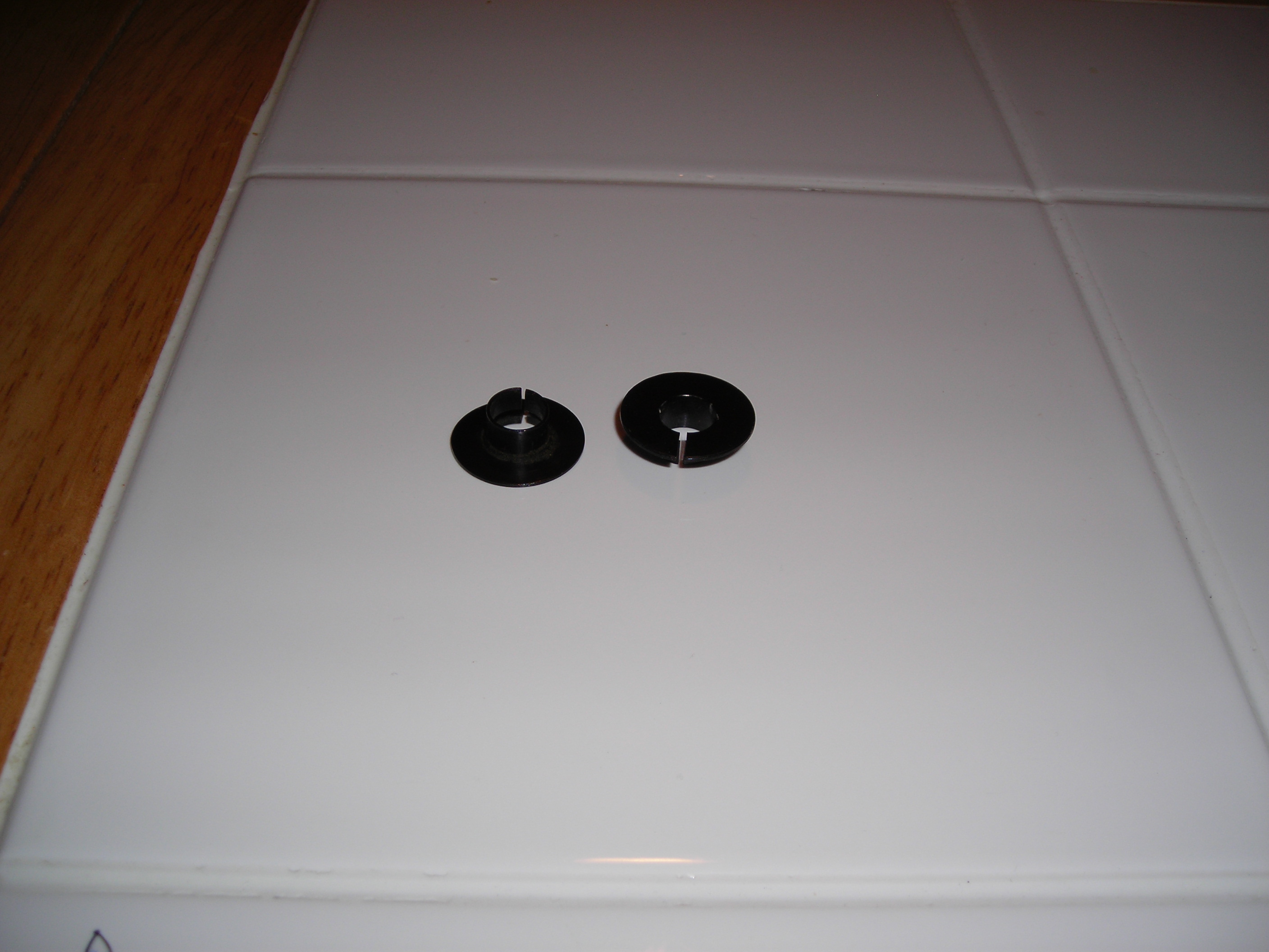

Help with identifying and finding these...
Need your help guys. These are the little fabric protectors that go over the fabric into the screw holes on the side of my Acoustat 2+2 to hold the braces on. I'm sure they are for the grill cloth protection and also for looks.
I only have (4) of these. One speaker didn't have any at all and the other speaker had all (4).
I've tried Googling a bunch of different names to call these, buy couldn't find any.
Does anyone know what they are called and more importantly, where to get them?
Thanks!
Thanks!
Thanks!

Damn. I was hoping you knew. I knew that you came to Acoustat later, but was hoping you would still know. They are metal and pretty strong. One got bent and it was a struggle to straighten it.
I Googled your suggestion, but still not quite right. I will continue my search.

Andy, you sir are a genius. I think this is it?
Thermalloy/Aavid - 2226B - Heatsink. For TO-5, TO-39 components.
All the dimensions that are listed are the same as the one I have, but they don't list an OD for the smaller barrel. Kinda pricey for just using them as a fabric protector.

I'm 99.19% sure that these are indeed what I am looking for. I found (4) on E-Bay for $6.00 shipped, so I bought them. Once they are here, I will see for sure. I already used the other (4) on one speaker and they are just the ticket. They work really well.
Makes me chuckle to think that Jim (Strickland) re-purposed these for this situation. Sounds just like him. I was an Acoustat dealer from almost the beginning to almost the end. I became very good friends with Jim and Dave, (Hafler). I opened my first high-end store when I was just 22. Without the help and guidance of those two, I wouldn't have made it.
