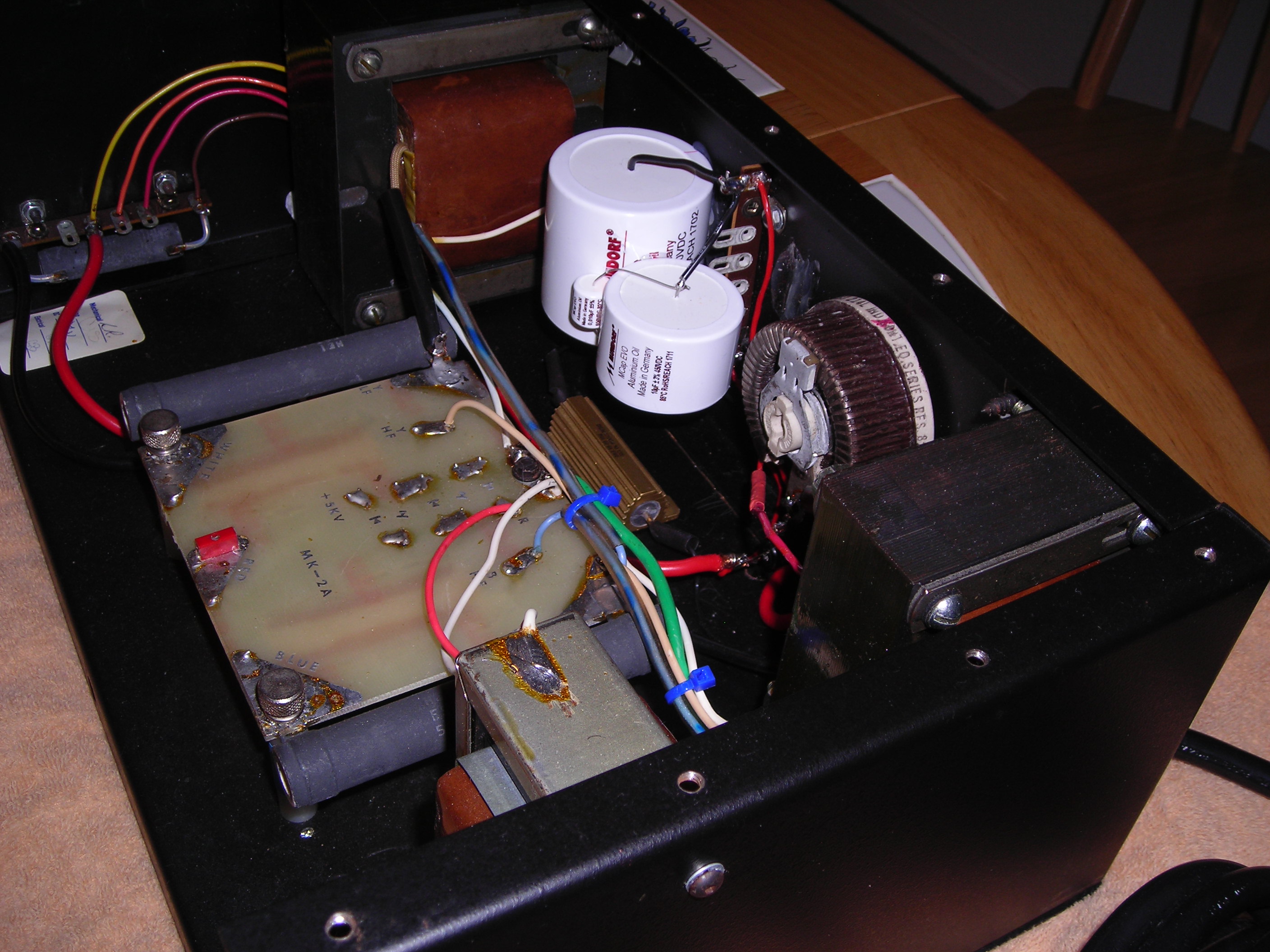

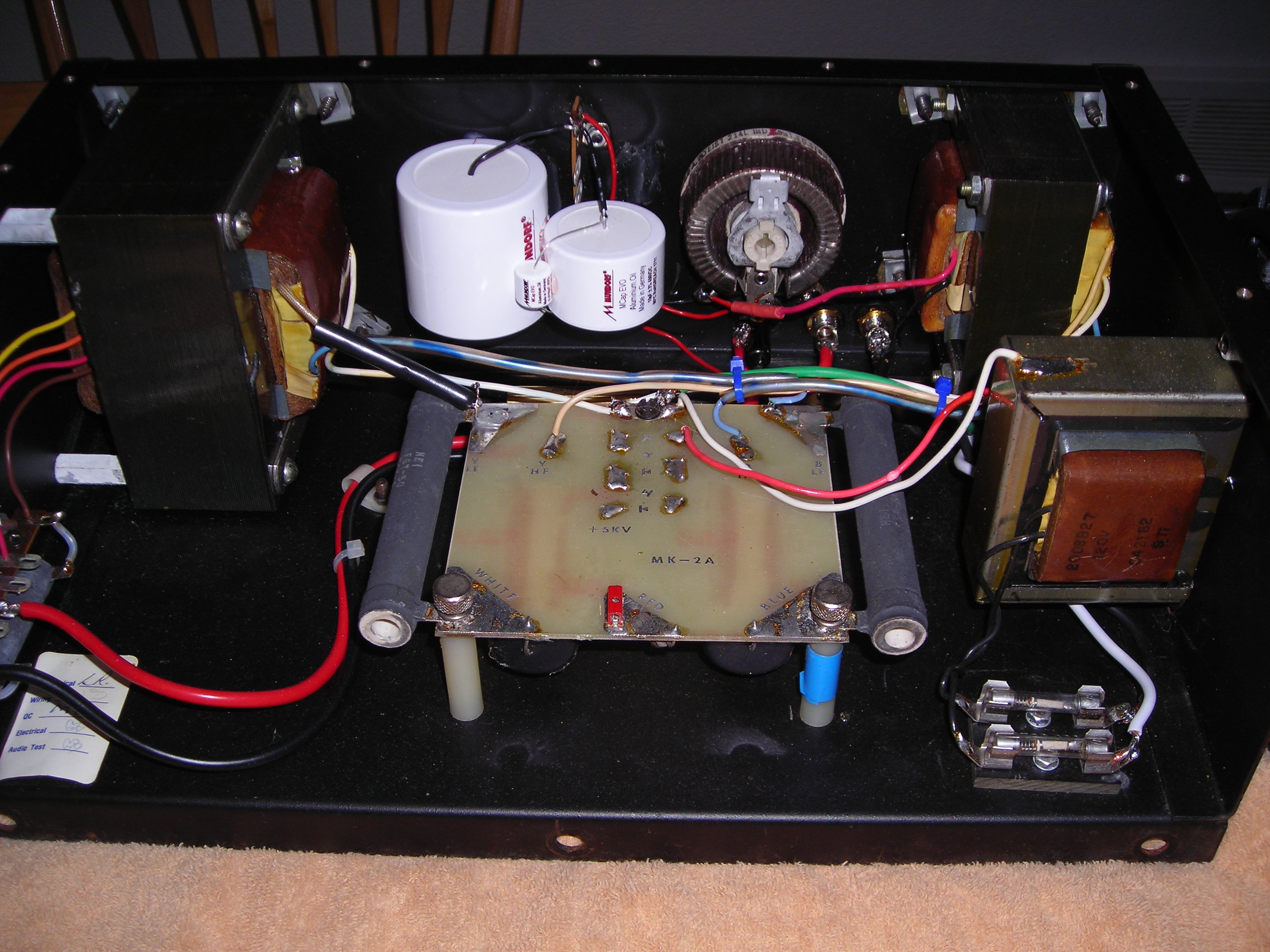

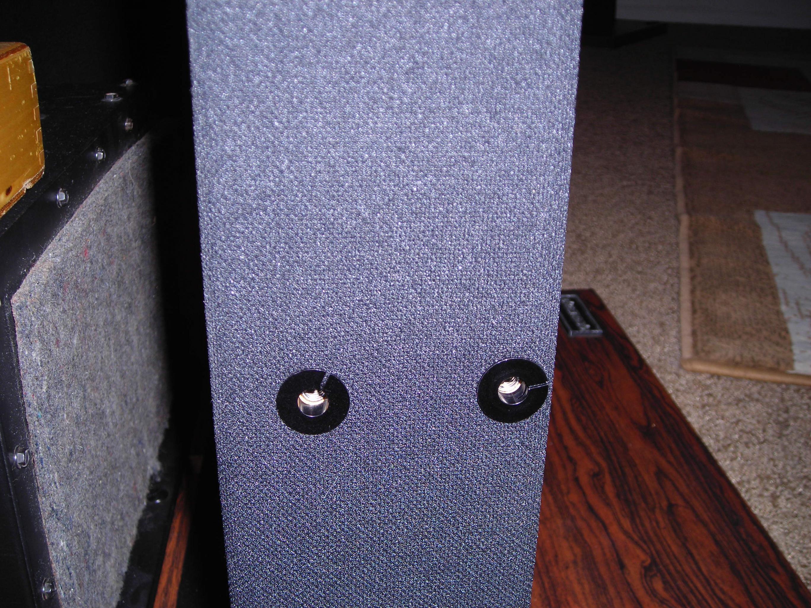

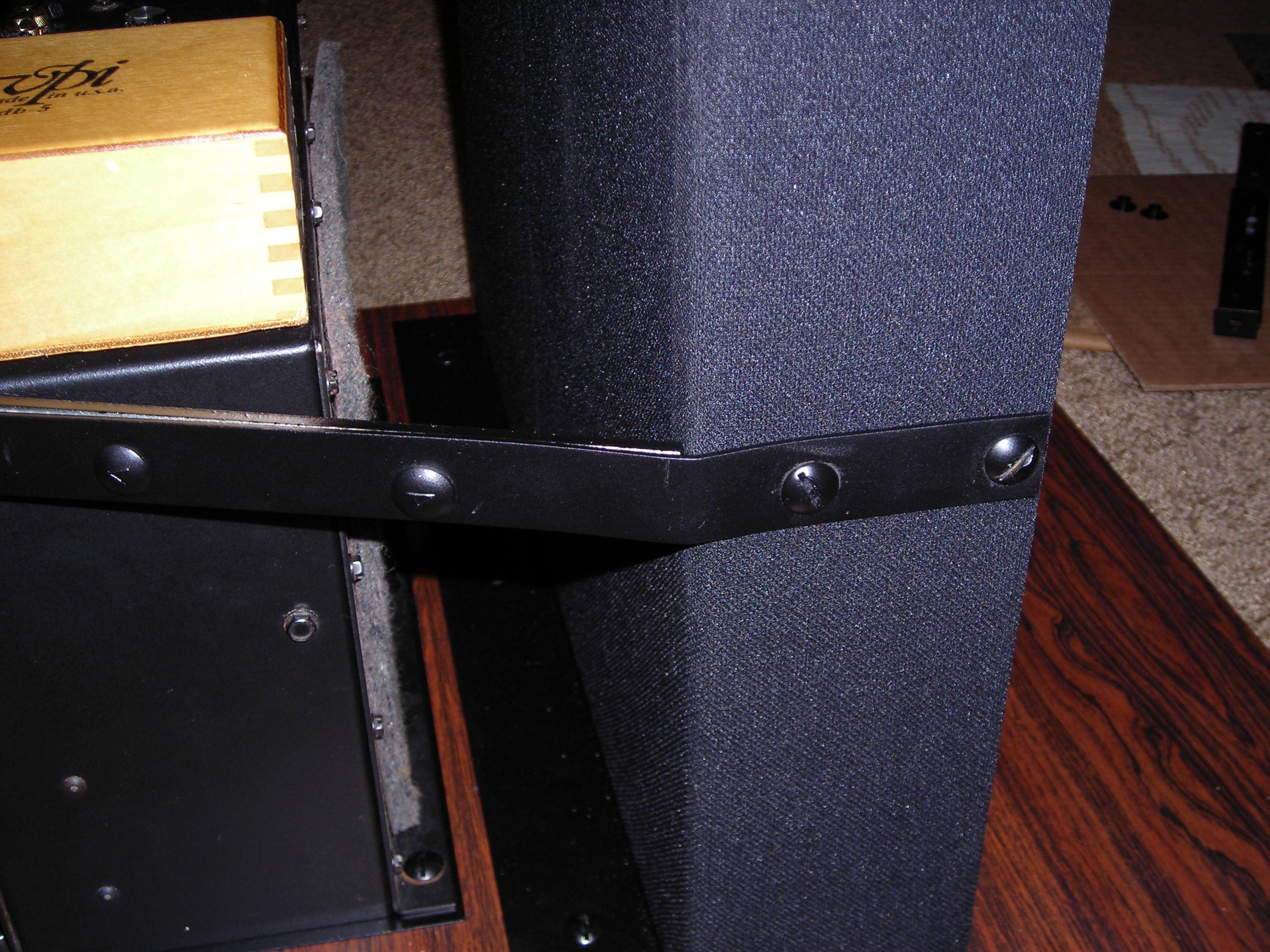

Acoustat 2+2 "C" mod info & impressions
Sorry this has taken so long. I had to have the help of several people and was at the mercy of their schedules. I not only did the "C" modification to my 2+2's, but also reinforced the frames, tightened up all the panels, vacuumed the panels several times, painted all the black metal parts and replaced the fabric. So, more or less, a complete restoration. They turned out AWESOME! Look like I just took them out of the box.
Now on to the "C" mod:

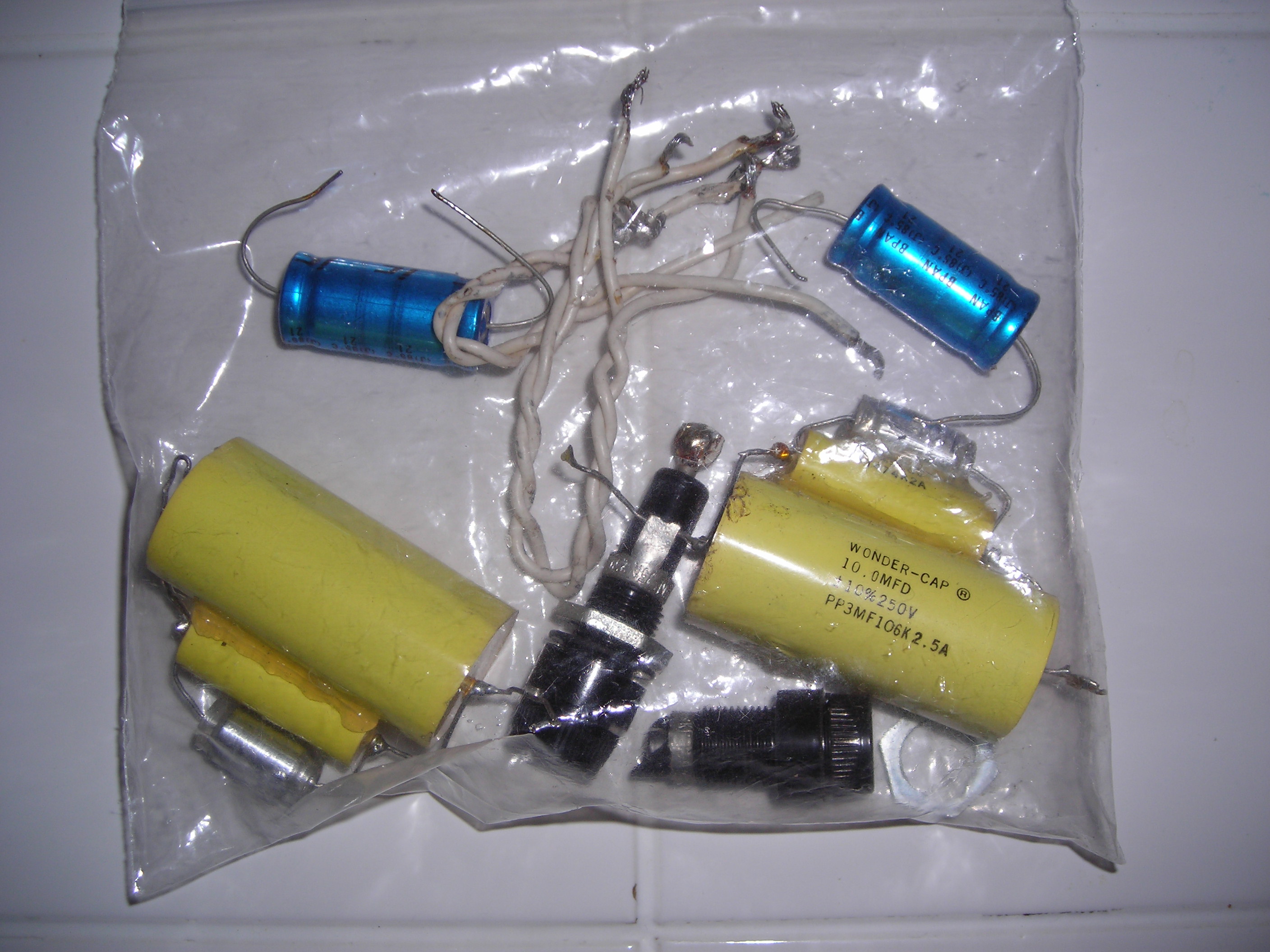

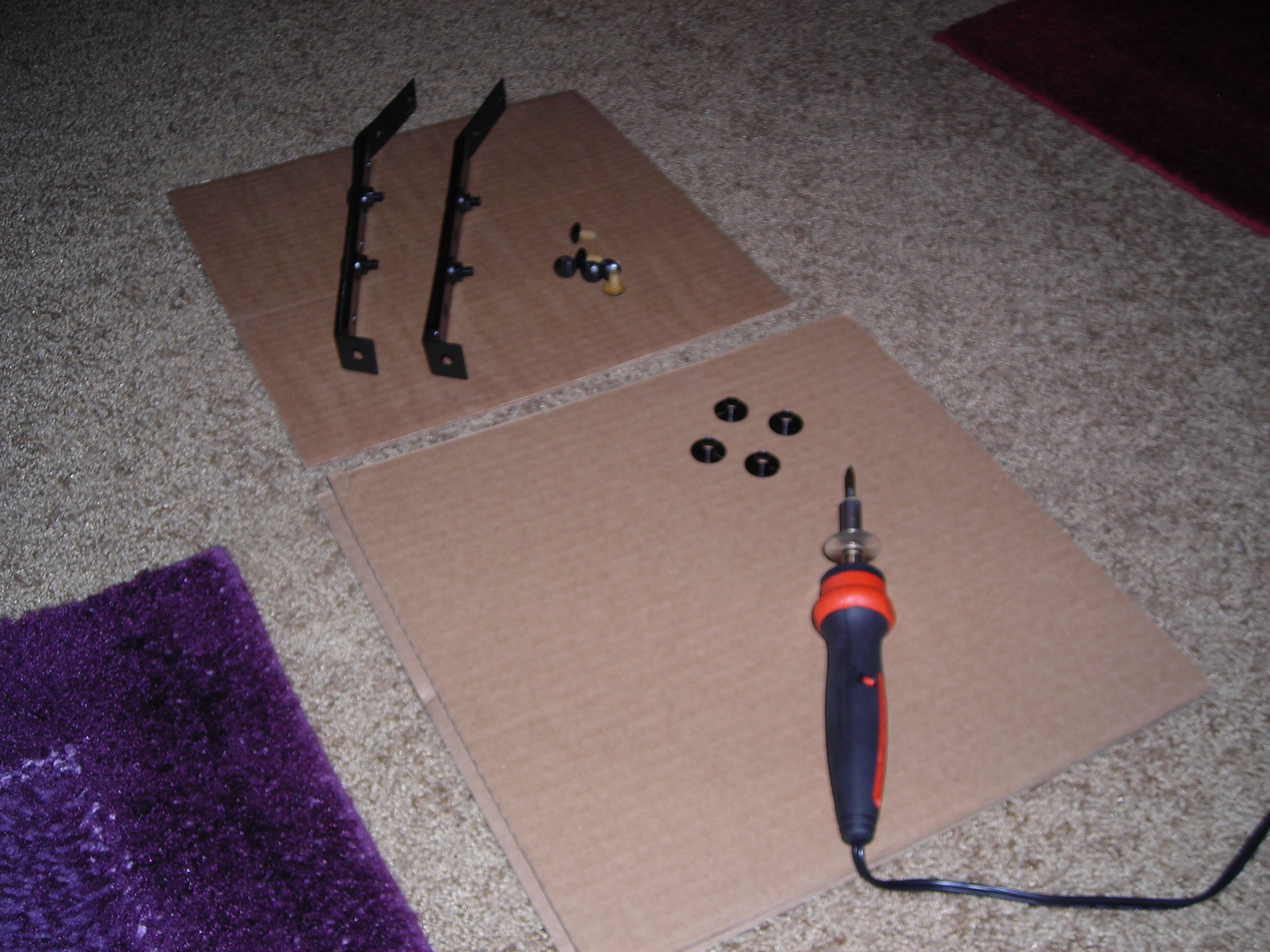

I used the following parts for my "C" mod:
Vishay/Dale 10 Ohm/50 Watt aluminum housed resistors
Mundorf EVO Alum+Oil Caps (all 3 values .01, 10, 47)
Kimber TCSS Chassis Wire (you only need 4 short pieces)
Cardas Binding Posts with 12 Gauge Vampire wire to the board
Monoprice 14 Gauge shielded AC Power Cables (12 ft)
Radio Shack Deluxe Fuse Holders (for the "audio fuse")
Cardas Silver Solder (while inside, I touced up all of the solder joints)
I'm pretty decent with a soldering iron, (certainly not in the same league as Andy or most of you guys, but not too bad). This was a pretty easy and straightforward mod. I just followed the picture and really didn't even read the steps. The picture was easier for me to follow and I checked my work like 100 times.
I let the speakers charge for 3 hours before I turned my system on. My initial listening session was several hours, taking notes along the way. Then I put on a Tune-In radio station 24/7 for 9 straight days. I put over 200 hours of burn-in on the Mundorf caps before I started my serious listening. I did periodically step in and listen throughout this period, hearing improvements each time.
I've done enough cap mods/upgrades to various preamps and phono stages, that I have a pretty good take on burn-in/forming of higher end caps. I'm still not convinced that the caps are fully broken-in yet, but they are close. Just a smidgen of a hardness and edge, but way better then before.
Within the initial 30 seconds of "Delta" by CS&N, the first word that popped into my head was "blossom". The high frequencies just blossomed. I thought they sounded very good before, but holy moly, I was missing a lot.
More air, presence, openness and everthing just smoothed out. It has an even wider soundstage and it was vast before, but now! There is more "there", there.
One of the surprises for me was the bass response. The bass is now much tighter and seems faster to me than before. I'm sure the frame work and tightening of all the panel bolts that I did, helped a lot, but this was even more than I was expecting.
IMHO, I now have a pair of Acoustat 2+2's that have been brought into the 21st Century. These turned out so well that I just sold my Magnepan MG3.6s, (although I'm keeping my Martin Logan CLSIIA in Rosewood) and don't intend to ever look back.
The "C" Mod is HIGHLY RECOMMENDED!!!

mraudioguru - Glad you like the C-Mod for the MK-121 Series interface. The circuit change was actually suggested by David Hafler, who owned Acoustat at the time. David knew a thing or two about transformers and the circuits driving them. I remember well the lunch with David and Jim Strickland where David sketched his idea on a napkin.
It appears in your photos that some wires may be resting on the large 50K resistors soldered to the board. These resistors can get hot under hard driving conditions, so take care to keep wires from touching these potential hot-spots.
Andy, thanks for the advice! I pulled the interfaces off and the wires really aren't touching the 50K resistors, but I moved them anyway just to be safe.

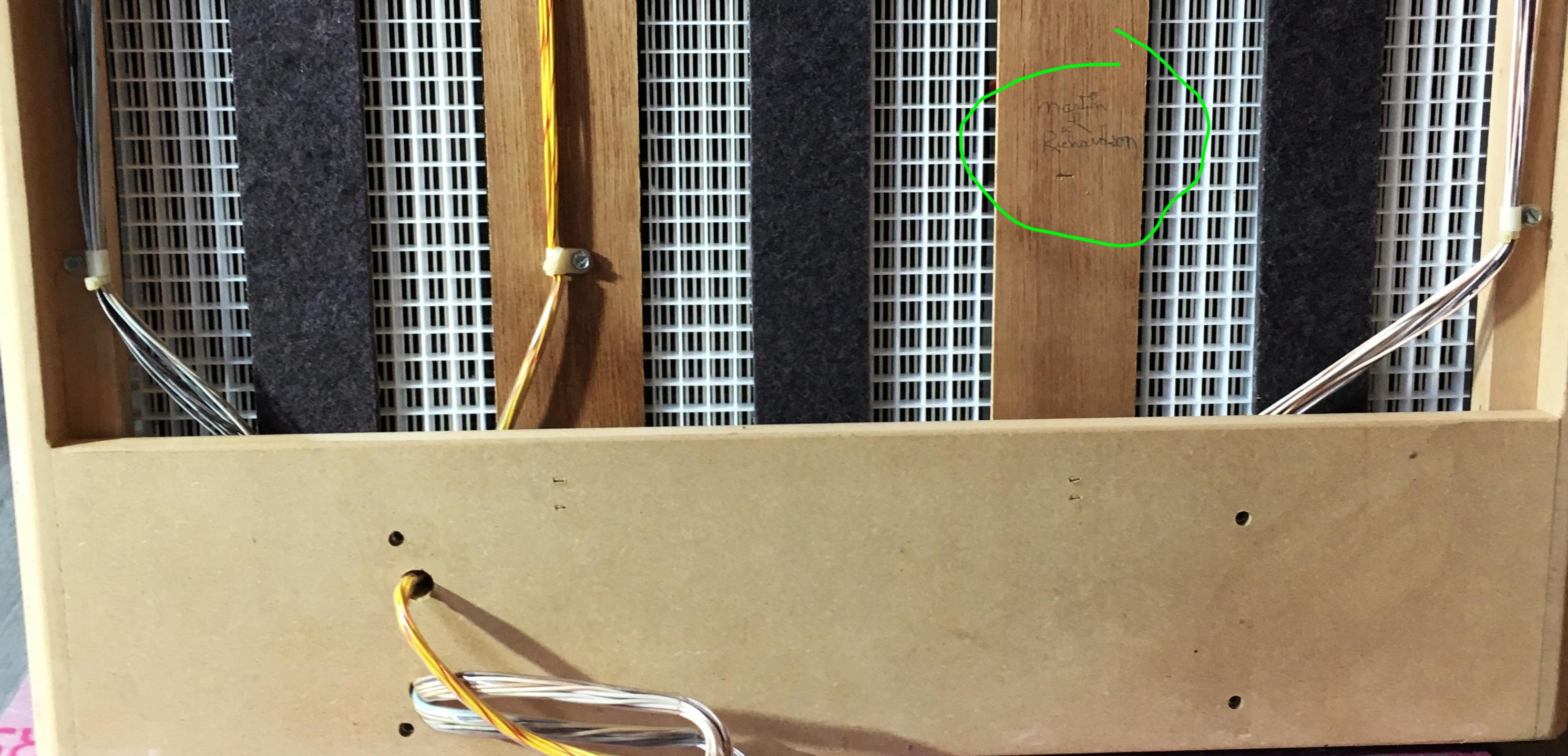

I had mentioned in a prior post that I became really good friends with both Jim and Dave while I was a dealer. Dave was the one who actually taught me how to solder, (well I already knew, but wasn't doing it quite right).
Hi Andy, I removed the socks to clean and noticed a Martin L. Richardson signed his name. Just courious was he a Acoustat employee?
That name does ring a bell, from when the plant was located in Tempe AZ. I think he is the one on the left, in the blue shirt. Note they are building a Spectra 66 or 6600.
Thanks Andy, round florescent stickers on top of the panels indicates 4-4-91 DM.
