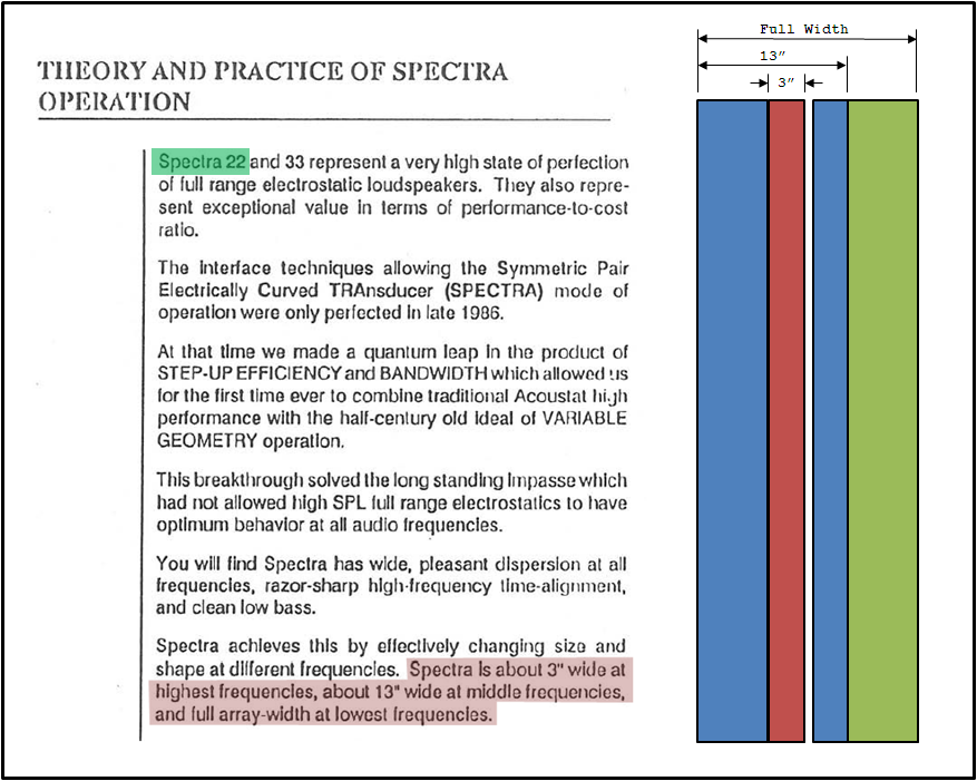

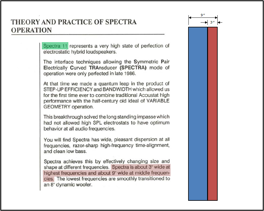

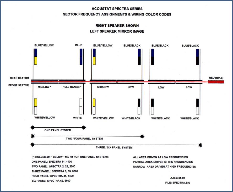

I have seen it mentioned several places that all Spectra panels are the same, having stators that are split in the middle of the panel.
I'm not sure if the term "middle" was meant to be specific(as in split exactly into two equal sized sections) or just general.
Could you clarify?
Both the Spectra 11 and 1100 models I have worked on had the stators split into roughly 3" and 6" widths(ie not the middle).
This seems to agree with the descriptions in the manual for the Spectra 11.
I have not personally seen any of the larger Spectra models.
But, the manual description for the Spectra 22 also agrees with the use of two panels having identical stator section widths of 3" & 6".

To the best of my memory, all Spectra panels are physically divided into two equal halves. That was the design intention of the Spectra technique. Any references in marketing literature to panel widths refer to effective panel width at a particular frequency.
If you have observed panels that were physically divided into unequal segments, I am at a loss to explain that. I will have to dig out my slides of the panel manufacturing process to see if the equal-halves segmentation is clearly shown.

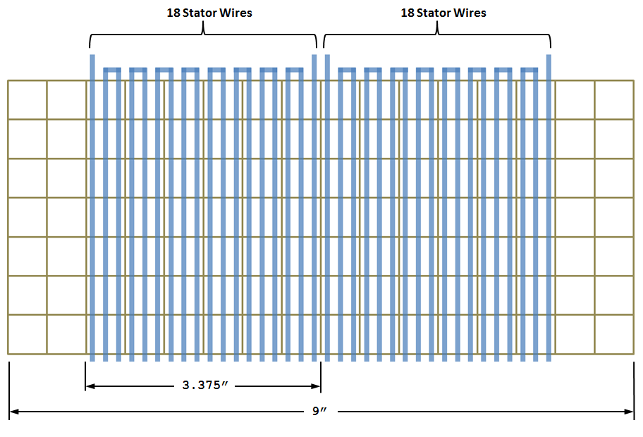

It has been a while since I looked at a Spectra panel and was going on memory and scribbled notes where I had the width of the full range section identified as ~3”. As soon as I started reading you reply I realized the 6” section width I had calculated (ie 9” – 3”) was incorrect since the total width of the light louver is 9” and the outer two rows of cubes do not have any stator wires on them. That is what I get for trying to match numbers in a manual 😉
Based on your description and photos in your factory tour document, I created a diagram showing the width for each of the stator sections as 3.375”. I’d say that qualifies as about 3”, as mentioned in the manuals. The midrange width for the Spectra 22 would then be 13.25” which is about 13” as mentioned in the manuals. The only outlier is the Spectra 11 manual which had the midrange width listed as 9”.
Interestingly enough, I stumbled on a Spectra Brochure which identifies the width of the full range section as a pretty specific 3.3”.
Note also the figure at the bottom clearly showing equal widths for all the stator sections.
