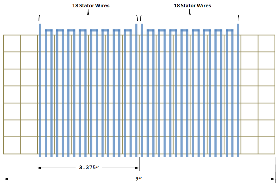

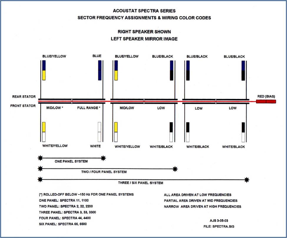

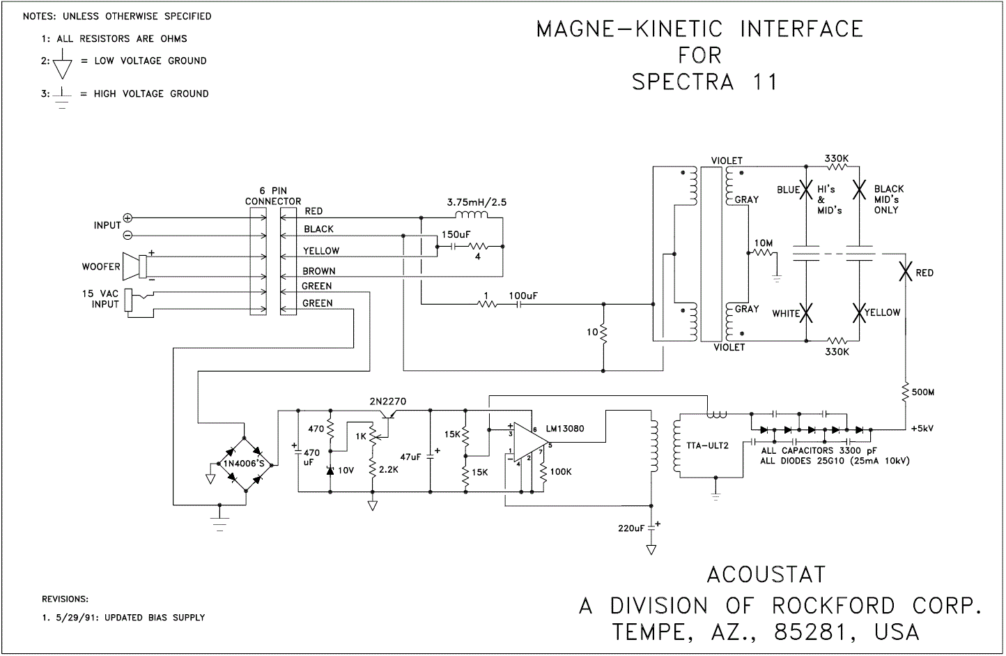

Spectra uses diff res to segment planels as seen in spectra 11 crossover panel setup pic....that's just one 9"panel.....
Hmmm, looking at that any pre spectra could be segmented. kinda odd how much sound can come of such a small surface area of coating and stator.and 70 per cent open. I took an in depth look at my 2+2's, they are simplicity, nothing seems exact. Wonder what kind of HV wire they used, stuff can be expensive.

A difference in volume between the speakers usually indicates a problem in the 5000-volt bias power supply. I would suggest first replacing all five of the capacitors in the voltage multiplier. These are 3300 pF, 3000-volt ceramic discs. A higher voltage rating is okay as long as they fit okay in the board. I also suggest replacing these parts in both interfaces. There's no point in using fancy "audiophile grade" parts in this application - plain ol' ceramic discs are fine.
If that does not solve the problem, the next step is to replace all five of the high voltage diodes (again, in both speakers). The original manufacturer no longer makes this part, but substitutes are available. The minimum rating is 10,000-volts at 25 milliamps. Higher ratings on either voltage or current are okay, as long as they fit the board. Note that these diodes cannot be tested like a regular diode with an ohmmeter, as they are a stacked multiple-junction type.
