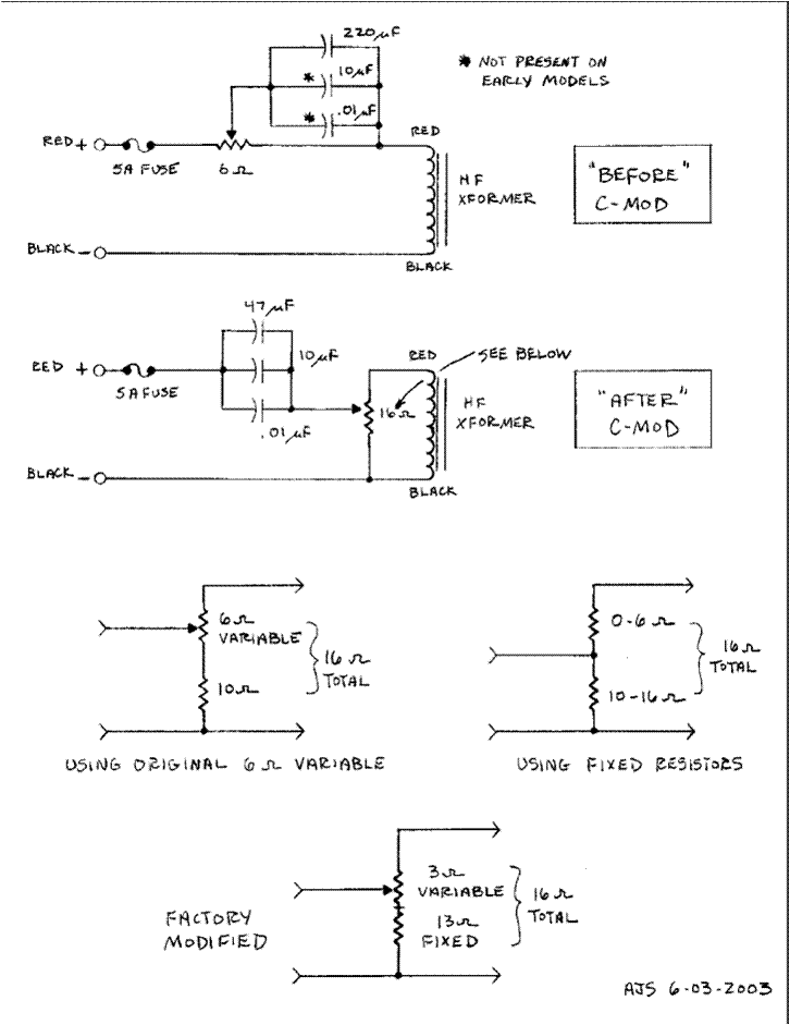

I have only heard of the 3+13 and 6+10 C-mods, that's what I was referring to.Look at the schematic Tyu attached in post#996:

So for about 10hr i have had a 1ohm res in place of the stock 121 C mod 3ohm....Air mod type setup......pulls the mid out of the sound in my setup....sounds gutless up agents the 3ohm ..... more mid richer sound an in my case better topend...Now with stock panels with the felt on the back of the panels it well sound diff no dout darker.........
Tyu, if I understand you correctly:
You replaced the 3ohm VR with a fixed 1ohm?
That achieves the opposite of what any Mid/HF increase mod should do. You lowered the resistance of the shunt leg meaning that less HF energy is going through the HF Trf and more is wasted through the shunt.
If you want to increase the amount of Mid/HF, you need to increase (max-out) the resistance of the shunt leg (16ohm), which is the same as winding up the VR to the max.
That's why I was saying earlier that I don't see the point of "air mod" as it was described to us earlier - if it is only about bridging (MK121A) or maxing out (MK121C) the VR.
If you want "air", then rather increase the capacitance of the HF filter (say 100uF) which lower the HiPass frequency (at a guess, under 200Hz) so there would be significantly more energy going to the HF transformer. You can keep the VR + Resistor arrangement standard, as per C-mod, and still use it for fine adjustments.
