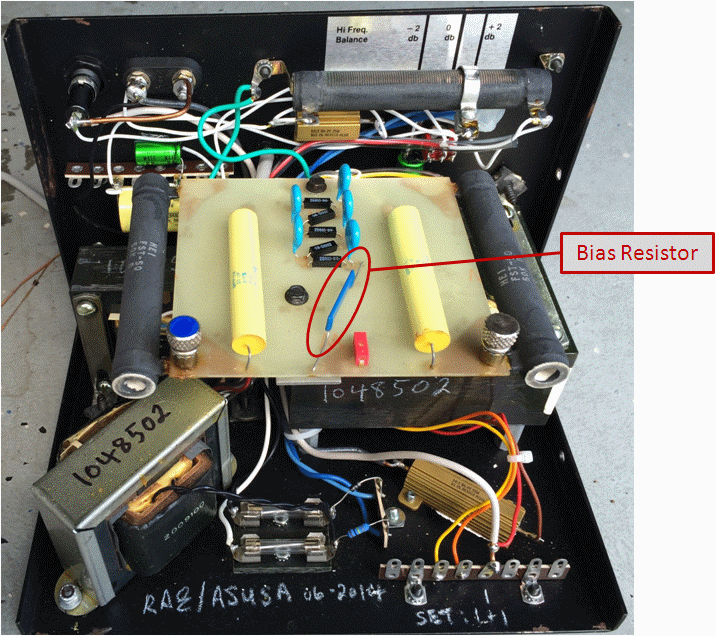

looks like the so called Air mod has (No)meg ohms Res...At all....??
The Bias Resistor was not removed.
It was replaced with what looks like an Ohmite Thick Film Planar HV resistor.
I can't tell you what the resistance is, but it isn't zero.

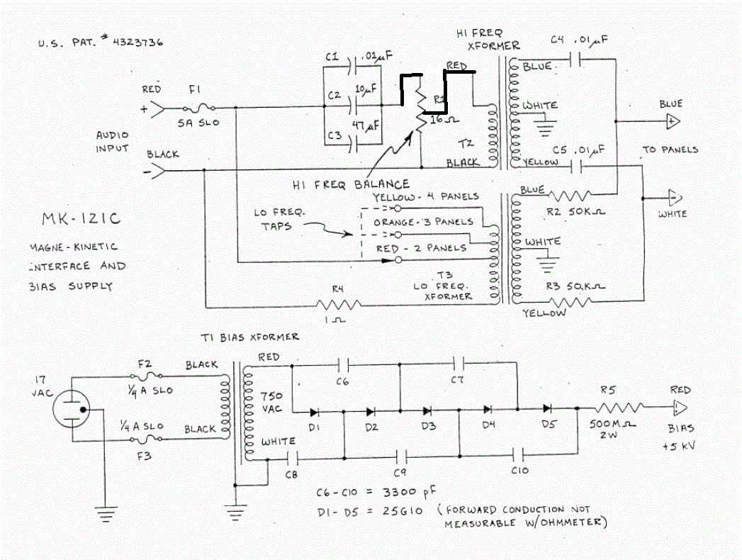

Air Mod is the bypassing of the C Mods top 3ohms.....with what looks like a small gold dail res....

Well i just did the Air mod setup...an the topend gos up.... add the 3ohms back in ...less output at the top...............so so....
When tyu says Mg, he means Mega Ohms resistance. He is referring to the acoustat 500 Mega Ohm bias resistor, and/or the 50K Ohm bass transformer series resistor to the stators. Soundlabs does not have that series resistor to the stators, ...I shorted mine (both of them)...don't know if it really makes it better sounding yet - (need a little more critical listening), but they are there to provide an electronic "delay" of sort - like the quad ESL 63 delay... I cannot tell if the 2+2 I have are now more "beamy" with these bass tranny series resistors shorted, but I have noticed that they now sound best when I listen seated further away from the speakers than before (with the resistors). This may be a problem for me as my listening room is not long enough to make this permanent...I may remove the jumpers soon...

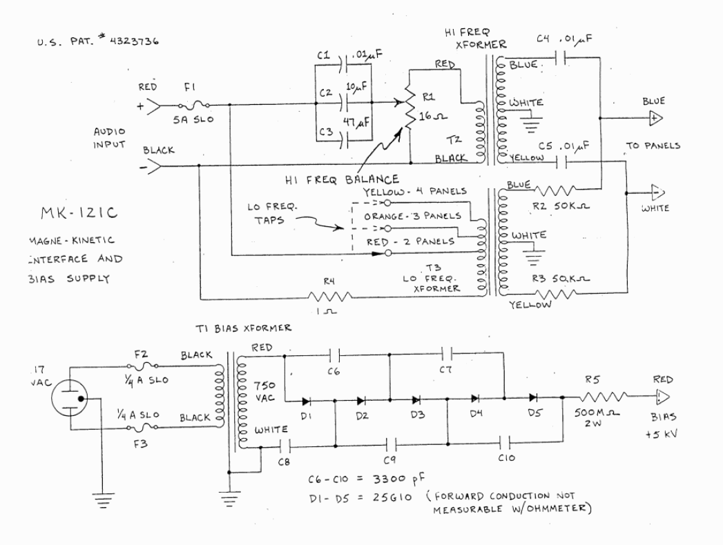

So what are everyone's thoughts on dropping the R5 500 M Ohm resistor down to 3 M Ohm's? Is it safe? will I damage anything? and if it is ok what's the best resistor to use? The thought of just changing two resistors to open up the top end is very appealing.

Having the 500meg bias resistor does a few things - limits bias current so you don't get shocked real bad (should you unwillingly become part of the bias circuit), and also controls the recharge rate of the panel (seems to me the faster the better). Also helps prevent the diaphragm from going up in flames....
I would rather raise the bias voltage than reduce the bias resistor by adding another ladder rung.

As for this Air mod.....i put a 1ohm res. in where the 3ohm was.....an the sound is like Roy states ....the mid pulls back an the top move out... some well like more mid....lot fun...

The hi freq level potentiometer seems to be wrongly wired, it must be better to
connect the hi transformer input to the pot's slider?
Relly.....i see the 3ohm to in the pic.. an if this is dropet to 1ohm you get more highs.....This is hard to get speaker set the same...So Roys Mod Lets this be done ezer......the slider is set at 13ohms...from pos-to neg....so the amp see the 13ohms all the time...that not removed in the Air mod...are it well be what amp well we cook to day mod.....hehe....what do you see??
Agree 100%
Main function is limiting the damage to film in case of arc. Small hole, no problem, big hole, big problem. 100MO (MegaOhm), 300MO, 500MO - I don't think it makes any sonic difference but the higher the value, the better protection of the film.
Even easier and certainly more flexible solution than adding step(s) to the multiplier ladder is over-sizing (20% higher will be more than sufficient for any needs) AC supply and putting a voltage divider ("bias control") at the AC (110/220) input like Soundlab did on their early panels. I have an A2x where the voltage divider is 12k/1W shunted across the AC with a 50k/2W pot. Works great, and it's very easy to adjust.
With your ear close to the stator wind the pot up, say, 5-10 degrees at the time. Faint pops go up as the charge builds up, then they disappear. Keep raising the voltage in these 5-10deg steps until you notice that pops are not disappearing any longer, then back up just a tiny bit until they are gone. Biasing done.

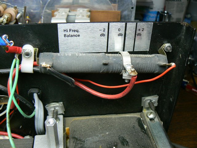

As far as the "Air mod"... if it really is only jumping the variable wire-wound resistor (VR), how is that any different from turning the VR all the way to 0 resistance?
However, the sonic effects of 0-resistance VR will depend on which version of MK121 interface it's applied on.
Early MK121 had the VR in series with the signal, acting as a rather crude voltage divider between a straight line to HF audio transformer on one leg, and a total of 230uF capacitance on the other.
0 resistance VR in this case meant no filtering (almost - internal resistance of capacitors) of the HF signal and probably caused quite a few blown HF transformers because they would be receiving the full frequency (and energy) as the LF transformer.
MK121 C-Mod (can't remember what the "B" was about) puts the VR in the "shunt" across the HF transformer primary, acting as much finer voltage divider (6ohm variable + 10ohm fixed), and with negligible effect on the capacitance filter that precedes it.
In this case, setting the VR to 0 resistance lowers the resistance of the "shunt" and conducts MORE through the shunt compared to the HV Trf primary leg.
Thus, maximum shunt leg resistance = maximum HF output.
Without knowing the HV Trf primary AC/DC resistance, I cannot for certain calculate the effect of the voltage divider, nor can I calculate the effect of the much reduced HF filter capacitance of the C-mod, but it is absolutely certain that the C-Mod acts as a 1st order HF (HiPass) filter at a much higher frequency than original MK121, which protects the HF Trf a whole lot more.
Some assumptions for equation purposes:
Since the total shunt resistance is 16ohm, I will assume that the HF Trf primary is also 16ohm, producing the total DC resistance of 8ohm. Assuming that impedance is similar to resistance, capacitance value of 57uF in the 1st order filter means a HiPass from 350Hz (which sounds about right).
Finally, the 1ohm resistor on the LF Trf primary.
It's sole purpose is to prevent transformer impedance from dropping to very uncomfortable 0. I remember reading somewhere that it was actually measured dropping down to 1ohm so Acoustat thought it's safer to put another 1ohm in series to protect the amplifiers from going into short-circuit panic. Does this affect the LF sonics? Honestly, no idea. Soundlab has 30ohm (!!!) 100w (!!!) in series and I honestly cannot say that it differs much from Acoustat in terms of perceived speed or definition.
Mike

Not at all - it's just a shunt across the HF Trf primary. Full swing it both ways, medium effect. Even if you completely remove the shunt leg, you end up with HF Trf primary resistance/impedance as the load. It will just be LOUD.But if the pot is turned to the lowest level, the amp will be short circuited at high freqs...
I enclose my suggestion..
Edit: Just in case of misunderstanding:
Shunt resitance can never be 0 because it either contains a fixed 10ohm resistor (if the original 6ohm VR was used), or a fixed 13ohm resistor (if a 3ohm VR was used).
On all the OEM Acoustats I have worked with, it is physically impossible to adjust the tap on the slider resistor below the half way point.(see attached pic)
Acoustat Answer Man may know if there were ever MK-121 interfaces made where the tap was adjustable over the whole range.
I would bet no.
Look at the schematic Tyu attached in post#996:Not at all - it's just a shunt across the HF Trf primary.
http://www.diyaudio.com/forums/planars-exotics/183168-acoustat-answer-man-here-100.html#post3985864
"IF" the slider could be adjusted all the way down, the amplifier would see a short thru the capacitors to ground at high frequencies.
I don't think it is possible to adjust the slider in this manner on OEM interfaces.
