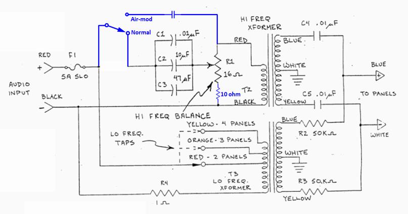

When i look at this setup.....i see a diode on one leg...look like pos Dc... an a res on the other leg..... ..... it looks like its after the bias transf....but were dose it go?.....is this part of the Air mod...
Look back at the circuit you posted:
http://www.diyaudio.com/forums/planars-exotics/183168-acoustat-answer-man-here-100.html#post3985864
Notice that the black wires from the bias transformer are the 120Vac input to the bias transformer. The diode and resistor are downstream of the bias transformer fuses and the light/dark blue wires run to the back panel where they disappear under a glob of silicone. My guess would be that the diode/resistor are being used to illuminate an LED on the back panel indicating 120Vac power is getting to the input of the bias transformer.
Yup, bolserst has it... its on the primary side of the bias tranny, not the secondary... I also see an added red power switch too. It must be a power indicator using a 120v bulb
Based on Roy's description the switch is not for power, but to switch between "normal" and "air mod".
http://www.diyaudio.com/forums/planars-exotics/183168-acoustat-answer-man-here-97.html#post3985124
It's kind of hard to tell from Estat's pic, but the general circuit arrangement for the mod is probably pretty close to this.
thanks for the info.....thats what i ended up with .....i put a 5ohm addon in my setup not a 10ohm.... that gave me.....gave me 23ohms...an the 56mf cap...but i bet....he put a high mf cap in the air mod...it a green one....maybe 220mf...it not a polly cap....looks like he put one in the norm crossover also.....he must like the sound.....who knows...

Exactly! The bypass is switchable. I pretty much leave it on the air setting. The blue LED is on in either position.Based on Roy's description the switch is not for power, but to switch between "normal" and "air mod".
