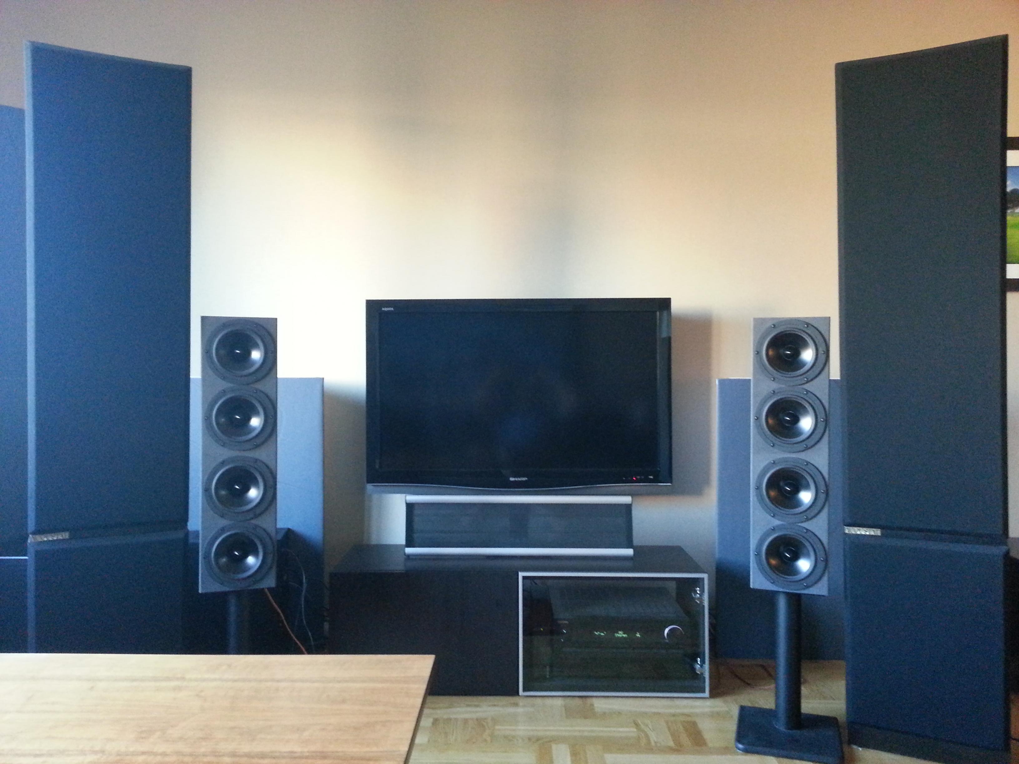

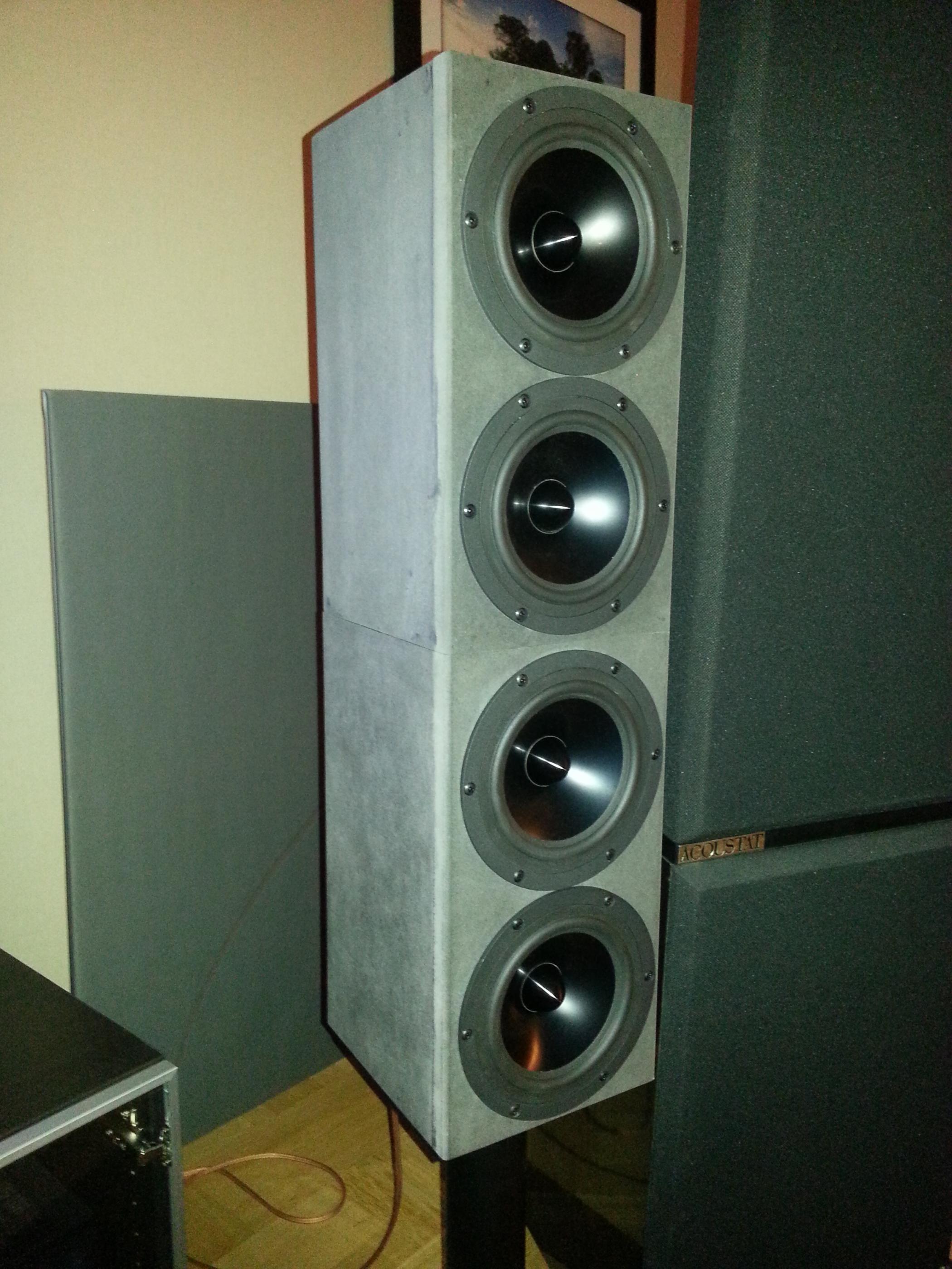

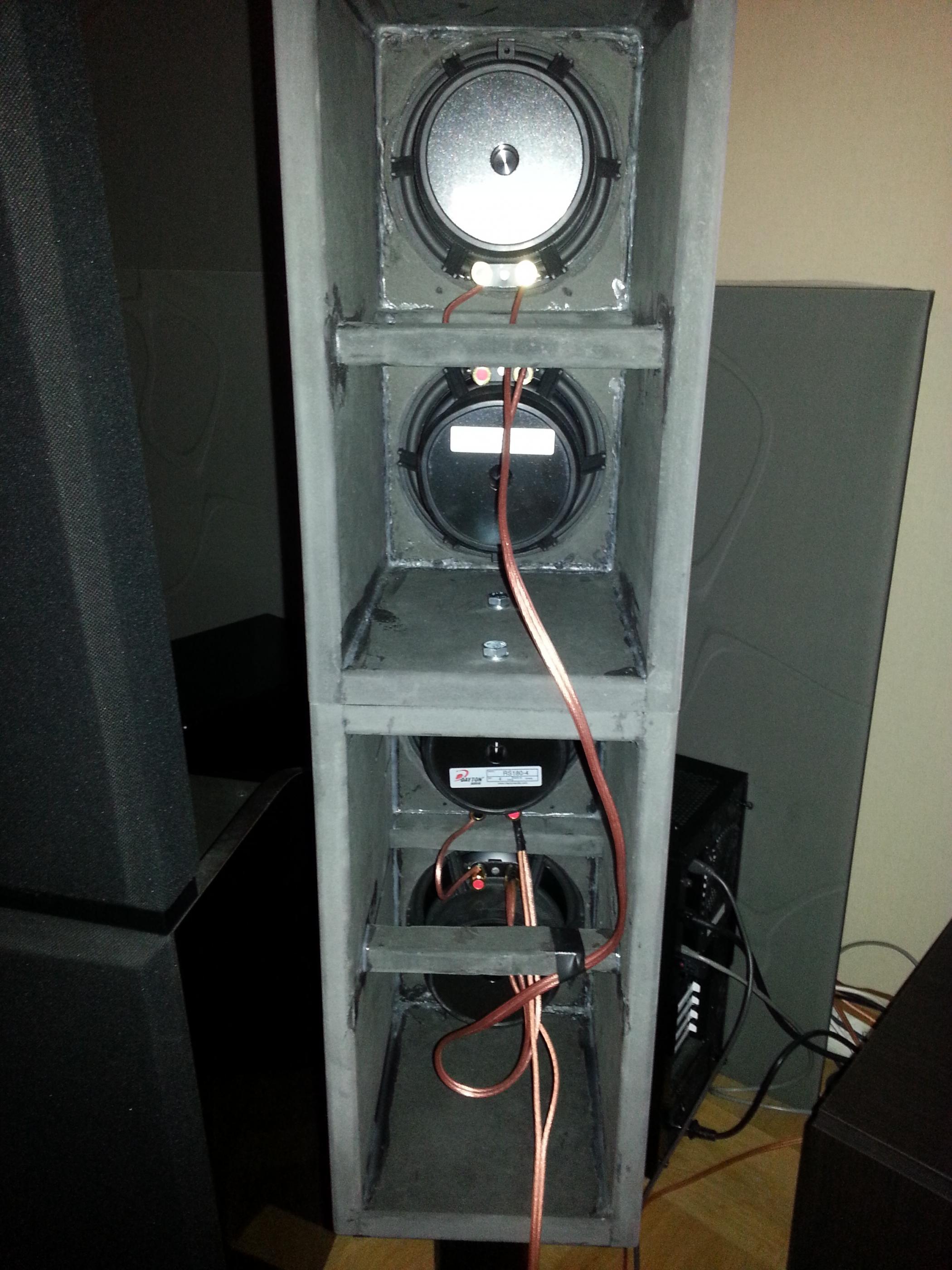

Bass towers for Spectra 11
I've now completed my open baffle bass towers build. The goal was to replace the bass boxes of my Spectra 11's with something better. I believe an open baffle line source with dynamic drivers is the best fit for ESL panels. After a very valuable discussion with Calvin on this forum I chose the Dayton Audio RS180-4 driver. It's a very high quality driver with nice properties for a reasonable price (even cheaper if you live in the US 🙂). I used Calvin's purist ESL as inspiration for the project, but I only used 4 drivers in each tower not 6. I built four boxes with two drivers in each and then bolted them together two and two. Although I can't claim to achieve the same quality as Calvin's products, I'm very happy with the result both visually and sound wise. Subjectively the bass sound is very controlled and uncoloured.
The boxes are made of 19 mm thick MDF board which makes them very sturdy. I chose a board that was already died black as I'm not that skilled at paint work. 🙂 The finish is ok by my standards, but maybe I'll consider improving it later on.
The bass towers are crossed over at 250 Hz with the Acoustat panels using a steep digital filter to avoid a quite nasty resonance at 335 Hz. I don't use any damping material in the boxes as I didn't see any need for it. At the bottom I crossover with the subs at 40 Hz as below that the distortion in the Dayton drivers rises quite steeply. At 40 Hz I measured about 3% THD for one tower. Above that the distortion drops to below 1% (all measurements were made in my living room so they should be taken with a grain of salt). After some driver break in all four boxes measured pretty much identically between 40 and 400 Hz which I think says something about the consistent quality of the Dayton drivers.
Digital EQ is certainly required for this kind of speaker and I use Audyssey MultEQ XT32 calibration for that. It does an excellent job of flattening the frequency response and seamlessly integrate the bass towers with the Acoustat panels and the sub woofers.
See this page for more pictures and measurement results of the build (warning: the page is in Swedish 🙂). My next project is probably to build a floor stands for the Spectra ESL panels and remove the bass boxes from them.
