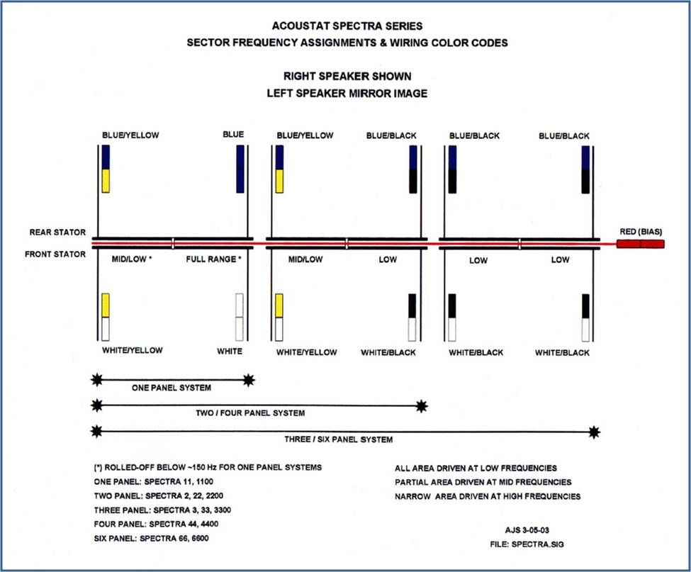

Does anybody knows wich wires (colors) are for front- rear stators on spectra 1100 panels?

The BLUE group of wires is for the rear stator, and the WHITE group is for the front stators. Besides the color coding, it's easy to look at the edge of the panel where the wires exit, and it should be obvious which are the front and rear stator wires. The RED wire, of course, is the diaphragm bias connection.
Spectra panels CAN be used as a subsitute for the older, non-Spectra panels, but not vice-versa. All Spectra panels are 9" wide, whereas some of the inner panels on the older models are 8" wide, so the Spectra panels can only be used as direct replacements for 9" panels.
For example, your current three panel Monitor has two outer 9" panels, and one inner 8" panel. But nothing says you can't add another 9" panel to the array to make it a quasi-Monitor Four.
You'll probably want to change the low frequency transformer tap, from its current ORANGE position (for 3 panels) to the YELLOW position (for 4 panels).

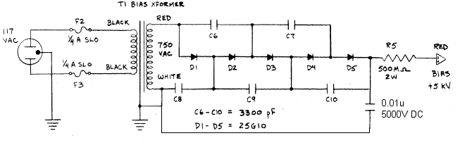

Thank you very much for your answers. What do you think about HV mod with on this picture?
I'll be honest and say that I am not a fan of any chnges to the bias supply other than replacement of existing parts with identical parts.
The modification shown probably won't hurt anything, but I'm not sure that it will improve the sound, either. Your mileage may vary. Note that the extra capacitor is connected before the 500-megohm resistor. Connecting it after the resistor (as some people have erroneously done) will violate the constant-charge principal of the speaker and will certainly decrease the linearity of the system.
One caution: the capacitor shown will retain significant charge after the power is shut-off, so the usual advice to carefully discharge the power supply is especially important. Otherwise it has the potential (pun intended) to give a MUCH nastier shock than the stock power supply.😱

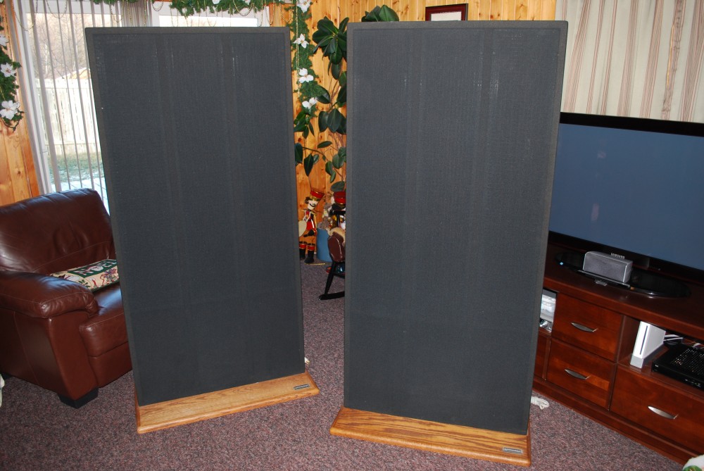

Just got these Spectra 3s in the pic......... can someone give me any info thay may have on this Acoustat....i think there the frist.Spectra ?..........
Can thay be ran fullrang.??........... dose the... looks like a 10"bass driver have to be used?....it faces down............I have the .Spectra 33 setup in the pic..........is it this same setup??...

Yes, the model shown is the Spectra 3. Along with the 2-panel Spectra 2, these were Acoustat's first Spectra models. They can be run full range or as a hybrid with the enclosed woofer. There are switches on the bottom of the woofer enclosure for selecting these options. Electrically, these models are the same ESL's as the later Spectra 22/2200 and 33/3300. The only difference is the built-in woofer. These models did not sell well due to the higher cost and the cosmetics were not to everyone's liking. The later Spectra models were much more popular.
The tambour wood on the front of your speaker appears to be the 'teak' option. Several other real-wood finishes were available. Those woofer cabinets were a real bitch to build!

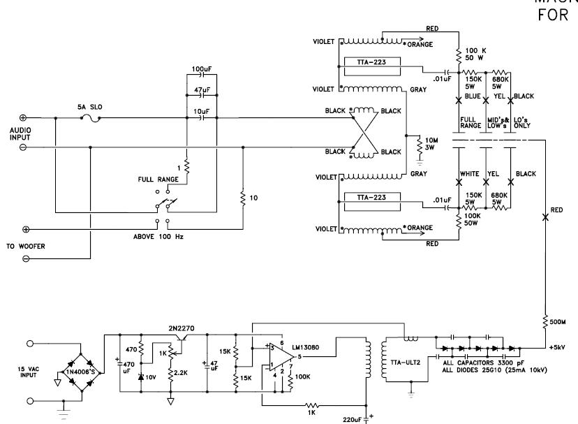

Early Spectra models did not have the Ultrasonic bias power supply. The line-powered bias supply is exactly the same as used in the MK-121 series.
YES, the 1-ohm resistor should remain in-circuit regardless of switch settings. Same as the 1-ohm resistor in the MK-121 series, its pupose is to keep the extreme LF impedance above 1-ohm.

All of the bias supply and audio step-up components are mounted on the metal plate underneath the woofer enclosure. Remove the screws, disconnect the internal wires, and you're in. You will find the transformers and HV circuit board to be identical to later full range Spectras.
I don't remember where the woofer crossover components are mounted: some of them may be on the metal plate, but other parts (such as the coil) may be mounted directly on the woofer cabinet. There might also be a component (like a resistor) mounted directly on the woofer terminals. Sorry, but it's been a LONG time since I looked at a Spectra 2 or 3!
