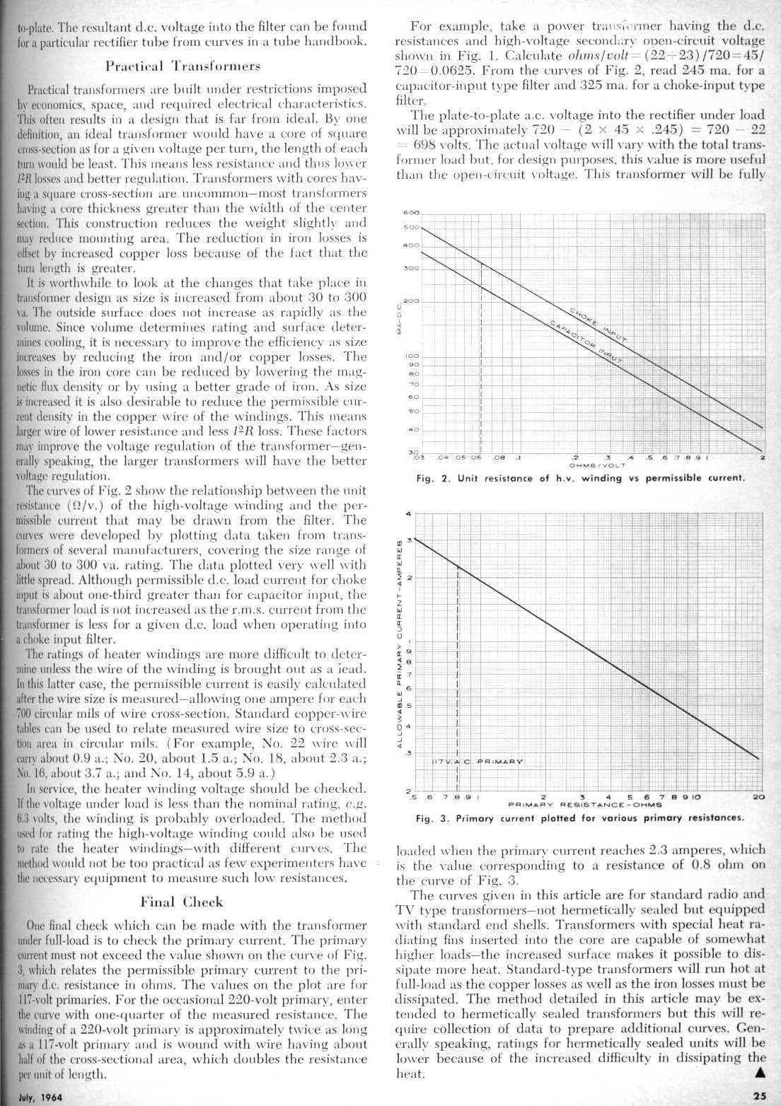

Acoustat Answer Man - do you know what the current capacity is on the standard Bias transformers? 750VAC @ XXma?? Fuse on Bias tranny primary is only .25A, so that's around 40ma on secondary...is that really it?
Sorry, I don't know the output current rating for the standard bias transformer - I don't think I ever saw that specification. However, it WILL be very low: remember this is a constant-charge system, feeding the panels through a 500-Mohm resistor, so the resulting current flow from the multiplier is miniscule. I suspect most of the transformer's output power is actually consumed as waste heat in the multiplier.
In actual use, it's probably a lot less than the 40 mA you calculated, since the primary current will only reach 250 mA due to a major failure.

Yeah, I found my chart (to determine current capacity of unknown voltage transformers), and it is more near 30ma - 40ma at best... attached...secondary DC resistance/secondary voltage gives a ratio you can look up to see approximate current...the secondary dc resistance on the bias tranny was 1200 ohms, giving 1.6 ratio. Chart says around 30ma. This is cool!!
