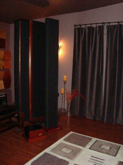

I've been toying with the idea of making new smaller, but more ridged frames for both my Model 3s, and Spectra 11s. My plans have been around using a steel tubing with rectangular cross section, and filling it with lead shot for damping. I'd then pull a cloth sock over them, like stock, and add a thin wood strip "picture frame" around the whole thing. I got the idea from the Arcici stands on my ESL-63s... I might even try to bend the tubing to work as a stand as well. Still mostly just ideas floating in my mind at this point, but thought I'd share, since it sounds like you're working towards a similar goal.
Here is a frame for the model 3 that i sold one month ago.
New frames for model 2s - 3s - 1+1s -
nice you do the after market support and upgrades 🙂 frames look nice! like the wire idea with the fabric to create an arc!

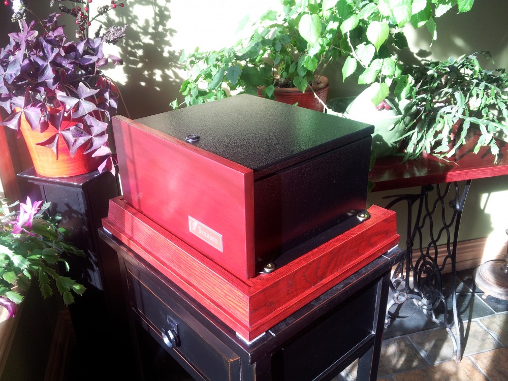

This is a pair of 1+1s leaving for Barbados this week, the interfaces are seperate to be next to the amps.

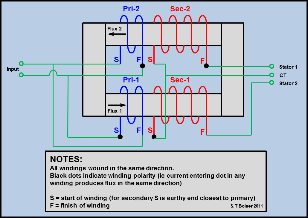

Why is the schematic for the Spectra 11 and 1100 showing the output transformer connected out of faze in the primary and in series in the secondary winding?
Usually dots shown on transformer windings indicate which end of a winding will cause flux to develop in the core in the same direction for every winding. My guess is that dots on the Spectra 11 schematic are being used to indicate the start(or end) of a particular winding not its relative flux polarity. Since the Spectra transformer uses UI-core with a primary on each leg wound in the same direction, if the primaries are to be wired in parallel the start of one primary must be connected together with the end of the other.
The attached pic shows how the primary and secondary windings are oriented and wired.
Exactly, I know what You are saying.
But as they have illustrated it it will be a short circuit as they have interconnected both primary windings and also illustrated it together with a joint core. Regardless of the dots, the sum of the illustration will be wrong, I think.
Take the QUAD esl 63 or earlier Acoustats for an example, those schematics show it right.
Or am I just thick?😱
Perhaps it's the UI-core lineup that beats me...
