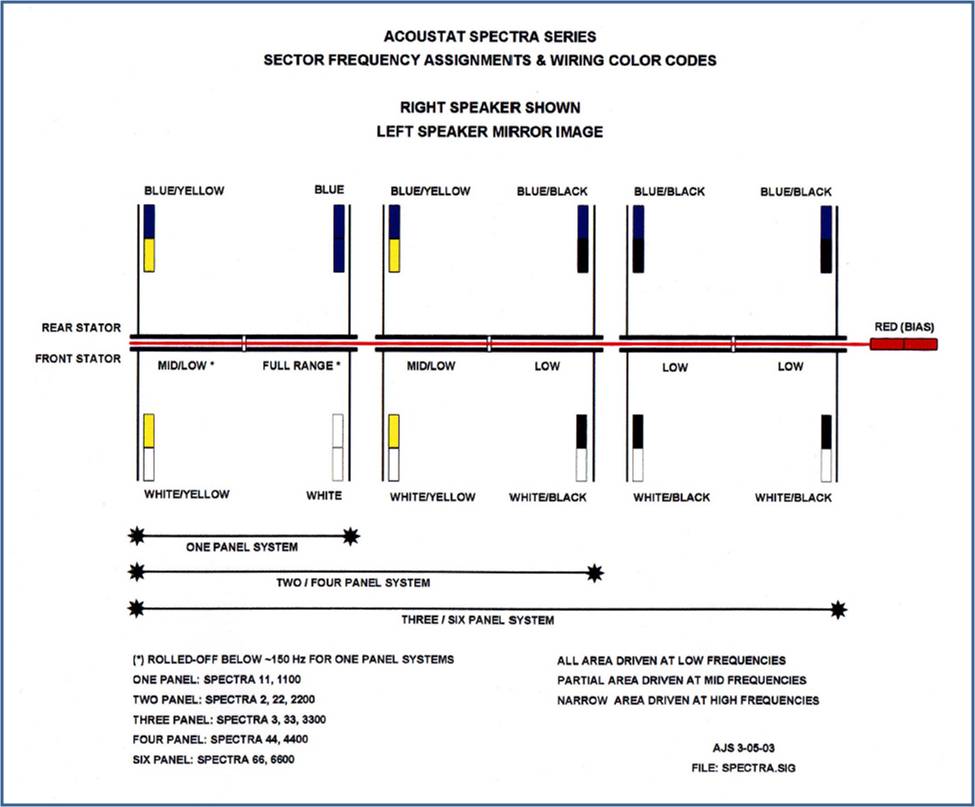

The Spectra 2200 is here.......
Hmmm, nice drawing I made there (I'm 'AJS'). Nice to see it still in circulation!
Yes thanks for all the work you done for all of us Acoustat lifers.... some cant find anything so i try to help if i can..other here help a lot
