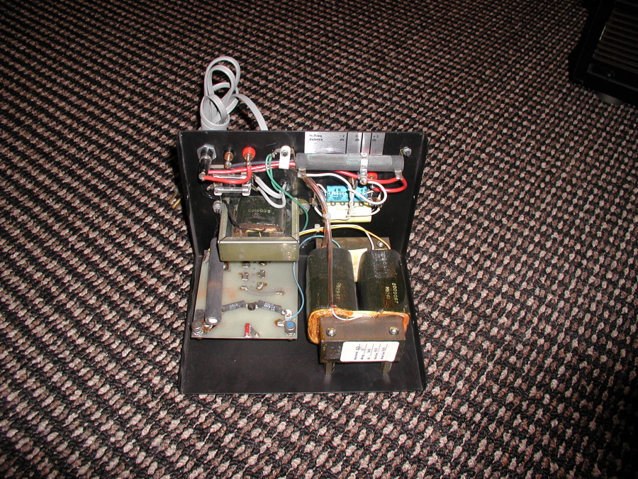

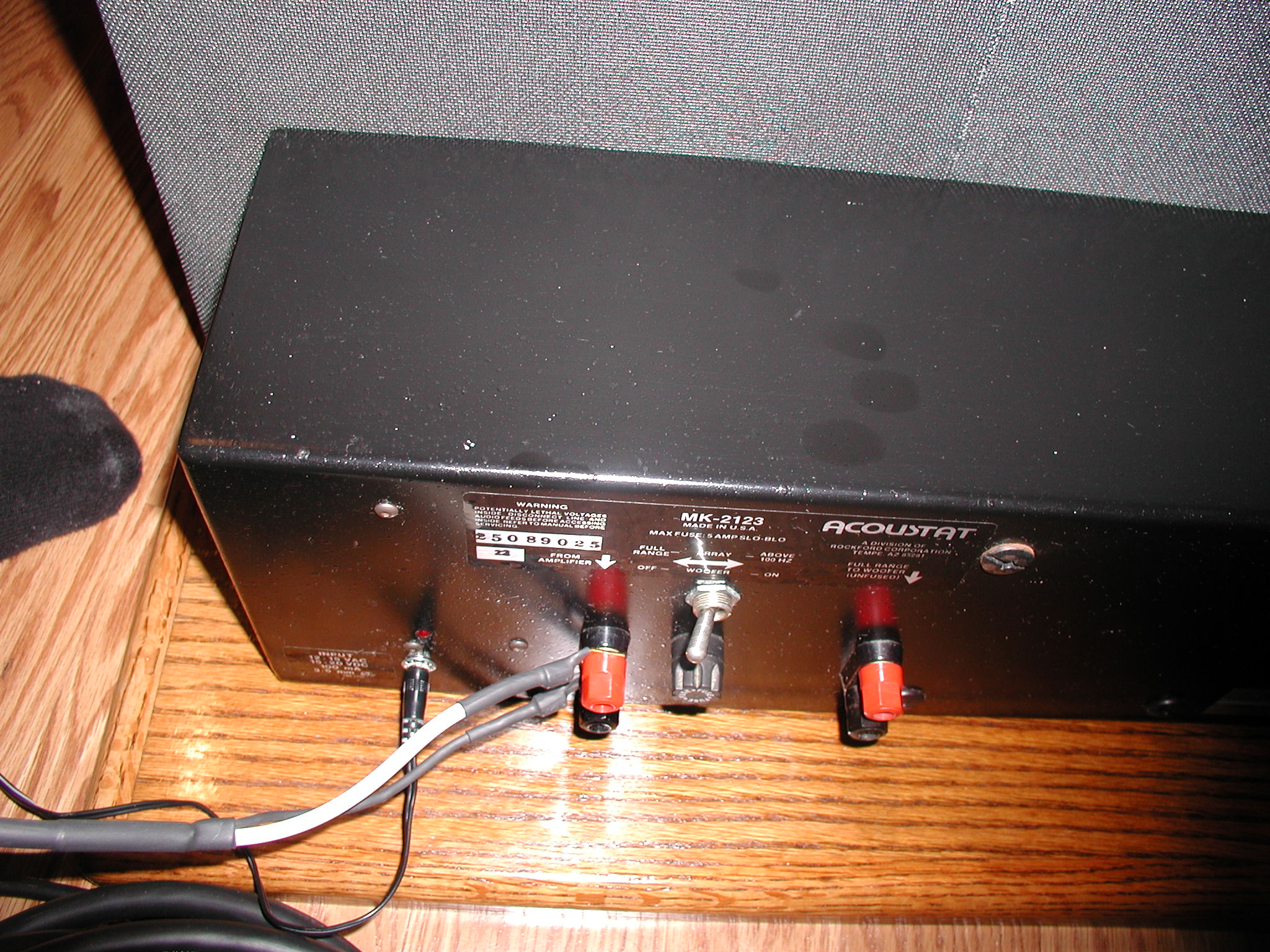

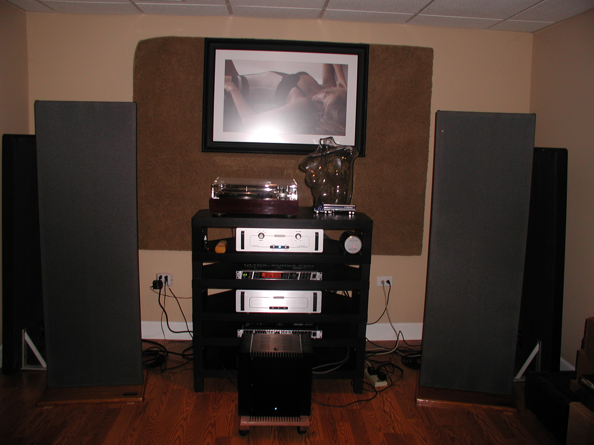

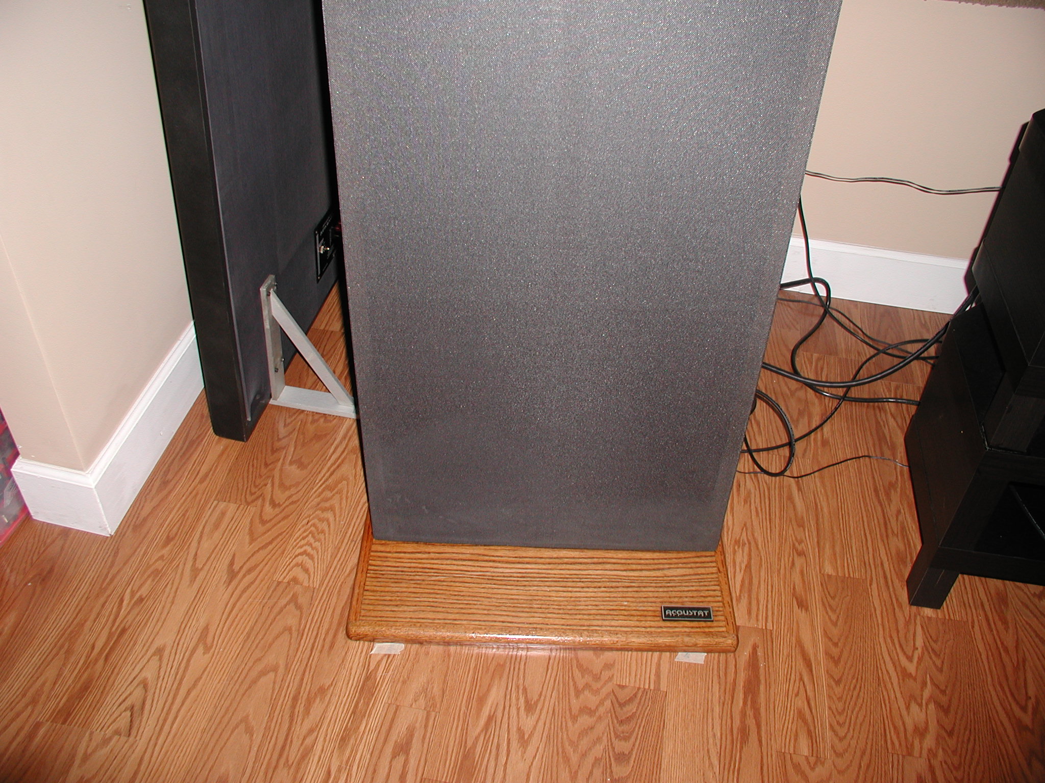

Hello Andy et al,
I have just finished restoring a pair of Spectra 22. I rewired the wall wart jack to the bias pcb and anchored the new jack to the I/F box - no longer just secured to the bias PCB - using a new rat shack 1/8" jack, reglued some bias wires to the lattice - which was the real buzzing problem with these speakers initially, blew out the panels with compressed air, washed the original socks, and re-finished the bases. Aside from a couple small holes in sock, they look brand new. They definitely have less beaming and sound livelier than the Model 2 equivalent. I was actually surprised on how much bass it has too. I have to decide if it is a keeper, as I have too many speakers, (my Apogee Duetta Sigs currently rule the roost), and also have plans to someday build a monster Model 6 or 8 (I have a total of 6 9" panels so far)...decisions decisions...
I must say that the design of the Spectra interfaces is quite unique as there are no crossover components on the frontside of the step up trannies. I look at the wiring diagram and see that for a two panel, the outer section of the outmost panel is run full range, while the other three are mid/low and low. Interesting. Going from two to three panels just adds more low end? I really wonder what these would sound like with both panels (all four sections) are run full range, and a pair of regular panels from my model 3 just wired to the low connections on the spectra interface.
Anyway, my question, I have a couple Model 1 MK-141 interfaces and the step up trannies look a lot like the step up trannies used in the Spectra...are they the same? I have attached a pic of the speakers as they now look, and a pic of the MK-141 interface showing the step up tranny....
Beyond the similarity in physical appearance (both transformers are constructed with U-I laminations) the Spectra transformers and the MK-141 transformers are very different. The MK-141 is a dual-phase, limited-frequency range unit, whereas the Spectra transformer is a single-phase, full-range unit. So, you can't make a Spectra using an MK-141 transformer.
